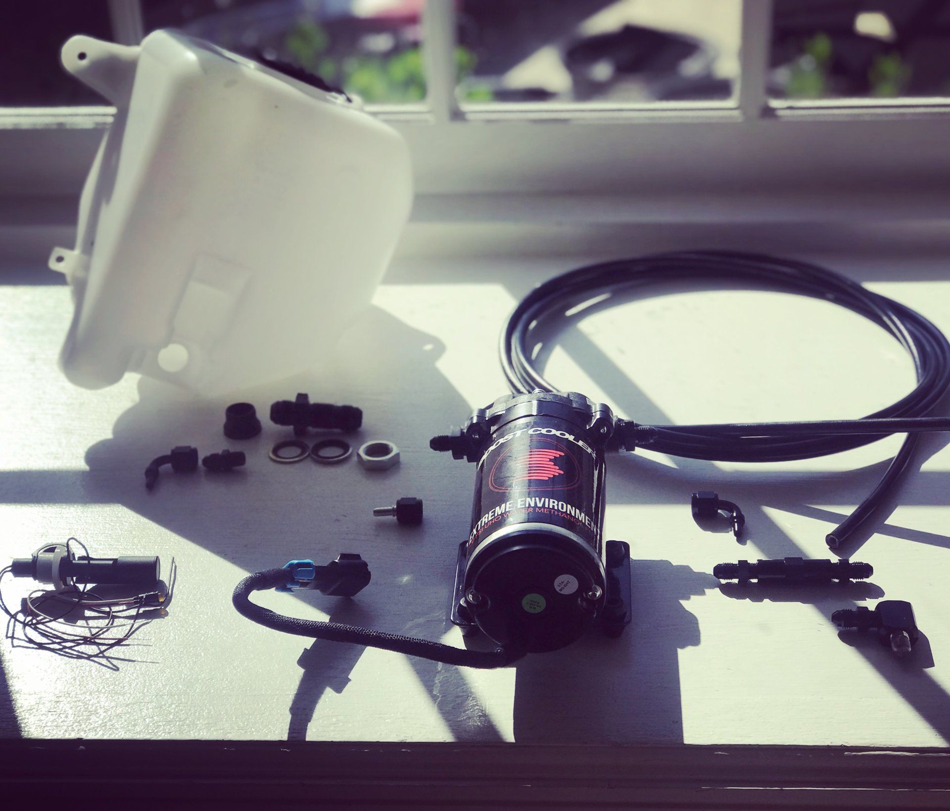

Oooooooh snap! All I need is my boost switch to arrive and the “mostly bolt-on” meth injection kit for us boosted 1FZ folks will be ready to go.
Im using Snow Performance on the pump and critical bits. All of the hoses will be PTFE/stainless braided with a black coating. Cannot wait to play with this!
But you can buy them triggered off MAF sensor with a window switch for throttle. There are a lot of ways to set them up.
Is the switch a dash mounted manual switch thing, or a switch that controls the flow of the methanol depending on engine load/RPM’s?
Price point on this yet?
Mine has dual arming. There has to be at least 3lbs of boost and the engine RPM must be greater than 3,100. When both thresholds are met the pump kicks in with 90 PSI at a rate of 14 GPH.
