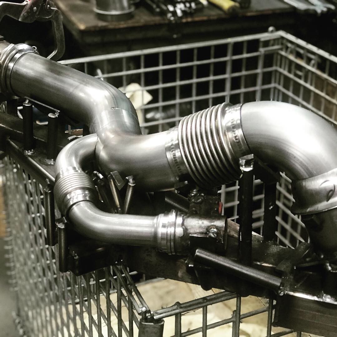

The first article of the downpipe was off by 1/2” due to the accident with the ICON80. It was forcing the bellows too far to its edge rather than being at the center of its movement. So that one was scrapped while some modifications for the jig were made. Pretty sure it’s dialed in but the second article will be ready tomorrow to test fit again.

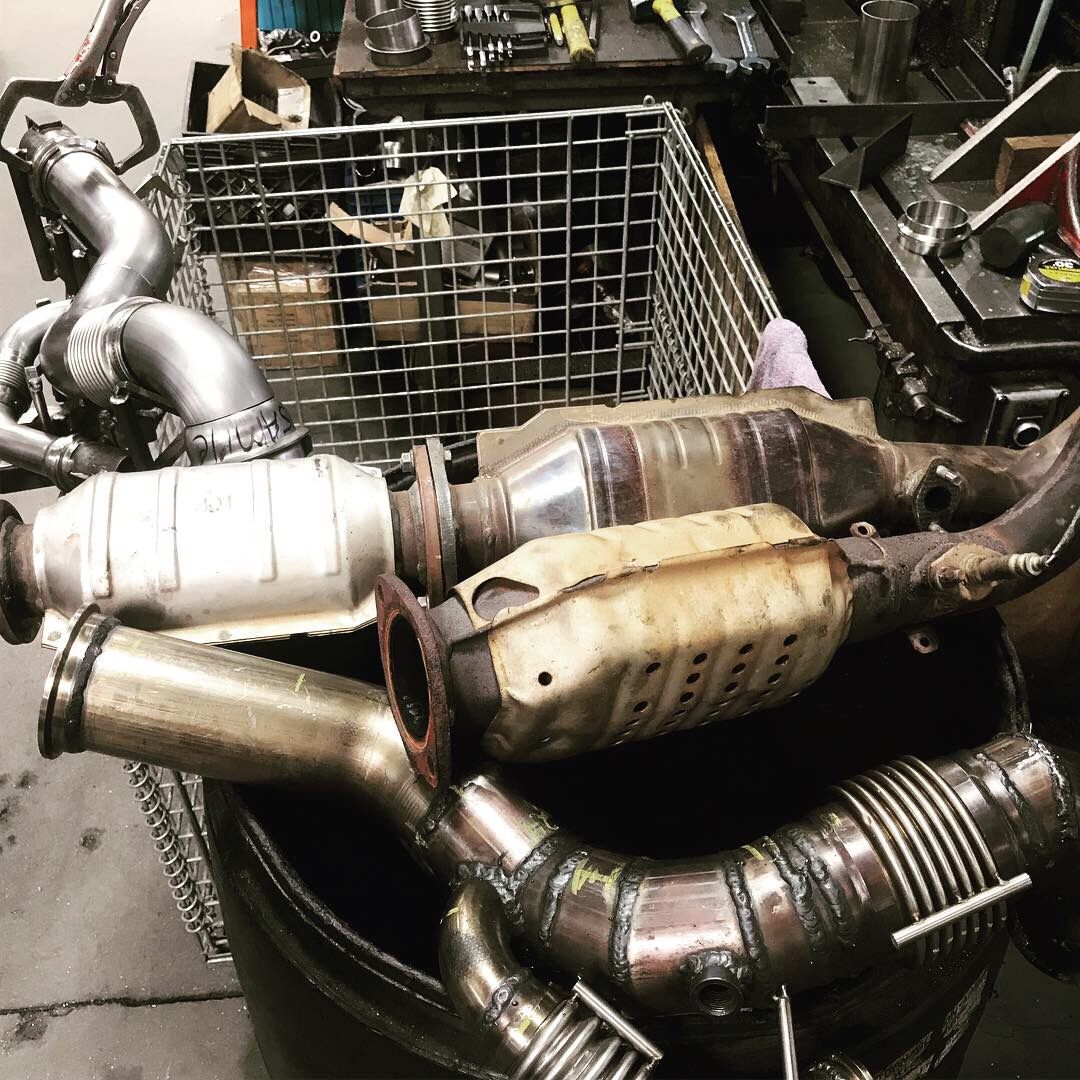

My brothers went over to Dylan’s home to remove the cats so we could verify some measurements. Unfortunate the pieces were too damaged to be of much use. Bummer. Luckily we removed the cats from the test mule #3 to compare.

I did make sure I spent 15mins with my brother to get the downpipe test fit. I have to say it’s almost embarrassing at how easily the downpipe bolts up with the turbo and wastegate. Zero drama. A crazy amount of time was spent putting the downpipe together and all that effort shows. I was so happy I could feel my eyes well up 😉
@Heckraiser I really don't think your wife could have any objections to these pipes....
Good job Joey, this kit looks every bit as good as my custom setup!
