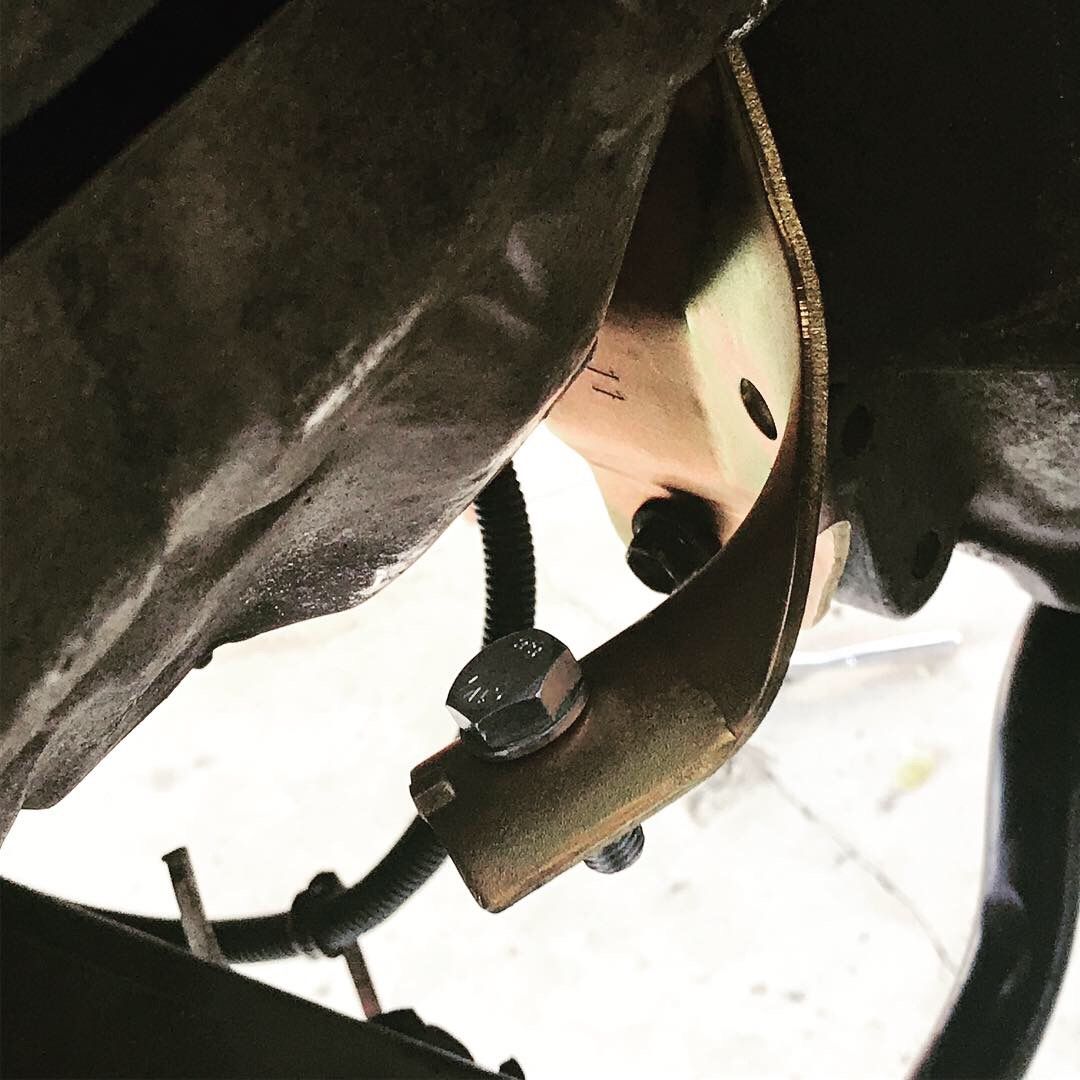

The turbo downpipe needs to be supported onto the transmission bellhousing in a similar way that the OEM setup was. The same bracket is used but needs to have a 7/16” hole added to it so that the new clamp and hardware can be attached. Once put together it keeps the downpipe from moving or prematurely cracking. Really happy with how this came out.

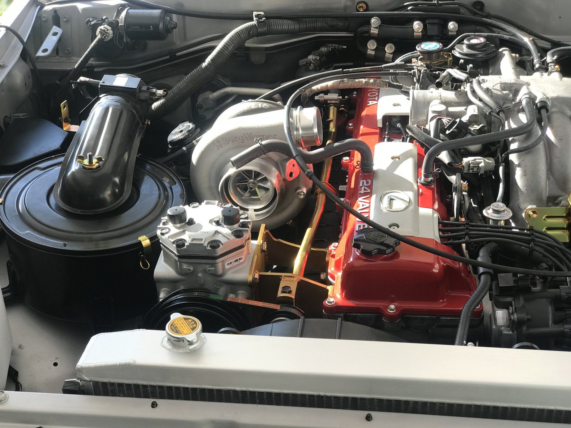

Is the air cleaner lid staying in that orientation?
Intake pipe is going to have some big bends?
Hdj80 turbo intake is much more direct
Not as shiney as yours :hmm: and different scenario. This a pic from my hzj105 install.
Just curious if a more direct intake path is possible?
Looking super clean!
Hdj80 turbo intake is much more directView attachment 2041065
You don’t have a MAF to contend with. When originally designing the intake that was the original plan until...well, MAF.

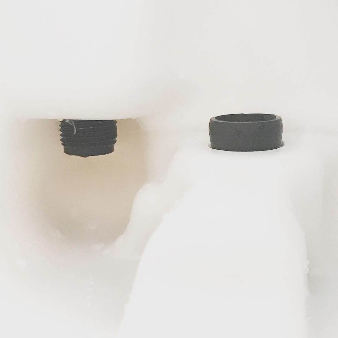

This may not be terribly exciting for most but since I’m going to be running #MethInjection I will be needing a tank. I don’t want to add a tank. But our trucks already have a #methanol tank. It’s called the windshield fluid reservoir. It’s going to remain a washer reservoir but it’s also going to supply the methanol (washer fluid) to the turbo to cool the intake temperature down significantly.
The new tank got a new motor. The flat spot in back (that looks like it used to be for another pump motor) instead got drilled and tapped for 1/4NPT so that a 4AN fitting could be added. Next I was able to figure out that the tank covers the auxiliary battery hold down. But this truck isn’t getting dual batteries. So instead I’m going to use that hole to route the float wiring. Now that larger circular impression in the bottle gets a .75” hole drilled dead center. Then the float gets mounted and tested. Good to go.
