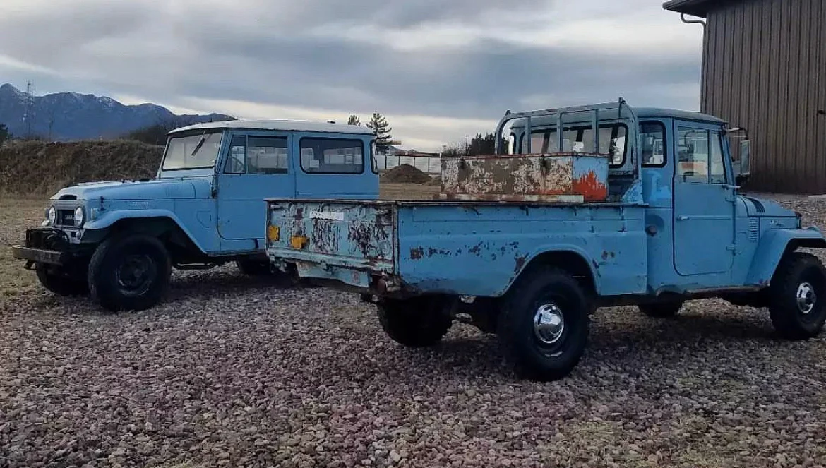

My first major project of 2023 was the 1967 FJ45 LPB I did for @Sweet Water ’s dad. While Mike was out looking at the 45 at @OGBeno ‘s place Johnny sold them on this 2 for 1 package. I had already made many commitments for this year so I could not work on these two back to back but now the shop is open to take this fella in for some love.

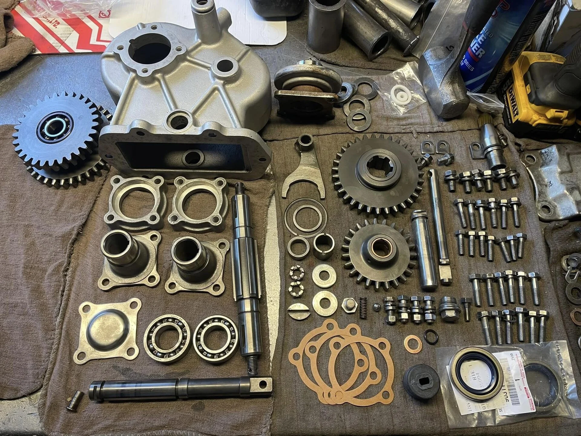

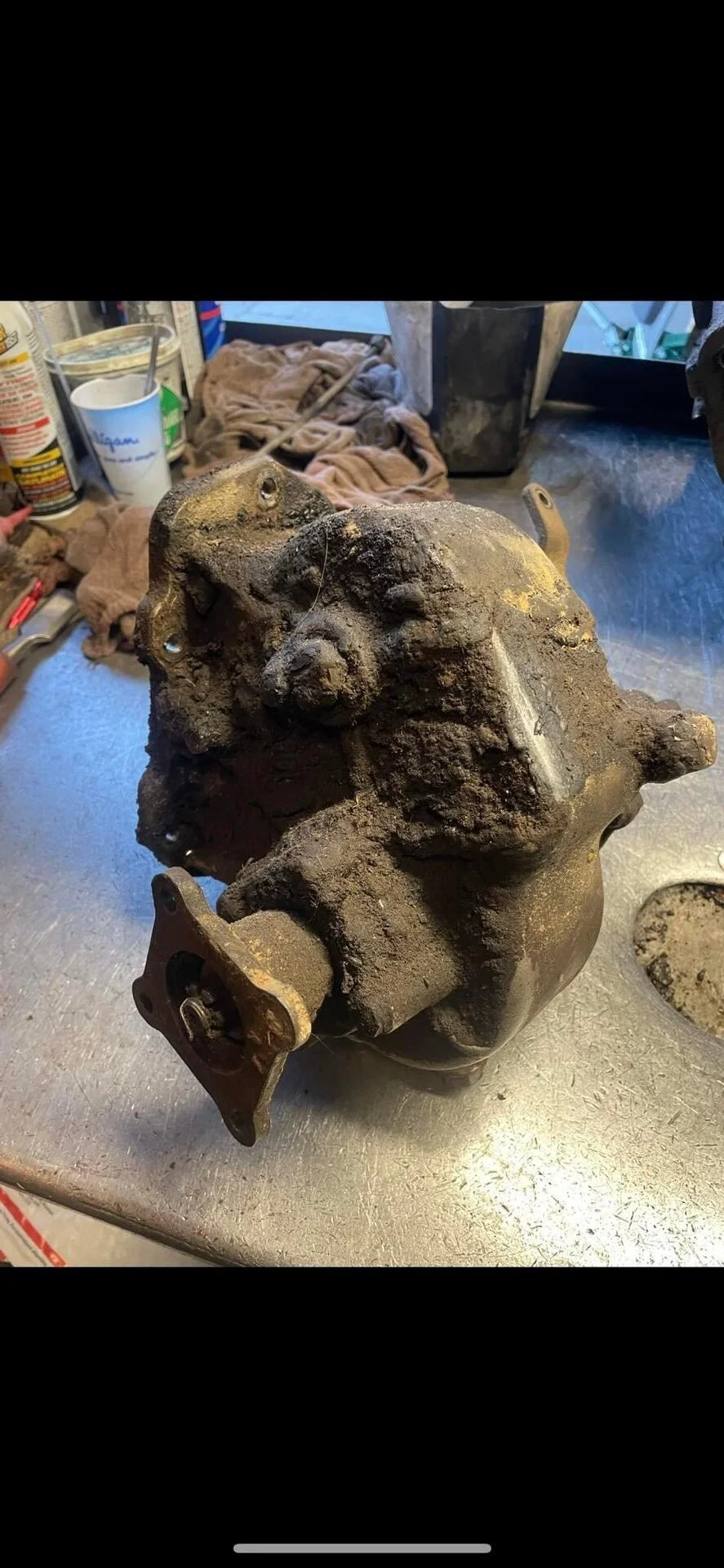

Drivetrain will be the known-good F135 I took out of the FJ45 (ran when parked) with a freshly rebuilt 3 speed and PTO via @orangefj45
This is the one I pulled out of his dads 45. I sent it out a couple months ago

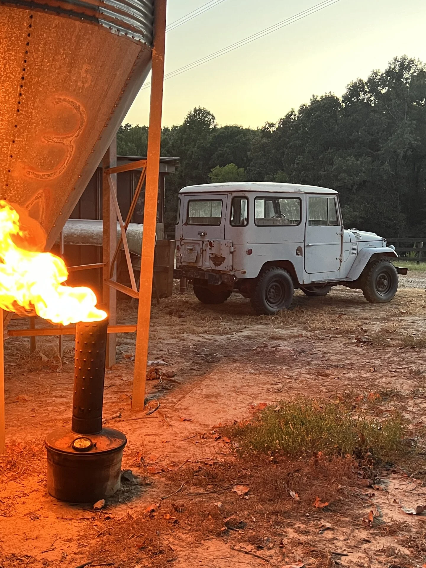

Yesterday I burned off some waste oil and made a final walk around of this thing. I moved the donor axles down from the main barn and pressure washed them. This thing has been sitting right here since January.
So today at lunch the Wizard came by and helped me move it around to the new shop.

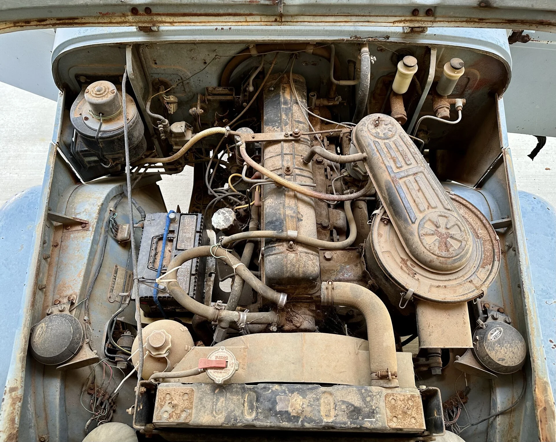

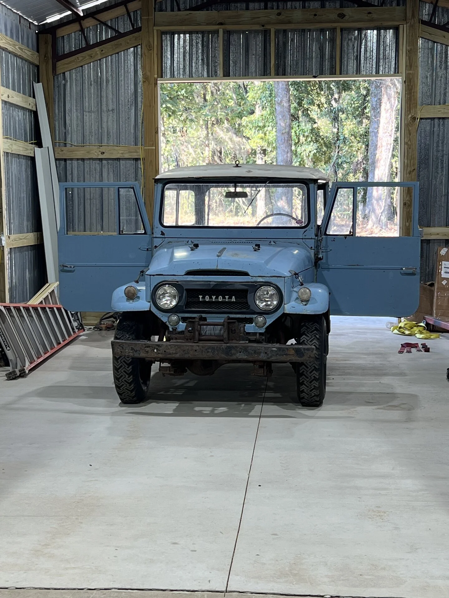

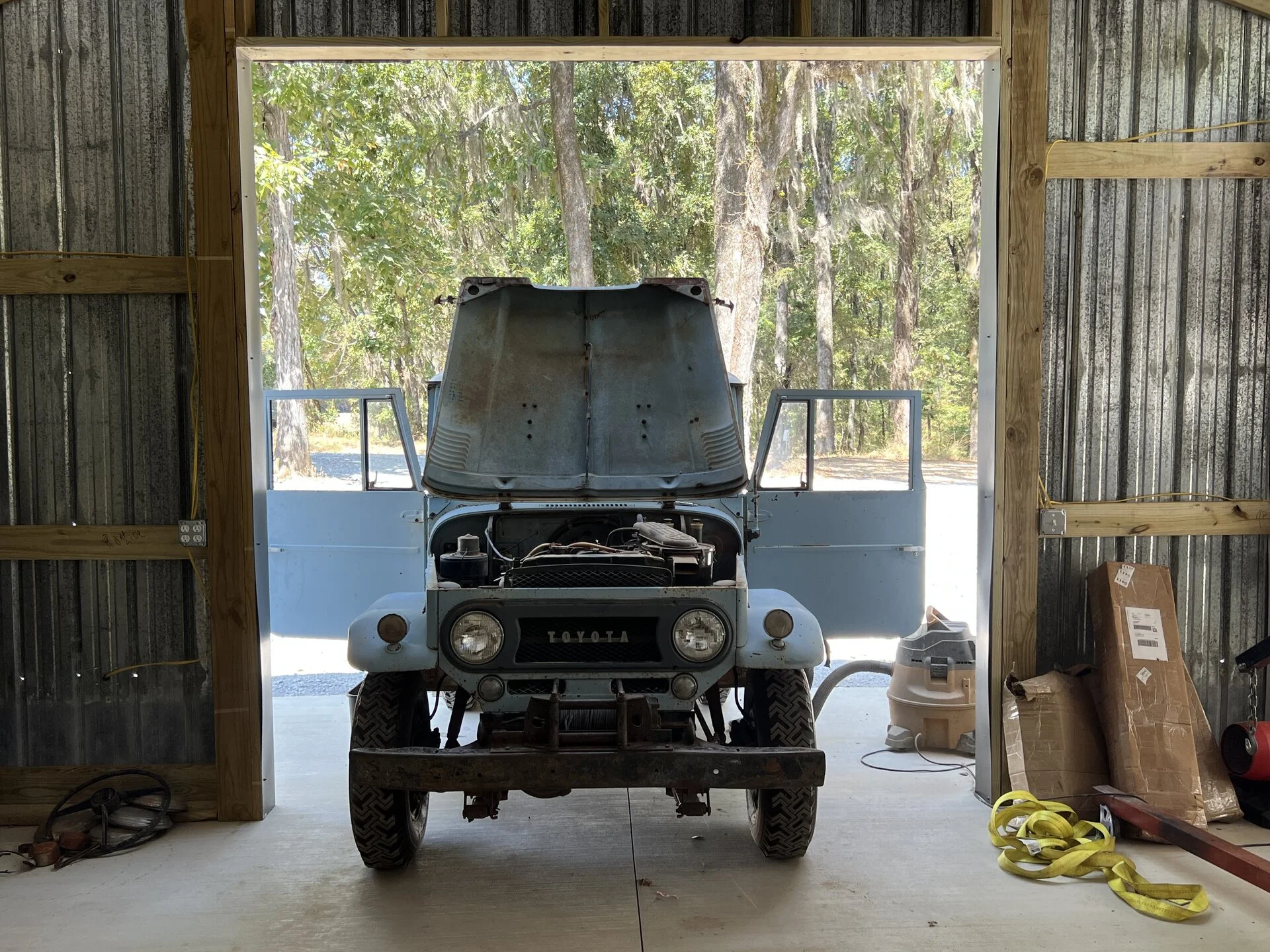

Here are some Before photos

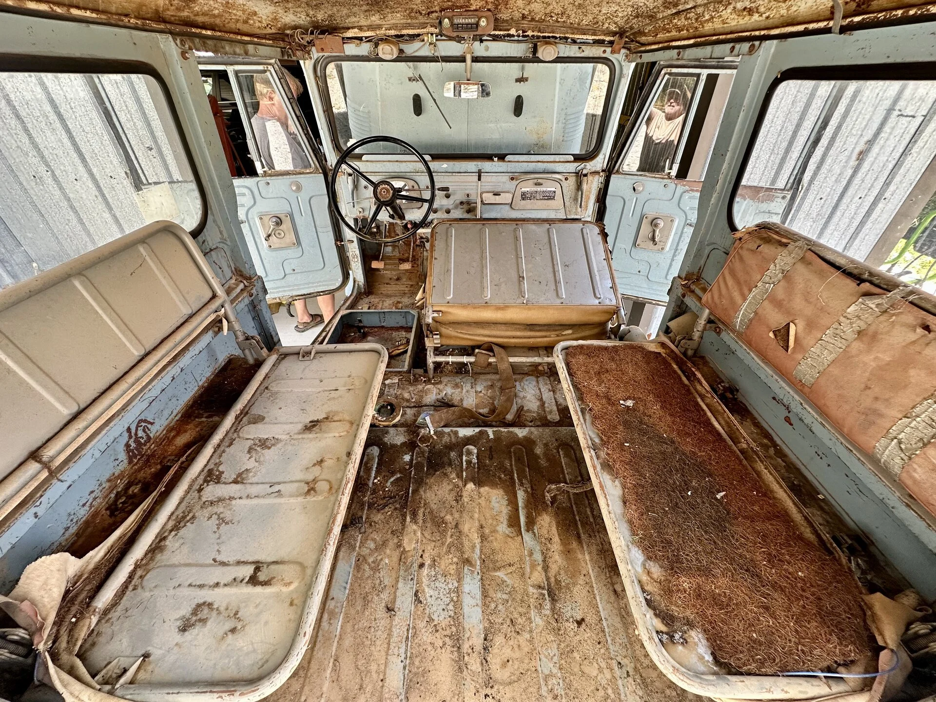

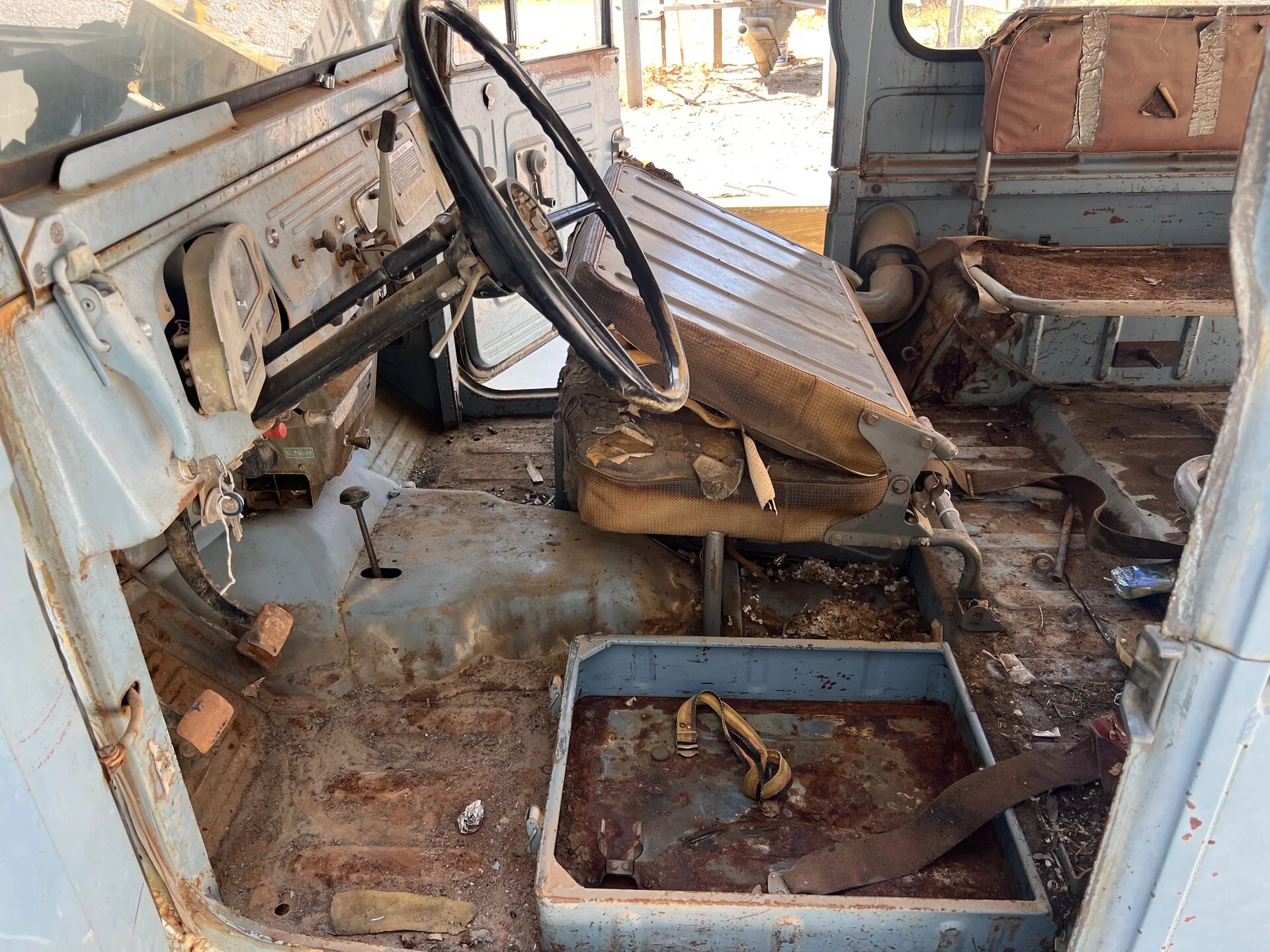

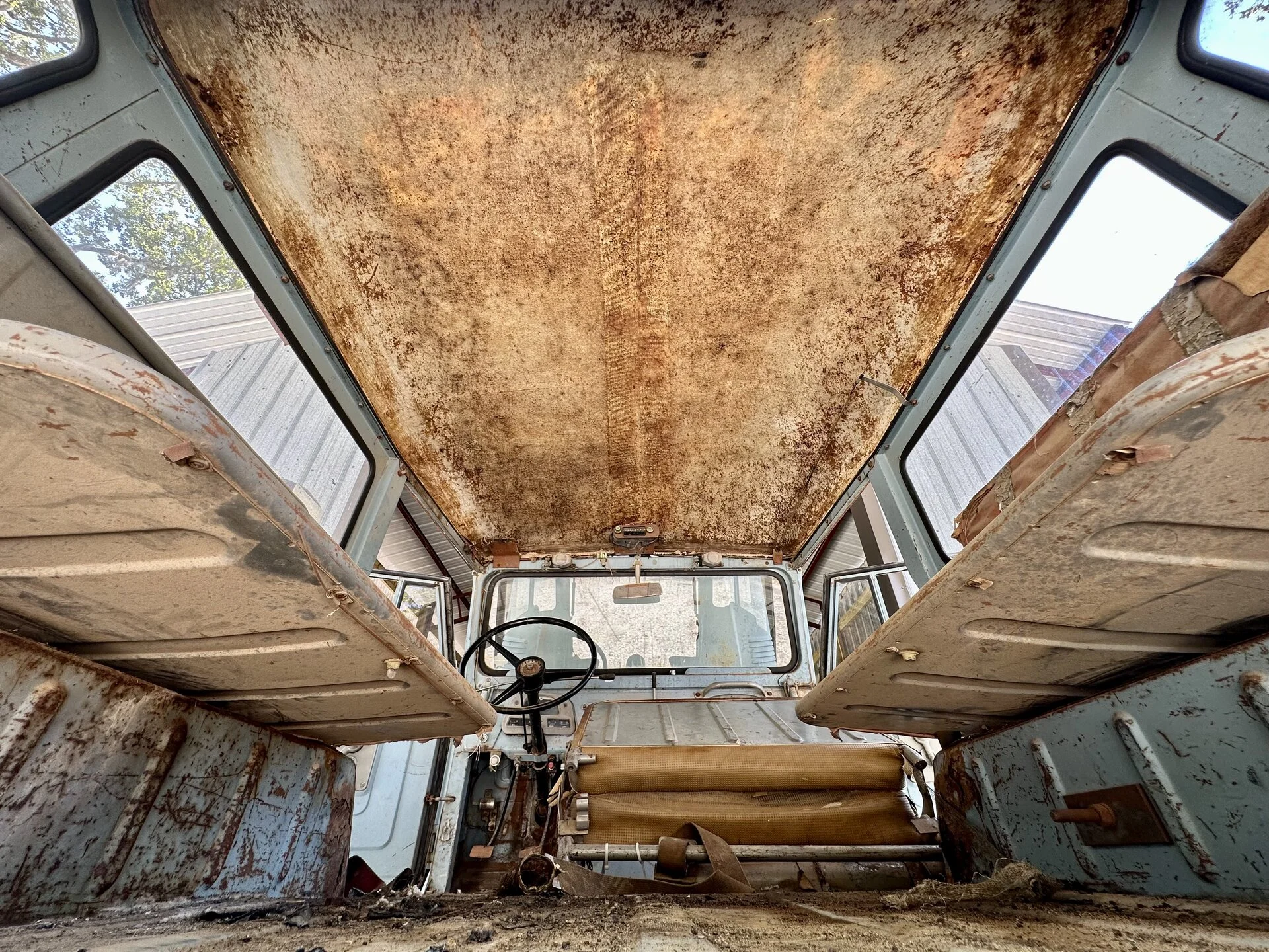

Step one on this thing is to clean it up nicely to see what I’m working with. I got about 1/3 of a Shop Vac of dirt and rodents out of it

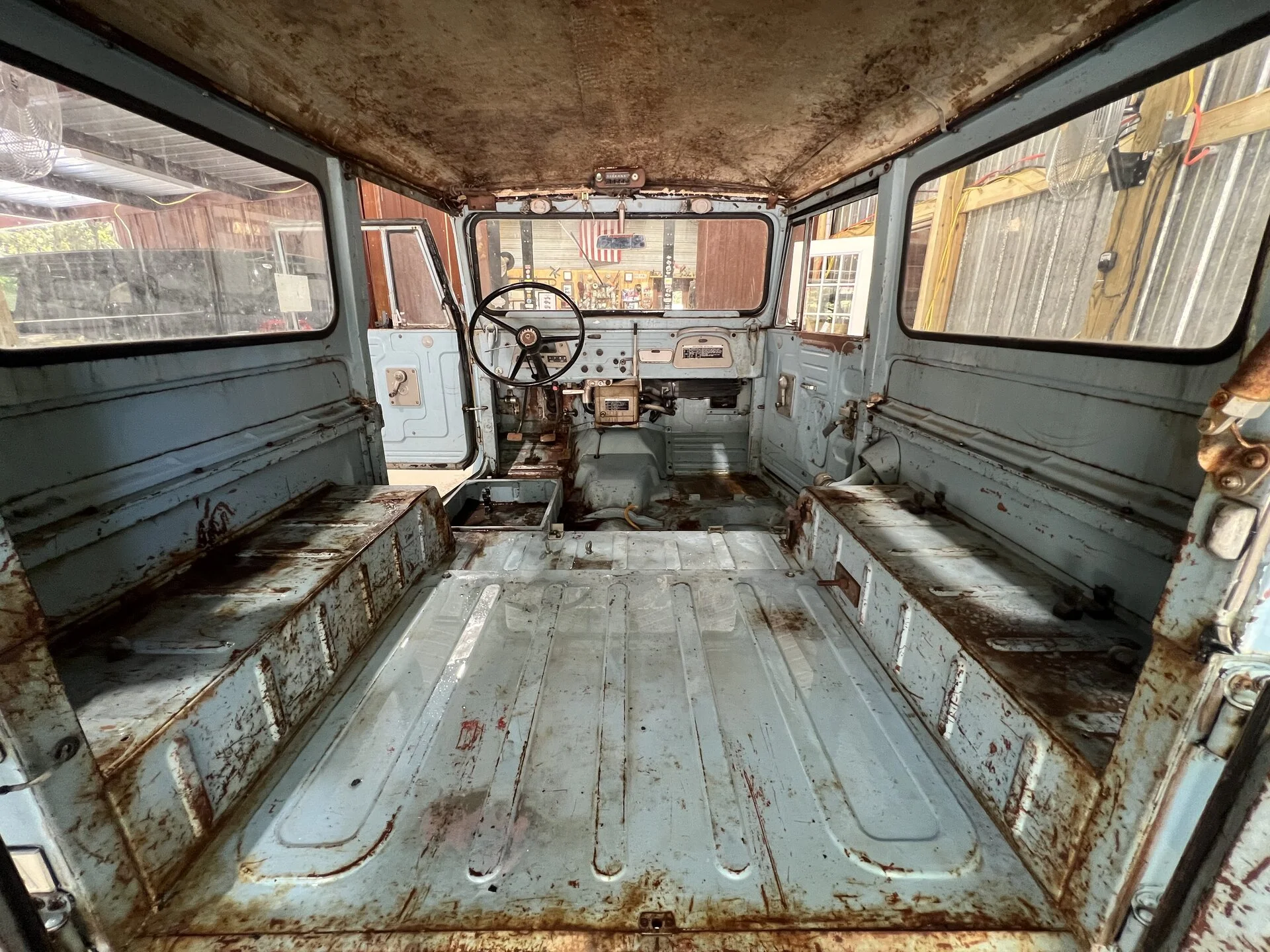

Next I pulled the interior out. Hosed it with Zepp orange

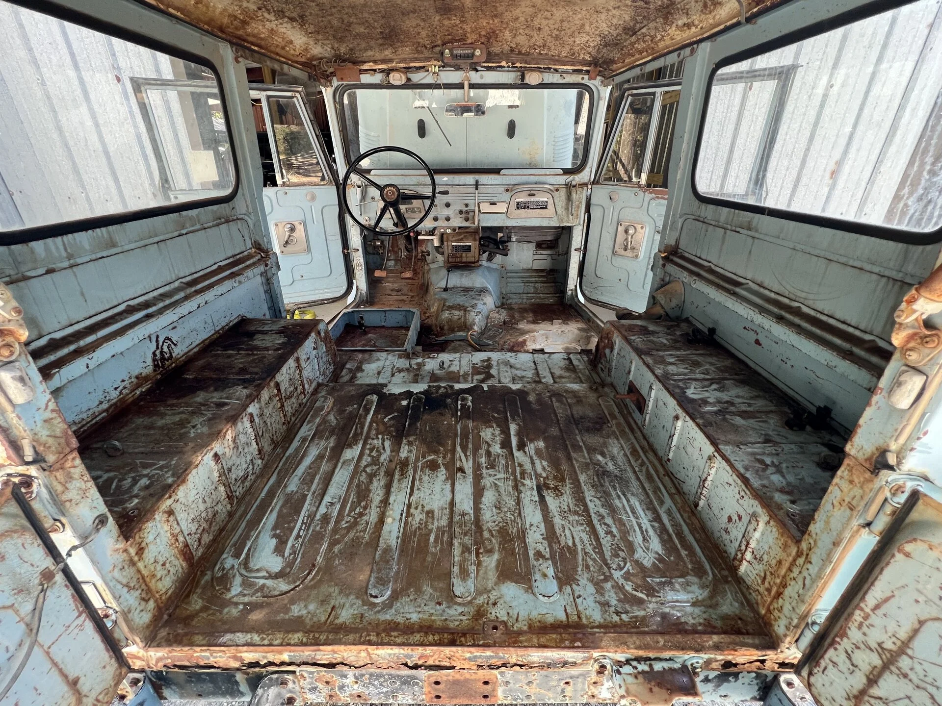

Then I took the pressure washer to town on it

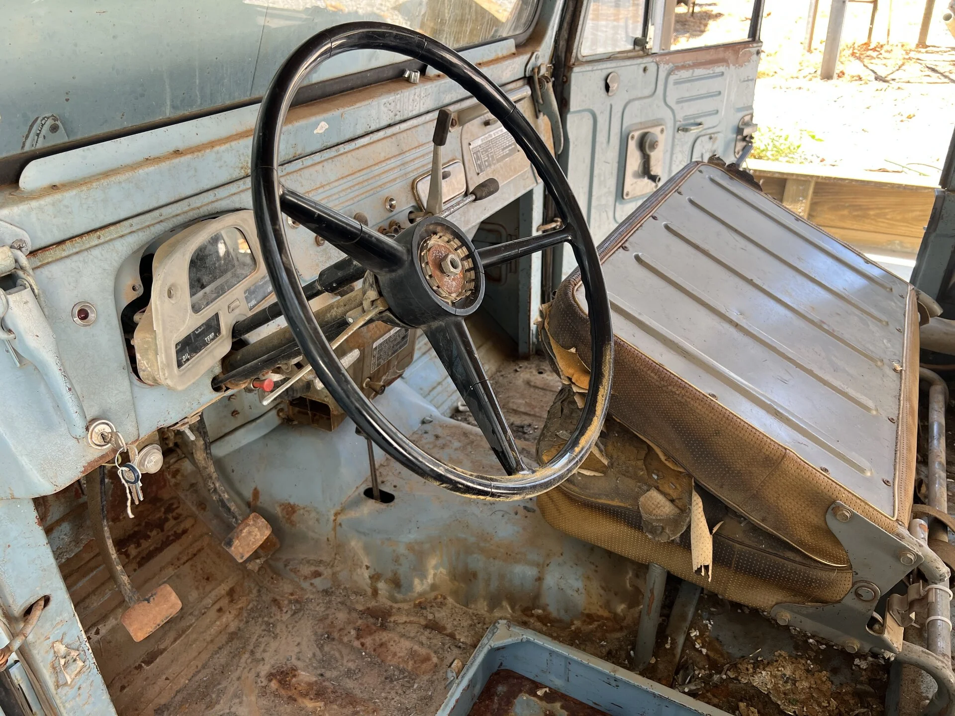

OG seatbelts cleaned up nicely as well

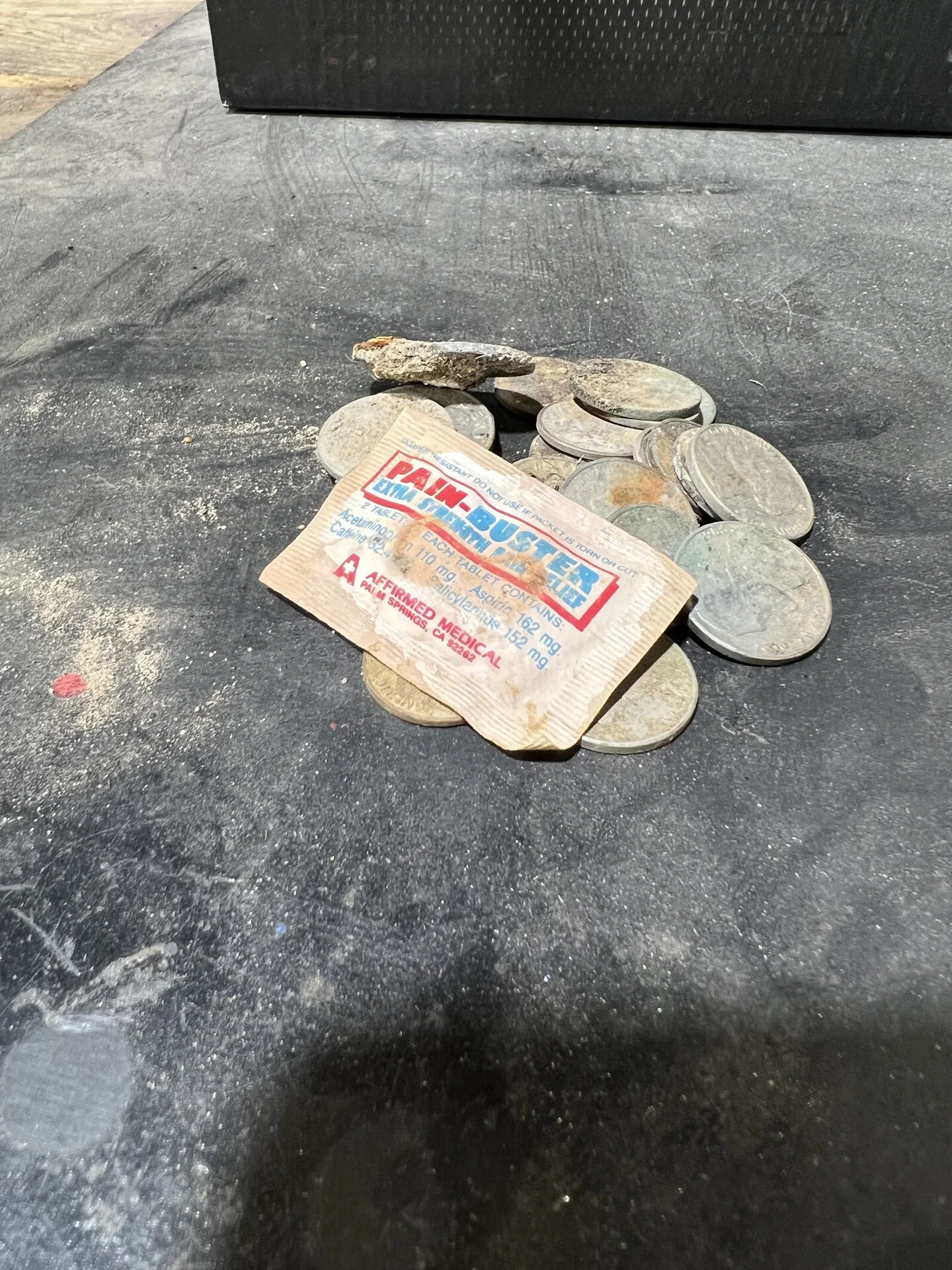

Found my bonus and even some .22 shells to prove this was not owned by a communist lefty

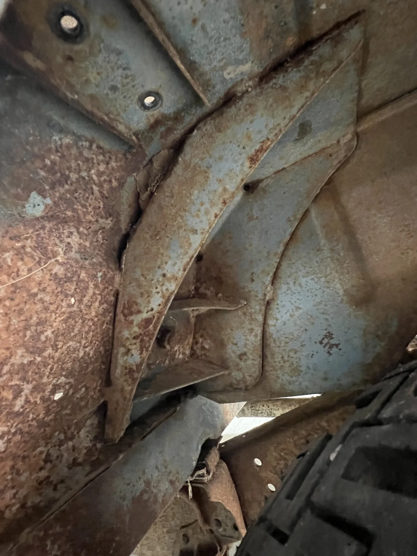

My initial impressions are good. Other than a rotten rear sill and some rot where these ridiculous brackets for the seatbelts trapped mud for 55 years, this truck is super duper nice and complete.

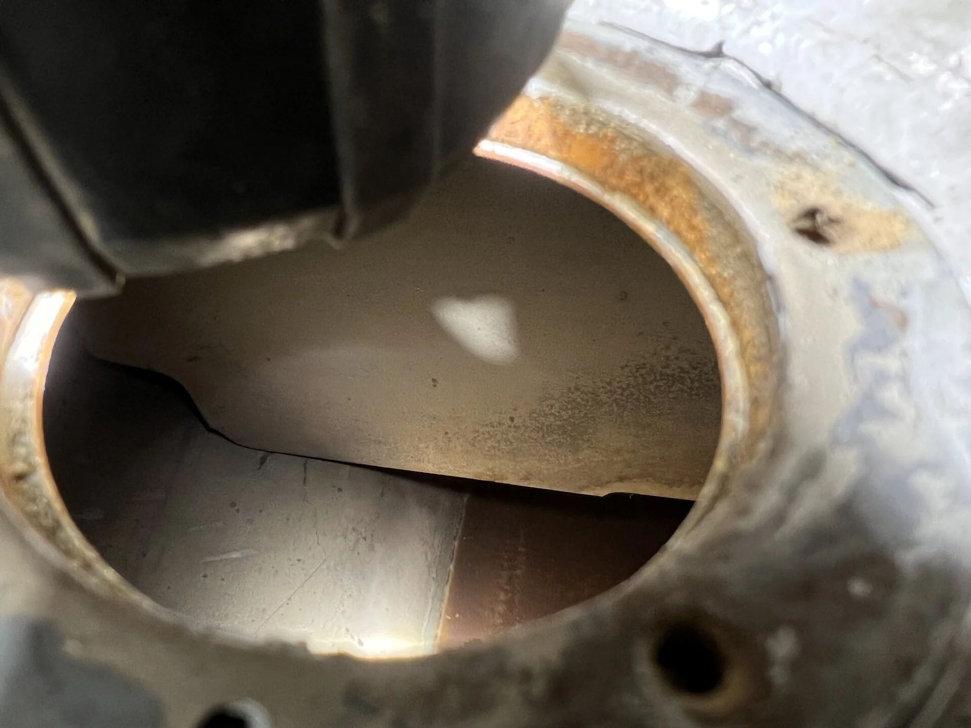

Gas tank is clean and rust free.

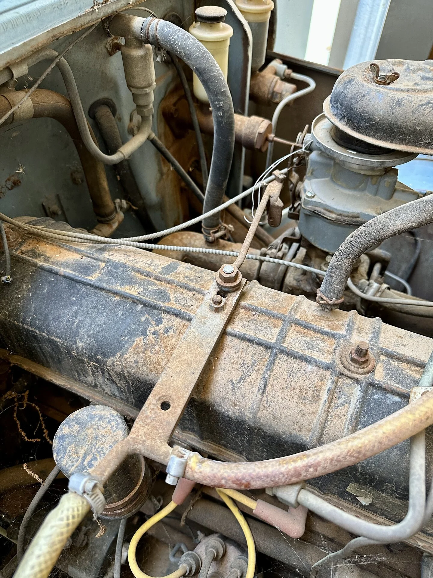

Always interesting to see how many factory components, hose clamps, bolts, etc still remain after 55 years. This one seems to have quite a few intact, likely hasn’t fallen into too many enemy hands!!!
Also, Looks like the owner procured his otc drugs from the company first aid kit!

I’m feeling like this one is nearly as clean as your new 45. The rear sill rust is weird compared to the rest of the truck. I’ll get the Wizard to stitch in some metal there.
The fender support things are a FJ55 level nightmare. Can’t believe those things existed. Mud trap.

I need a properly patina’ d front bezel of the correct color if anyone has one in their stash. This dark one is killing me
