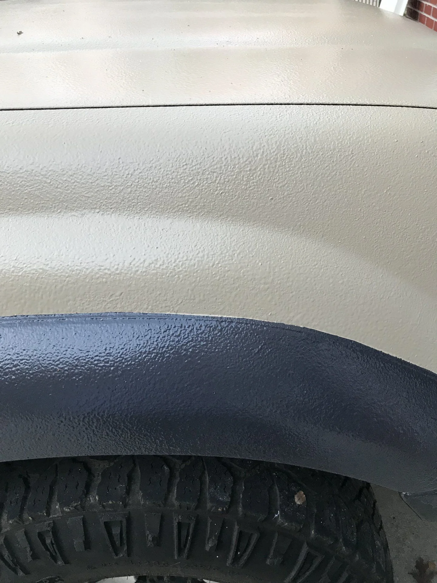

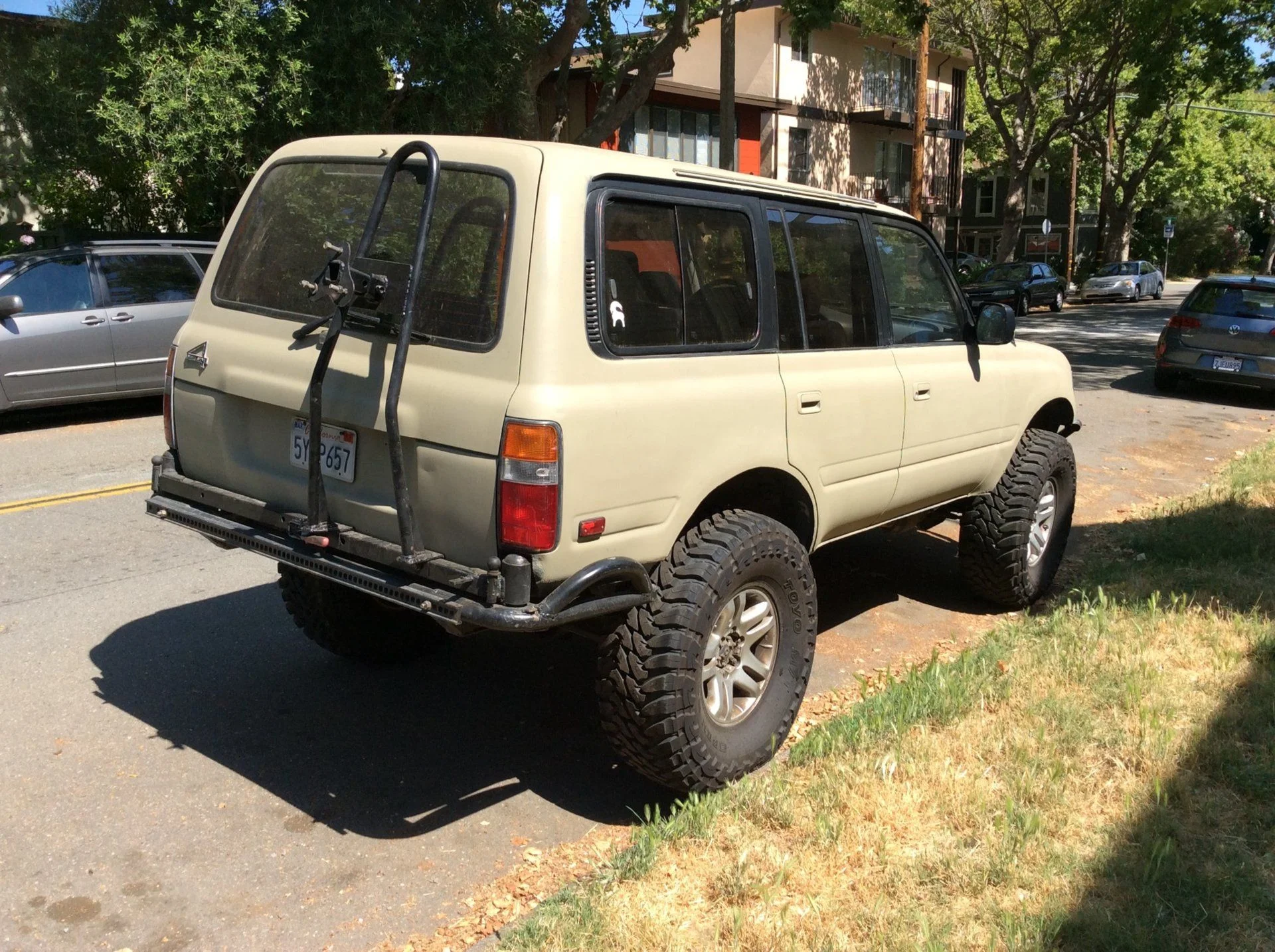

Go to the Line-X shop and see if they will give you any contact info for anyone they have sprayed a similar color to what you want that is 2 or 3 years old. I love my Line-X, texture has held up great, very tough, very good adhesion, etc. But the silver color faded. They said they have had problems with silvers in the past but had replaced all their equipment and base, but mine still faded.
I will likely get it redone in a color similar to what you are thinking, but it will be a while and I am sure will be a huge pain in the ass to get off. lol.
2012
linex-jpg.590029
2016
dsc00499-jpg.1064645

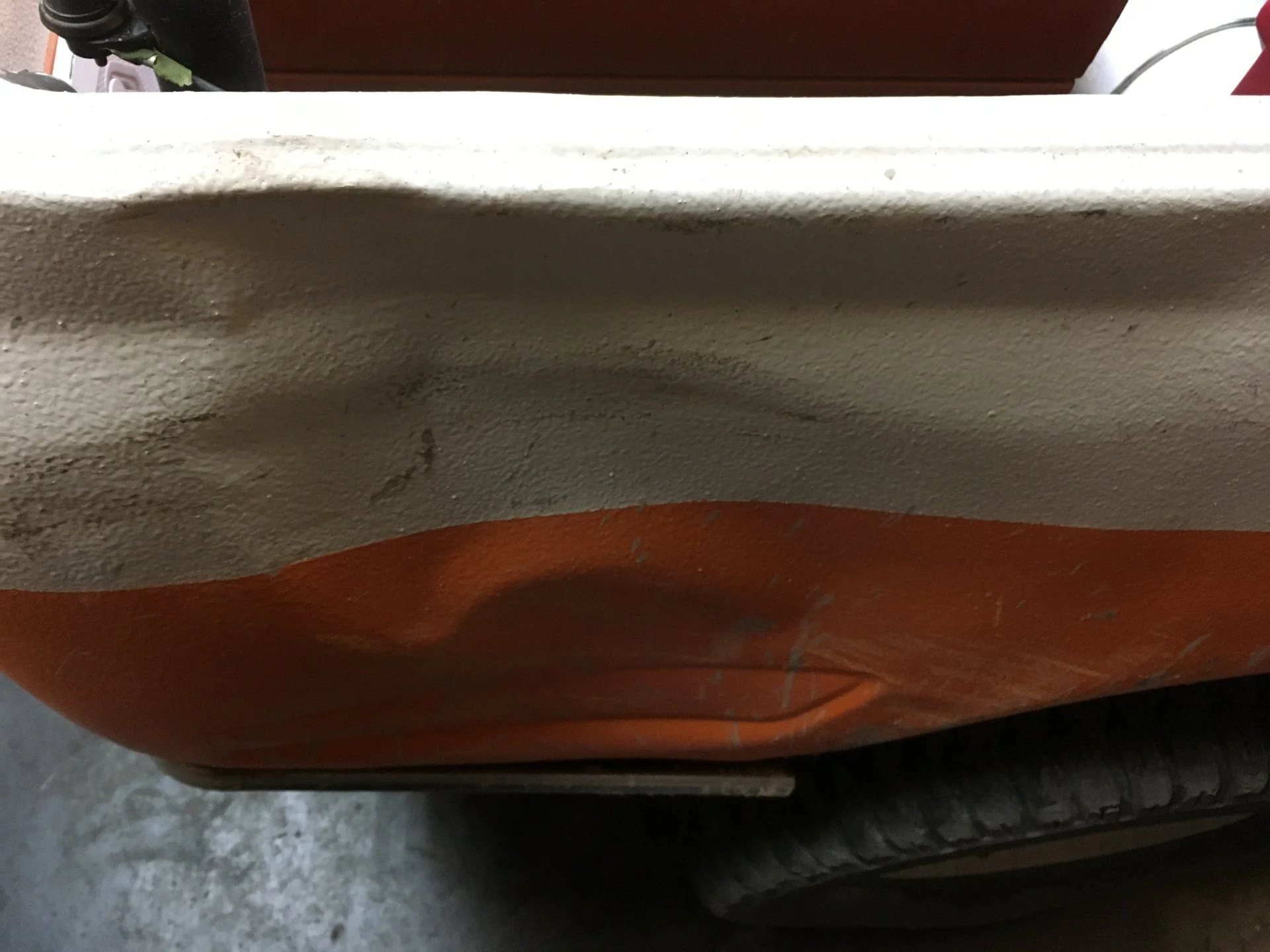

Here is after hitting two trees and pivoting on another.
img_8892-jpg.1544620
After a little porta power action....
img_9157-jpg.1578419

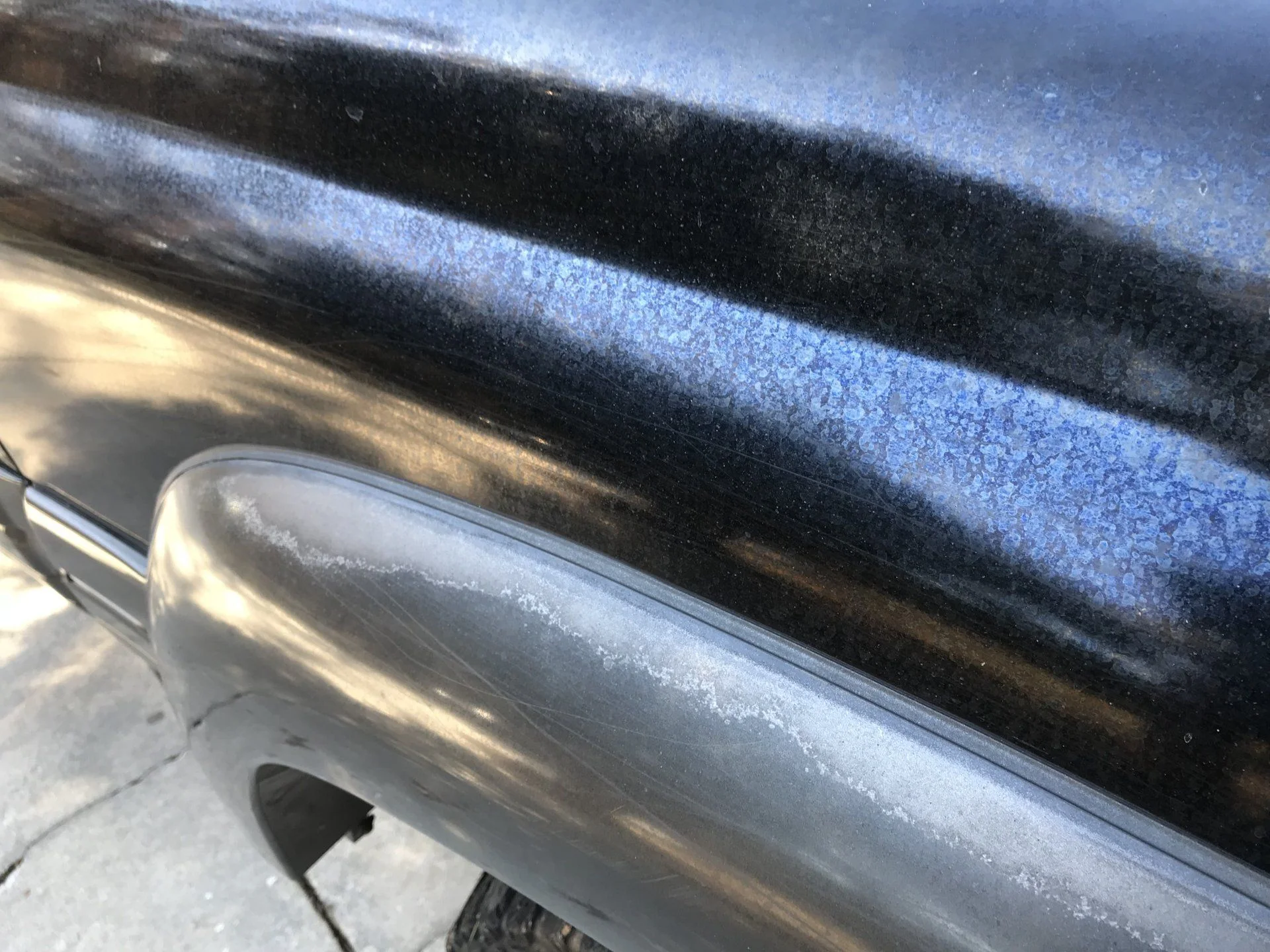

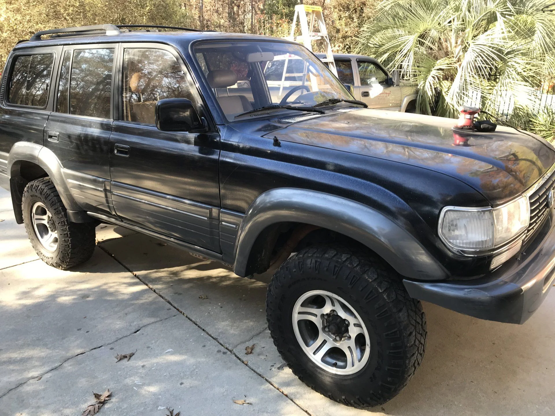

My beater 80 was lined several years ago, it’s flaking off and looked like complete s***. My body guy wouldn’t mess with it without charging a ton to remove it.... I eventually rattle canned over top. If you have to do something, just use paint....
@beefjerky What liner was used, and was it DIY or done by a shop? I'd be curious to know about the prep that was done.
@dirtyboots Thanks for the reference. I've not seen the paint and body thread before and for some reason it wasn't coming up in my Google searches.... I'd seen sound deadener showdown before but forgot about that site. Will definitely be checking that out again before the interior goes back together.
Good stuff guys! Keep it coming!
Not sure on the details on mine. It was that way when I bought it.... when I saw it was flaking and peeling pretty heavily I figured it would be pretty easy to get off with a pressure washer. It wasn’t! Lol

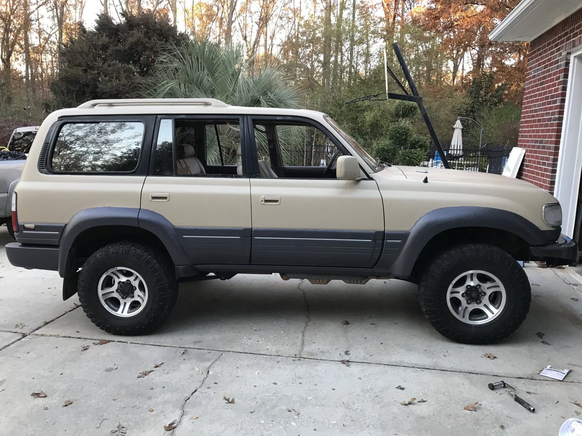

6-7 rattle cans of rustoleum Ultra Flat Khaki have held up surprisingly well. going on 3years since 1st application and mine sits in the California sun 24/7. roof and hood may need a 1can touchup but that will take all of 20min and a simple rinseoff with a hose as prep. Ultra flat goes on real flat with No streaking.
Real happy-real cheap and definitely looks about 1/10th as “ghetto-liscous” as the “ i just bedlined my rig beside my doublewide with a paint roller -bedlined-look. :)
Sorry- but bedliner looks like ass. Id definitely spend the $38 for 6 cans of this.....and in 3years if you still aren’t digging it....you can always blow your wad of cash on a fancy shmancy white trash bedliner of choice and go drink PBR’s down by the river with Scotty And the bedliner-boys :flipoff2:
