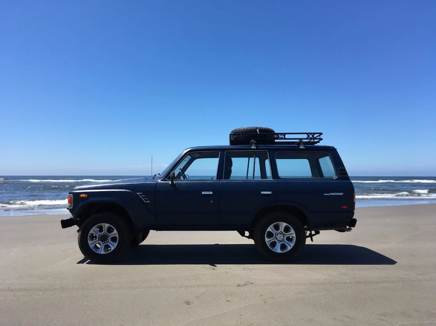

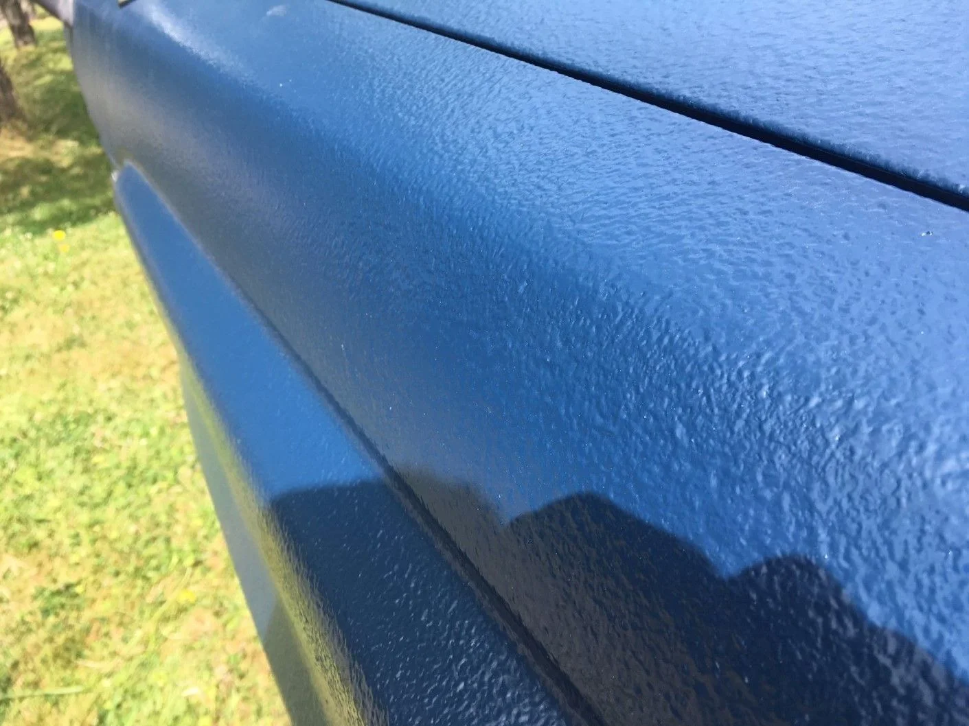

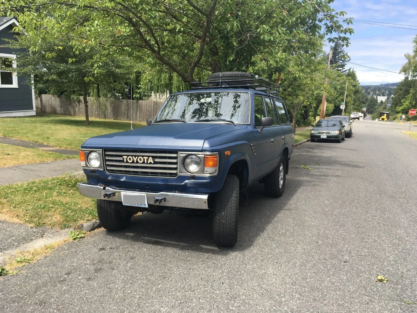

Pulled the trigger and monstalined the rig this past month, now just getting around to posting photos. I unfortunately didn't take photos of the entire two week process.
Took 3 Gallons + 1 Quart, 2 coats, color is Midnight Special. It looks maybe a shade lighter to that dark blue cruiser color that the 60's have. Texture came out great. I was worried the color would be too light but I love it. All in after brushes/mix buckets/extra tape ~$600.
Originally I was going to paint the doors off the truck on some sawhorses, but after applying the texture to the interior of the doors I was worried that gravity had an effect on the texture, so to match the texture of the fender/quarter panels the doors were painted a week later after hanging them.
I'd recommend buying two mini kits + six or seven extra rollers, as I used the texture sponge in the tight corners, to mop up drips, door weather rails, etc.
I used a new brush/pan/sponge for each coat, and kept some MEK around to loosen up the brush when going back to it after rolling.

Looks great! Ive been trying to figure out a way to match the 80 series nightshadow pearl, but decided midnight special is going to have to do. Glad to finally see some good pics of it on a cruiser :)

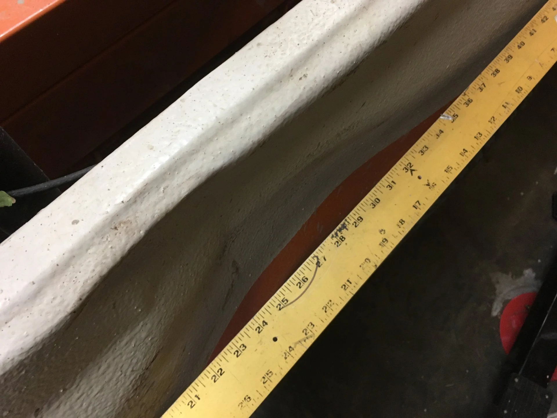

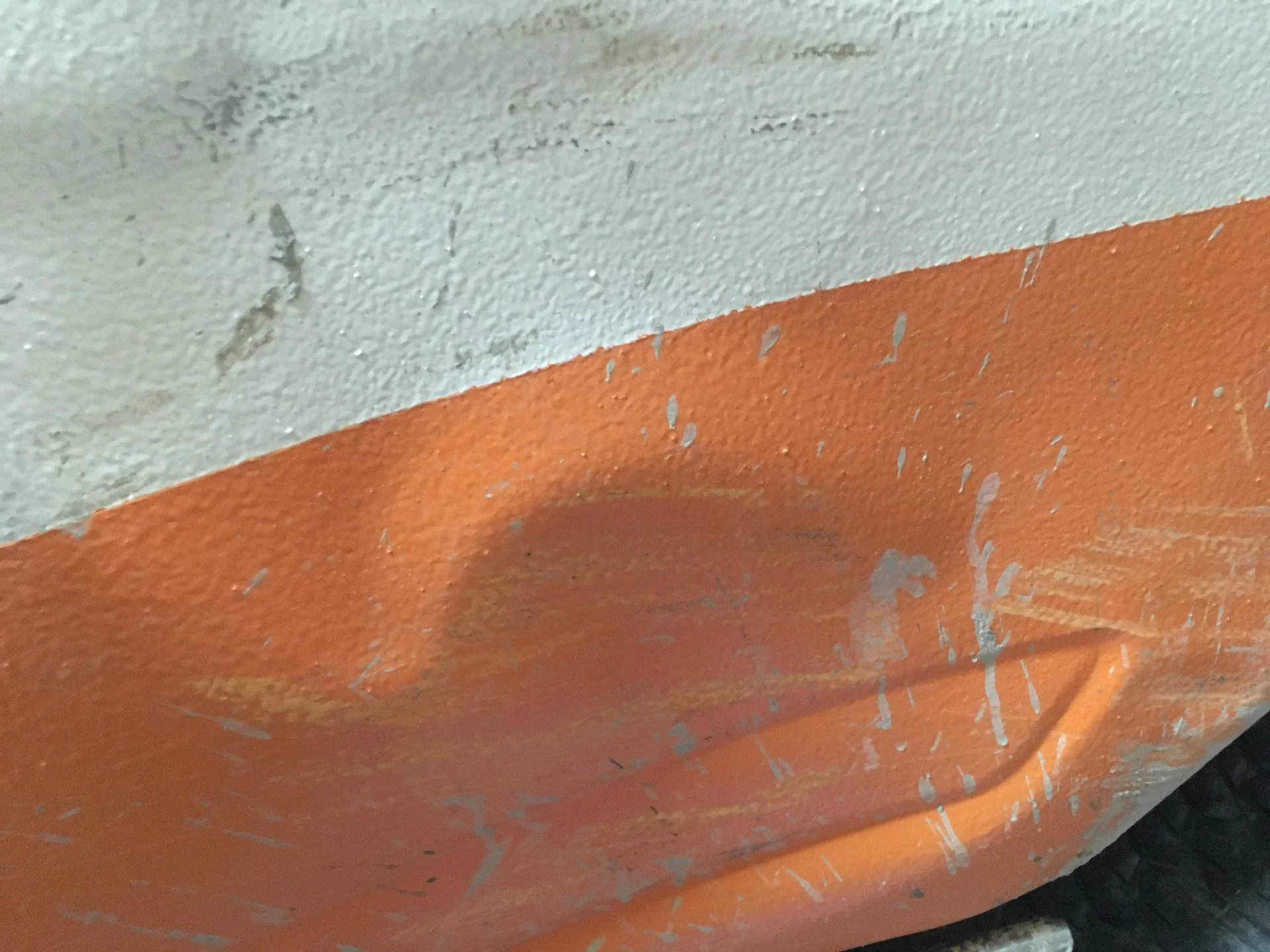

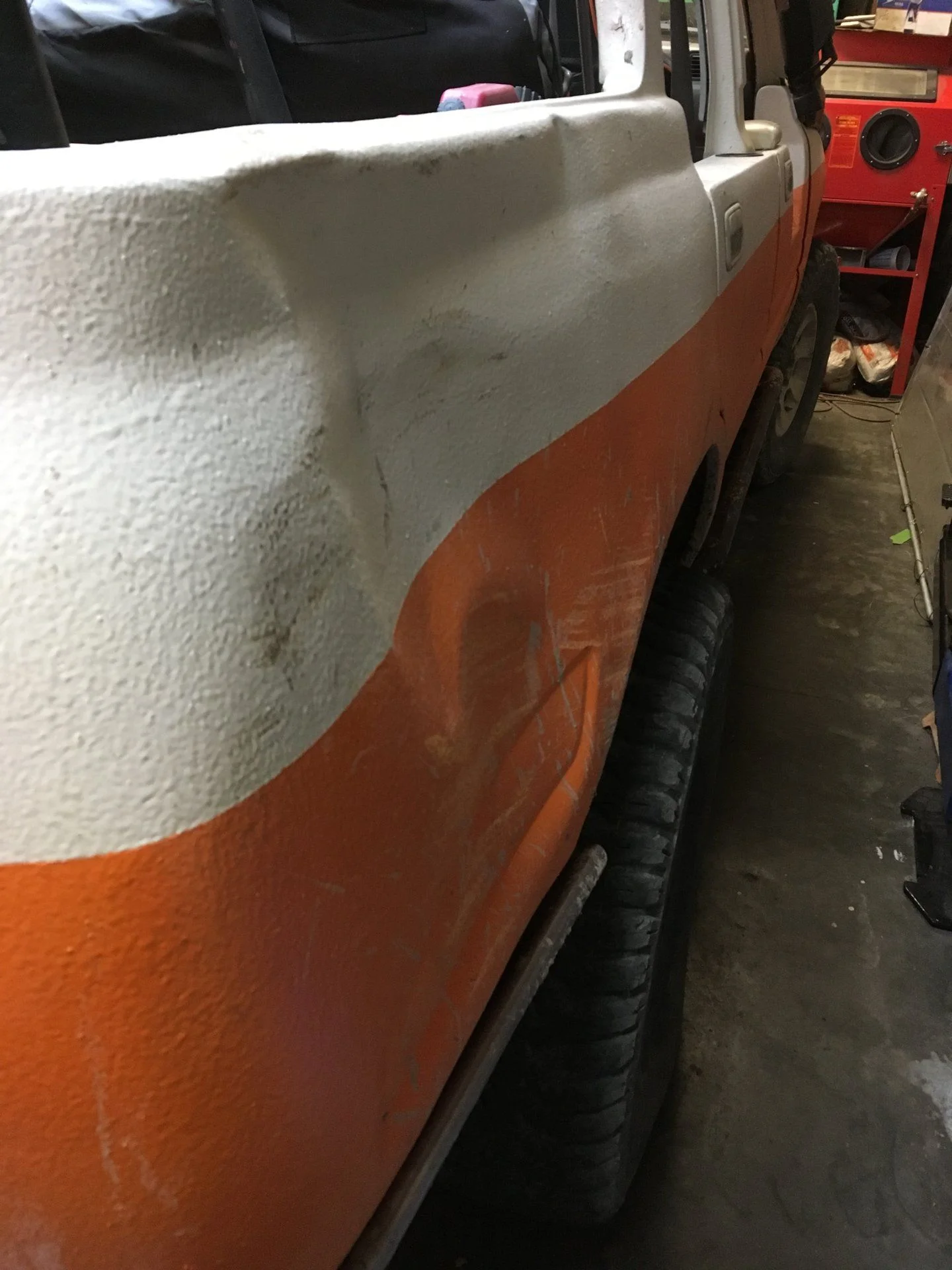

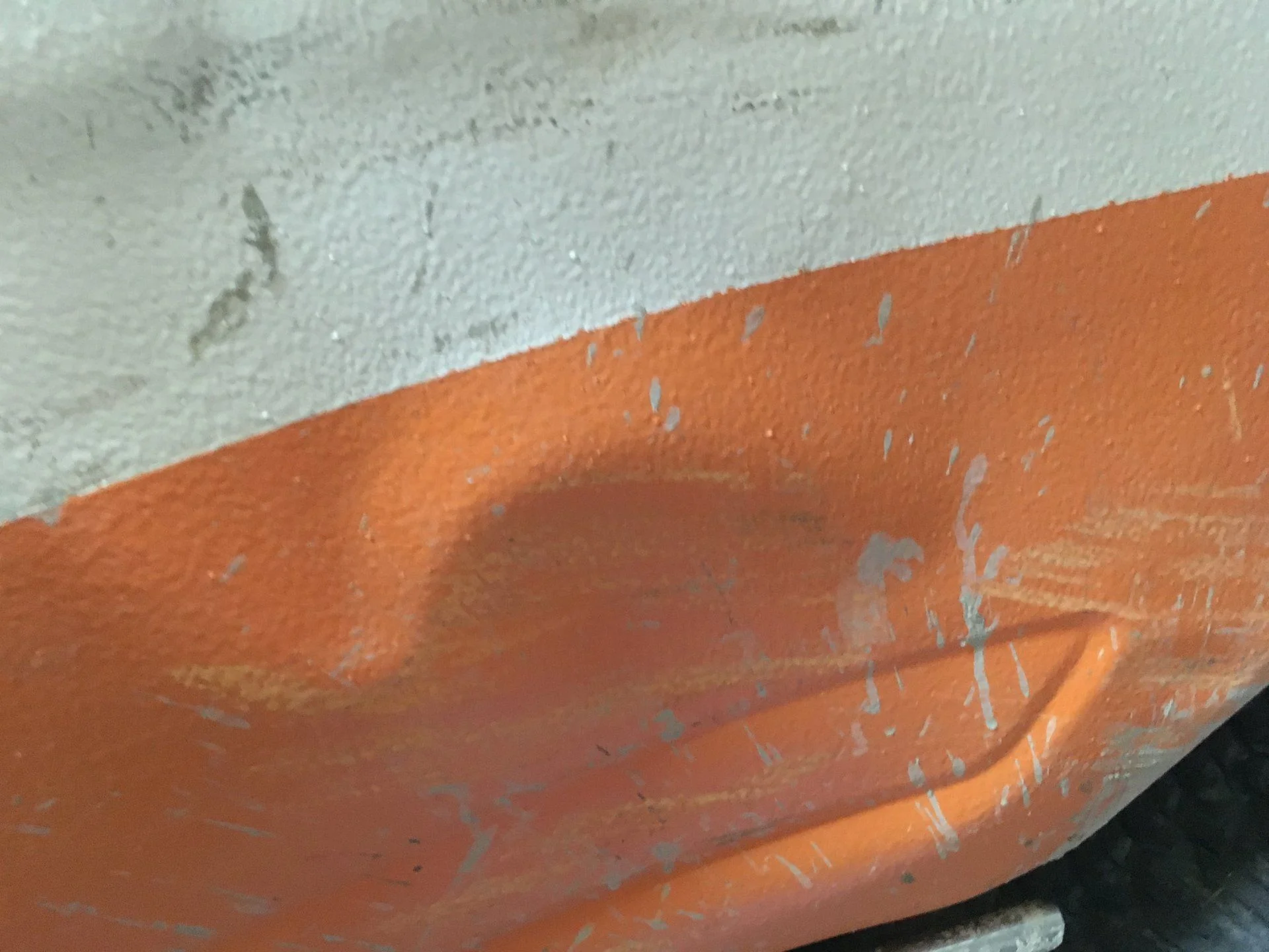

Here's how we're on March the liner puts up with some extreme damage
That instills confidence.
and at the same time no confidence in my driving abilities.... Actually this is two dents. The first one was way off camber bypass trail (imagine the actual trail), when the low side of the trail that i was trying to ride to get less camber, started to crumble.... Another tree was there, so I was pushed sideways into it and used it as pivot point.
