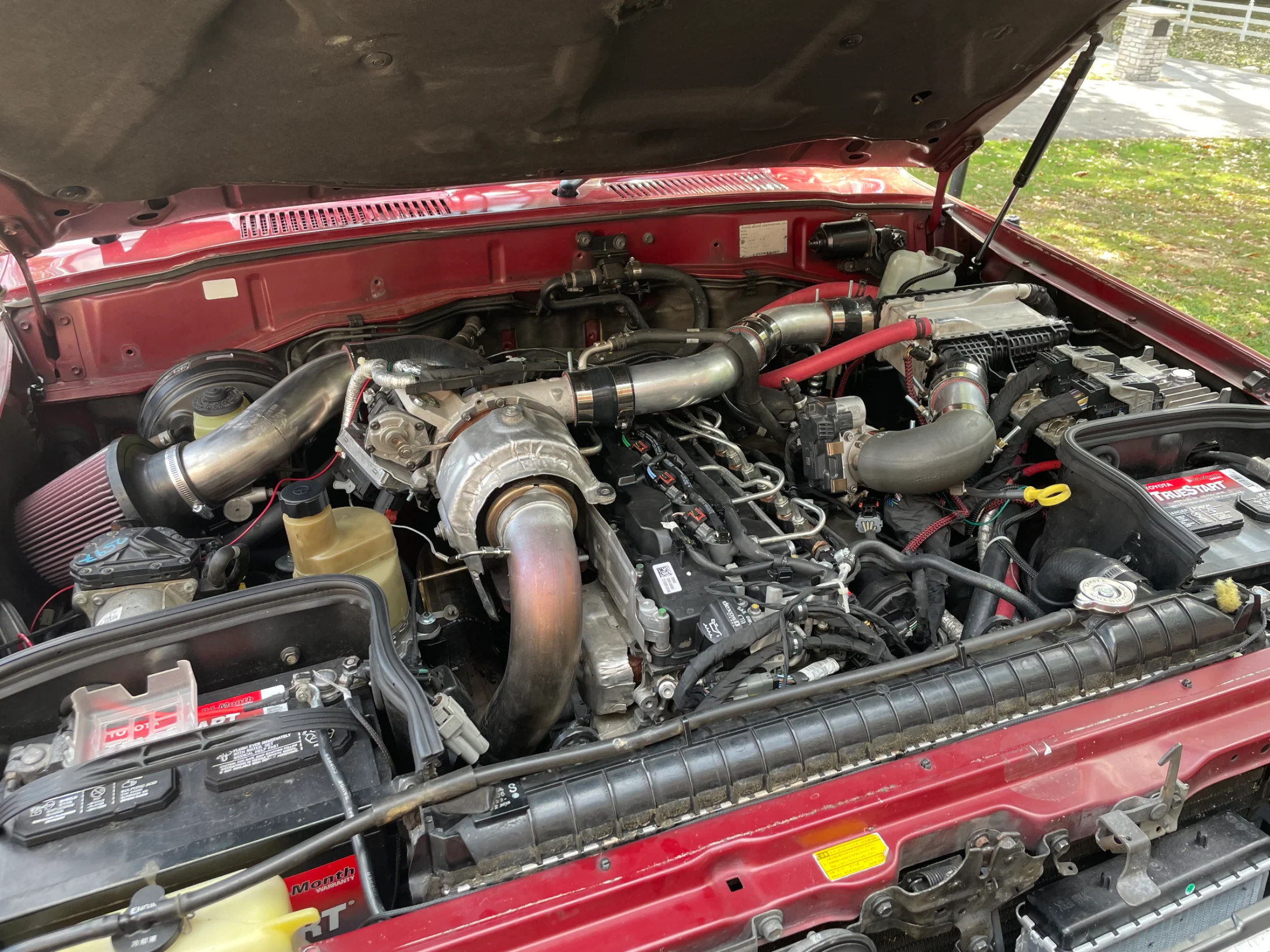

Ok small update, so I pulled a 2000 pound trailer 300ish miles this weekend, 60% of it on the highway and it got 20mpg on the dot. And this was taken off GPS miles instead of relying on gauge cluster because it’s off a little. This was also on a “test” tune because I don’t have that completely ironed out yet. So I’m impressed with that, can’t wait to see what unloaded on the interstate will do.
Any tuning, mpg or parts install updates?
Hey thanks for asking, I have been fiddling with it trying to get it more and more better
I relocated the intercooler off to the side to help with intake air temps and to gain hood clearance
Added a EGT gauge that I had on the 1HDT
Changed up my air intake. Went from a 4 inch that went to the passenger side to a 3 inch towards the driver side. I was having a problem with intake air temps going up which would cause boost levels to go down
I’ve been putting tons of miles on it and I’m averaging around 28 MPG around town
I haven’t had any long road trips yet to see what MPG I get on strictly interstate.
Haven’t messed with tuning much
Problems I have so far is with electric power steering pump not being enough to turn 37s. It works great if I don’t have any rapid movements on the wheel
I have a really nice 3d printer on the way and I’m going to start designing a power steering pump bracket
I also plan on getting rid of one of my batteries and going to a AGM. I think the alternator is having problems with lead acid batteries because of the smart charging system GM has but I’m not 100% sure
I also mounted a shifter from a 6th gen Camaro I got from swaptime. It has tap shift buttons on the side. lol bad thing is they are on the wrong side but I guess I’ll have to start working out my pinky hahahaha
But the shifter feels insanely good compared to the stock shifter with the B&M cable I was using
Also in that picture you can see my custom speedhut boost and EGT gauges I had from the 1HDT
How's the noise? Quiet?
