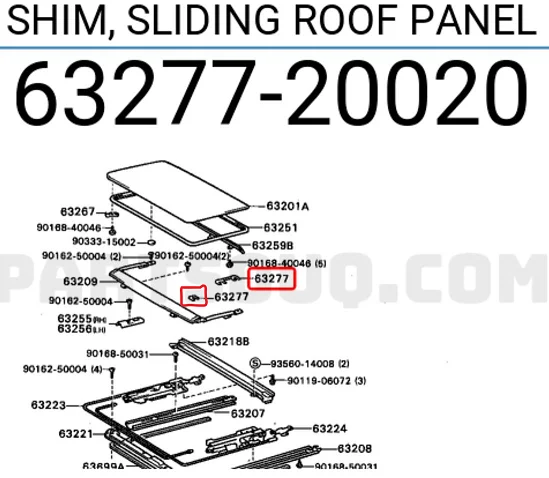

The glass (assembly) can sag allowing too much water to get past the seal, adding shims under the glass assembly (to push it upwards and closing the gap) may help. Also adjusting the position of the glass fore or aft may make a difference along with extra shims, you can test leakage using a garden hose.
Search for "Shim, sliding roof panel"
There are two types, Type A and Type B (short and long) and two different thicknesses for each, depending on position under the glass assembly
(or, you can pick up an assortment of U type shims from any auto parts store, Harbor Freight, etc)
63277-20020 (-20030, -20040, -20050)
