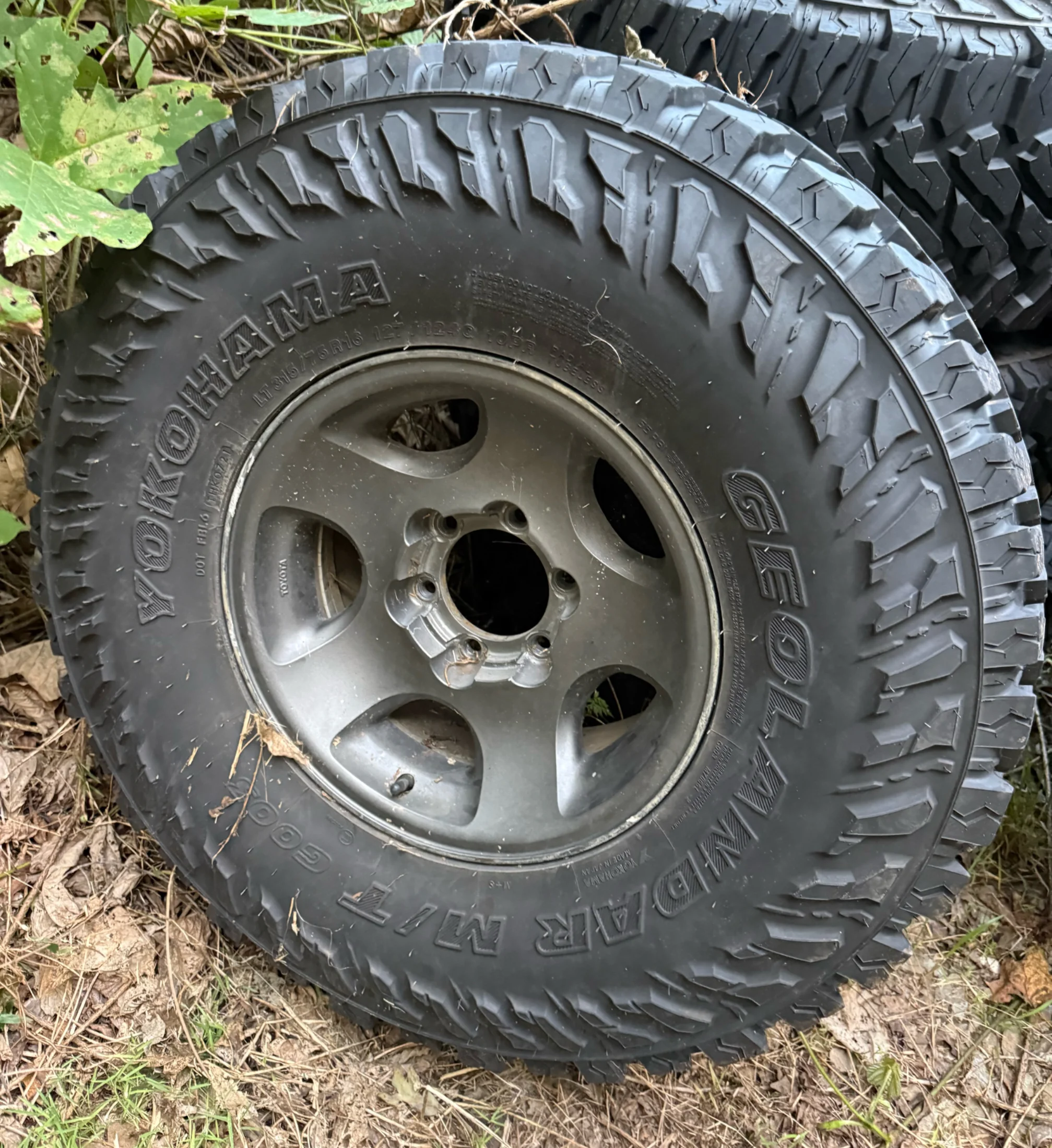

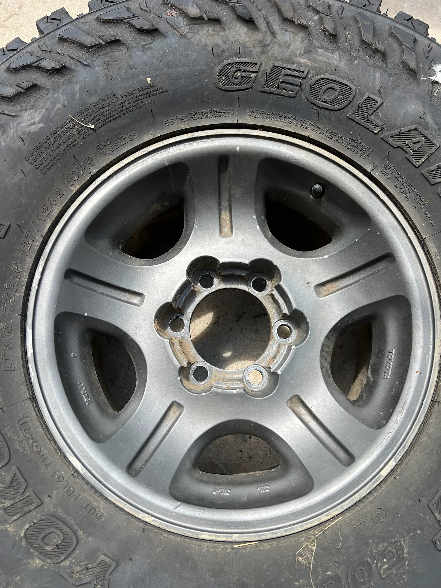

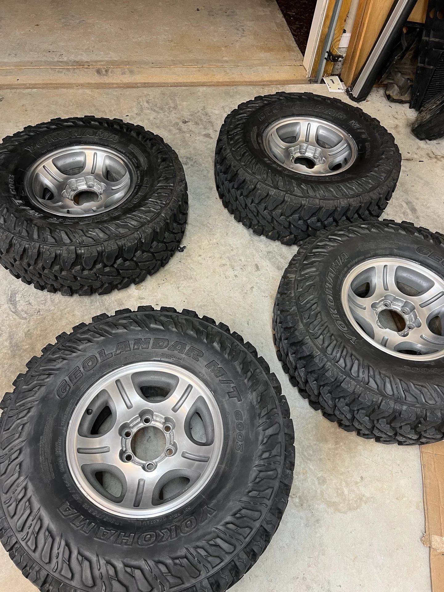

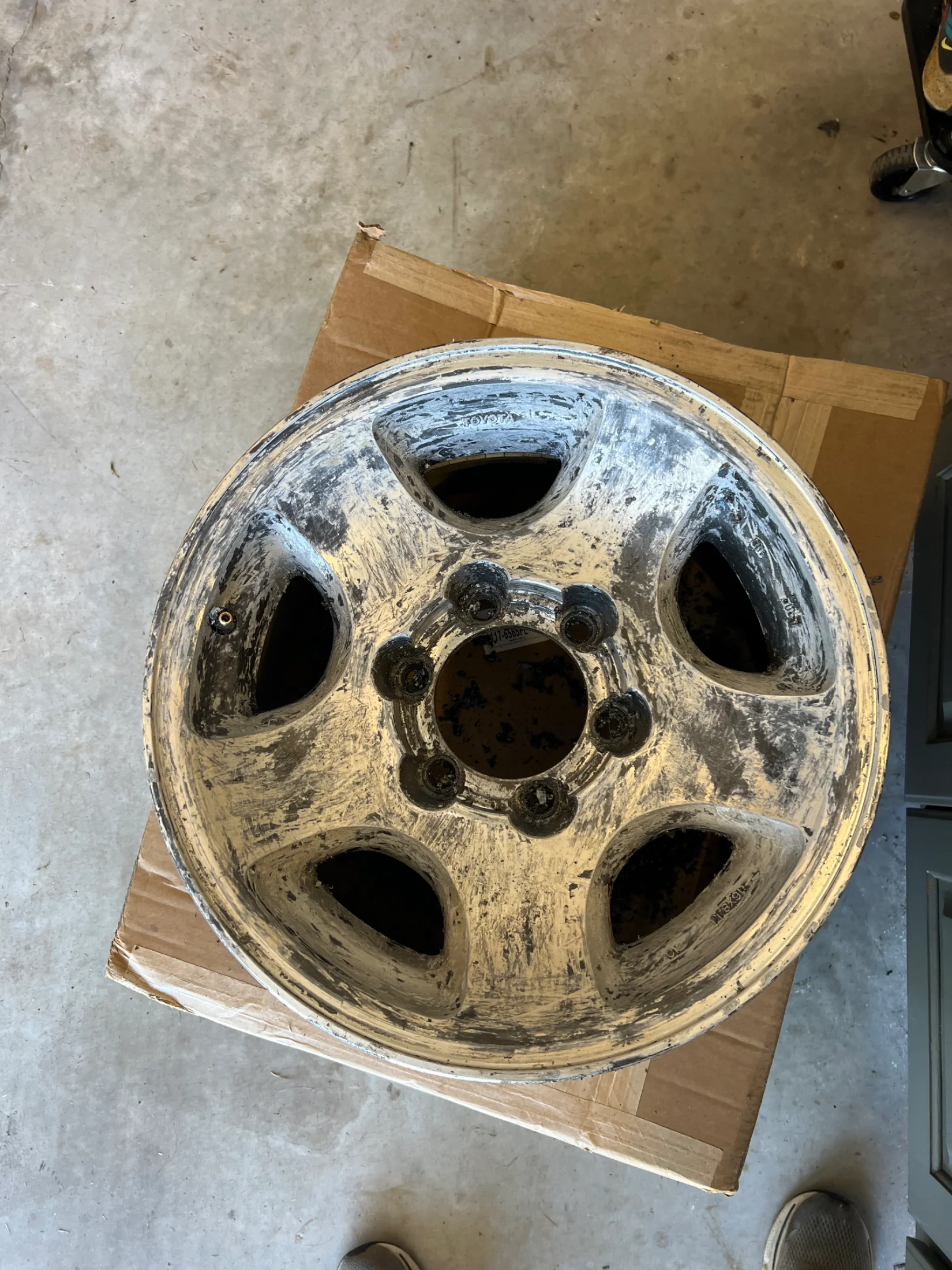

Hello! I finally was able to source some OEM LX450 Wheels. However, the previous owner did a poor job painting these. I would like to get them back to original if possible. What's the best way to do that? I know these are aluminum so the process may be different from what I've done in the past. Any suggestions? Thanks in advance!

Thanks! I'm familiar with sand blasting, but knew it would be too aggressive for the aluminum. Walnut shell is interesting, I'll see if I can get to my local harbor freight to source the blaster and media. If I like the bare aluminum look, would a coat of clear work to retain it?

You've got to remove the visible paint and also the coatings underneath to get to bare metal. My assumption is that the original clear powdercoat (I think that was used from the factory but others can correct me if I'm wrong) is still partially intact so may need to be removed once the visible paint is off depending on it's condition. The Lexus wheels also had paint in the D holes and those grooves.
My guess is that the visible paint will be the easiest to get off and may come off with fairly gentle solvents/strippers while the underlying coatings will be harder to remove and may benefit from media blasting or other techniques. I'm sharing that since you may want to try a few "easy" approaches on a spot first to get a sense for what it takes to get the visible coating off. If, by some chance, the wheels look ok under the paint you could possibly get away from a little cleaning and then clear-coat touch up on problem areas if there aren't too many.

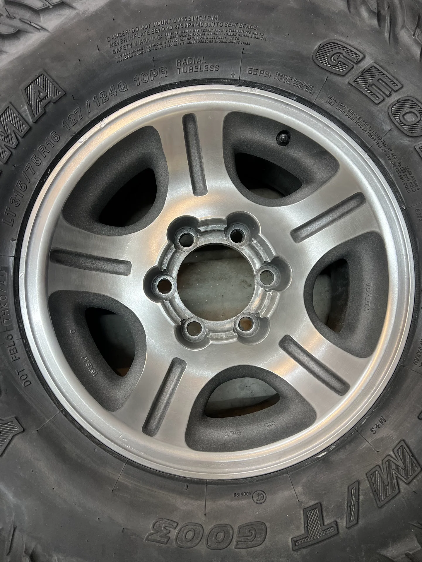

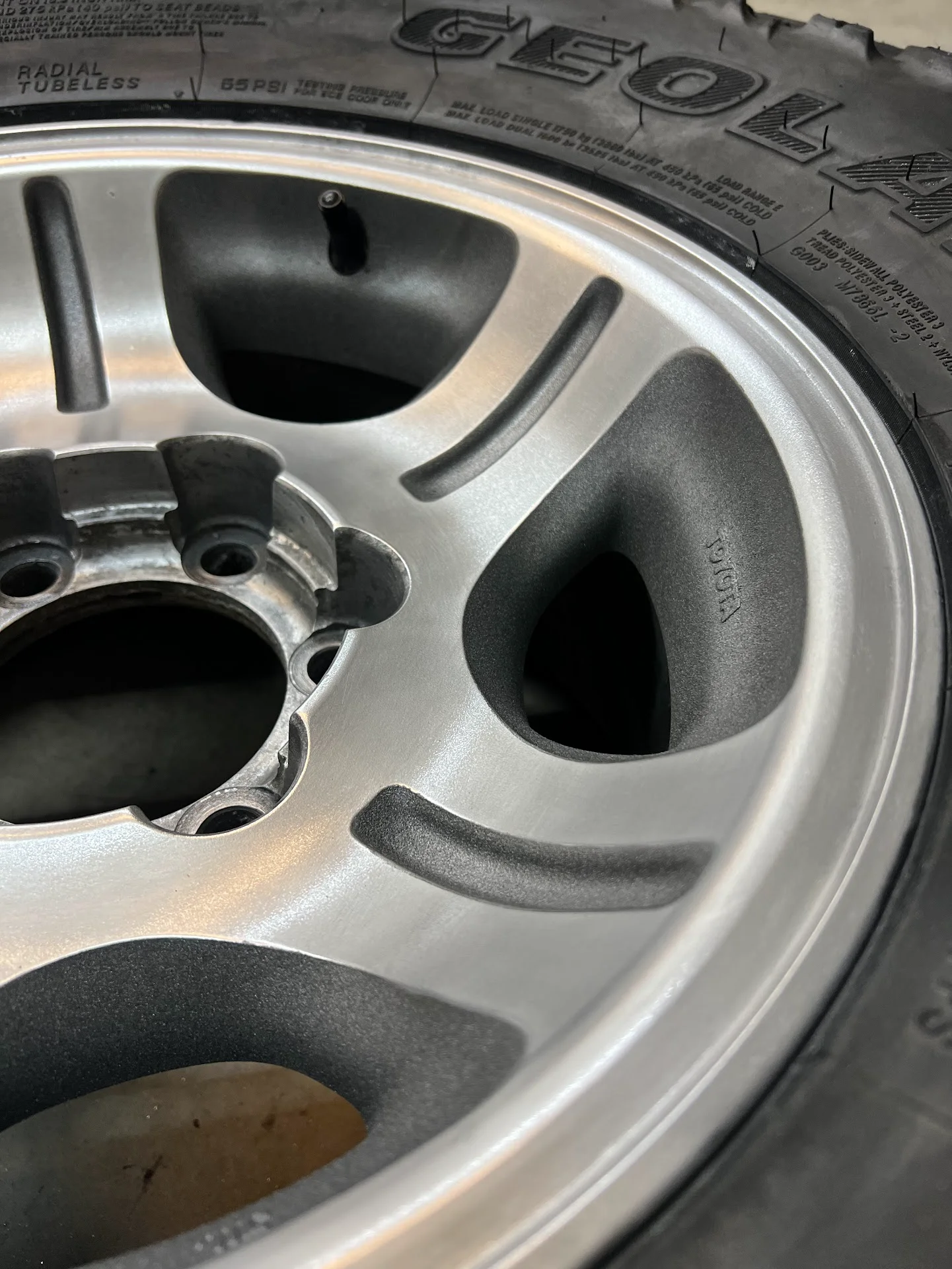

I practiced with the spare today. Paint thinner and sanded all the way down to 2000 grit. Mothers polish after. I think it turned out great!
I think I’ll grab some 2k clearcoat also since I’ll likely be repainting the LX450 wheels. I’ll have to figure out a good method to retain the darker inlays. I have some ideas, but curious of others. I’ll pick up some Metallic Duplicolor that I saw matches well to OEM too.
I’ll post results here.
