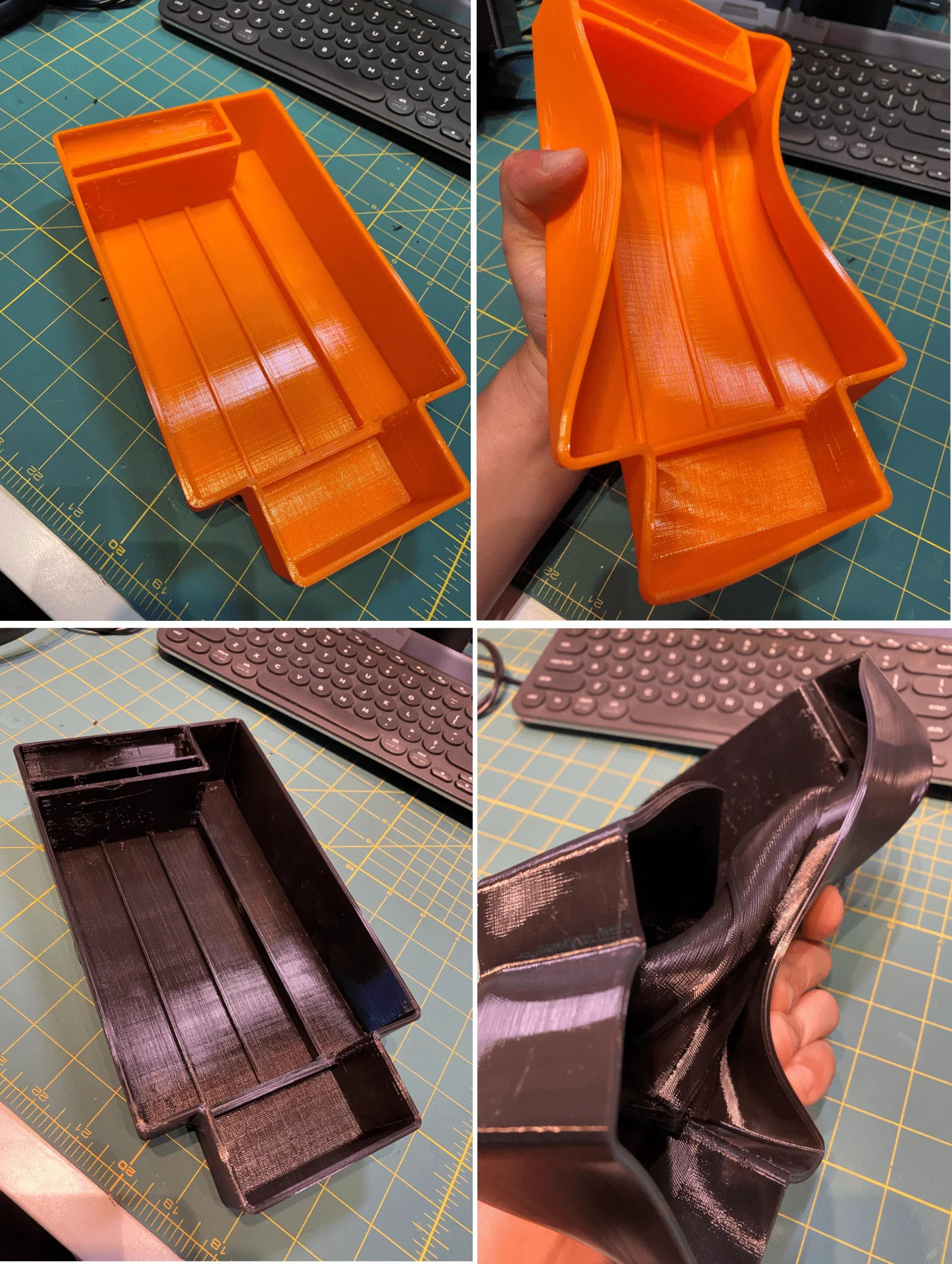

The red prototype was printed with PLA, which is a good material only for fast prototyping. It had good fit with the factory part. But after several hot days staying in the truck, it shrunk. But you see the upgrades from the photo:
1. Phone slot is removed. I personally don't want to put my phone so close to drinks even though most of our phones are water proof.
2. Better fixture to the truck. I want a secure and rigid fixture.

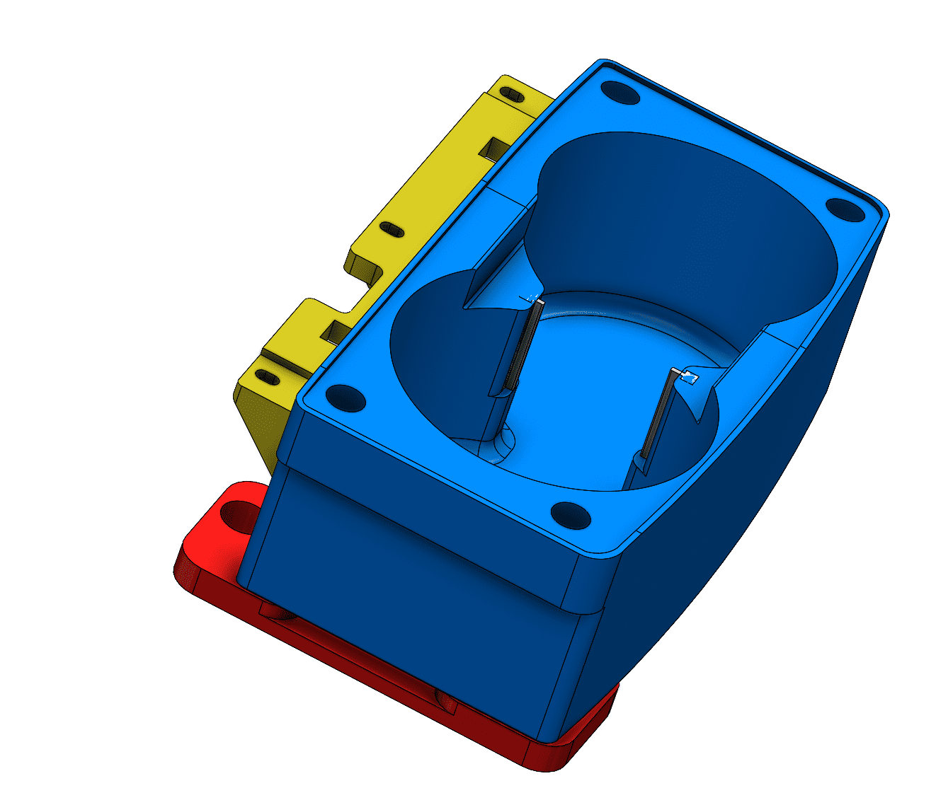

I am working on a updated version. The main change is on the way it mounts on the truck.
The current design is kind of floating. The cupholder is only fixed to the shifter panel and sits on two plastic lips. You know what I am talking about since you have installed it on your truck.
I am making two brackets that fixes the cupholder to some rigid mounting point of the truck.

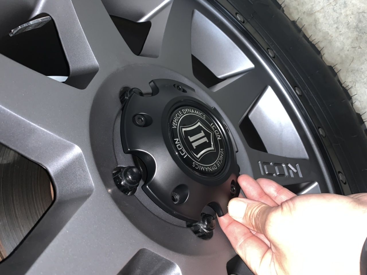

In the spirit of the Method center caps can you do some for my Icons? They fit a little differently and are too shallow all around.
