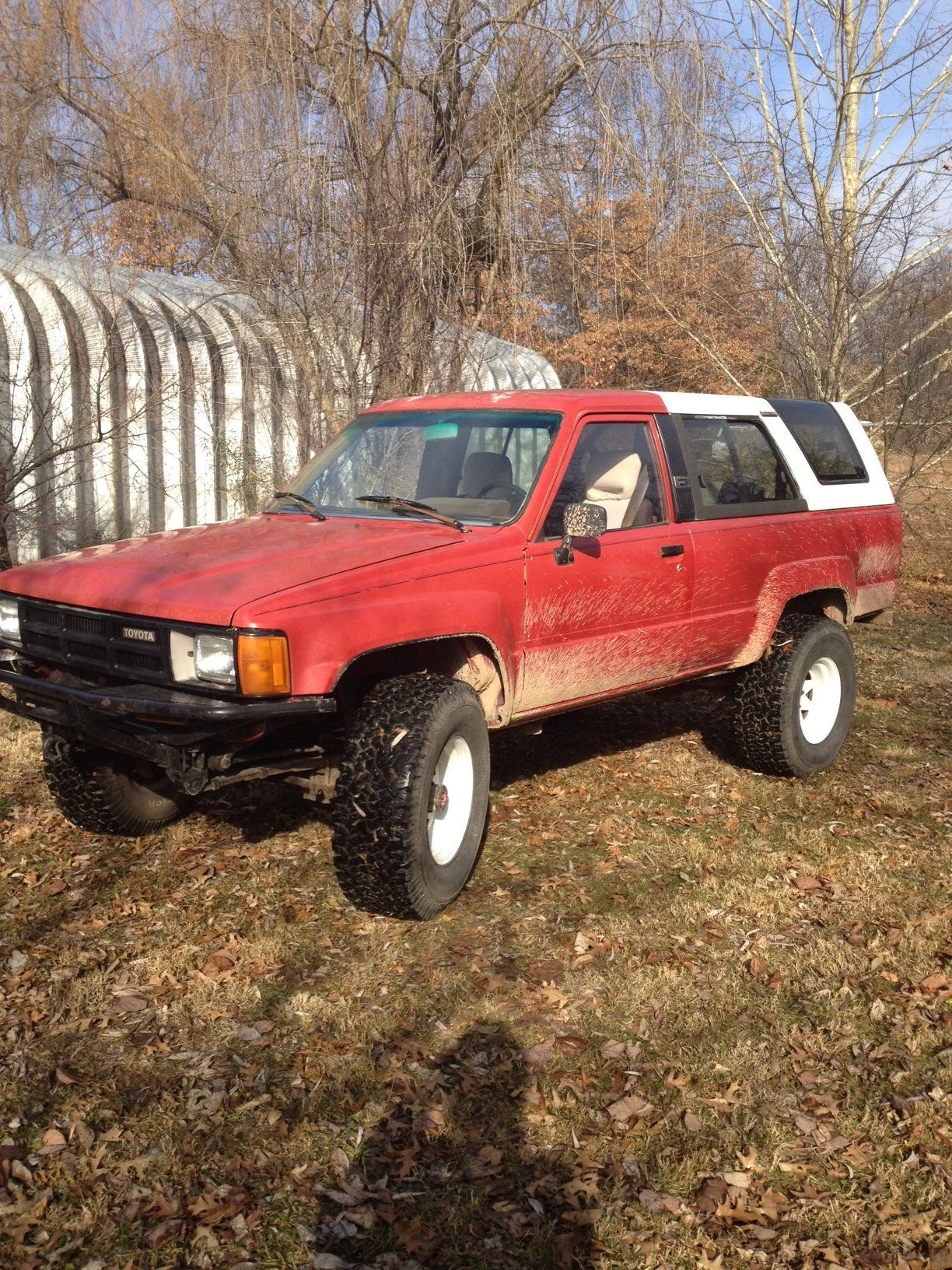

Been waiting on nutserts and installation tool to get here. Unfortunately this gives me too much time to peruse CL. Found an 85 4Runner in a neighboring state. Ad said willing to trade.
We bought our 100 series 5 months before my wire’s stroke. The plan was to use it to tow our 65 Airstream and enjoy a nice cruiser. It has seen very little use since we bought it over 3 years ago, just at 6,000 miles. It represented lost hopes and dreams to me, so I struck a deal with the nice young man with the 4Runner.
I’m happy, he’s happy. He even drove 5 hours to deliver so I didn’t run the risk of COVID exposure for my wife. A picture since everyone likes them. Sure hope those nutserts show up soon. No telling what I might trade next.

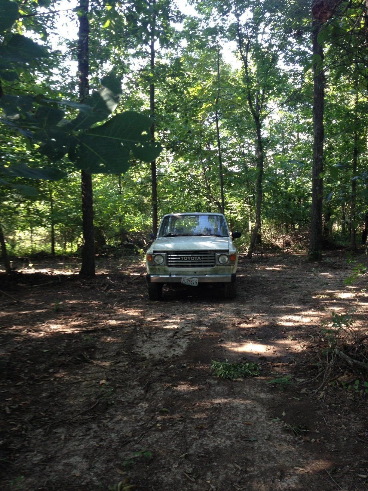

Thanks Ron. Here’s a picture of the spot I cleared last summer. The 60 is where I was looking to park the Airstream. A couple of chairs around a fire pit. Solar collectors to keep the battery up for lights, be about perfect.

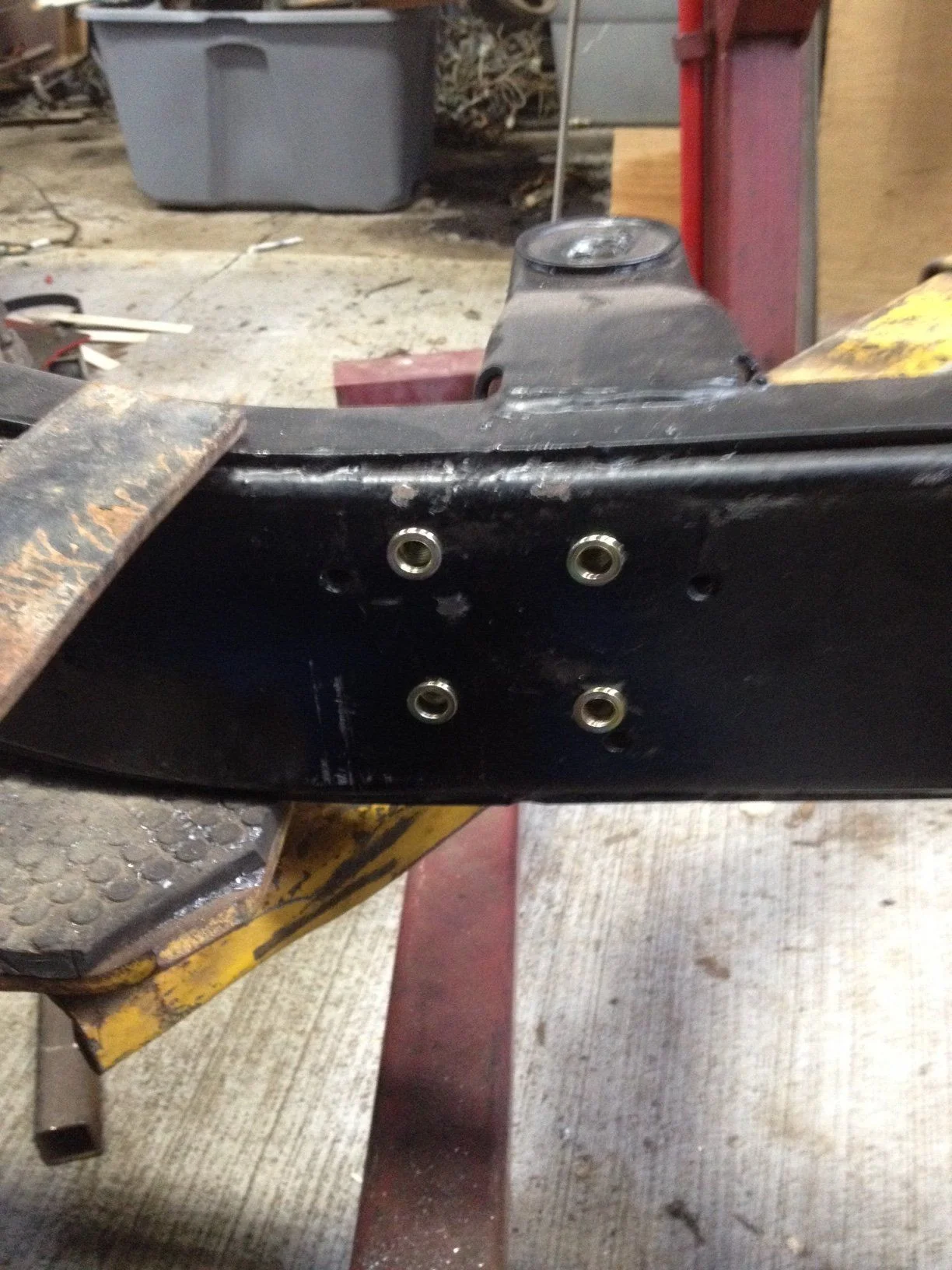

The nutserts and installation tool got here before I could trade anything else. My wife was beginning to get nervous that she might be next. The problem with working on a project hit or miss is that things change in between therapy sessions. I had to remove transmission/transfer case to drill frame for nutserts. Left the frame side plates clamped in place. A few days later, the passenger side plate slipped out of clamp when I bumped it. “Thought” I put it back exactly where it was. Checked level between both sides and it was good. Added a second clamp and drilled the frame. Driver side went smoothly. A few days later when the nutserts and tool arrived, I unclamped the plates and tried to install the first nutsert.
Closing in on 70 pretty quickly, I realized I might need a cheater bar to help squeeze the handles together. Put the first nutserts on tool, put it in hole, and started squeezing. Somehow managed to wobble it a bit as it finished closing. 2/3 inside frame, 1/3 out. Next time out there managed to remove rubber stopper from outer side of frame and sort of see the backside. A lot of hammering and choice words it finally came out. Realized I didn’t need no stinking cheaters. Got all eight installed without anymore issues.
A couple weeks later I was putting the transmission back in. Took two days of limited shop time, but got it in. Driver’s side frame plate bolted on and markings on plate lined up with the crossmember. Great, ready to drill. Mounted passenger side plate, and was off by 1/2” from my marks! Wasn’t about to pull tranny again, or install 4 more nutserts. Took plate off next time in shop and redrilled all four holes 1/2” over. Everything lined up again, so I drilled the crossmember holes in side plates. Ready to pull off and weld the nuts on next trip out there. And weld up four holes in the plate.
