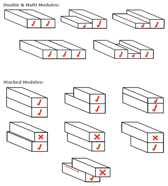

Any one ever tried to put a Rolling Floor onto a shorter drawer? To mount something inbetween the drawer and the 2nd row seats and have it cover by the Rolling Floor?
Went through the whole thread but couldnt find an answer...
I think he is asking about using the shorter box on the bottom and then putting a roller floor on top of the shorter box.
I have a short box that is near new in storage.
That video they cut and welded the box .. looks like a bunch of work to do that.
I know the short box will bolt on top of the long box, but I have not seen anyone do it the other way around.
I would think it would be easy to bolt the roller floor to the short box. "but" when installing 2 long boxes there is a beam on the bottom that ties the 2 long boxes together and this would not line up between the short box and the long box. You would likely need to move the beam on the bottom so it aligned between the both boxes. This beam is just screwed on, so some drilling and repositioning it would likely work.

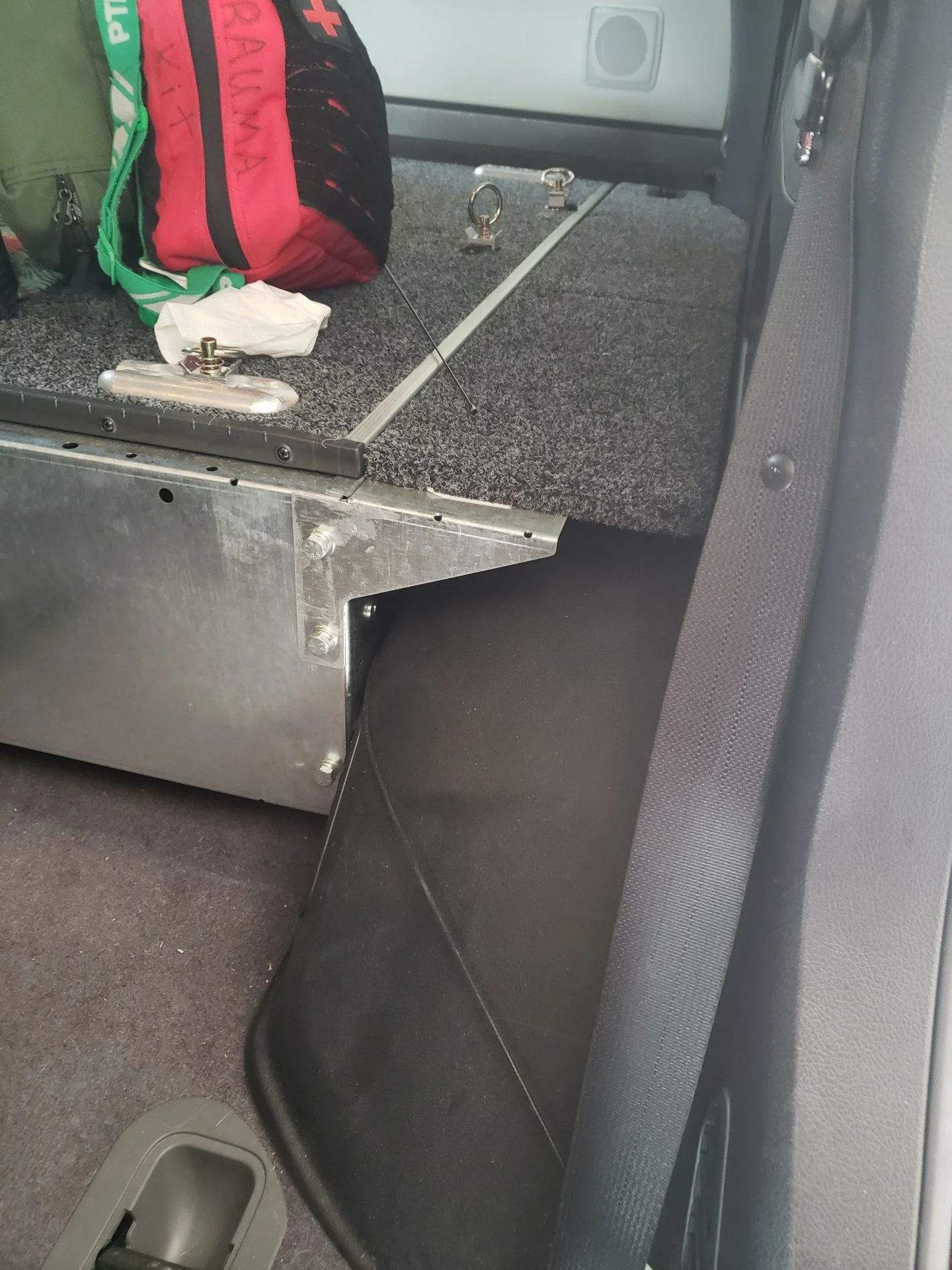

This may seem like an OCD question, but is there an issue with the drawer system covering up the vents on inside, drivers side panel? guessing this is for recirc or pressure regulation?
Not a problem. In favt, I placed my large i verter in that passenger soace *because it will benefit from the AC intake that sits back there. Just avoid cramming stuff directly against the slats of tge intake and then you’ll have no issues.
For consideration—note tgat tge length of tge slats/grill back tgere are much linger tgan the actual intake opening. So take a closer look and you see tgat you inly need to keep on portion of it clear withing the space in the fit kit. Passenger side has no intake, so cram away on tgat side.
Excellent guidance, thank you sir!
