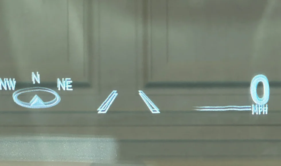

I use a great glass installer. Small 'mom & pop' shop (literally). Guy has several decades of experience and knows all kinds of details regarding the intricacies of Land Cruiser glass. It's a good shop. They did a windshield in my 13 LC a year ago and used FYG glass and it was a really good job.
A few weeks ago I took a rock into the windshield on Leonard (16 570). It hit right at the VIN plate and cracked across the driver's side. Used the same shop, same brand of glass. Great clarity, great install. I didn't notice it at first but I've got pretty bad ghosting on the HUD. There's also lacking optical clarity as showing in the wavy lines, though the view outside it great and there is no hint of distortion when looking side-to-side.

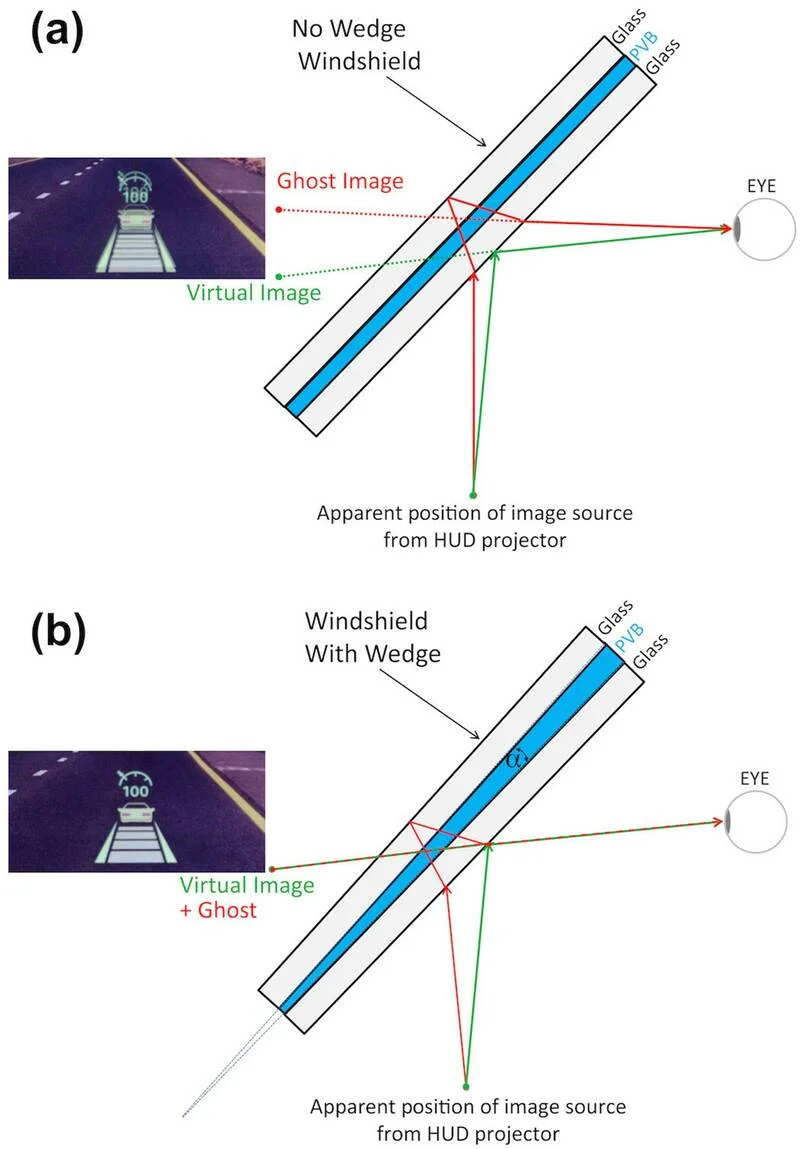

The shop is supportive, reaching out to their supplier to see what the remedy is. My guess is the only solution is to go with Lexus glass, but since it's a State Farm repair, I'm not sure how easy that path is going to be. In doing a bit of research, it sounds like HUD glass has a wedge-shaped poly layer that eliminates the refraction resulting in the ghosted image. My guess is FYG doesn't have this spec'd correctly.
It's a State Farm repair, so I'm not sure how easy it is going to be to get them to up the cost for OEM. Worst case, I'll pay the delta to have it done correctly. With FYG it was a $1,350 repair.

HUD glass has two possible remedies, one is an anti-reflective coating on the poly layer, preventing the forward glass layer from producing the secondary (ghost) image. The other is to have the poly be wedge shaped, thicker at the top resulting in the focal planes to align at eye level.
Through the Launch tool you do have some minor adjustments, but they're not designed to fix the wrong glass.
