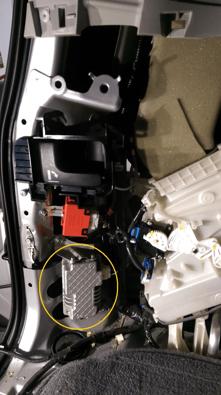

Inverter is directly below the 3rd row seat release handle.
I wouldn't use the inverter wiring for the DC-DC charger. I would run dedicated wires from the starter battery of sufficient size to be below 3% voltage drop at the charger's max current draw.
Nice, thanks!
I have no use for the AC inverter, but yeah, probably better to just run a cable from engine compartment or even the cigarette lighter below the back seat controls.

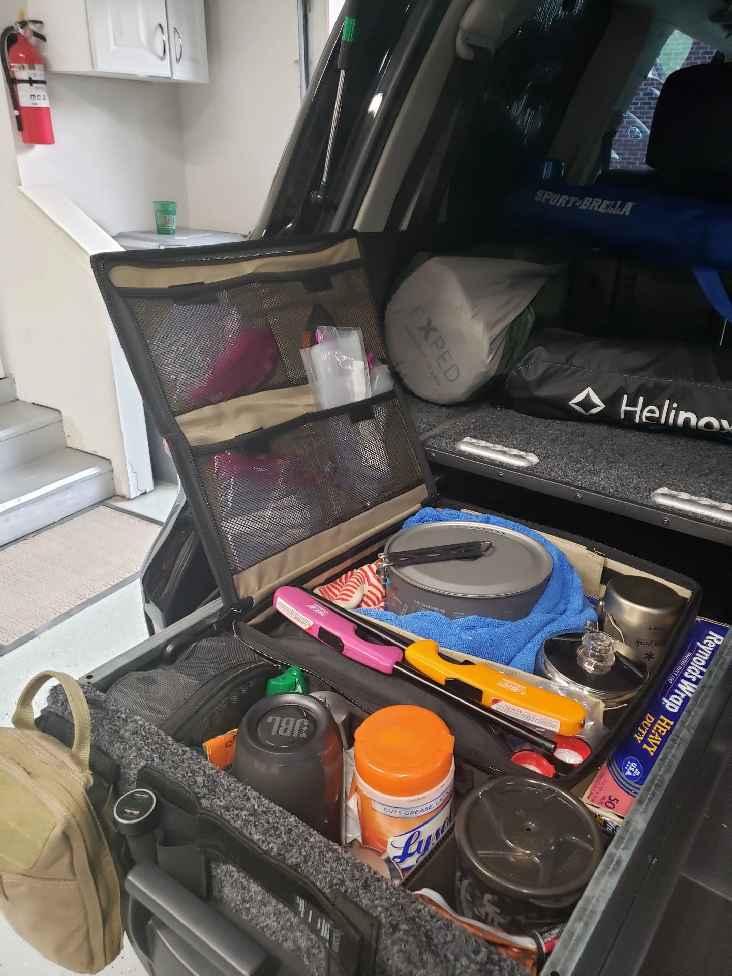

I use one of the cubes for my camp kitchen. Makes it easy to store in garage or pull out at camp.
Wow, that looks really tidy. L track on the top makes a lot of sense too.

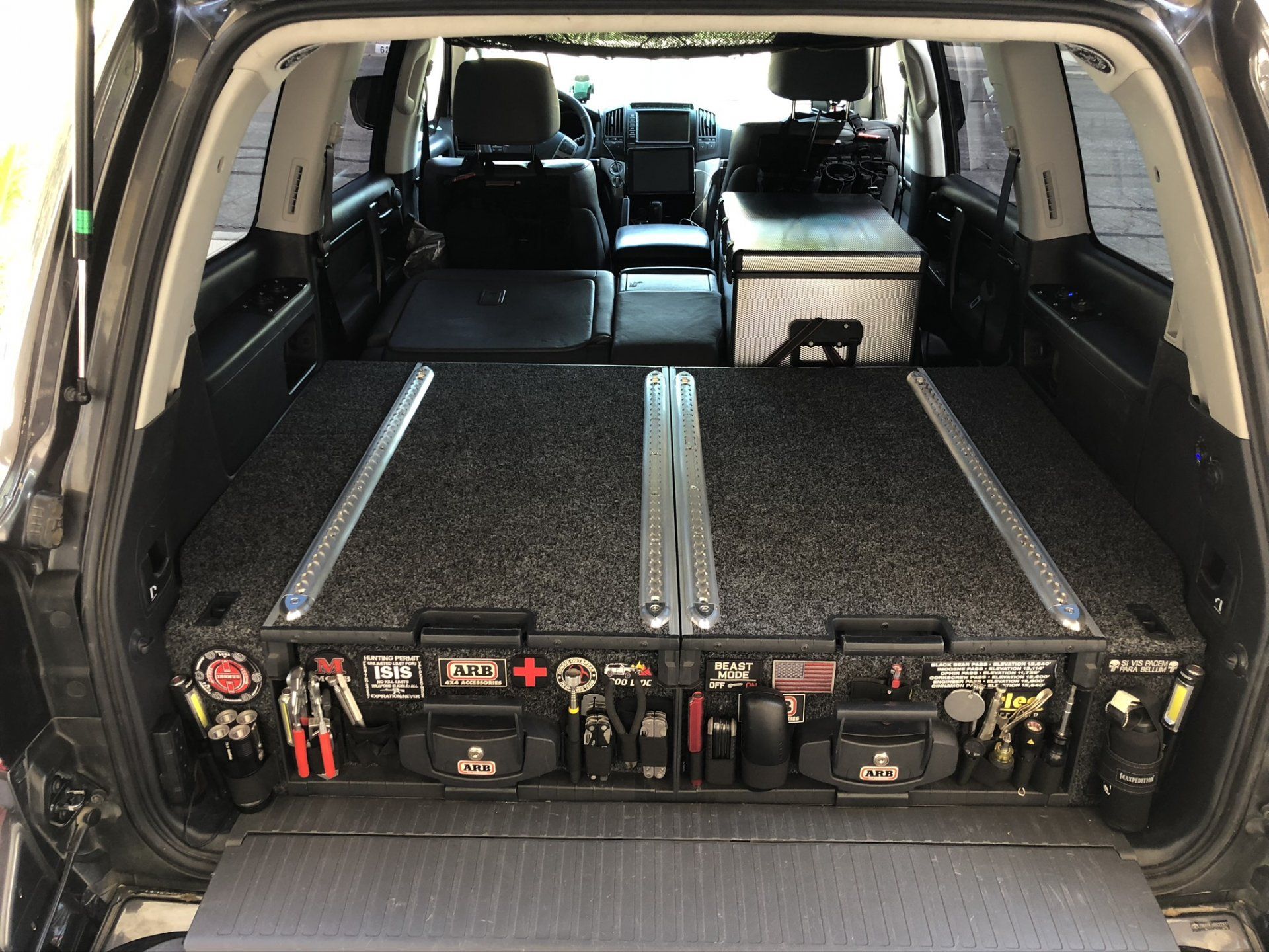

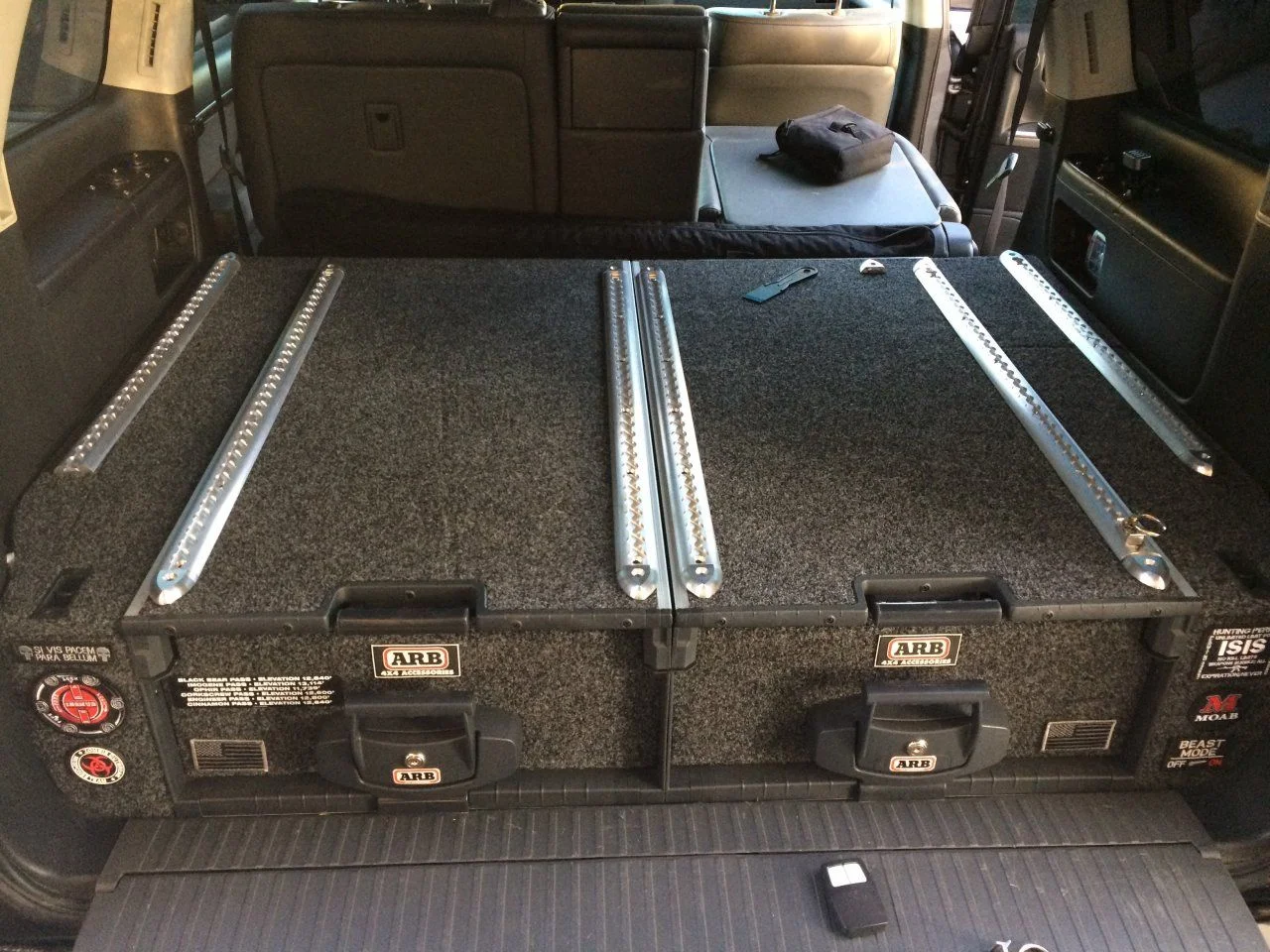

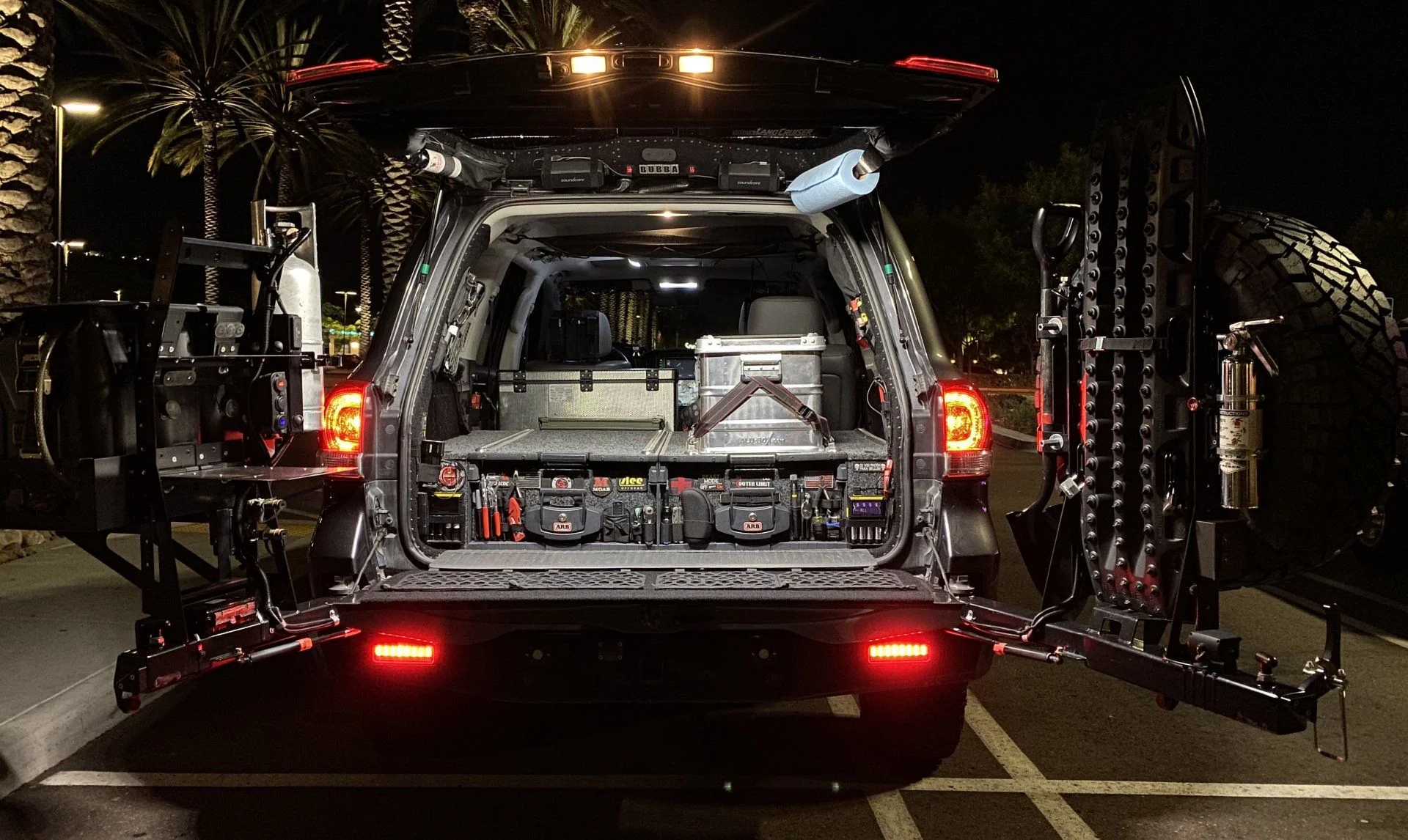

Or...you could really go nuts on tracks...
Overkill, sure...but honestly, it turns outto be incredibly handy to be able to tie thi gs down at any odd angle or shape...on each drawer...and still be able to slide either or both floors.

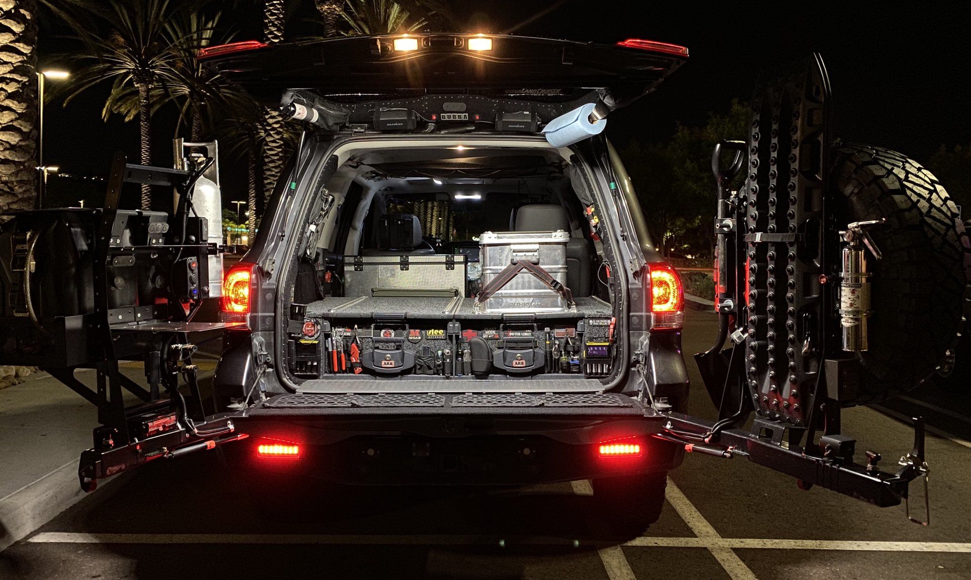

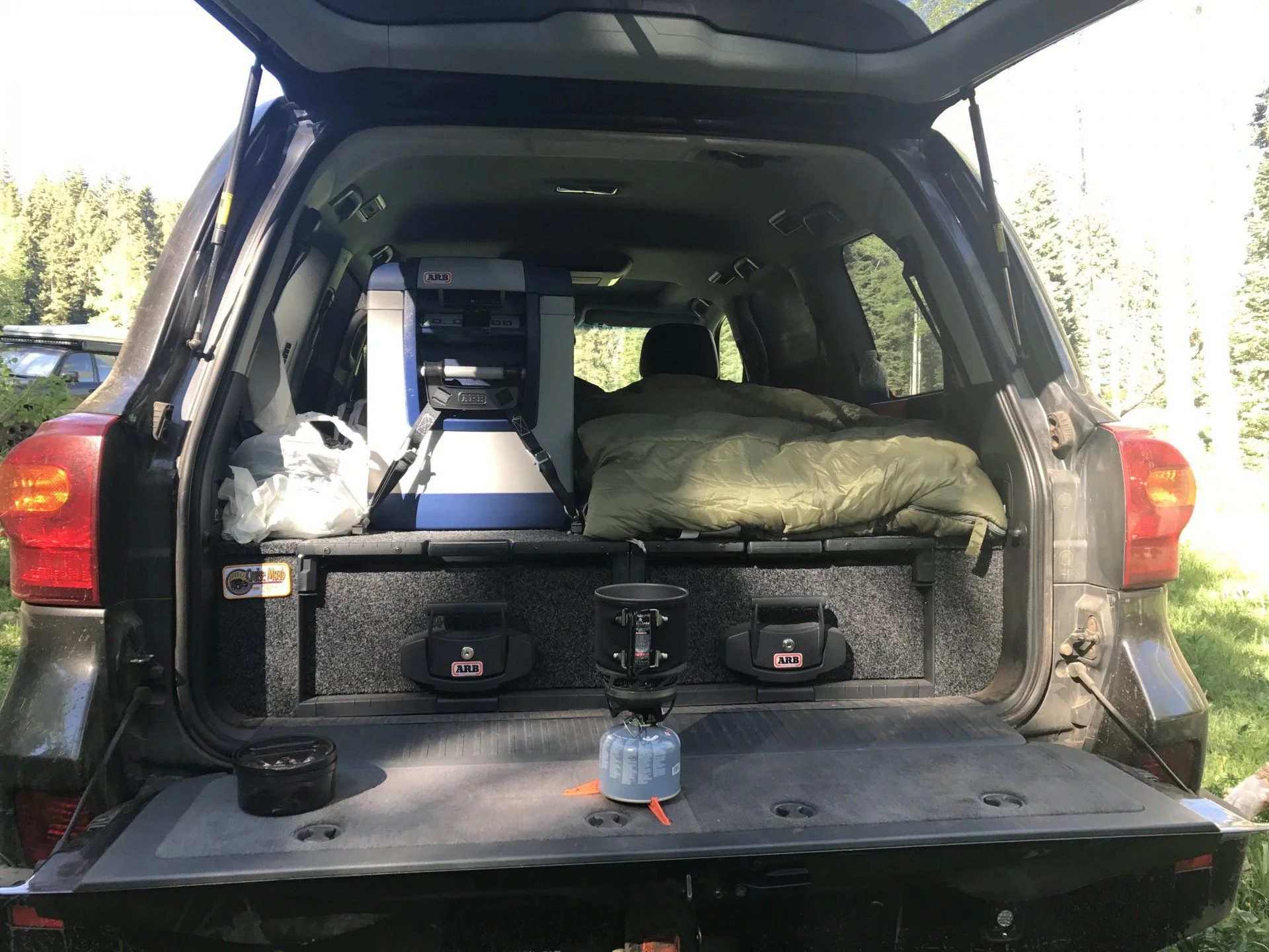

Depending on how tall your fridge is, I strongly recommend putting it on the driver side if you want to maintain any visibility out of the rear corner through the glass. The ARB 50qt blocks the whole window, and the 63qt while shorter still blocks a decent bit of the window. For wiring, the only “right” way to do it is to run dedicated power to it, especially if you ever want to go back to a fully functional stock operation. Keep in mind when you go to sell in the future the next buyer may very well want the AC outlet in the back, so if it’s been hacked for the fridge you may lose some buyers. If you run dedicated power, add a fuse block and attach to the rear of the drawer to make adding any future wiring projects easy. It will add minimal cost but decrease future time and frustration by lot!
My 50qt fridge would have totally blocked the passenger side rear window as you can see here:

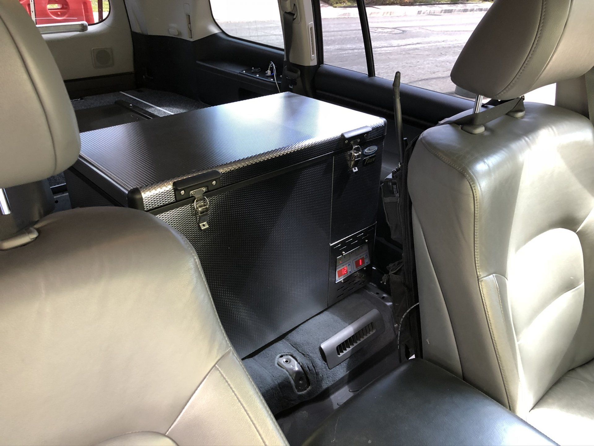

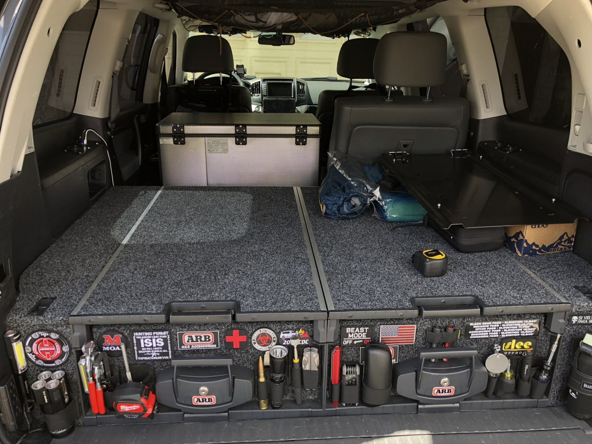

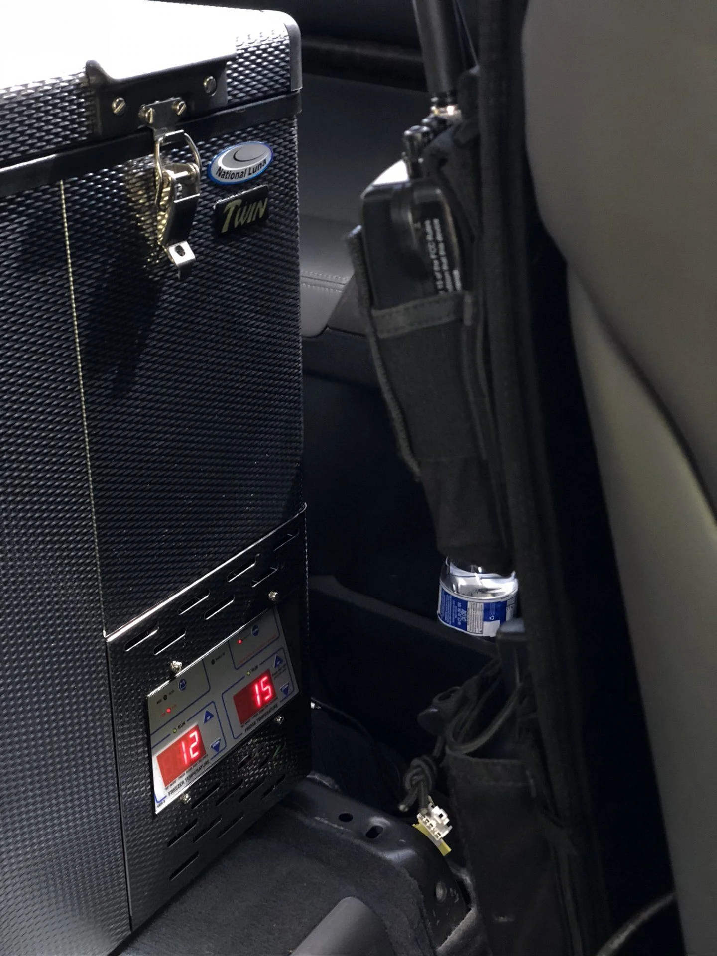

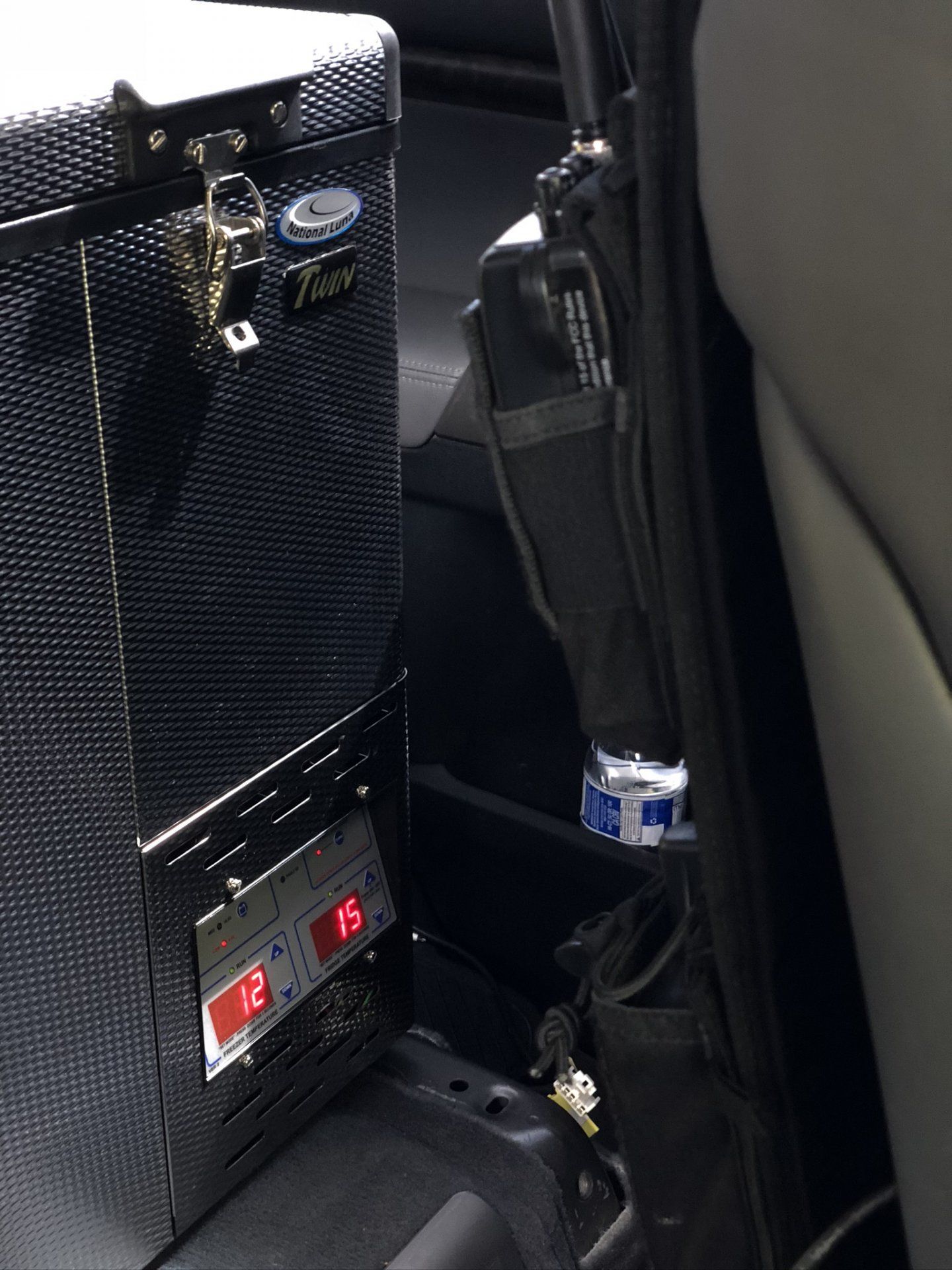

For those of you who do not have lots of passengers... I am a huge fan of placing the fridge in the second row in one of two configurations.
-Both still allow sleeping in the back on one side or the other.
-Dramatically lowers and centers the weight of a full fridge
-Access while driving & without opening swing-arms
-Massively improves rearward visibility
-No ceiling height issues for fridge door
-Retains full rear cargo area.
Have a look.
60% seat removed:
40% seat removed:
PS. This is the National Luna 60L Twin (two compartments with their own thermostat/controls for fridge/freezer, freezer/freezer or fridge/fridge options. Temps shown are in degrees Celsius. It will go as low as -25).

I like that a lot. How is the fridge secured in those locations?
Drilled holes in the heavy steel fridge plate from National Luna to match the very heavy seat anchor bolt holes in the floor. Heavy washers complete this, and allow easy remival of fridge with plate in place, or plate removal.
