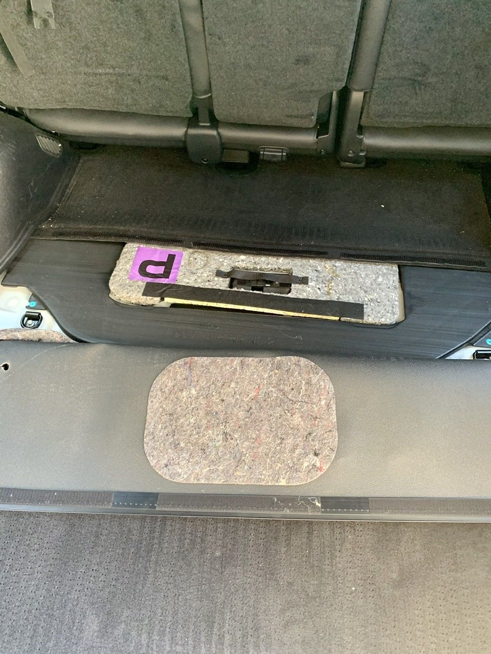

Can the anchor bolts for the ARB drawers use the existing four D-ring bolts holes in the rear cargo area, or do they have to use bolt locations from the removed 3rd row seats?
The reason I ask is I have a 2020 Heritage Edition and do not have the 3rd row seats/hardware. I have the four D-rings, but that's it for existing anchoring locations. I've done several hours of research and was not able to confirm this.
Also, are the hat sections fairly adjustable? I'm thinking if the existing D-ring locations do not line up, I may be able to adjust the hat sections and possible drill new holes in the hat to match the existing d-ring bolts.

Trying to use the existing tie down bolts will not work so well.
Not in right position and too small of bolts to secure the drawer.

Not that big a leap.. It's a inconspicuous location and there are templates available that tell you exactly where to drill.

Because some of our designs existed before the HE Edition, and the 10mm seat mounting points are better/stronger mounts.
Finding the threaded holes is easy. If anyone is nervous- just get a competent shop to do it for you. Takes about 10 minutes.
