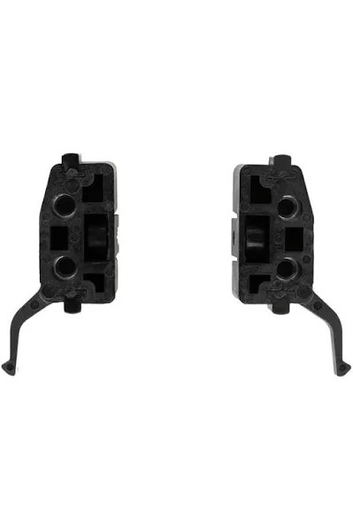

See image below. The main body will hold the drawer in place. What happens is the tip of the thin extension piece breaks off and it no longer can retain the drawer in the fully open position.
Yup, if you're parked on a slope nose-down, the drawers won't stay open. It's not a big deal, but can get annoying.
These little gizmos are available separately and are easily replaced.
I got my drawers used and needed to replace them, took 5 mins, not even a banana
I got mine from Slee, they are on his website, they were inexpensive

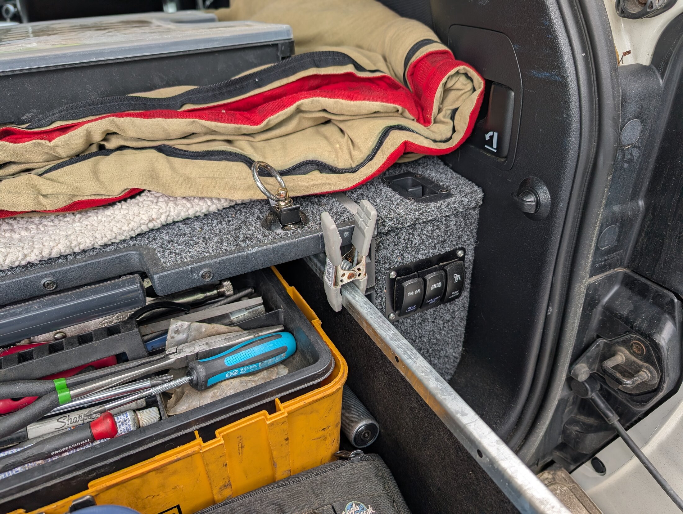

This is how I fixed my broken stoppers issue, $2 each at Harbor Freight
Dang! I can use those on my Frontrunner drawers that don't have stops - genius!!
Thanks for posting!
(Definitely falls into the category of "Why didn't I think of that???")
