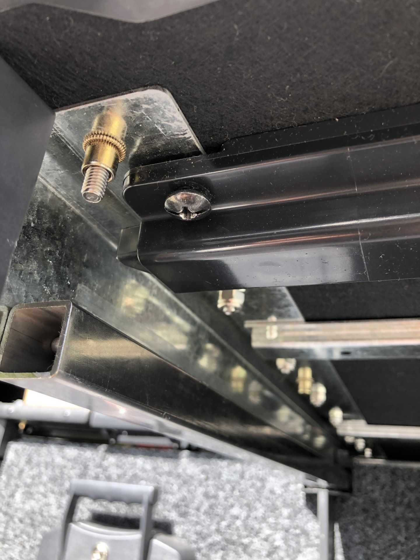

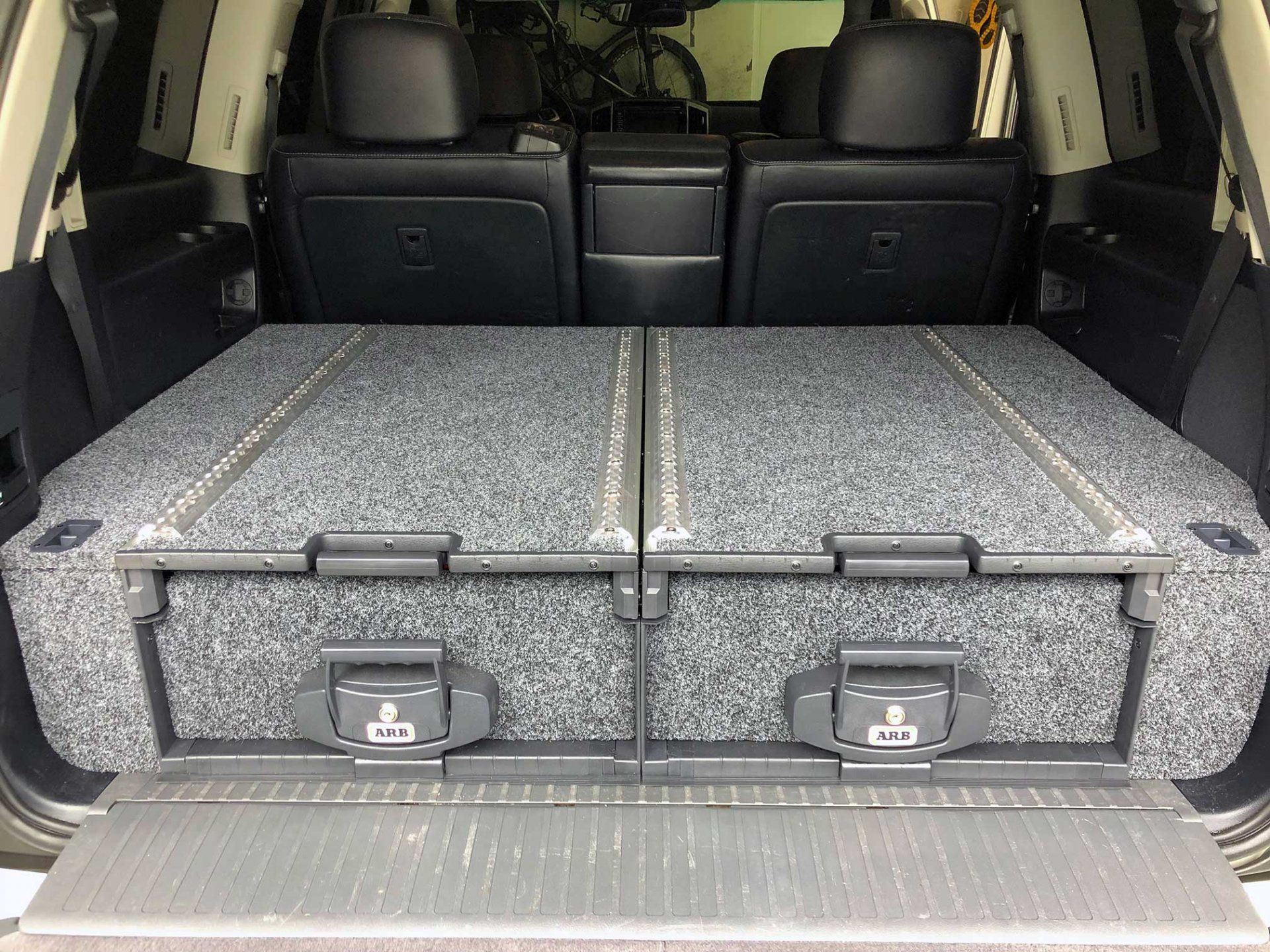

OK, got some L track and got it mounted thanks to @Markuson 's other thread. Was able to reuse the rivnuts on the front (M6 x 1.5") so everything lines up perfectly.
The only catch is that the end caps I ordered don't lie down flush so will probably just grind down the rough edges for a cleaner look.

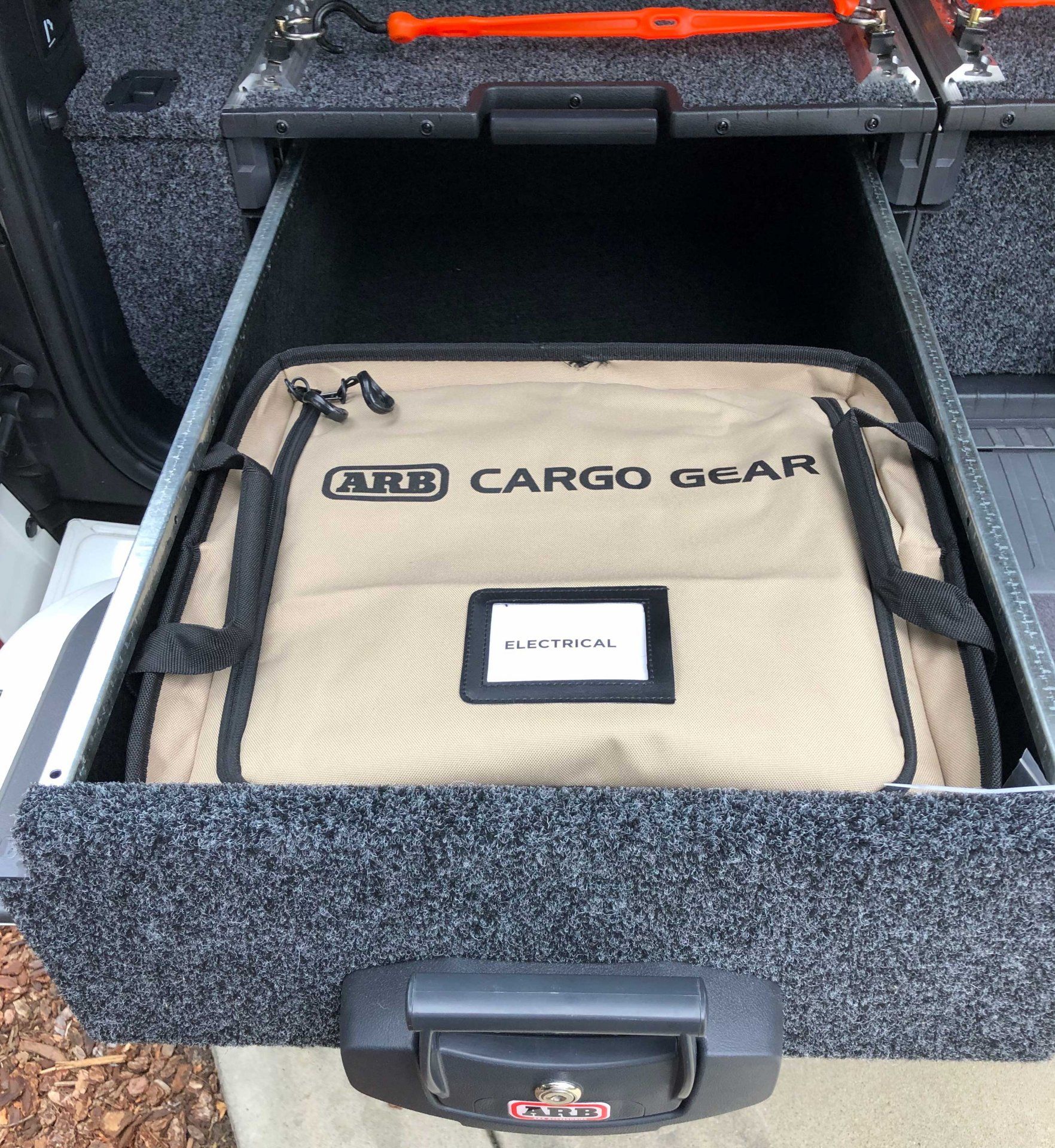

Also ordered some ARB cargo organizers to keep stuff, uh, organized. Found that these little $10 ammo boxes fit perfectly and are also waterproof so good for fluids and such.

What L track are you using? Pretty sure the holes in the track do not line up with the 4 rivnuts in the drawer top. Are you saying you only used the front rivnut and drilled the track for the other positions? Or drilled the drawer?

Couple suggestions to consider:
-If you haven’t already, I would drill through the fullplywood top, and anchor with washers and a nut at several points underneath, (making sure you don’t interrup tge cross braces of course). This is because when you strongly anchor stuff with straps, it has a lot of pull force over time. Not hard to do. Might need to shorten bomts to fit, etc.
-Other item definitely worth the extra are these end pieces for your track:
These end pieces dramatically improve the ability to slide gear in without damage, scrapes, etc. No need for them to be anchored for huge strebth,ads they are just protective caps/slides...so even a wood screw can work for them, though a bolt/nut is better.

I just used the front rivnut as an anchor point since it is exactly in the center of the metal bracing, and then drilled 8 holes (4" on center) for 1/4-20 1.25" stainless bolts and locking nuts. It just seemed like the strongest place to anchor things (I trust a large piece of steel more than plywood) and also provided the widest possible spread for things like fridges. I guess if some extreme force shears the sliding floor off the drawers completely, then all bets are off.
And yes, I will finish the ends at some point. USCG makes matching end caps but they are not as elegant as the Mac's ones and they overlap the front trim so I left them off for now. As with anything, I learned a lot on this attempt so might do it differently next time.

Ah. Ya, on mine, I didnt stay at the edge...because I wanted to mimic the exact width of my alu-boxes &sabe extra width for sleeping on other side. If at the edges & on the metal, then never mind. Still not sureabout tive nuts on the ends, if using ratchet straps...but enchors in the middle should be fine.
Re plywood... I meant the plywood that is the main top structure...but thats only if you offset your anchors away from the edges.
OK so I'm dialed in on the ARB drawer installs, fit kit and L track, so moving on to organization. Got some ARB "cargo organizers" and really like them. First impression is that they are smaller than I had envisioned (large is only 16"x16") but also very well built and an ideal match for the 1045 drawers. Other bonus points are that they fold up easily ( I can nest 4 smalls and a large inside one large for storage when not used), have gripper feet to prevent them from sliding around in the drawers, have finger loops on very robust zippers, and are padded but not so much as to rob you of valuable space. They fit close to the edges of the drawers but you can still sneak in some stuff if desired as there is 2" to spare. Very beefy handles and these should last a long time if not handled too roughly. Evidentially those Aussie's know what works :geek:
Also tried a Plano Sportsman 68 quart box on the sliding floor, but it is too small to use that space efficiently. Will look at Alubox stuff next (A081?), 25x the price but they have parallel walls and you can really dial in the fit so that should yield almost 50% more capacity and still keep the rear window view unobstructed. Anyone using Alubox on their ARB drawers and comments?

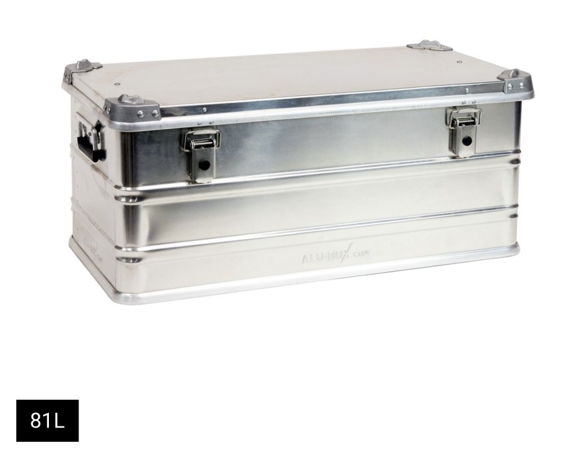

@Markuson - looks like you have an Alubox, what size and would you recommend it?
Definitely recommend alu-boxes. I use a combination of the 60L and 81L boxes.
The key point on both these boxes is that the lids cam both open fully while still strapped to my drawers by the handles. Trey just clear the roof.

Great thanks! That's exactly what I was hoping to hear. I might designate the Alubox be my "wet" box, meaning it could contain some water packs and other stuff that could leak. Looks like the Alubox edges are sealed with silicone (as opposed to one piece of molded plastic) but that is about the only downside I can see. Any reservations for that intended use?
Plano box = $14, Alubox = $350+. That BETTER be a good solution 😆

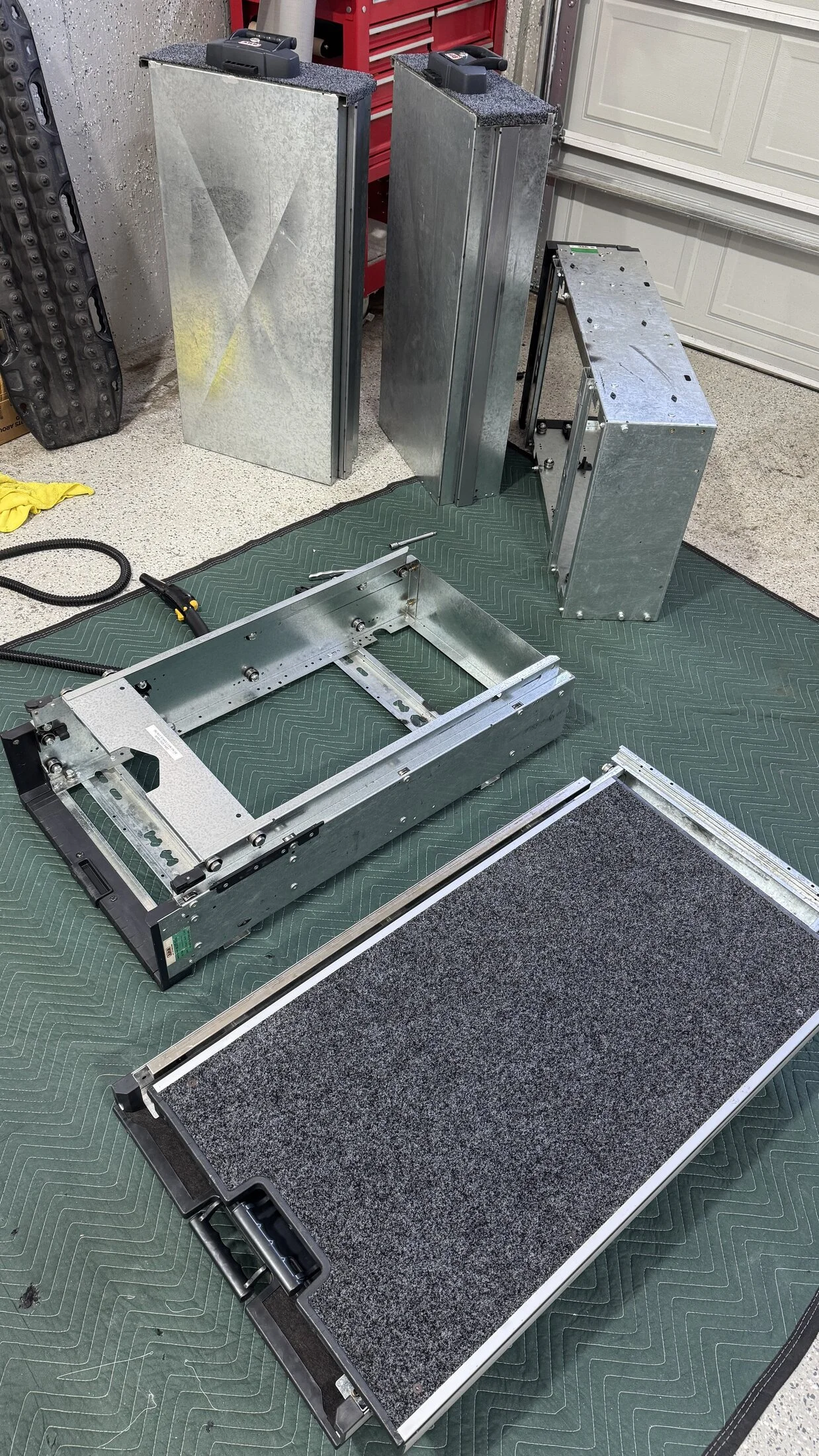

I picked up a used set of drawers, about 7 years old but in great shape.
As I have them apart to go through all the hardware, stoppers, etc. should I do any maintenance on the roller bearings? I couldn't find anything in google searches or any documentation from ARB.

Have had a bunch of different drawer systems and ARB's are very reliable and strong. Pretty sure the bearings are sealed and the rails are stainless so I've never done anything to mine.
The achilles heels on these units are the plastic trim on the front, and the drawer "stopper" which is a plastic hook doodad that is easy to break or install wrong. I think you can get these from ARB or Slee and the procedure is described pretty well near the end of this video:
I have had my drawers out a few times and I've tried to lube the rollers, but yeah they seem like sealed bearings. I'm in my drawers several times a day, had them since 2018, and they still slide perfectly, so I guess they are just maintenance free.
Yup, all my stoppers are broken. Dumb weak design.

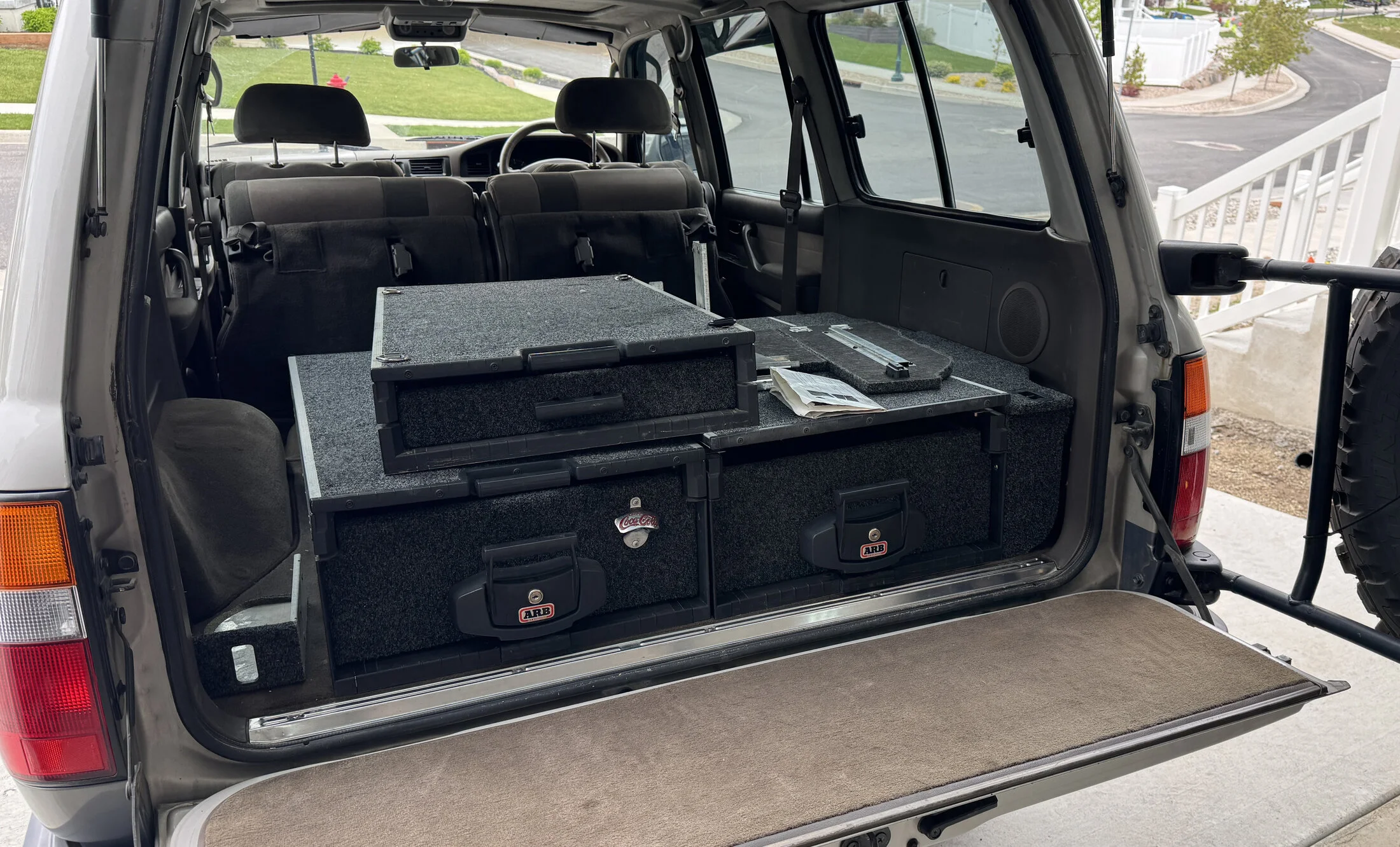

That's awesome, thanks for the replies @KLF and @eskimoke . These are actually going in my 80 but this thread in the 200 section seemed more recent/well-informed than anything I could find for 80s. The set came out of a 100 so I bought the 80 wings and some stoppers (one broken, three ok) from Cruiser Outfitters.

The wings, "fit kit", whatever, is super handy and you will be shocked at how much extra gear you can jam along the sides.
2 accessories that I use a lot are "L-track" to hold stuff down (Rollercam straps are great for this) and some kind of packing cubes to organize and de-rattle things. The ARB ones in particular can do the Tetris thing where they fit together with little wasted space - very Aussie (including the khaki color) since you're going that direction anyway.
When installed and loaded properly, the ARB's are nearly silent - enough to let you focus all the other stuff you forgot to tie down correctly.
