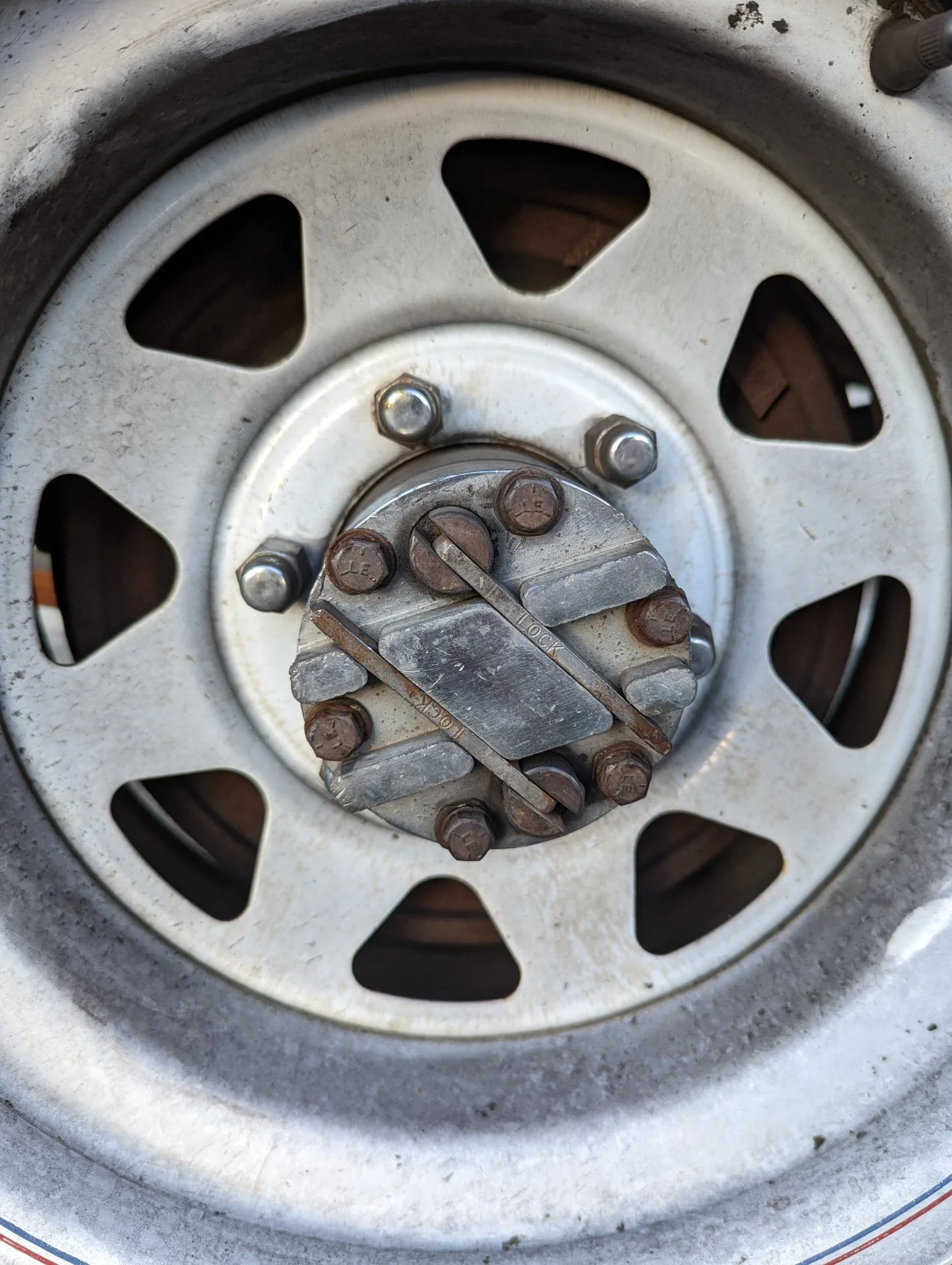

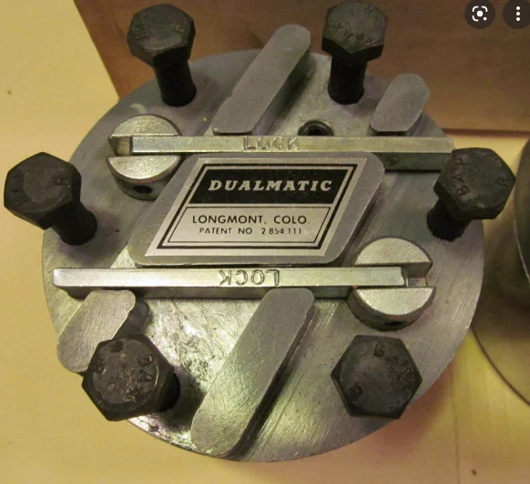

Thank you.Those are Dualmatic hubs made in Longmont CO, common on early Cruisers.

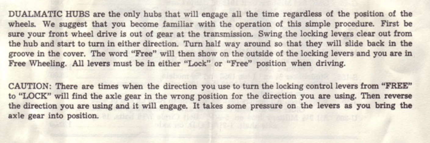

They are goofy. You pull those tabs out and kind of spin them around to lock or unlock. Issue is they spin in any direction so I'm not sure of they are locking or not. Was hoping to find a manufacturer manual or something.Those are the goofiest hubs I’ve ever seen in my life
I sent a pair of Atlas hubs to @Drake2 . There’s a pic of them floating around.I would have thunk those were very rare "Atlas" hubs ???
Hi Mark, you sent me a set of DualMatics (like the OP posted pic) and a set of Cutlass hubs. Is the "Atlas" name associated to either one of those? Were you thinking of "Cutlass" and not "Atlas" maybe?I sent a pair of Atlas hubs to @Drake2 . There’s a pic of them floating around.
Nice picture of them in good shape.Anyone able to tell me the make of these hubs? Nothing was printed on them that I could find. They are on a 68 FJ40 if it matters.
