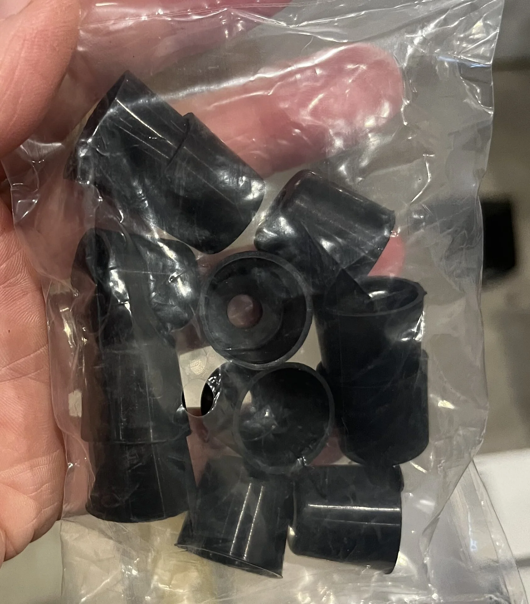

Hello! Dumb question, but what are these for? Head gasket kit.
1. Look at the seals on your valves to see if you are comparing apples to apples.
2. If you are, and you don’t know when the last time was that the head was serviced, you should consider servicing the head and changing the seals.
3. If you take the head to a shop to have it serviced, you can get their opinion on the seals.
