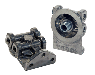

I think I would put on a good spin-on filter to keep that sediment out of my new carburetor and change the filter once a year until you do something about the tank.
