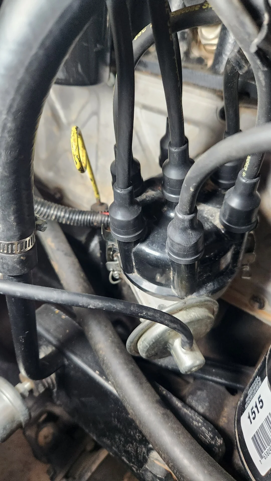

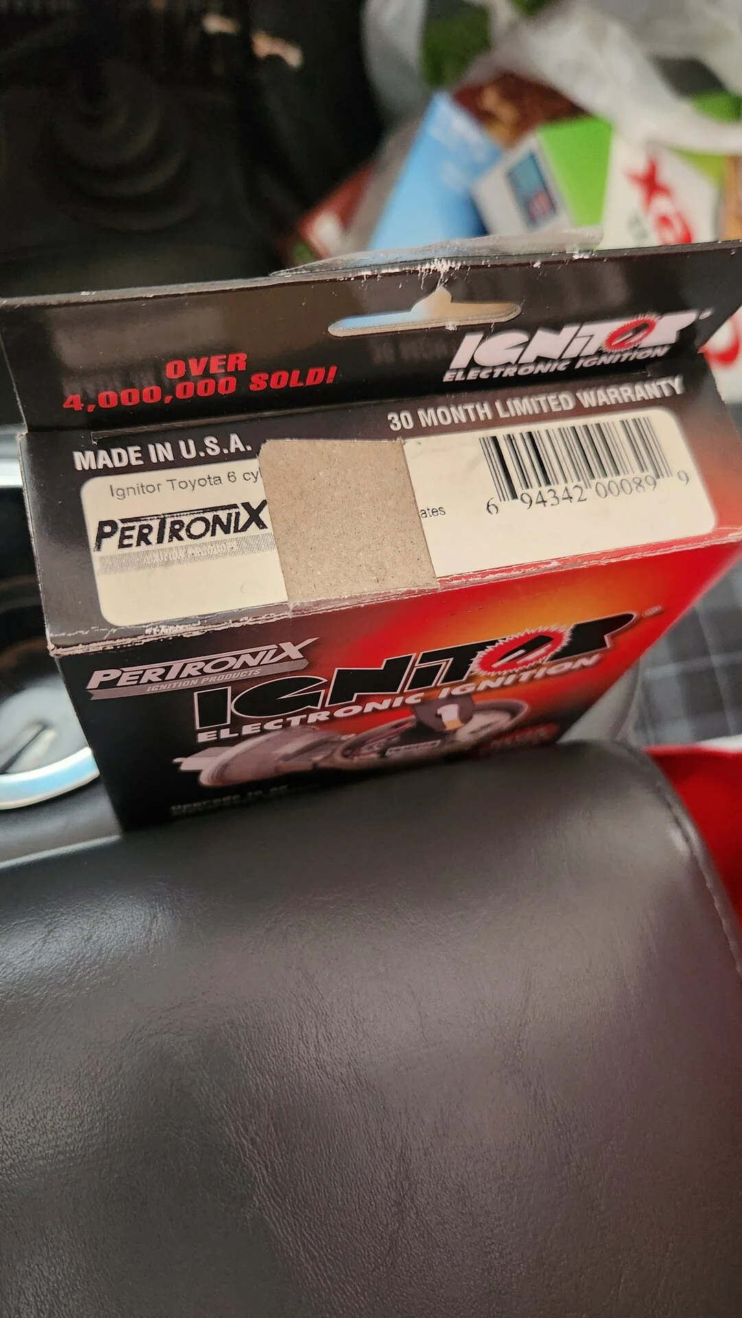

Cheers all! Been a minute since I've posted anything. Sign of a good running truck that's not been giving me much trouble this last year or so. Till this week. Question for everyone. The other day I just died while driving. Pretty quickly could tell it was a spark issue. I have a pertronix in a vac advance dizzy I got from Marks offroad (1st upgrade I did when I bought the truck a few years back). I figured it was that or the coil so I ordered new of both. Got what I though was the right pertonix unit based on what I read - "PerTronix 1662LS Ignitor® Toyota 6 cylinder Electronic Ignition Conversion Kit"

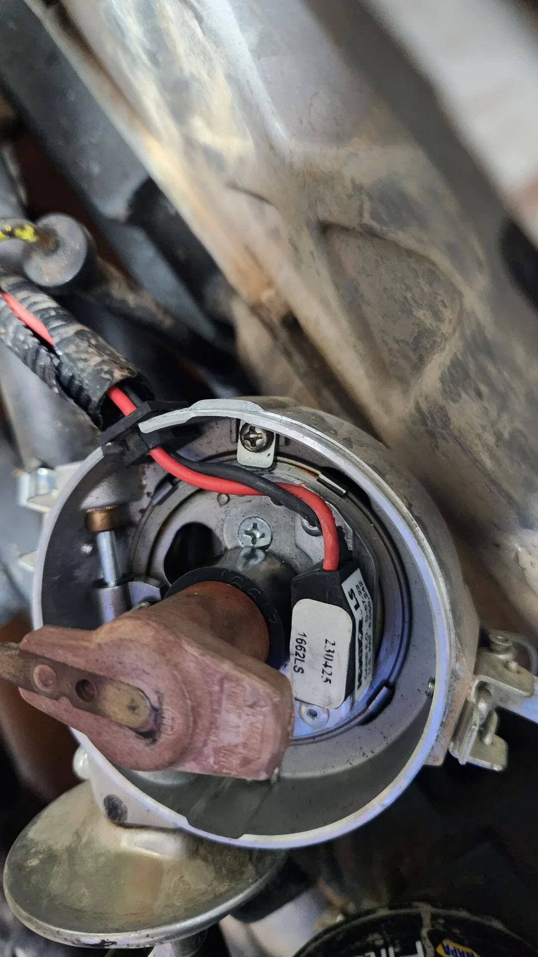

Turns out the plate didn't fit the dizzy. The rounded center part of the plate had the black unit too close to the shaft of the dizzy so it was rubbing on the magnet ring. I drilled the rivet outs on the new unit, detaching the electronics from the mounting plate, and mounted it to the plate of my old dead one, re-riveted it, installed and she fired back up! Installed the new coil too. Everything is back up and running fine.
My question though is what it is the actual model number of the pertronix unit that fits that Non USA Vac advance dizzy that mark sold me? Anyone know? I'd like to get a back up for the glove box once and for all. I've searched all the pertronix threads and can't find my answer. I suppose I need to just call Mark. Was gonna message him but his account wouldn't take messages. I recall he prefers a phone call...but maybe somebody knows the answer.

Detailed pics might help draw conclusions…🤔 💡
I'll post some. I really should just call Mark. lol gonna try that later today

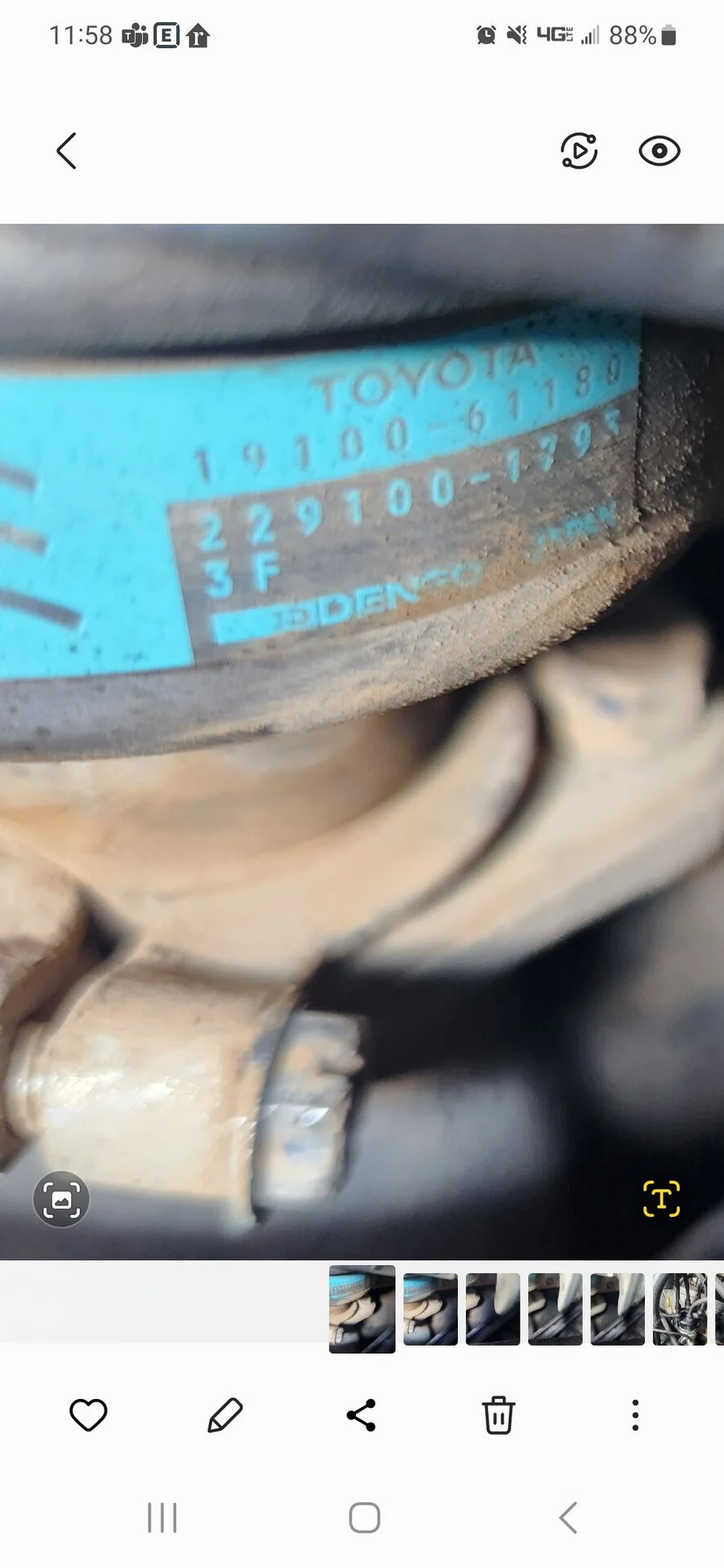

It was new unit, still available, I believe. I dug through my old threads and can't find exactly what it is. Pics to follow
I forgot it has a part number on it :bang: 19100-61180 !!!
Wonder if the “3F” under the PN# indicates that it’s for a 3F engine?
Wondered that. Spoke to Mark this afternoon and ordered the right pertronix direct from him. He didn't mention the part number, but knew what I had. I suppose it doesn't matter. Happy to order from him. Ill post pics of the two set ups when I get it. Planning to use the one from him and keep the modified one as the glove box back up.
