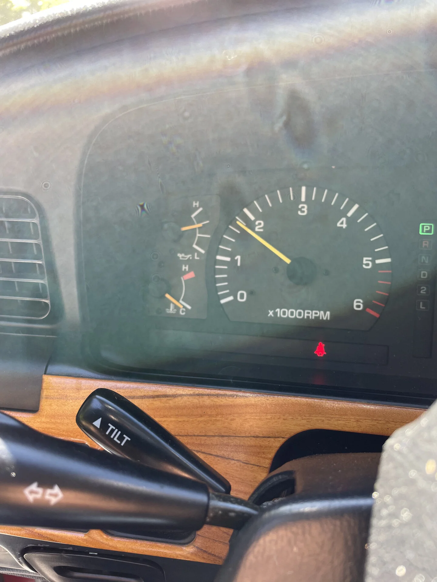

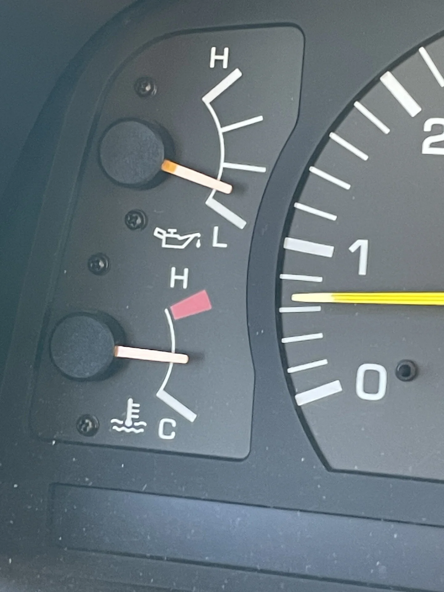

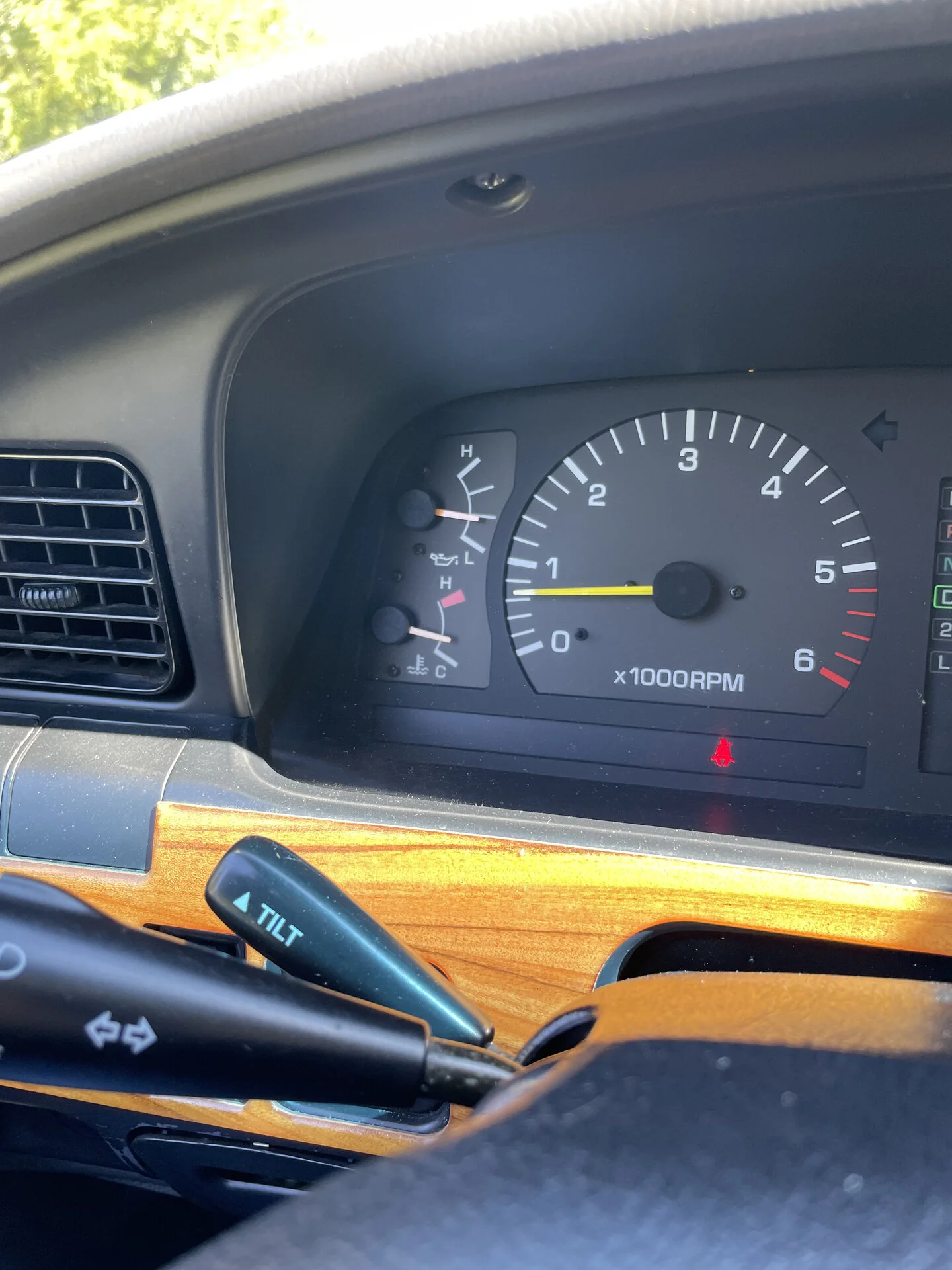

The oil pressure gauge is more suggestive than absolute.
However, your cold start pressure as shown is lower than I'd be comfortable with.
Mine at cold start is always quite high, like your first pic. Which is logical.
The lower indication in the third pic is where mine is once warm and at idle.
Is what you are seeing out of the ordinary? If not and oil shows full on the dipstick, could just be the pressure sensor.
They aren't exactly inexpensive to replace (easy diy tho) but you're in no danger of engine damage imo.

The odd experience was the rough idle at the light. Normally this car has almost zero vibration from the engine at hot idle. This when combine with the very low gauge is the source of anxiety. We tend to think of this engine as the ultimate in smooth at idle. The comparative group is a 2020 Volvo V90, 2006 Audi A6 and a 2002 ES 300. We are not experts, we just know what is abnormal.
No lights at all on the dash.
My concern is it has a WIX filter on it. Those are known to kill these engines.
You're not looking at a blown head gasket, you're looking at spun rod bearings.
Make sure your mechanic gets a flowing sample of oil in a CLEAN container so you can send it off to Blackstone Labs for analysis. This container can be a piss cup from the doctor, or a mason jar. Something with a lid. Then order your Blackstone kit and pour that sample into their cup and send it in. Best $35 youl spend for peace of mind on this.

Don't panic yet. If this was just a one time occurrence I would test the resistance at the oil sender or just replace it.
Follow all the previous advice about testing oil pressure with a mechanical gauge, send a sample to Blackstone and replace the Wix filter with a Toyota.

Recheck and post up a cold start photo after installing a new Toyota filter

By seriously low, the needle was barely above the lower white line on a visual gauge which I know is imperfect. Ordinarily, we would see it over the first mark of the scale.

The gauge is more of an indicator. Notice there are no numbers. When I did my headgqsket, I attached a mechanical gauge to the oil pressure sender. Despite my gauge indicating almost no pressure, I was well within spec at all rpms that the fsm says to check. My gauge never made it to the middle moat line.
Get real pressure numbers and then you'll know where the engine is.
