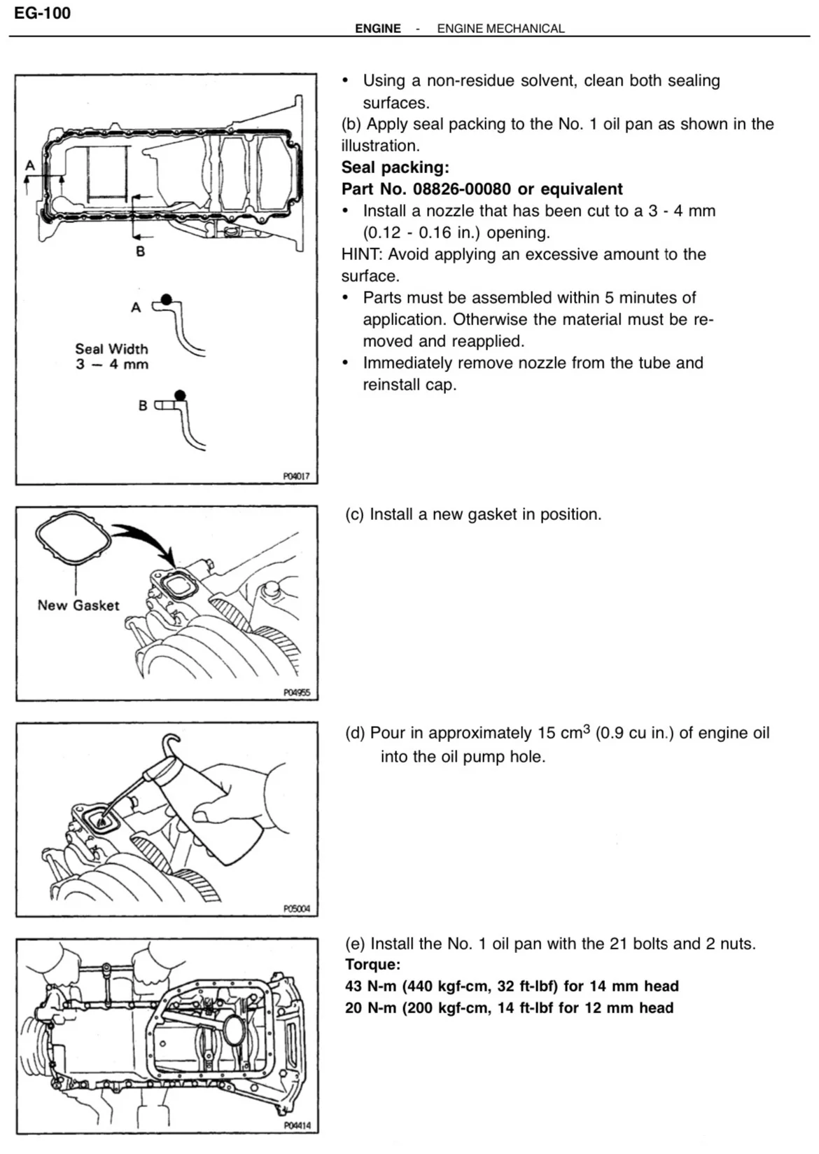

Was the oil pump primed during assembly? Should be about 30ml of oil poured into the pump intake in the timing case.

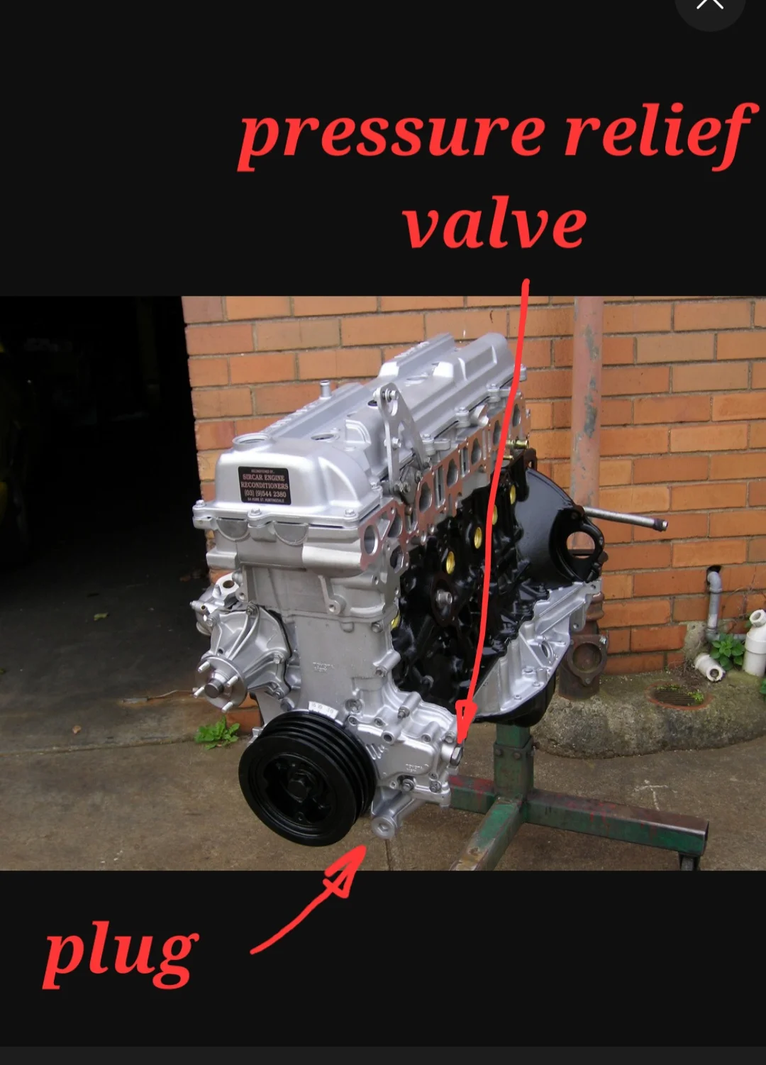

you could try removing the big round plug from the front of the upper oil pan, and use a small hose to direct oil upwards into the pump intake to hand prime the pump chamber before cranking again.
Pressure relief valve is on the left side, about where the power steering pump bolts up.
Remove plug, spring and plunger to inspect. Plunger should slide freely in the port
This is less likely to be the problem unless debris is stuck in it, or there's damage

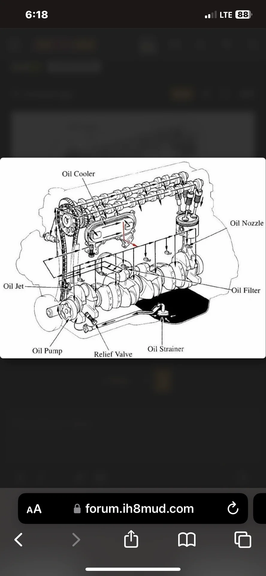

In the sketch I posted, the bottom red arrow is pointing to a large round allen key plug. This is the oil intake from the sump pick up. It leads up to the oil pump.
Zoom in on the pic
You'll need to prime the system BEFORE the pump.
The oil pressure relief valve is AFTER the pump, you won't be able to prime the pump from there.
Zoom in on the pic

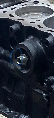

i feel like without having the engine out of the truck and upside down you wont be able to pour oil into the pickup location and get it where it needs to be. if there is indeed an airlock problem I would pour oil in at the oil filter location the (it runs down hill to the pump. if you poured oil in and waited a bit it would get get past the clearances in pump and then it should be full of oil.
Oil filter will be the easiest and for sure will go into the pump housing. Your oil filter will be dry as the pump has not filled any oil into the system yet. Don’t fill it through the brass oil bung fill it through the slotted galley to the left of the bung.

Is step "d" the oil pump priming step mentioned above? This was taken from the timing chain installation procedure.
