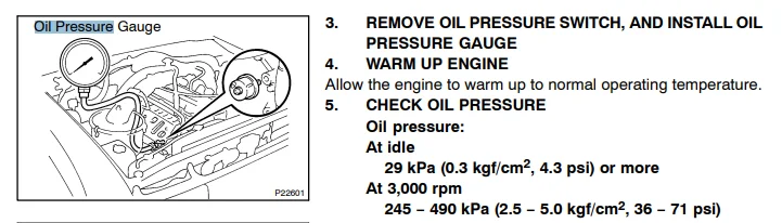

From the FSM:
If you drop below 4psi, I'd be looking at the same stuff @baldilocks suggested.
