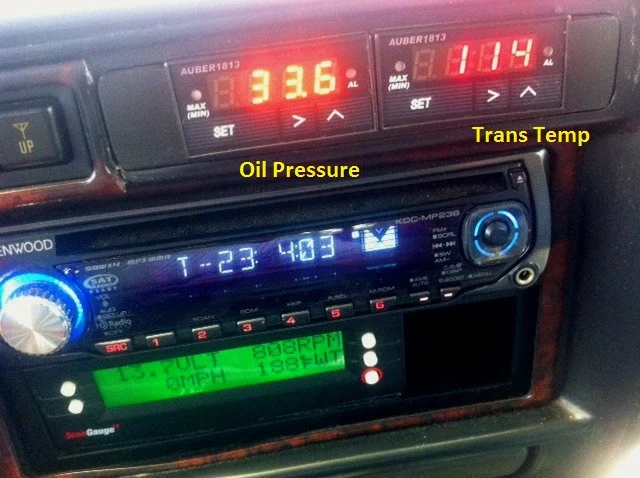

I run a digital Oil Pressure Gauge in tandem with my dash gauge. 'Auber' makes a nice digital gauge that can be mounted a number of places.
I run my Oil Pressure and Trans Temp side by side.
