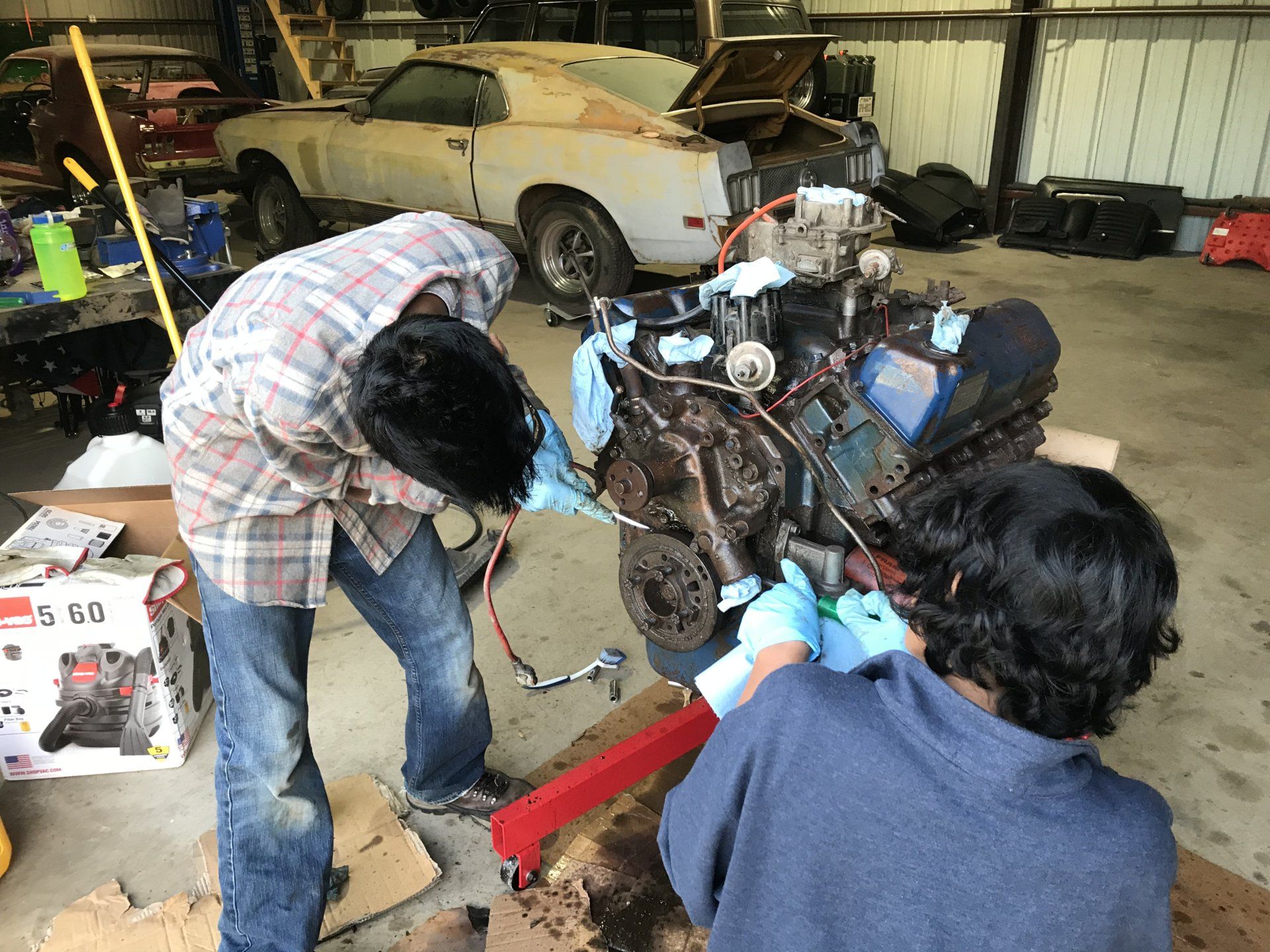

I am going through the same journey with my two boys now. 12 and 15. I love Cruisers. They love Muscle cars. Just stripped down 67 Mustang to repaint. Boys are cleaning up 351 Cleveland that’s going to be rebuilt. They are learning a ton about life. A recent awareness for them about design obsolescence..... One of them could lift the mustang tranny. Three of us could not lift my 80 tranny. Built to last aha moment.
Like many have said before, break it down to smaller projects. I have them do all the research on the next step. I guide them on what to research. Then they go do it. I support. Teach them safety. Have your son find good friends on Mud. So vital that they meet friends through this journey.
