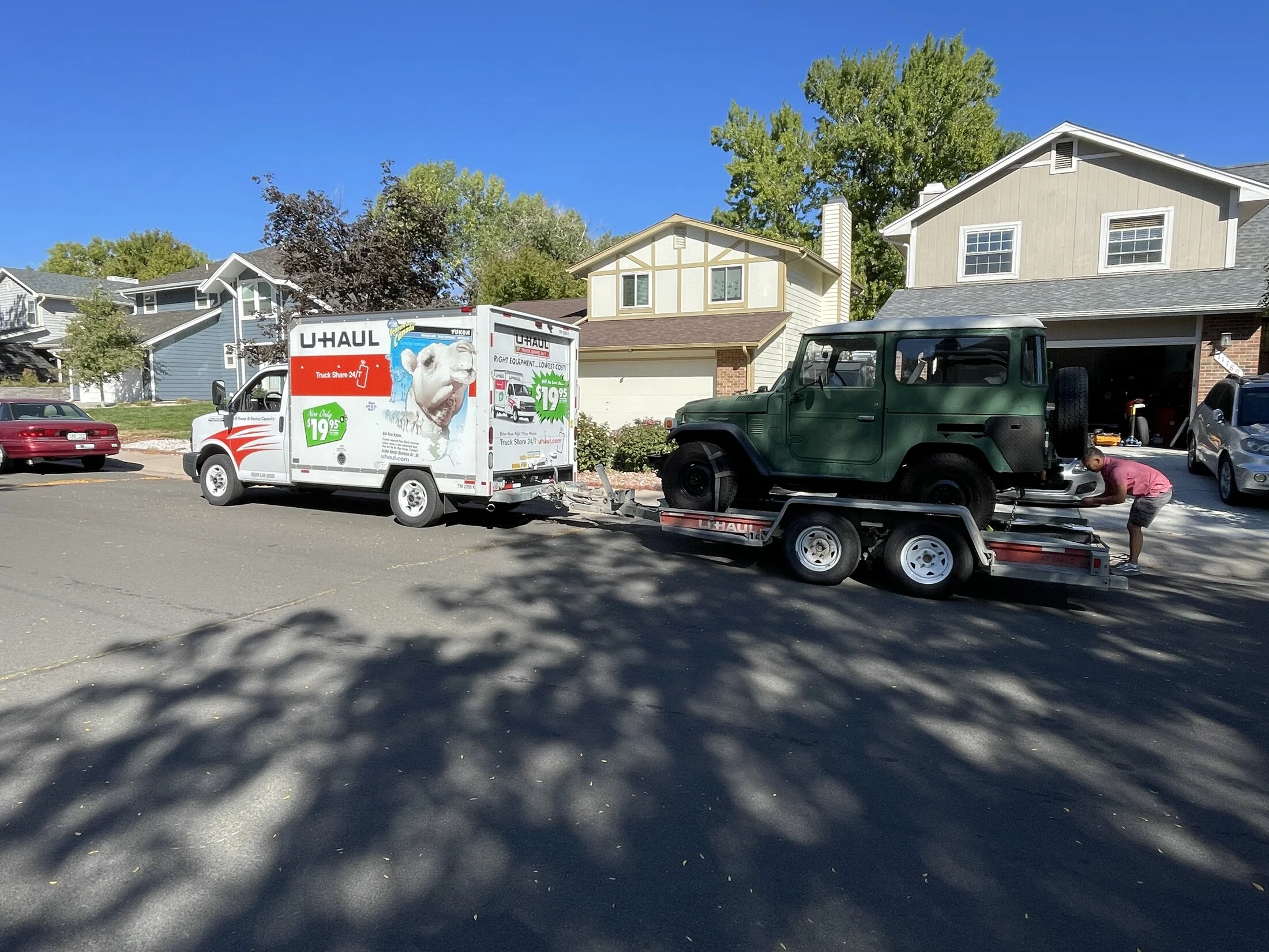

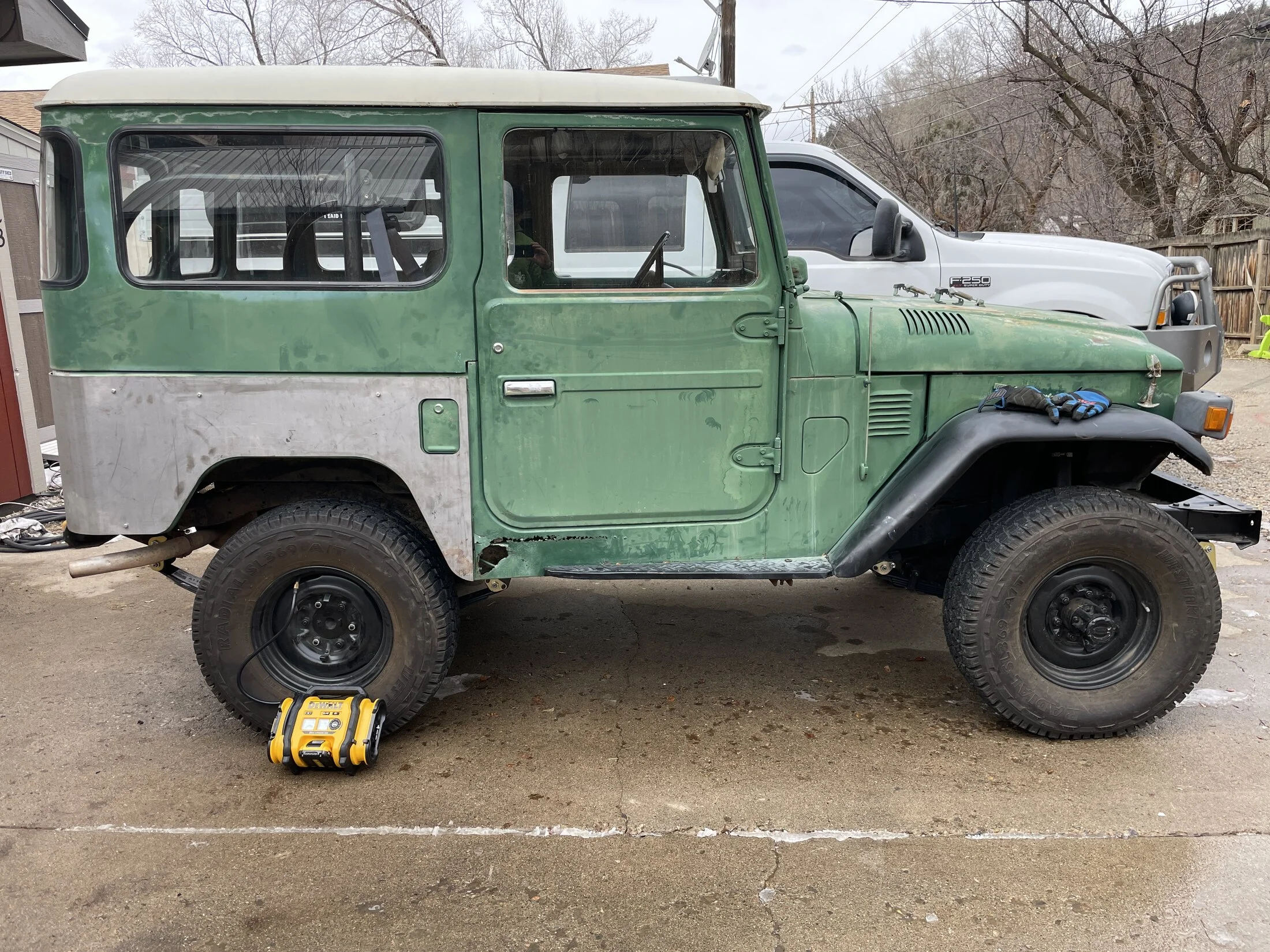

Calling this one the Ray. Story begins as my wife's uncle Raymond passed and he was big into restoring a cars and trucks. He had a 1954 Chevy that he had restored that was amazing (wish I could have bought that one). The last car he was working on was a 1936 Bentley, which was sold to someone far more qualified than me to restore that. Long story short, we wanted to restore an FJ40 in his honor and because we really like them. I found this 76 in Denver and it only has 40k miles. As a retired USFS vehicle it was well beaten, but all original. I flew up to Denver from Durango and towed it back and that is where the story begins.

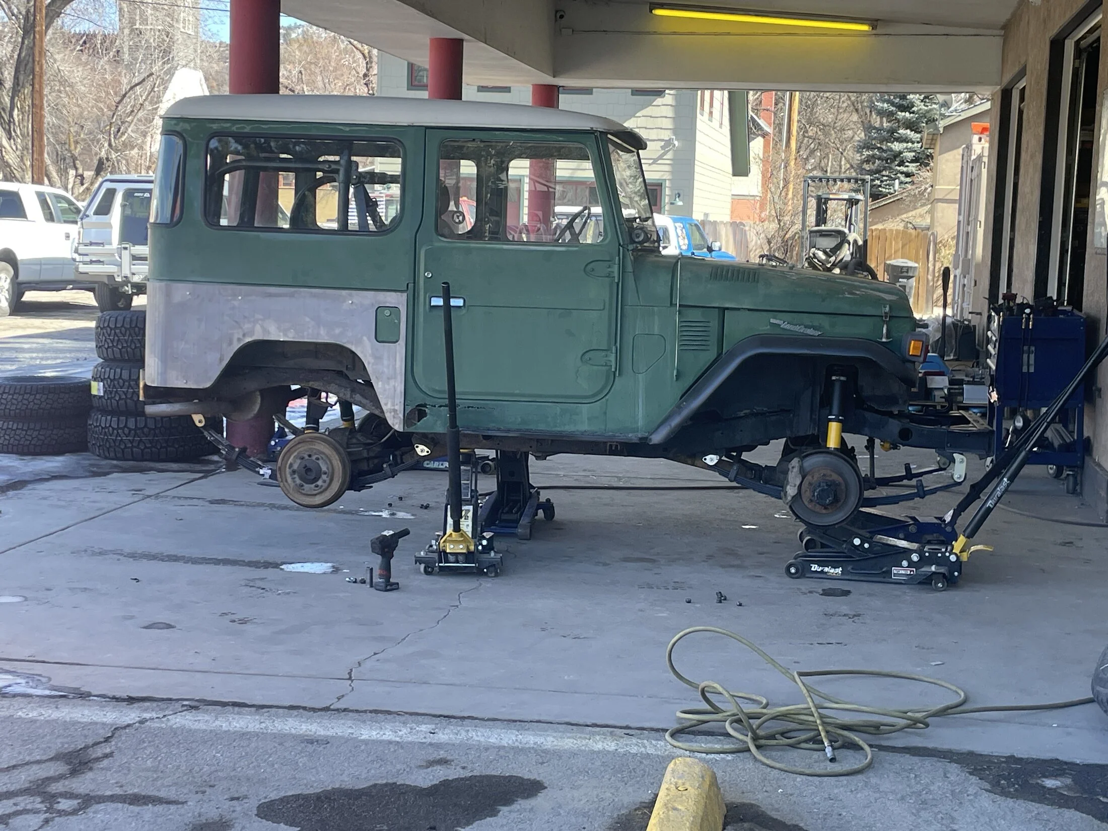

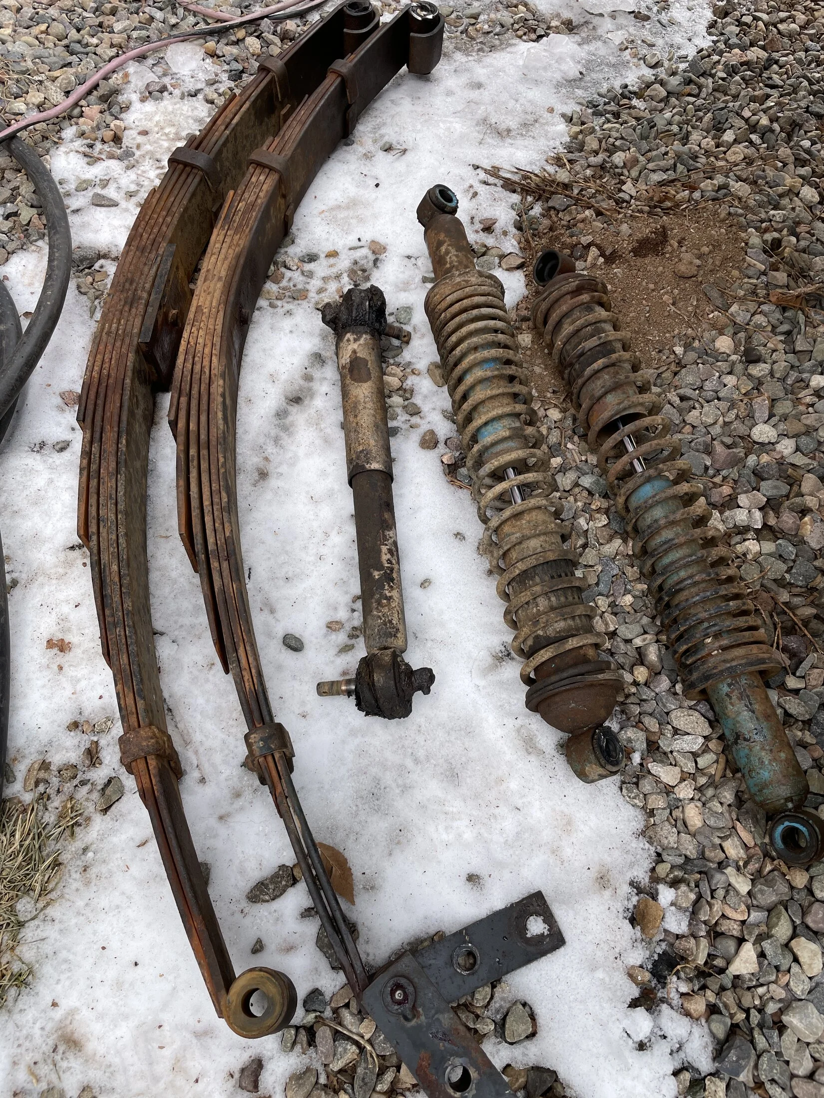

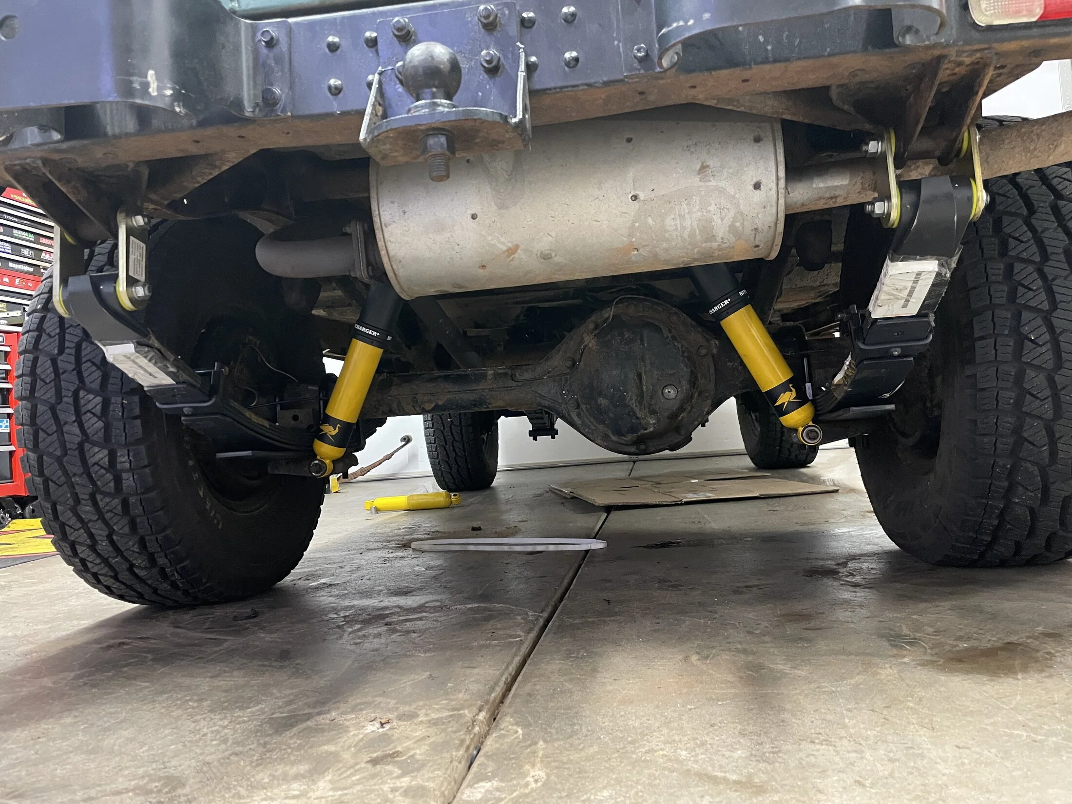

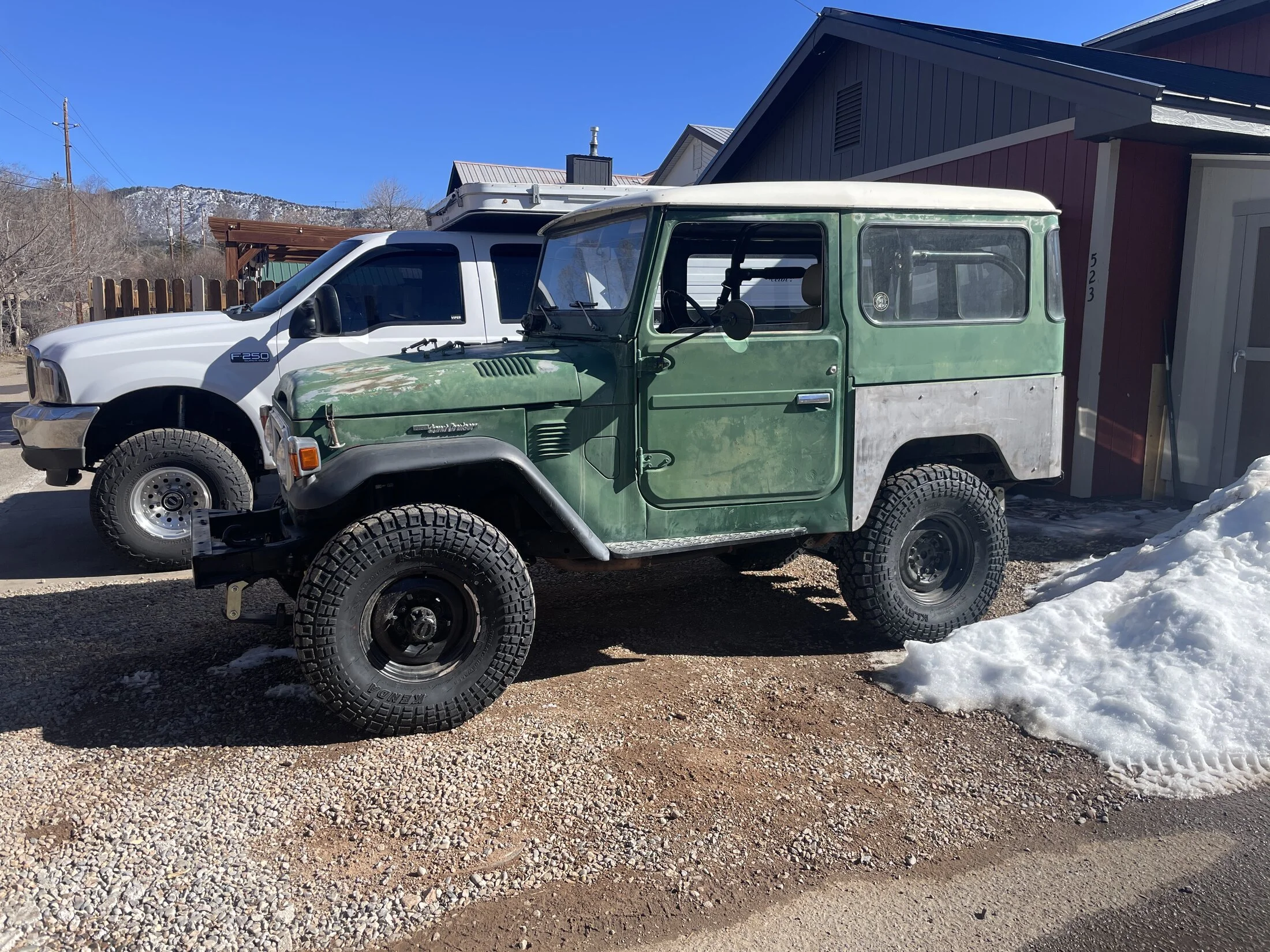

Once I got it home my first plan was to get it road worthy. Tuning the carb, fixing the exhaust leak and getting some new suspension under it was first priority. After a little tweaking on the carb it really surprised me how well it runs (original 2f). I went with the OME 2" lift and a set of 33s will be next on the list. At this point it's kinda taken over as my daily driver.

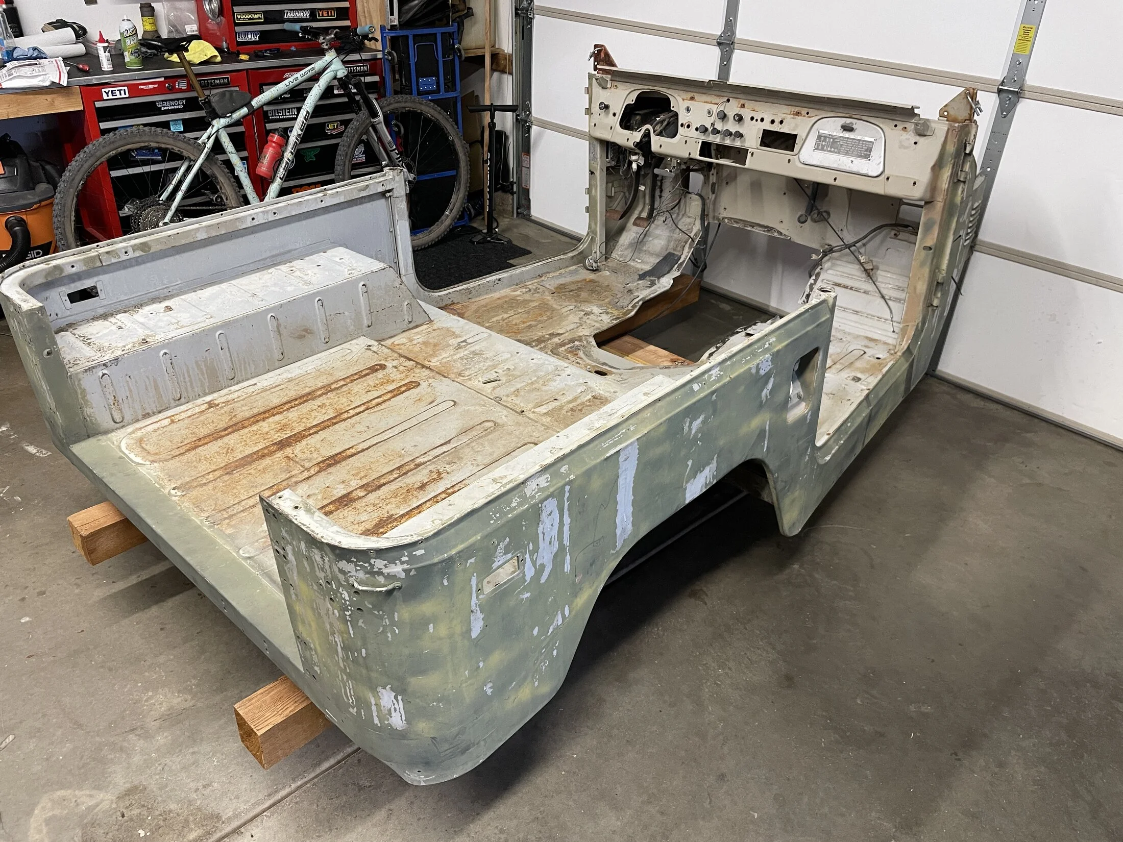

Lucky score! Just an hour away I found a rust free tub. Super stoked as this puts me way far ahead where I was planning to be at this stage of the rebuild. This is a 74 tub so there are a few modifications I have to make (rear door indent and door strikes). I got the tub and door strikes from some guys on this forum. I'll be using this for a 3/4 swap and will have the entire piece media blasted before paint.

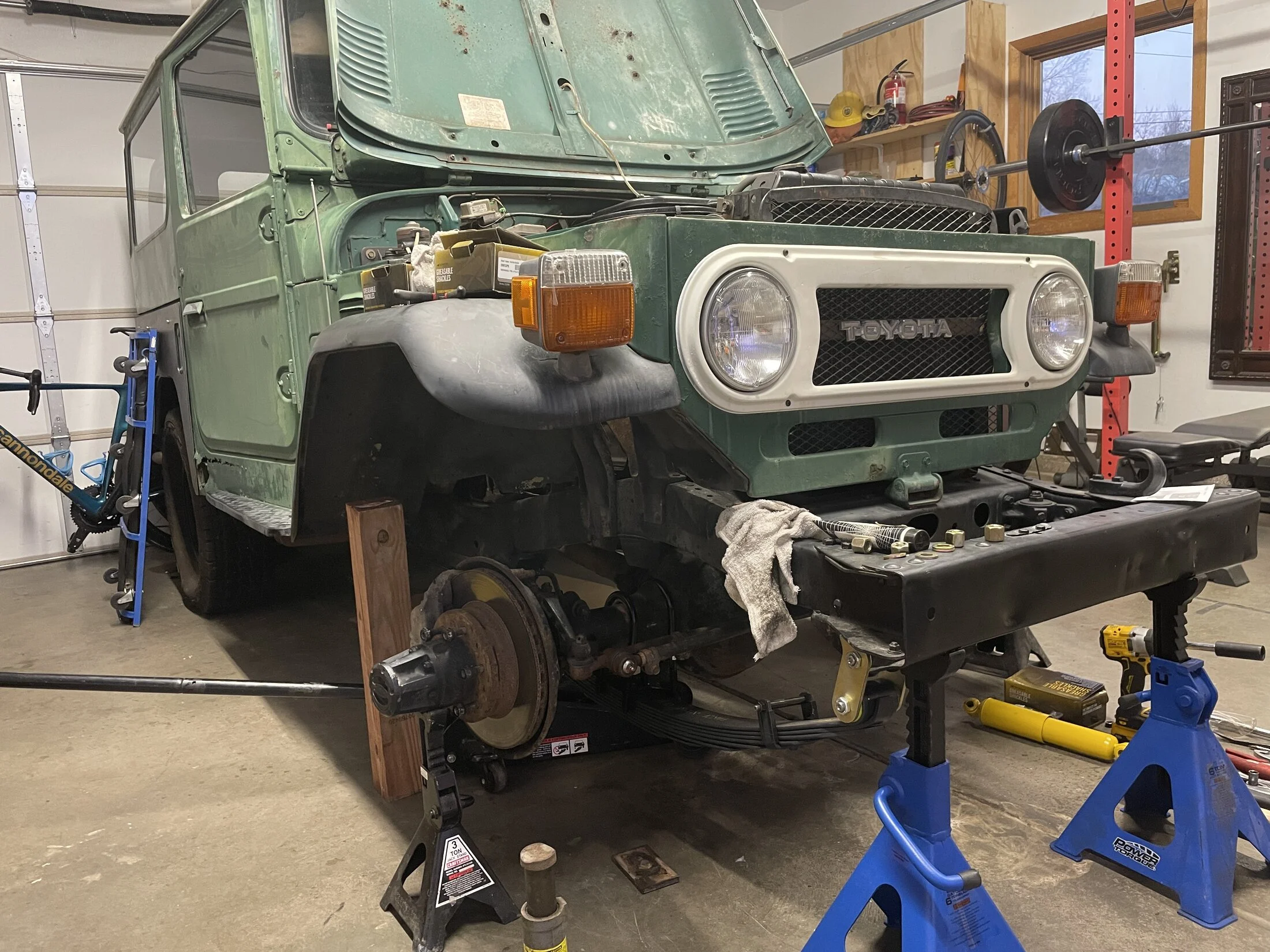

Few other things done as well. New clutch master and slave cylinder and starter.

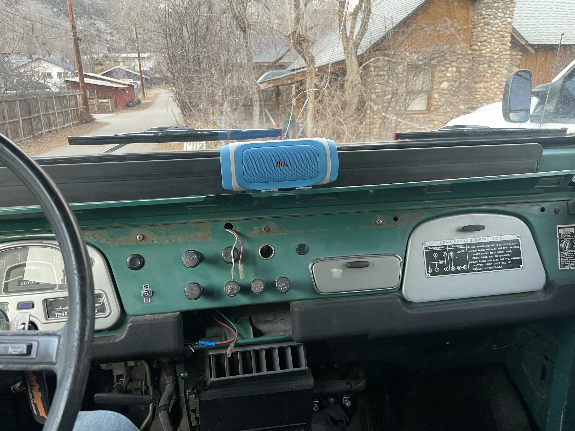

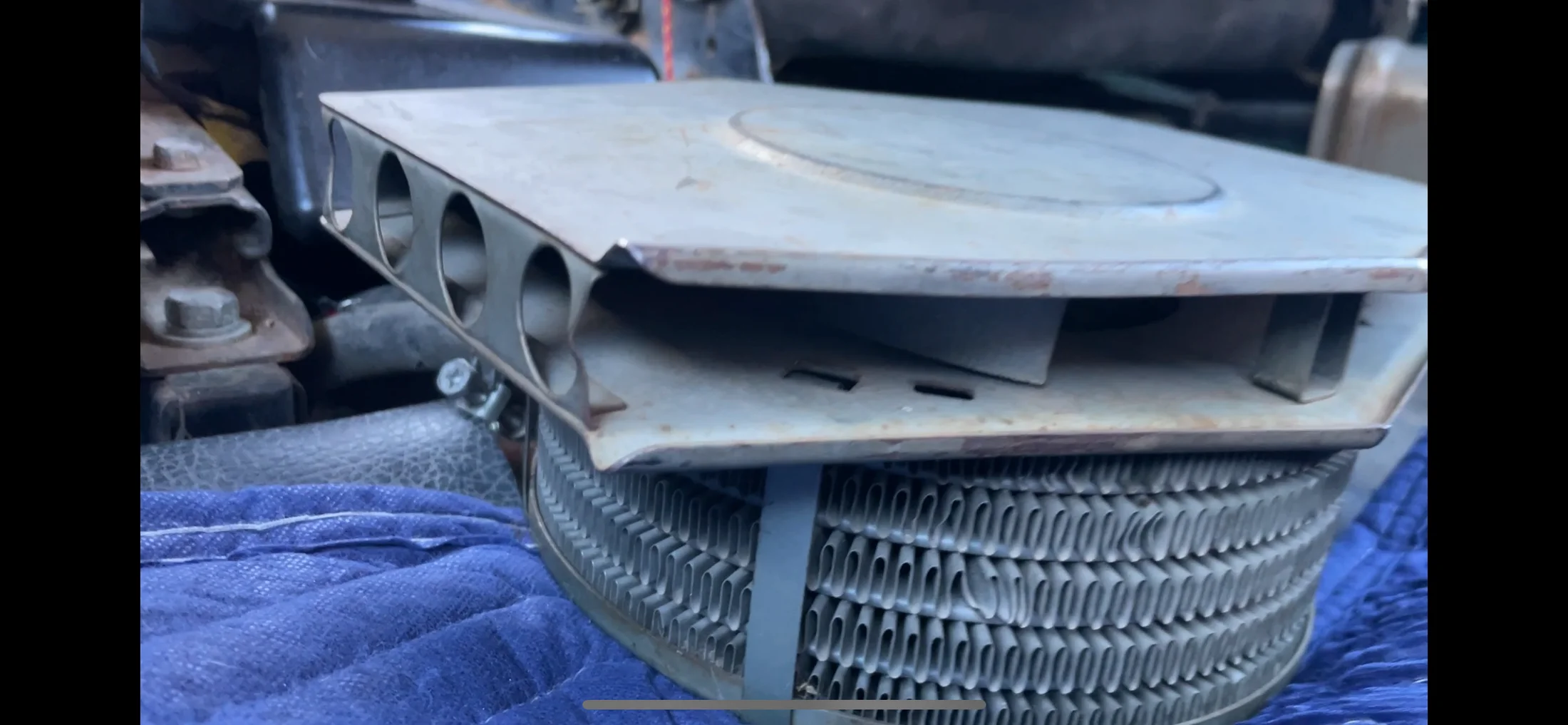

My rear heater had not been working but there were no leaks so I grabbed a new fan motor, now it's pumping out some good heat.
Even installed a new radio ;)

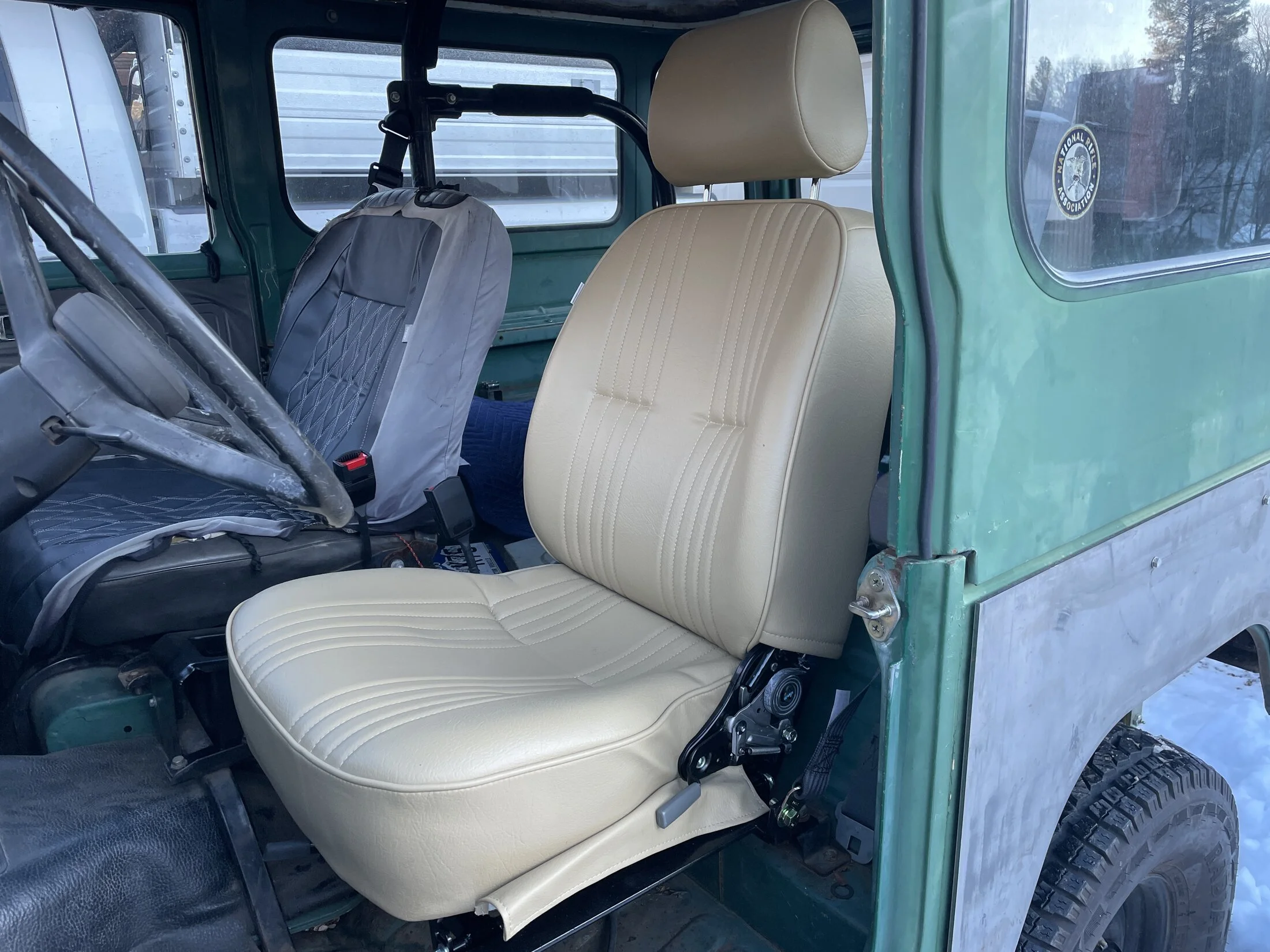

Not a big update, but a big update in comfort. I ordered my Procar seats when I first got the FJ40 and have been waiting on the brackets for a few months now. Well I got one of them in! Still waiting on the passenger side bracket but I got one of them in. This combo allows the seat to move a lot further back which makes the drive a lot more comfortable. No more knees in the chest.

Just looking at those seats makes my back relax.
Best sub $700 I spent on my 40.

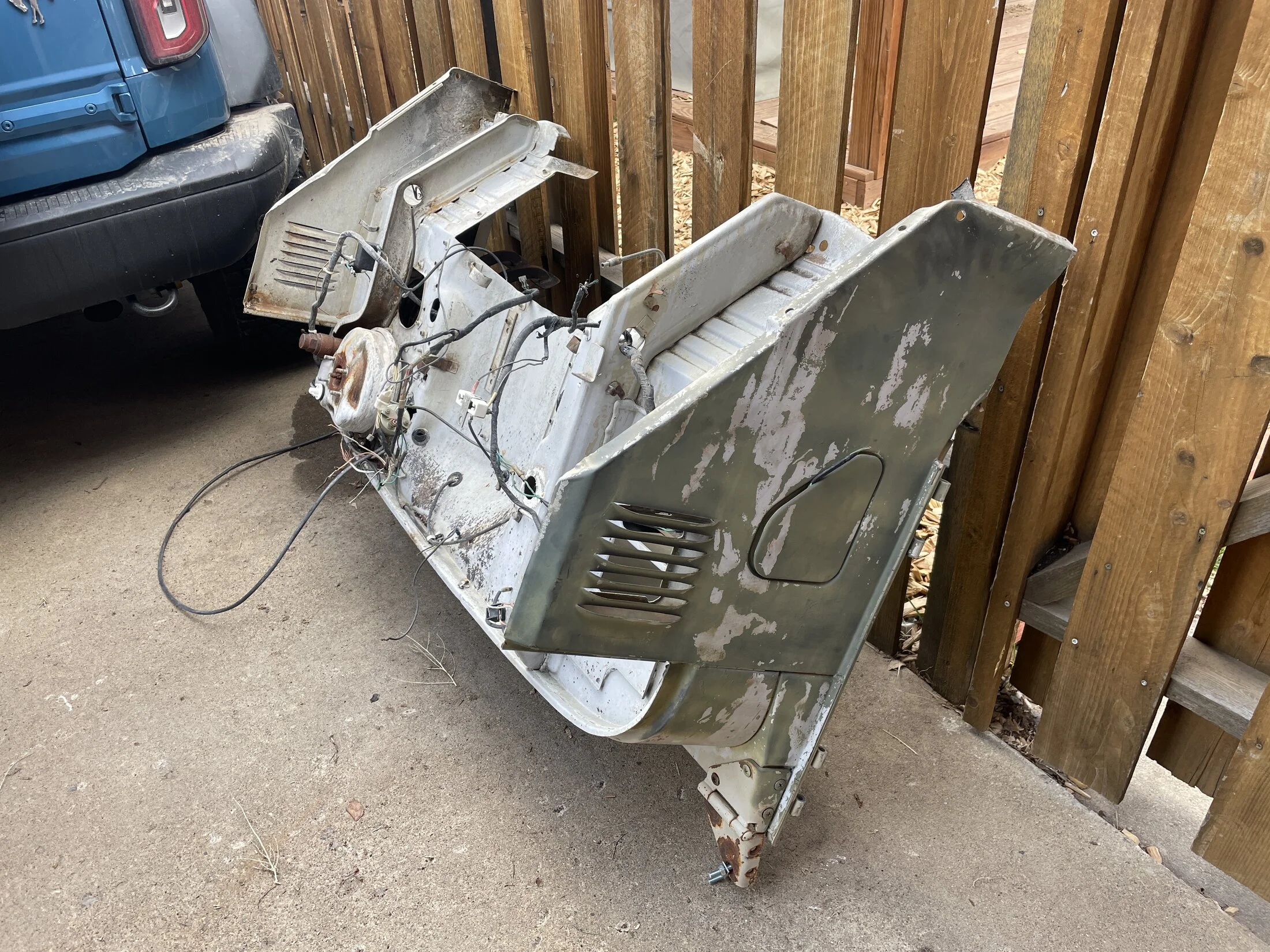

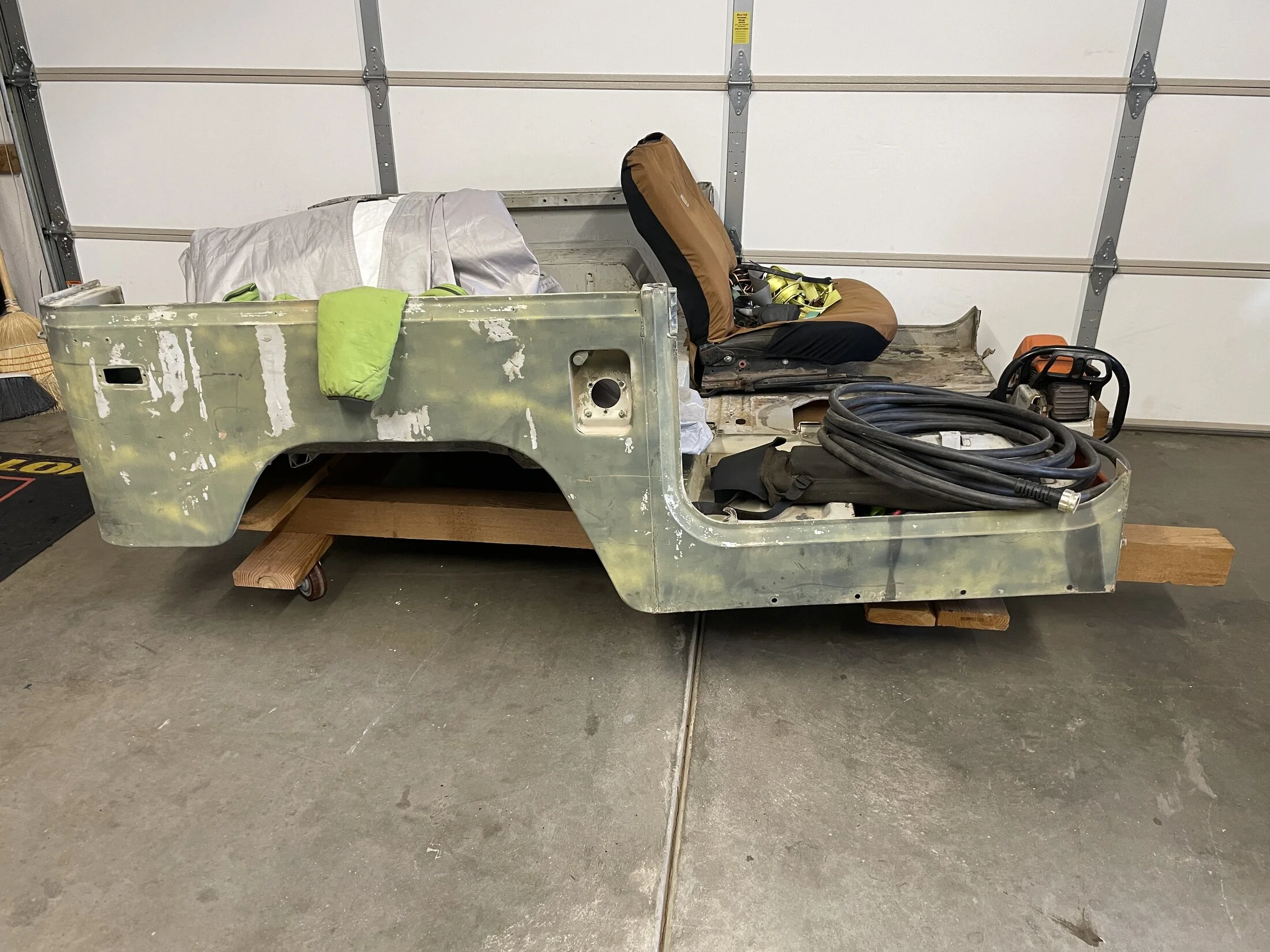

I've been staring at this tub for a while and finally decided to dive into the 3/4 separation. Using cutting wheels on an angle grinder, I cut out the metal around the welds leaving plenty of material to trim down later before I transplant it onto the running body. I didn't want to cut anything short so I figured leaving more material on the 3/4 section was better even though it pretty much left the front cowl useless, but fortunately I don't need that section.

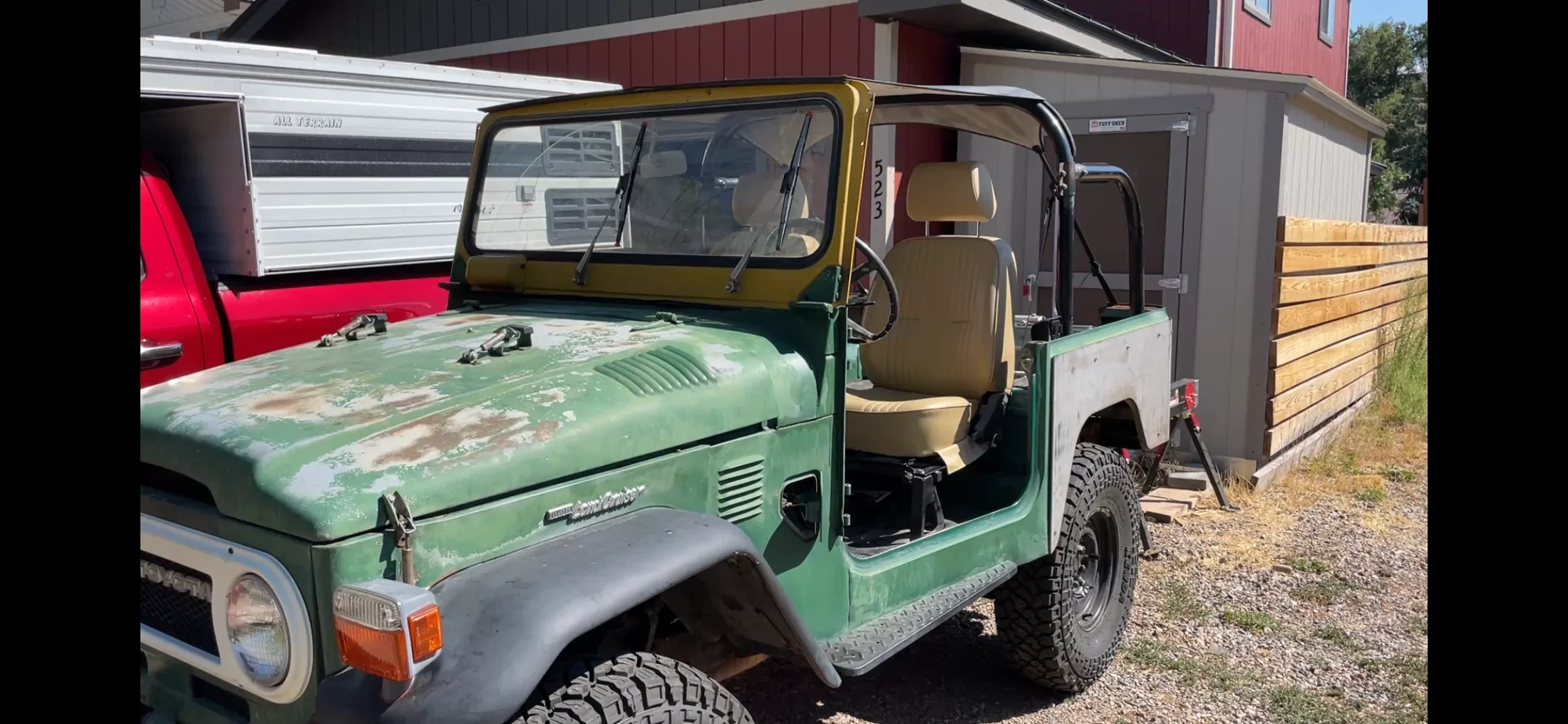

It's been a little while since I've made any changes to the FJ. Basically, just been driving and enjoying it for a bit. The need to make some upgrades and good timing on finding the parts aligned resulting in a new windshield frame including working wipers! To this point I have just not driven in the rain as the old wipers were not working and the frame had a lot of rust which barely held the old motor in. Colors don't match but the mustard paint actually has me thinking that could be the color direction later on in the resto.
