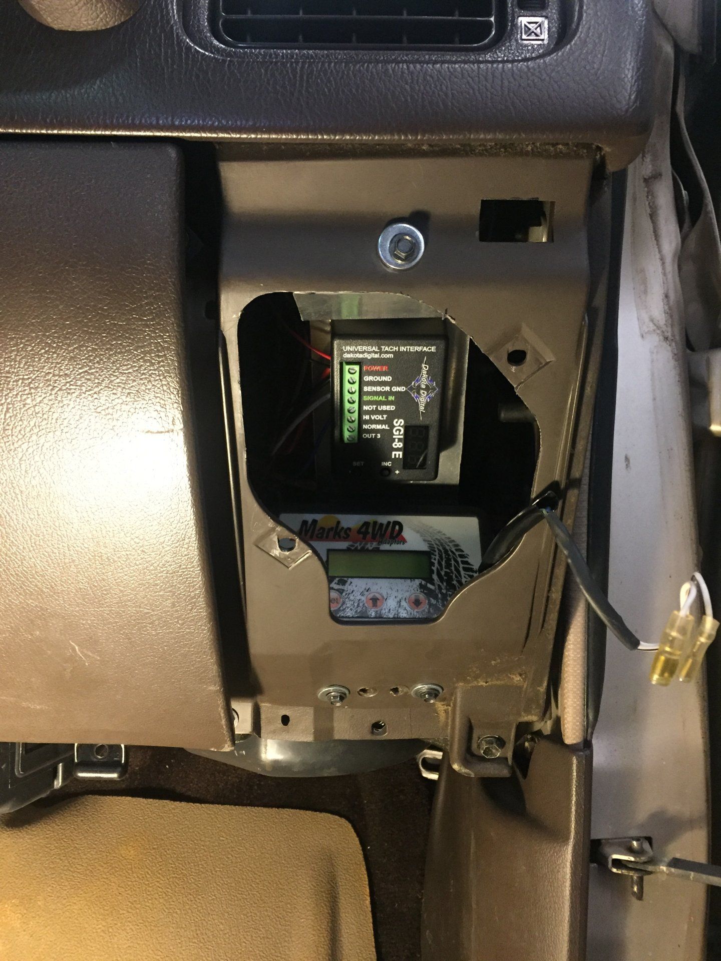

Need some help from those of you who have used the Dakota Digital sgi-8e for tachometer correction. I tried to get mine working this evening and couldn’t get any tach movement. (Running or in test mode) Box turns on fine and idicates it’s getting signal from the ECM. Maybe I’m hooking to the wrong wire behind the glove box?
Referencing @rockrod pinout sheet for 94s I assume this is the correct wire:
My truck is a 94 also, but referencing my EWD says the wire from the tach is black from the cluster to the igniter so I’m kinda lost. I’ve also tried using the “high volt” option as the instructions say it’s necessary with early Toyota clusters. I referenced @MarkN build thread and he had a pic of his mounted and he didn’t have hooked tothe “high volt” port, so I’m not sure it necessary on 80s.

So what was the solution?
Sorry, meant to come back and add what I did.
Short answer: I hooked to the much more logical wire highlighted below.
Unfortunately, I had deleted the partof the wire that lead to the Diagnosis port (per that sheet,) but I simply re-pinned a wire into the connector and all was good.
Once I found what to hook into, the Dakota Digital tach converter is a breeze to setup.
-Power and ground
- signal in from GM ECM (white wire)
- signal out from black wire from ignitor. Needs to be hooked into "Hi Volt"
-set input to 4cyl and output to 6cyl
I needed no fine tuning. Tach was essentially dead on out of the box with those settings.
Made an easily accessible, but completely out of the way mounting plate for tach and speedo correction devices by mimicking the way the (deleted) factory amplifier was mounted.
Simply pull speaker out if you need to adjust for some reason.
just watch for the speaker the magnetic field may interfere with the converter
and according alldata diagram TACHO wire does not go thru IH1 plug
It doesn't, but it does. It is not part of the engine harness and comes into the cab on the drivers side. From the drivers kick panel area it travels up into the dash and there is a splice. from there a wire goes to the tach, the other across the dash, through the connector pictured above on pin 4, and to the "DIAGNOSIS" port/datalink under the hood on the firewall. I tied into the tach circuit there and it works perfectly.
I completely removed the datalink port as it is useless to me at this point.
