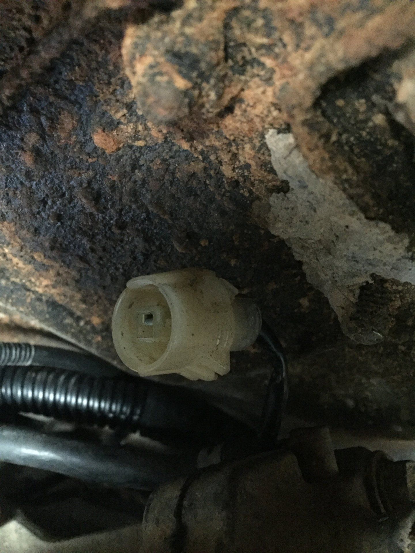

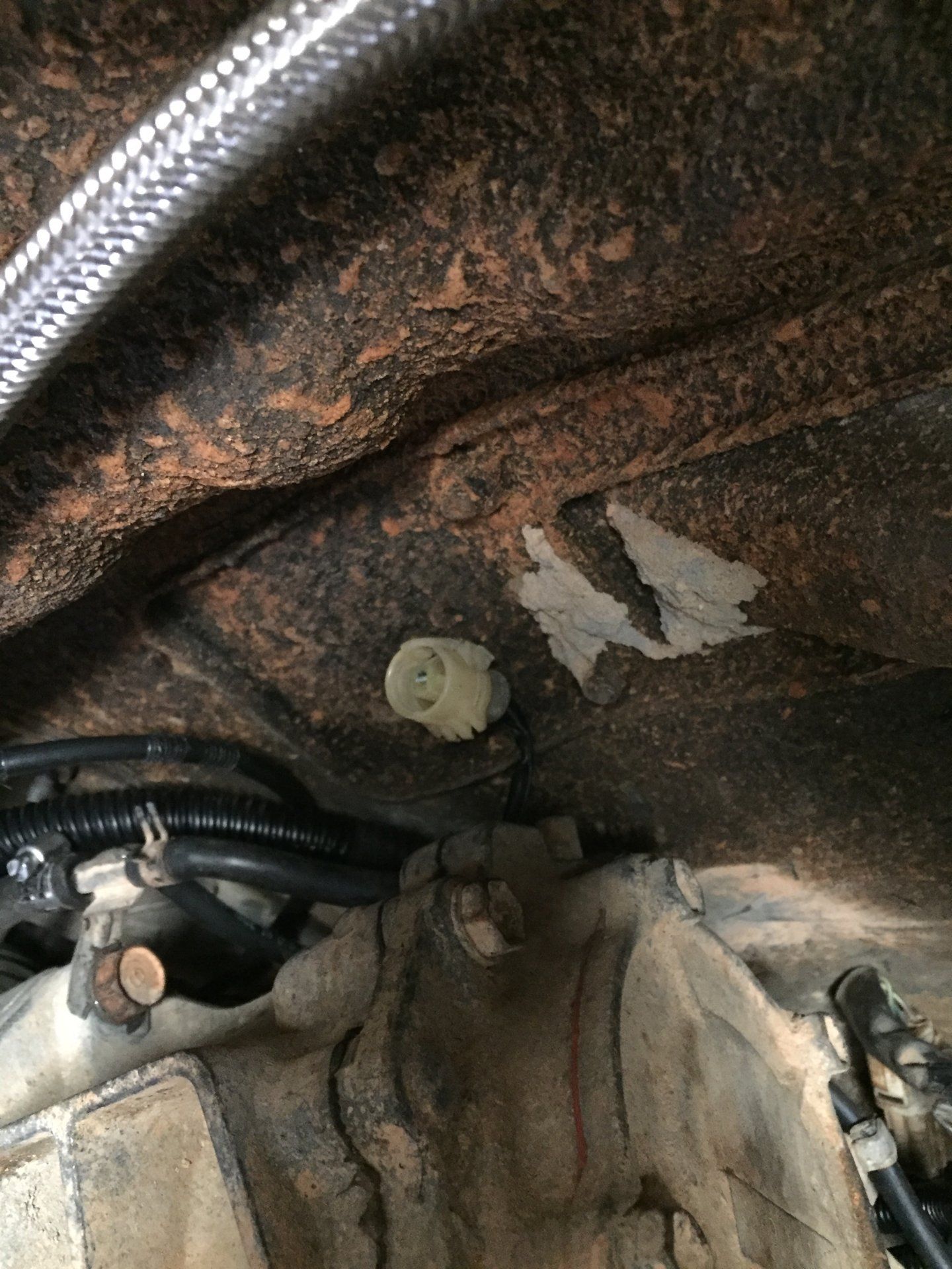

Alright guys, need help... I have no speedometer, and have been way too busy to tinker with it. (have been driving the hell out of the truck though:steer:)
I remember a few people in their builds saying that they had to go back into the t-case wiring because their speedo wasn't working and/or CDL not working. Inadvertently deleting a ground or something. The only ground I saw that I could see being deleted on accident was the brown one that was bolted with a large group of other wires to the rear of the 1fz's intake manifold. I DO have that one grounded. I actually ran it to under the dash. My CDL does work, just no speed. I bypassed the Mark's 4x4 correction box to rule it out also.
I did find a 1 wire plug at the t-case I left undone, so maybe it's as simple as plugging it where it belongs, but I don't see how it's related to the speed sensor wiring. Hoping to get a chance to work on it this weekend, so if anyone has any ideas throw 'em at me. Was going do a couple
0-60, ect. before/after videos but haven't yet due to this one issue. Thankfully it's the only one I have had.
Thanks
Oh and here is the plug I took a pic of a while back when buttoning up the swap. Hell, maybe this is the issue. Had forgot about it until I was halfway through writing the above post.
My problem with the dead speedometer ended up being the ground wire in the backside of the EC1 connector had a wire that appeared to be in place but was actually loose from the termination inside the connector. EC1 connector is right next to the PHH...
It will be the ground. That connector is for the Transmission fluid temp sensor of the Toyota trans
Thanks. I hadn’t thought of the trans temp. Makes me feel a little better. I looked high and low a place to plug that dang thing.
