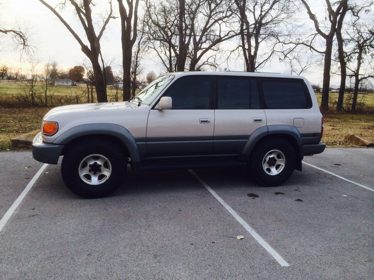

Now, to determine the absolute minimal lift height, in inches above OE ride height, to order up coils that'll eliminate rake and DS lean.
Guess I'll break out the laser and do it right.....
Unless you are commissioning custom coiled, coils, after doing a proper corner weighing with each of the likely passengers sitting in their likely seats and all current and likely cargo aboard, just order the OME stock replacement height springs and trim with trim packers. lol.
How long is a string? lol.
In my opinion no one will know until they get the springs on and settled. (Yes I know most people say coil springs don't need to settle, I think some settling is going to happen) then once the springs are on, if you want to get really picky, balance the truck about like you will drive it. i.e. half tank of gas, driver analog in the drivers seat any other things you might always have with you and then do your measuring and order trim packs accordingly. Doing it now when you have no idea the condition of the springs that are on it might just mean that you have some really bad springs and it won't be right when you get what you order.
Double the length from one end to the center....
There's a tangible value calculable from others' experiences.....just need to plug it into the equation and run with it.
30mm seems the popular elimination rake spacer, soooo:
PS rear unchanged from OE
DS rear +5mm
PS front +30mm
DS front +35mm
Not really concerned about DS lean, but might as we complicate the crap out of it and attempt to fix what ain't broke. :)
Measured from where?
Are you saying stock OE length +5mm, +30mm, +35mm and so on? Or plus from your current sitting height? Well you really can't go off your current sitting height as you have no idea the condition of the springs. And at true stock height I don't believe there was a rake. The rake comes from adding the OME springs which they value a higher back end to account for load. Which you may or may not have. IMO if you are going to do anything. You have to get fresh springs in first. This sets your baseline. The springs could be OE or OME and then if you want to get really picky about rake you can dial it out then. You can not dial it out now as you don't know how those measurements will change until you swap out the old dead springs.
... until you have a solid foundation to work from.
Methinks he's doing it wrong.

Ok so you are making my argument for me. You are taking OEM measurements specific to that VIN, and then going around the vehicle measuring how much you would need to level it out, but you are doing it on a vehicle that has 18 year old worn out springs and then adding (+5mm, +30mm, +35mm) and those measurements won't carry over when you have fresh springs whether OME or OEM.
Trust me I totally get the WANT to buy new parts for the new toy, but I still think I would get the springs you want to run, get them installed, give it a week or two of driving and then take your measurements.
But we all know this is going to end how every Chris wants to do it. haha.
Doesn't look stink bug to me..... I really think the stinkbug is because OME especially thinks there will be a load in the back.

Looking better, and it wasn't that bad....sorta. My OMEs stock heights did settle a tad, but it didn't take too long.

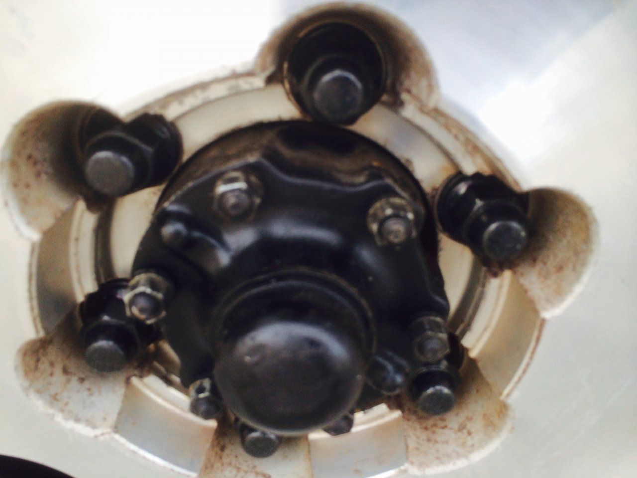

These are from Jason @ Cruiseryard and have center caps on the way.
I know I'll regret not refinishing before mounting tires, but had to be done before I took up Black and Milds.
Was gonna polish and paint, but don't know if the pitting is too deep.....but will figure it out.
Had no lugnuts, couldn't find any laying around town, so ordered OEs in haste.
