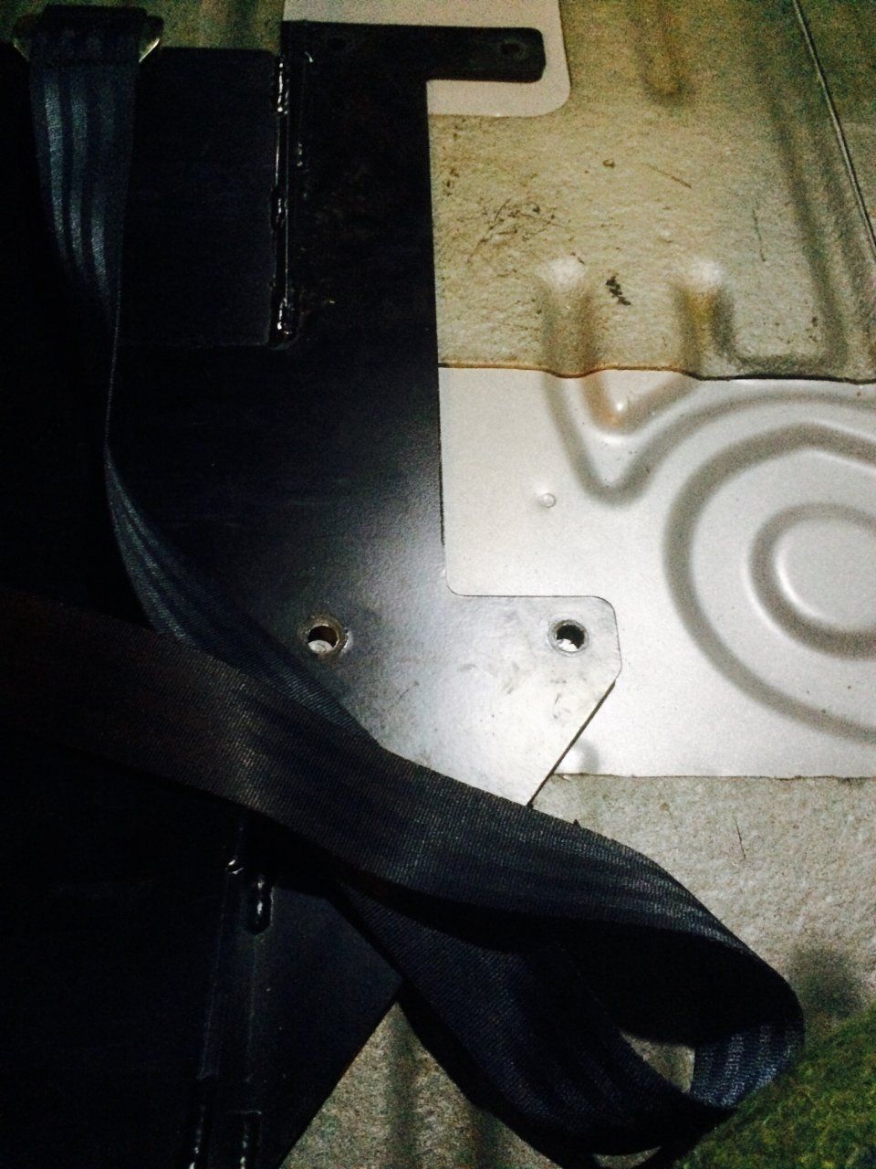

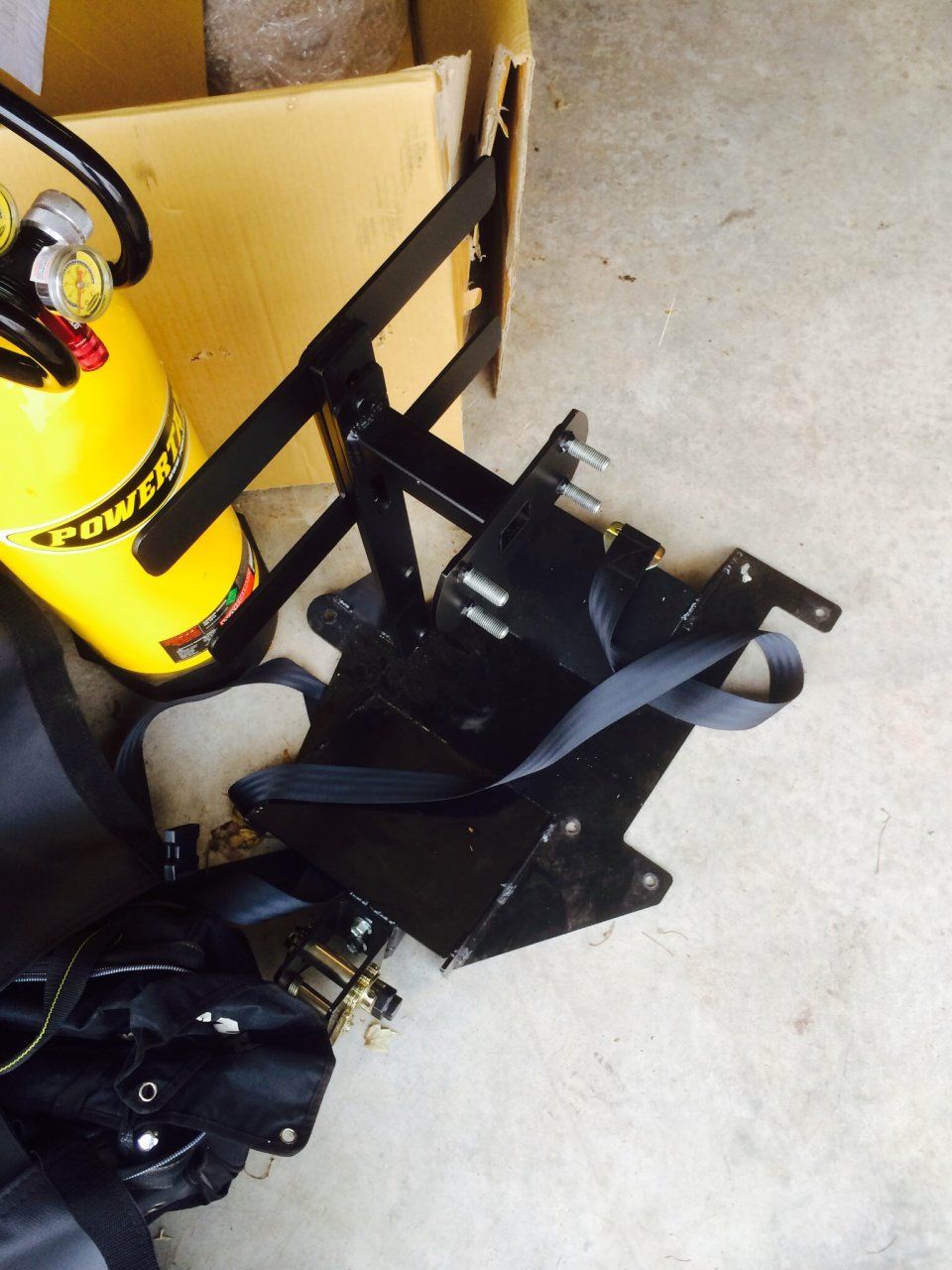

Since the spare mount performed so well in the roll and with an aversion to exterior mounted, figured I'd swap it over.
Well, there's not only no third row, but no provisions for anchoring either, so kinda in a quadary as to method to securely attach to the floor.
Don't want to overthink it, but don't want to get kilt by a spare neither.
Uncovered MORE speaker wire....
Can see where third row attachment would be....
Drill holes and through bolt with 1" thick ass fender washers on the bottom of floor?
Or over engineer and weld plate, like I'm assuming the third row would've had?
Where did you get this truck? I thought they all had 3rd row in the US. lol. I wouldn't trust fender washers with your track record :flipoff2: You could take the middle ground and just make maybe 3"x3" plates to bolt through that sit under the floor.
Guess I'll crawl under the 450 to see what Mr. T did, 'cause 3x3 plates sound a little janky.
Thinking about it, the base didn't impact the floor area's accommodations for the third row seats, but there were holes in the 450s floor, 'cause I just bolted this up and the hooks stayed put.
3"x3" plates sound janky, but 1" fender washers don't? ;) lol. Plates are usually what they bolt roll cages too. I don't remember what tire carrier you have. If it is Slee's than you have to drill holes no matter what.

Jonseys, now Duisers, but carrier is NLA, anyway.
Krawler busted the rear bead in the roll, I'm guessing, but stayed put, so a solid mount as tested. :)
Have been pondering using the OE carrier and saving the space in the back, this morning.

It this truck is going to be your around town truck and you are talking about stock height and maybe 33" tires. I would stay with the stock mount. Save the room, less deterioration than putting it on the bumper in direct sunlight, and you have as much cargo room as possible.
315 fits in Lexi but is tight. Receiver hitch won't work.
Gracias.
Guess I'll have a hitch to sell, too...
Kinda what I'm thinking.
Love the tire carrier and co2 tank mount construction, function, and obvious safety.....but it's only logical to keep it simple, considering.
Wish I'd have figured that out before pulling it from the LXs carcass...
Haha yeah that is how it usually goes.... You have an idea and then mull it over and after third and fourth thought maybe you would do it differently. But this is a lot better time to figure that out than after you have drilled holes. ;)
