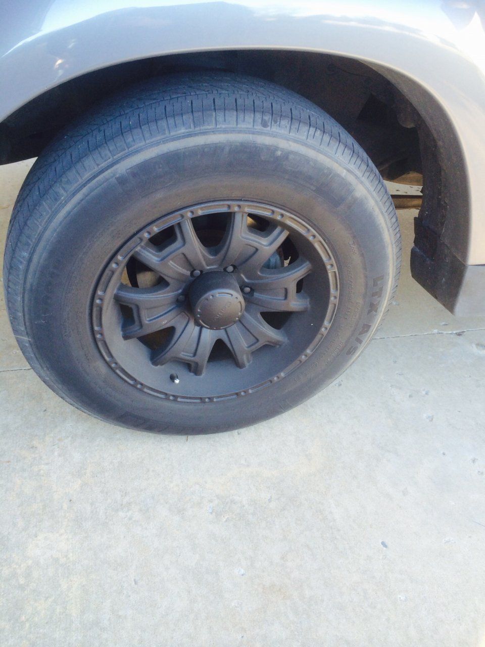

Give you an idea as to why I'm glad the clear glass is limo tinted?
