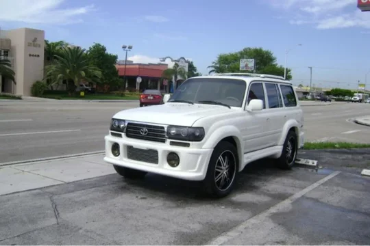

Translated as "Pink Panty 80". Long story.

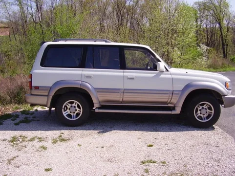

After a arduous search, I'll be picking up this 450 Wednesday from Missouri.
105k, two owner, elocked clean LX.

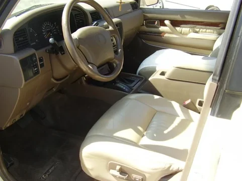

My initial project is to de-flare, de-clad, remove boards, roof rack and spoiler. The latter for aesthetics and to hopefully maintain less than 94" overall height. Install deadener at the same time, I'm assuming, and de-wood the interior.

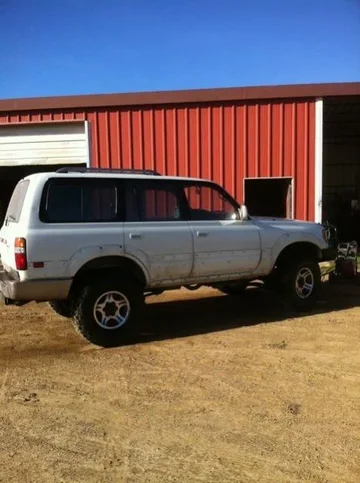

Pics from TexasD90s thread, for reference. (Thanks, and watching your build TD90)
I'm not a fan of bed liner, from past experiences and from an aesthetics standpoint, but after seeing TexasD90s "before" pics and input elsewhere, there's going to be a lot of patching involved, so requesting input about this choice.
