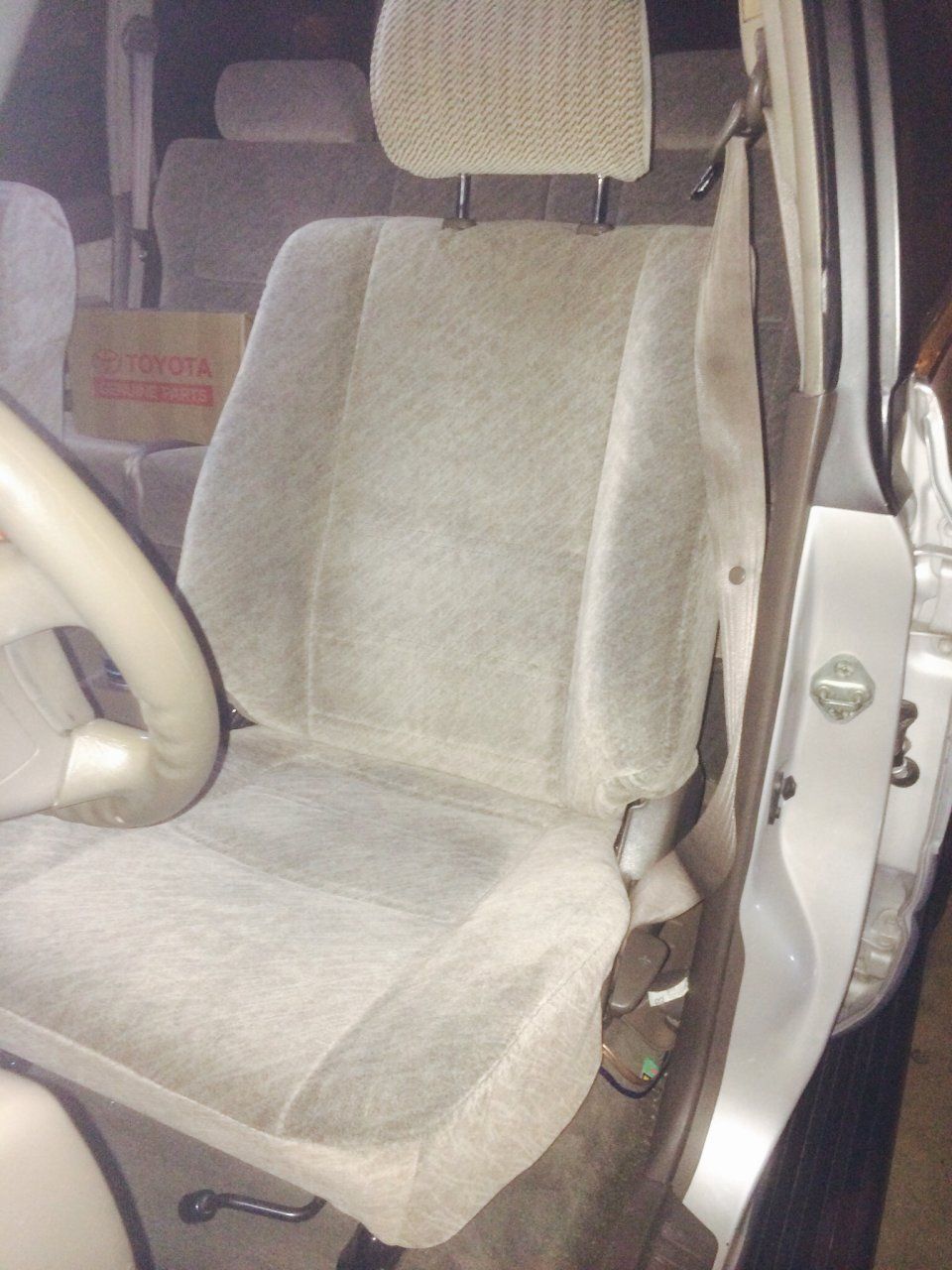

Please note the mismatched headrests.
I'm on a worldwide hunt for the two front that correspond, so if anyone happens upon, please bag the damn unicorns and I'll gladly compensate for the hunt.
I have no idea in hell how I found this thread, or this post. But maybe its some form of unicorn fate or whatnot. I have a very good idea where the headrests you need are. If you still need them lemme know and ill give you the info.

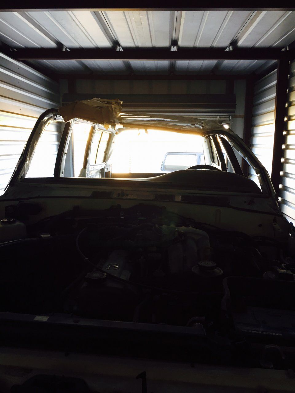

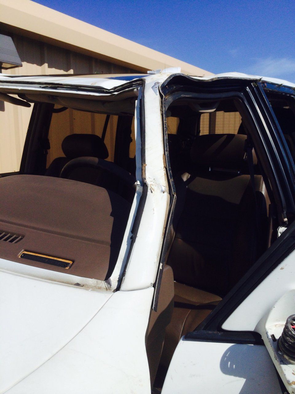

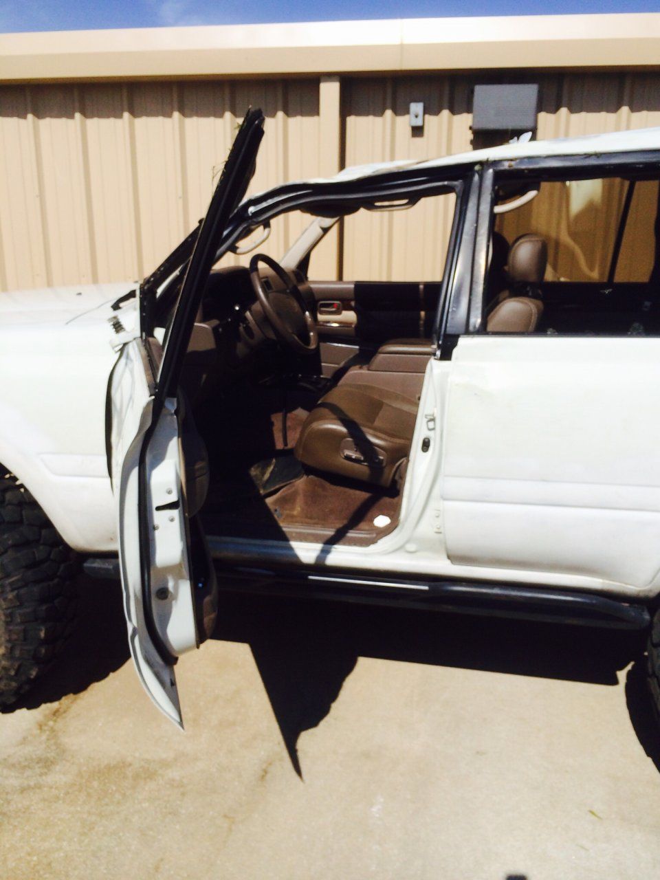

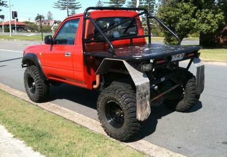

Kinda squirreled this thread with the inclusion of the 80, since there's movement in the ash pile that was formerly original thread topic LX.

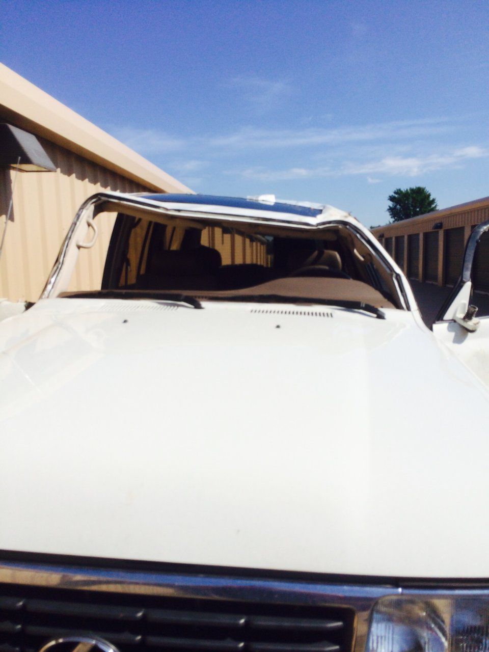

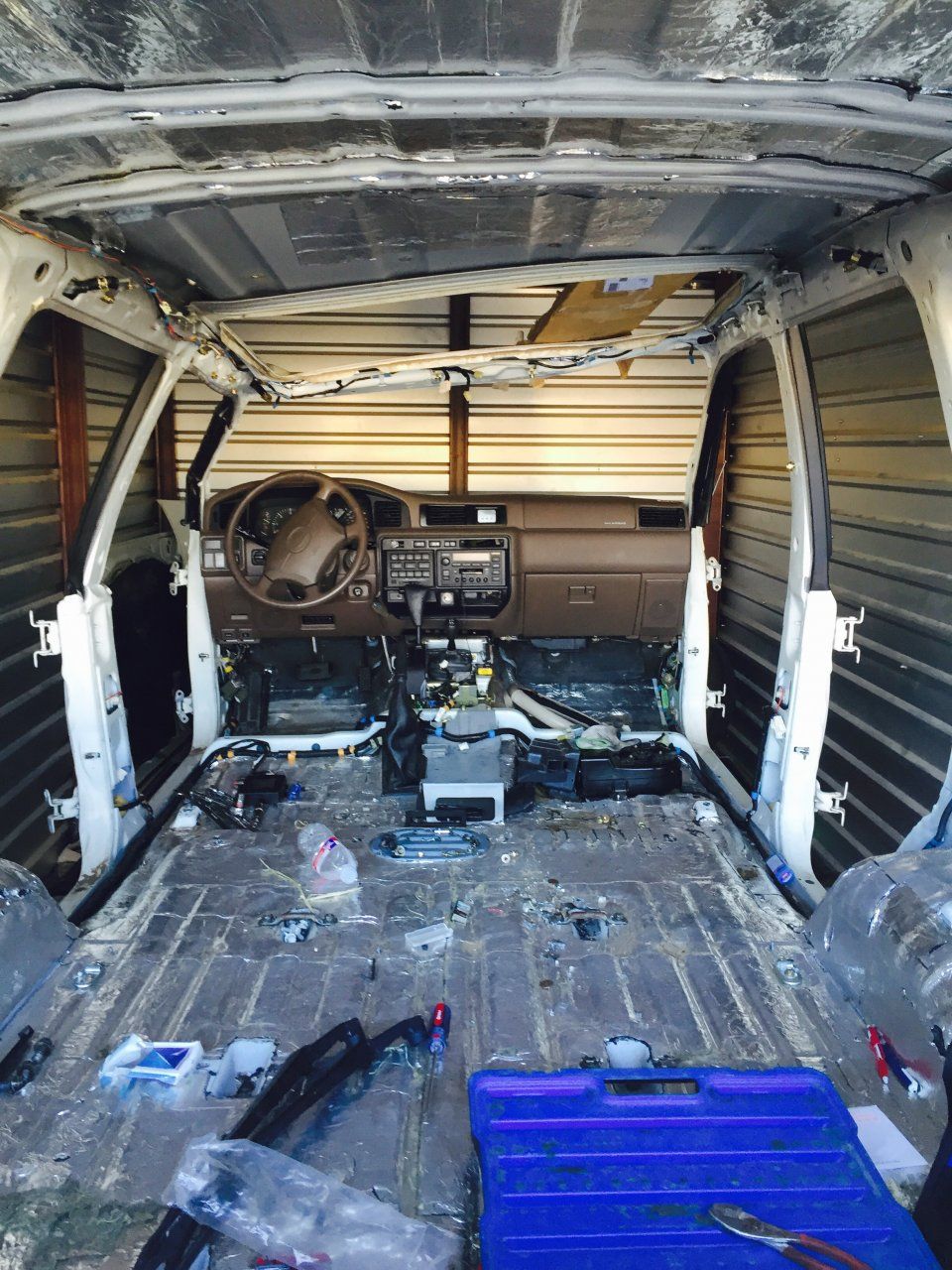

Guess I'll worry about sorting out later, but perusing body swap/chop options on the LX and hoping to firm direction in a few days.
Either option will result a single cab configuration, a dedicated wheeler more than DDer, but driveable to wheel and not look Sanford-ish on the journey.
Few questions I have:

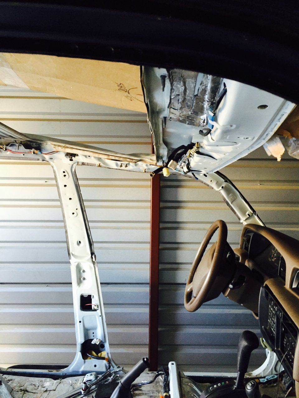

Can the a pillars be cut at dash and section a donor in, without it being an issue with windshield fitment or pose issues later I'm not thinking of?
How about the Bs?
Pretty much, thinking chop the roof off at the last portion of each pillar that isn't bent, welding a donor on.
I've not seen this done, but haven't seen many caged 80s, nor do I recall what's below, but is there any reason the cage pillar can't go to the floor by cutting a hole in the dash corners?
Will be figuring out in the next few, but contemplating these possible configurations.
70 chopped to 75 cab
A ton of work and may preclude usage this wheeling season. If I don't use for this, it'll be stretched and used on another 80 chassis in the future.
Prolly my favorite, but don't know that weight was saved, nor is it completely functional.

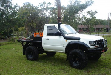

Extended

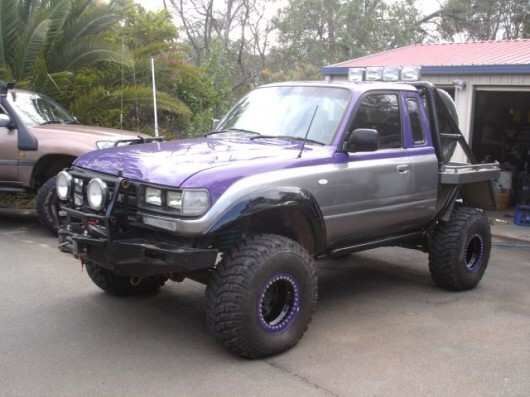

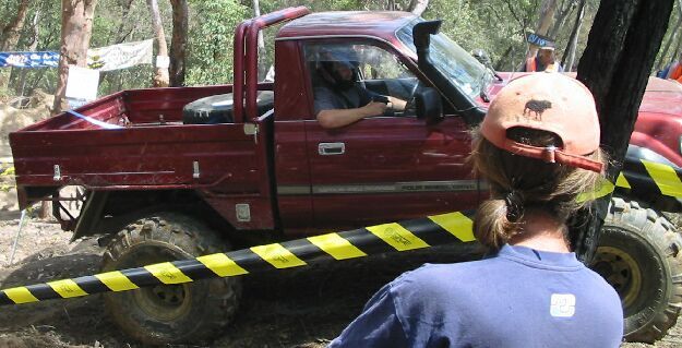

In discussions with Christo, he'd said the Javelina was the best all around configuration he'd built from an 80, which I think they coined "style side" in Oz, him suggesting body/bed separation.
Have to bob the ass end, a more functional bed, but may not address all ails, I dunno.
Bed wouldn't be that big of a deal and thinking a taco bed is, damn near, perfect width. Could tub for the tires, keep the rear intact. hanging the 80 panels off the bed rails.
