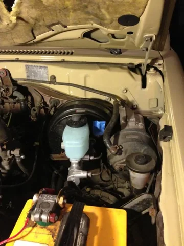

Sold a perfectly good brake booster, retrospectively stated, after installing a new OE, to Mudder Alberto SD some time ago.
My memory sucks and the fact that I wear many hats on a daily basis, none if which seem to fit right, make it difficult to recall everything, and had all but forgotten, until Alberto PM'd a "thanks" and "it's installed" yesterday.
Started digging and the rig it went on is entirely too cool not to post pics of, considering the organ donor status my PP80 played. Haha.

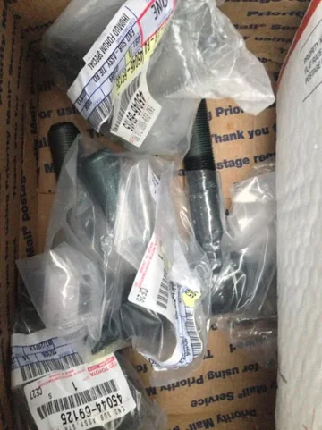

New OE TRE's to replace the RAF (acronym for "Rusty as ....") 555s, because ih8rust more than ih8mud...

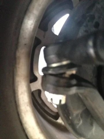

Swapped the rusty 555s for OE ball joints at all ends.
No matter the orientation of one, be it on a lift or on the ground, the other is in a bind, as far as I've been able to determine. Noticeable now after a few miles.

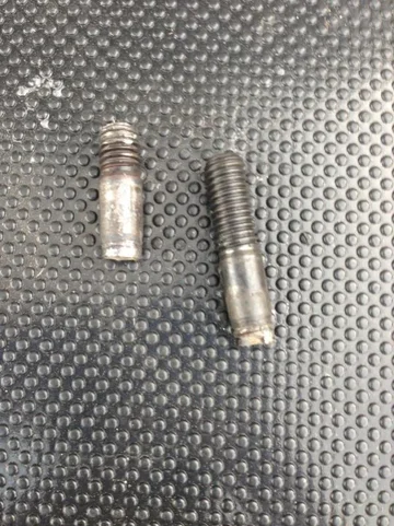

Swapped the ARP studs out for OEs, too, and trimmed the lug nuts. Be hunting a closed lug to conceal the hack job that became.

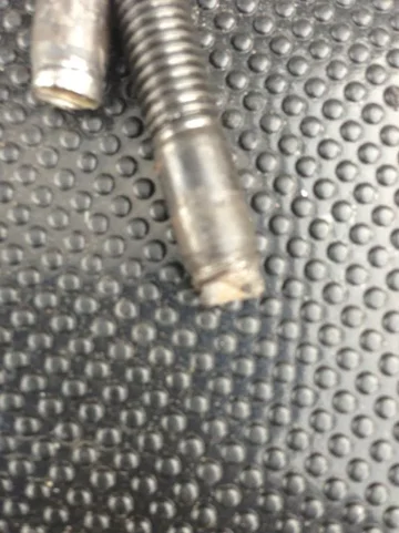

DO NOT INSTALL ALL WHEEL STUDS BEFORE FIRST CHECKING FITMENT as I did, forcing a surgery, like this. Winds up looking like chit.
Reason for stud swap was breaking one while tightening after checking wheel bearings a few weeks back (due to slop in steering that turned out being a nut missing on frame side front panhard. I replaced that, too, and checking all more regularly, since it'd be gone over before last trip out). but upon removal of these, several decided they weren't happy about the eviction and tried hanging on for dear life.

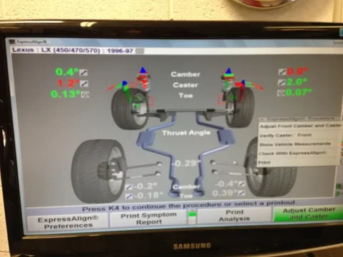

The front axle is a 1/4" to PS, rear 1/8" to PS, but can't get that minor of an adjustment out of the panhards.
Still feels a little dartier than before the TRE swap.
