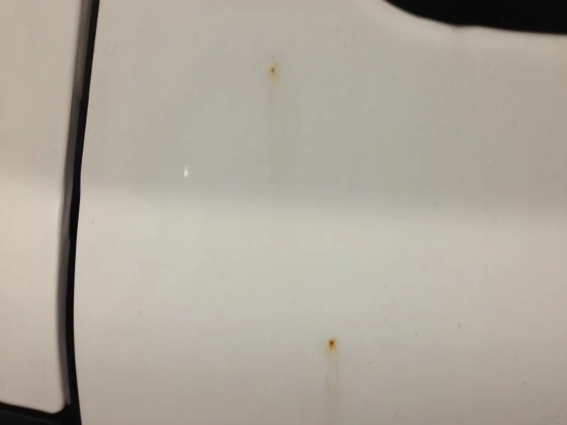

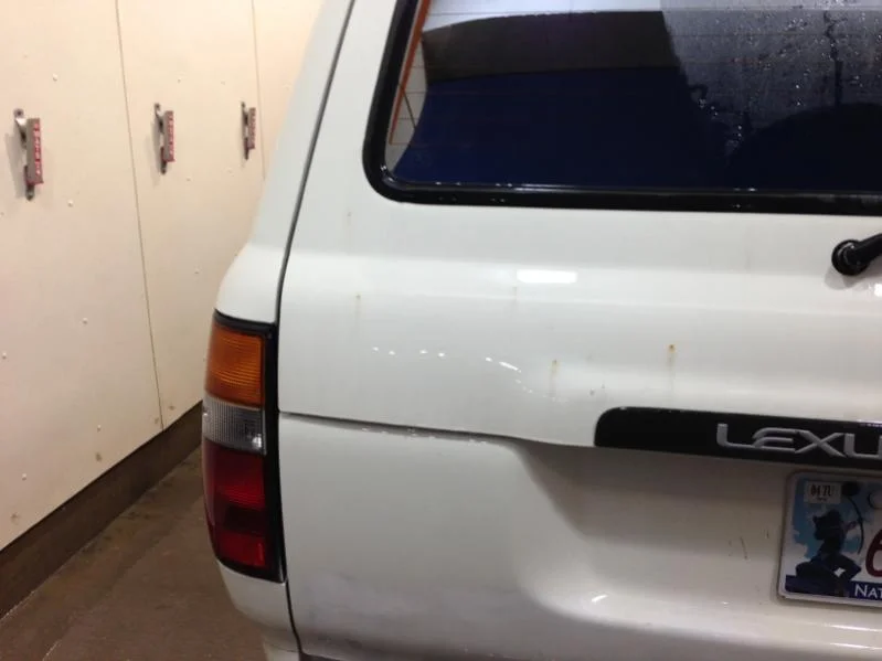

Have been in gripped within Tulsa's first snowpocalyptic event of the season, a deadly, shut down the city, winter storm of five days of snow and ice cover, sub zero temps, consisting of 4" of accumulation.
Yeah, 4" and the world stops here.
Anyhow, utilized the abilities afforded by the PP80 to traverse the town the last few, the entire time worrying about the ill affects of road treatments, hidden under a layer of ice and grime, so much so, I was at the car was in 26 degree temps, this being the first day opened in a week, to cleanse the impurities from every surface.
It has appeared.

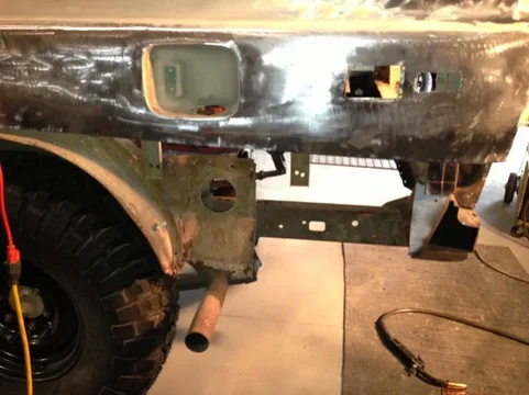

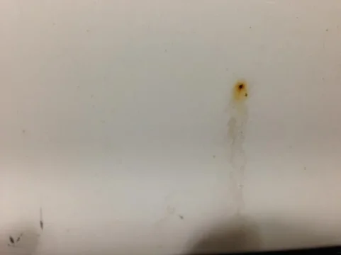

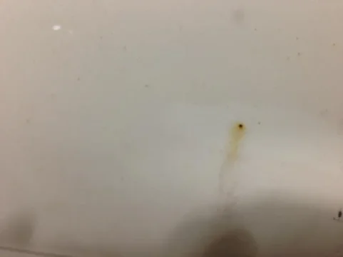

Four small spots on the upper hatch....enough to send me over the edge into the abyss and yank the body off for the full treatment.
It's gonna drive me nuts!!
Why, much you ask, would such a minuscule amount of corrosion be enough to warrant such drastic measures?
Once it begins, it eats at the very core of TLCs, deteriorating every bonding fiber of her being. If left intended for mere moments and in the blink of an eye (long, very long, deliberate 41 year blink) it'll reduce her to this.
Sadly, it was port installed on all LCs, so remain ever vigilant....
