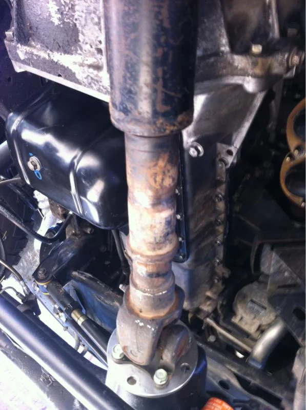

Cliff notes of another issue.
Lifted and bent the OE drive shaft.
Had a DC DS from AJIK, so installed and it vibrated horrendously.
Sourced used OE shaft from beno, lengthened, installed new u joints, balanced and seemed to correct the vibration.
Robbie regeared the diffs using the new spline output, refreshed the TC with new bearings and seals while installing the TC gears, then installed the freshly rebuilt shaft described above.
Called me during test drive (truck driver's waiting, so under the gun) stating there's was a problem, but he was confident that the gear pattern was correct and, even after I stated all the above, was going to pull his DC shaft and see if that corrected the growl.
It did and he left it on for me to drive with and have one built accordingly, (Thanks again, Robbie) but I'm under the gun to return to him by Monday, and having a hard time sourcing a DC joint (already tried Rick), and was concerned that spacing the front coils would alter the geometry enough to be premature ordering a specified length from Rick, since he offered.
Now that options have presented themselves to possibly have an outlet for the rear coils (than you, Rob) and leave the front alone, going to attempt to pull all necessary info from Robbie's loaner to build new shaft to, but my question is,
What changed to cause the previously functioning front shaft to vibrate (I love and hate that word, at the same time)? Is it possible that that the new flange decreased the distance enough to bind, or could the old bearings have allowed for more tolerance to the lack of DC?
Feel stupid, considering Josh restocked the DC I had, that now may have worked, so attempting to understand the cause.

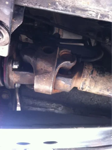

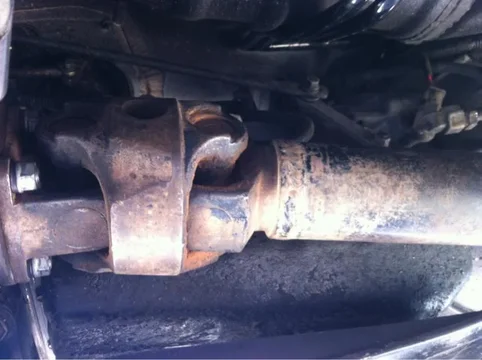

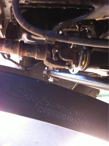

The vibration aren't caster to start with. His caster is correct. It's the pinion/out put angles on the front shaft.
The issue with a cut and turn with stock 80 axles is the interference of the tie rod with the front arms. Depending on which plate system you use you could get more correction from the plates before you have interference issues.
And if you do do a cut and turn the position of the high pinion diff will be steeper and possibly effect the lubrication of the outer pinion bearing.
Landtank, Yep. Pinion and tierod clearance problems. We just bend the rods here to clear. But to do a wheel alignment a tierod needs to be removed, adjusted and reinstalled. It's honestly not worth all that effort. Just get a part time chris. You will never look back.
Fellas, I have no vibrations with the ~ten year old, loaner shaft from Robbie, save those of the tires.
My question was more along the lines as to why, considering the shaft prior to diff and TC work didn't vibrate horrendously, BUT AFTER it did, and a previous DC shaft was a failure (not the shaft, but my set up ) yet this one is a success.
Reason I'm asking is in hopes of furthering the general education of myself, and the four to five others a day that post about this same issue.
A recap.
Could new bearings affect the driveline enough to cause this scenario? (DC shaft no worky before, DC shaft worky well now)
Pics of Robbie's shaft that DOES NOT VIBRATE.
