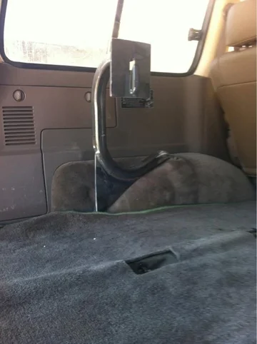

Test fitting the spare carrier.

More info needed on that tire carrier... I know there have been a couple threads on these.. That unit looks nice....
P.S. Your build thread is surely inspiring future addicts everywhere...;)
Thanks, Chris
Very cool. Jerry spent the time on it to space it far enough from the well that access is still easy to the compartment and it allow for a conceptualized WagonRack behind, plus it'll fit a true 37".
As far as I know, it's the last of it's kind, but Jerry'd be the one to talk to about. Hate to speak for him, but considerable discussion and a little history proved advantageous for me.
https://forum.ih8mud.com/merchandise-storefront/543125-interior-tire-mount-91-97-fj-fzj80.html

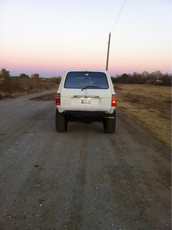

Front bumper and sliders on the way.
Will be modifying both, to some degree, and attempting to fab a rear to "match", hopefully with aikirilo's buddy that has serious skills.
Was thinking about running the rear wings to the edge of the inner fender lip, then bracing inside the fender well back to the frame.
Haven't seen any like this, and figure there's a good reason why, so hoping someone can enlighten me.
