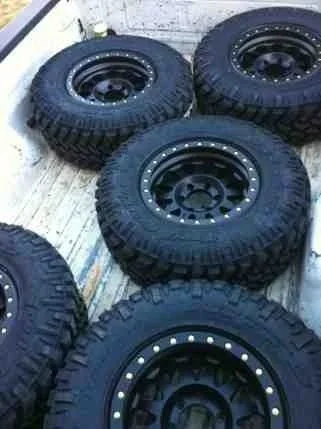

Buddy's Methods done
I don't care much for mounting tires on bead lockers, right now.
Conventionally balanced and tech at well renowned local shop said they were the best balancing he'd ever seen. Considering they've been in business for 100 years, guess points go to Method.
Slated to install tomorrow with other items on the D4D FJC.

Hey - Why don't you put a couple on your LX450 quick before you mount them up on your buddies FJ... Just to see how they look...........!!!
Way too small and think he ordered 4.5" BS, anyway.
I almost mounted the TRs with 35s from mine, just to see the widened stance.
But ain't breaking these down until the cords are showing.
If you have time to acquire, keep an eye on PolyPerformance open box page. Have seen several deals (where I got the 35s for FJC) there. Not many on 16s, but if 17s could be bought cheaply, may make the decision easier to move up.
I paid full retail for the KM2s on the 450 from the same shop that balanced the Methods. It's a local company called Dino's Wheel and Tire and have bought tires from them for many years. Felt bad not buying the FJC tires from them, so but the bullet on the 345 KM2s.
I really like KM2s. Best overall tire that wears very, very well and doesn't chunk in the rocks, but the side walls are still too stiff to warrant bead locks (less than 15 doesn't seem to buy much), and bead locks are a PITA, anyway.
ALL THAT SAID (I type about a thousand times more than I actually talk) I'd think FJC 17s would be a viable alternative to OEs. Equivalent weight, same strength, and a lot more options for tires.
Will have a set in the garage tomorrow that will, more than likely, be for sale for reasonable money.

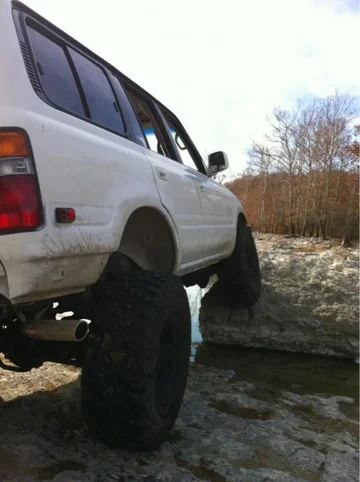

Little afternoon wheeling, with issues.
Realized two things when posing here, and reason for photos.
First, had felt a tremendous amount of play in the steering since returned, so much so, thought the alignment was off so racked it after futile attempts to minimize play by setting toe in the driveway. Aligned perfect Friday, so figured I had a stabilizer issue.
Not the case, but turns out the play adjuster nut was nut was loose, discovered when checking out shocks in the shot, evidenced with the 2 quarts of fluid spewed out on the rocks.
Tightened, filled, and all seems good, but will revisit when I hit the house with the FSM and fortune wrench.
Also, in the pic it's positioned where the PS rear wheel is spinning (natural RTI ramps rock) which was a little disappointing, until seeing that the rear OME is topped and the PS OME is bottomed. I don't know how much more usable shock travel is necessary, but more than the OME L's are capable of.
Going to measure at RH, deduct 4" of up, and see what total length will fit, but betting it'll be close to an 12" travel shock with more down, considering the rear binds long before a total of more than 12" is usable.
Good day out, even though mechanical issues abound. aikirilo is limping home with a stripped drive flange after several hard days of wheeling. Hopefully can make it to the house without any further damage.
The Marlin gears rock. Probably the most capability increasing investment possible for the 80. Locked in low, there wasn't and incline or decline that taxed and didn't feel the tires slip once.
Parting shot.

Still not sure what to do on PS gearbox. Figured out the jam but wasn't tight to begin with, which explains the steering play and inability to return to center, but have read the FSM ten times and still don't understand how to determine what the proper setting on screw adjustment is.
Also had to put clear fluid in, contrary to FSM guidelines (container actually states "not for use in.....") so hoping to figure out the "right way" to determine acceptable play, torque, and flush.
Always something.
A line had formed on the tires, but I'll be keeping. A trip through the rocks is a good reminder why I like KM2s.
More than likely be running Radflo's, if not King's, the latter only if Glenn's customer service has faltered, which I doubt.
I'll throw triple BPs on, if that's what it takes to get a decent on road ride, since it is a Lexus.
aikirilo and I were discussing, and kind of the same conclusion as the rear of the FJC.
Measure ride height, deduct 4" and whatever extended is, it is. Based on the binding that occurs, limits much more than the projected 12" travel shock that'd result.
In all honesty, flex is good, but locked with crawl gears, don't know how important.
