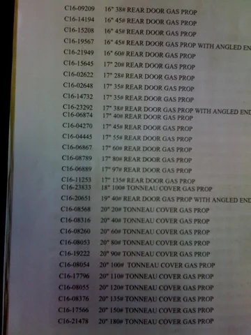

Just a cost saving tip. Only use one strut and keep the spring in the other. One Napa gas strut holds the hatch up just fine on mine. $80 was a little too rich for my blood considering I only gave $100 for my top.

Okay... I just picked up some 819-5565's from NAPA because I found the information in the FAQ's. The other threads I read did not describe that the new struts would go inside the old spring cylinders... I have a 73 FJ40 and the back glass struts are missing completely... So basically I need to find some old cylinders or look into another mounting option for these?
