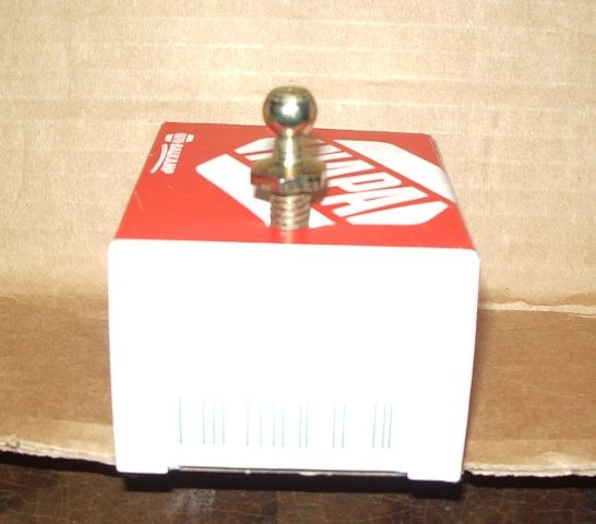

3.Ball stud NAPA part # 735-1896 packed 2 per box, about $5

By looking closely at pics 2 & 3 you might be able to see what I can see when I am looking at the real thing (not a pic). It might be possible to put the ball stud into the body without making a bracket. The stock thread size for the machine screws is 6mm x 1.0, or just under 1/4 inch. I'm not sure how big the captive nut is but it should be big enough to drill and tap for 5/16ths x 18 thread for the ball stud. The lower screw position is far enough back from the outer edge of the body and I think just far enough above the hatch latch to have enough room to fit the stud with the strut socket on it.

Handcannon-- I picked up the same ball studs over the weekend after looking in the catalog with my napa parts guy. Funny you got the same thing. I was going to try to install the stud into the body as you were describing and modify the brackets that come from coolerman... Anyway I'll post up some pics when I get mine mounted... I am still using the 819-5565's that were suggested in earlier posts... Is there a reason you got a different strut? I can still exchange mine if needed.

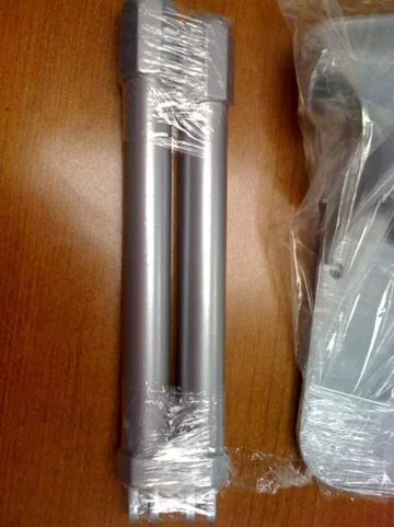

Received the stock struts back from the powder-coater....went with semi-gloss black.
Removed the old hardware and replaced it with 1/4" x 3/4" shoulder bolts; had to re-drill the brackets and strut ends to 1/4".
Took a 3/4" copper pipe cleaner; flattened the handle to fit the drill and cleaned the insides of both struts.

Looks good! Could you post a side view pic of your 40 with the hatch in the up position? I'm interested in seeing how high the hatch lifts with the refurbed stock struts. Also, could you tell us where you found the shoulder bolts?

Ok, I'll post the attached strut pic as soon as I get the 40 from the shop; I think Monday or Tuesday. :steer: I got the shoulder bolts from my local ACE Hardware.
