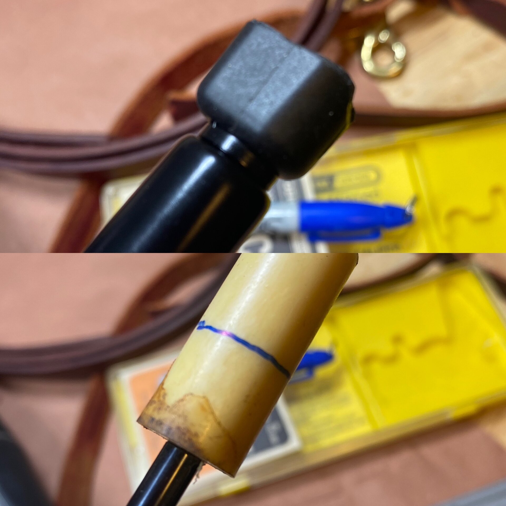

Thread the spacer with a 6mm x 1.0 tap and screw it onto the strut.
Cut the plastic off the gas piston end of the strut.
Test the length and cut the spacer down so the whole assembly fits inside the strut.
Cut the spacer to length. These are the two ends. The spacer marked for cutting.

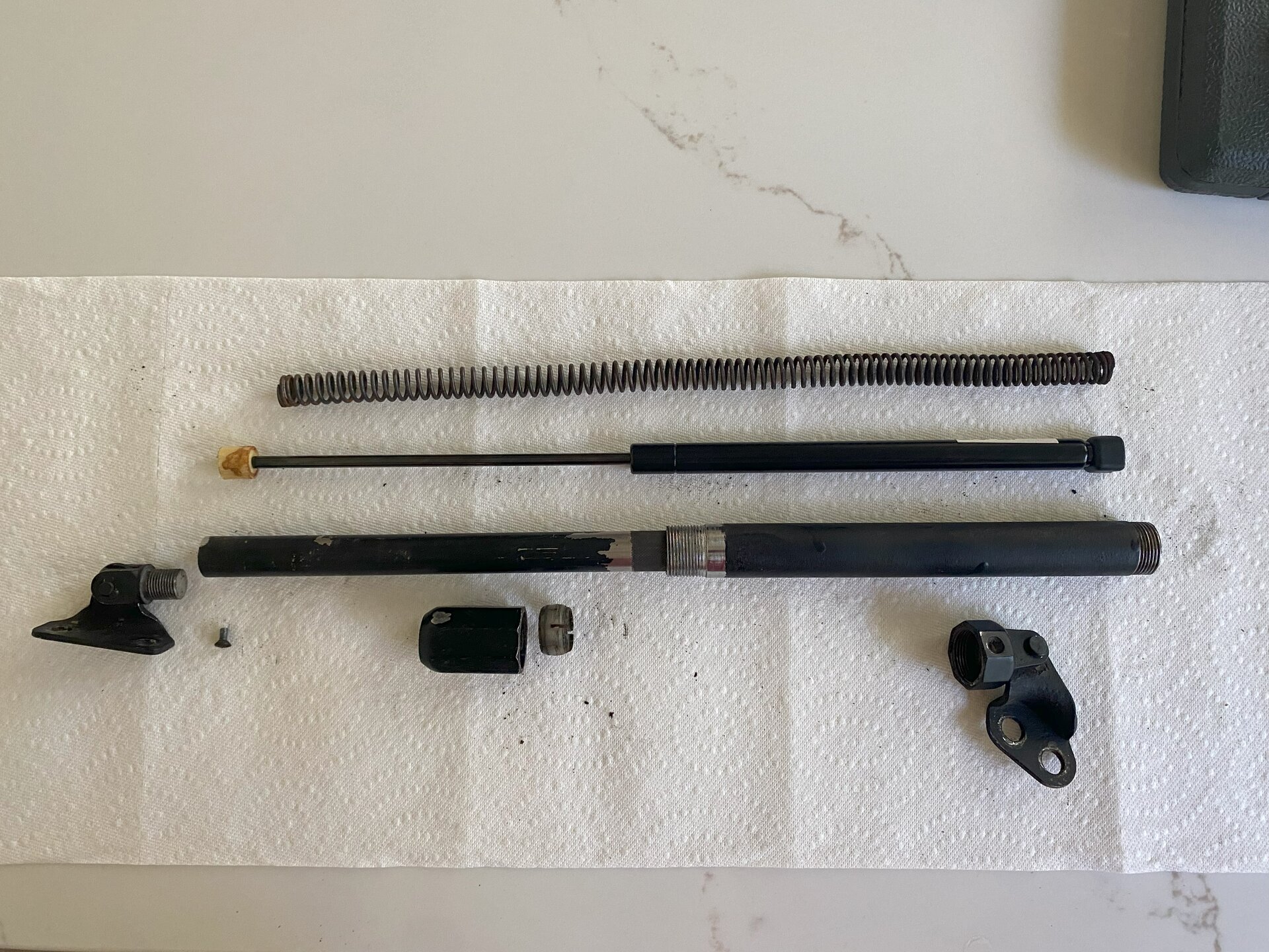

Here is the assembly ready for reassembly, the spring is shown for comparison.
Reassembly is the reverse of disassembly except for the spring. It is not used.

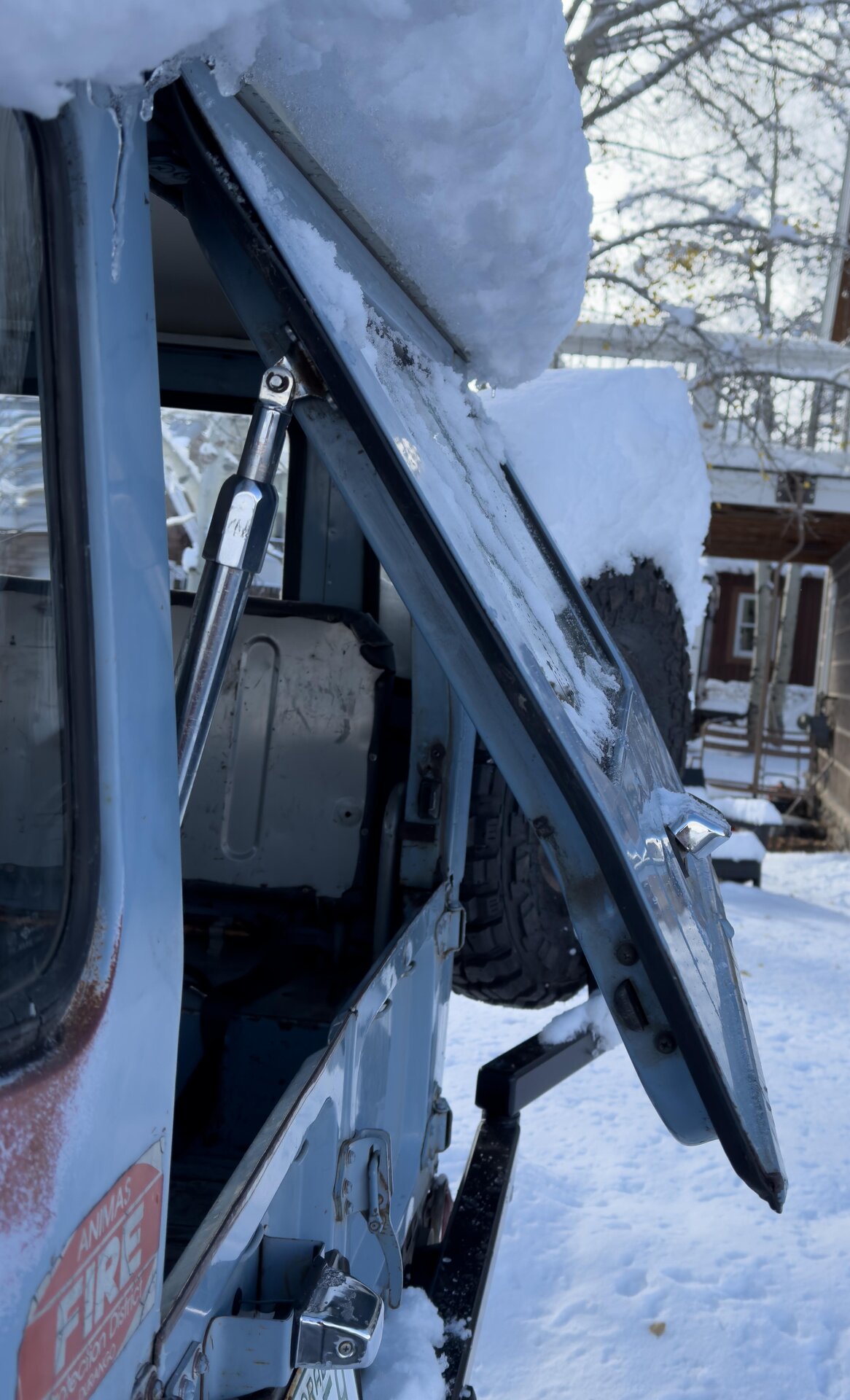

I was able to have the hatch so that it opens slightly higher than stock... When you're 6'5"+ with shoes on, every little bit helps.
