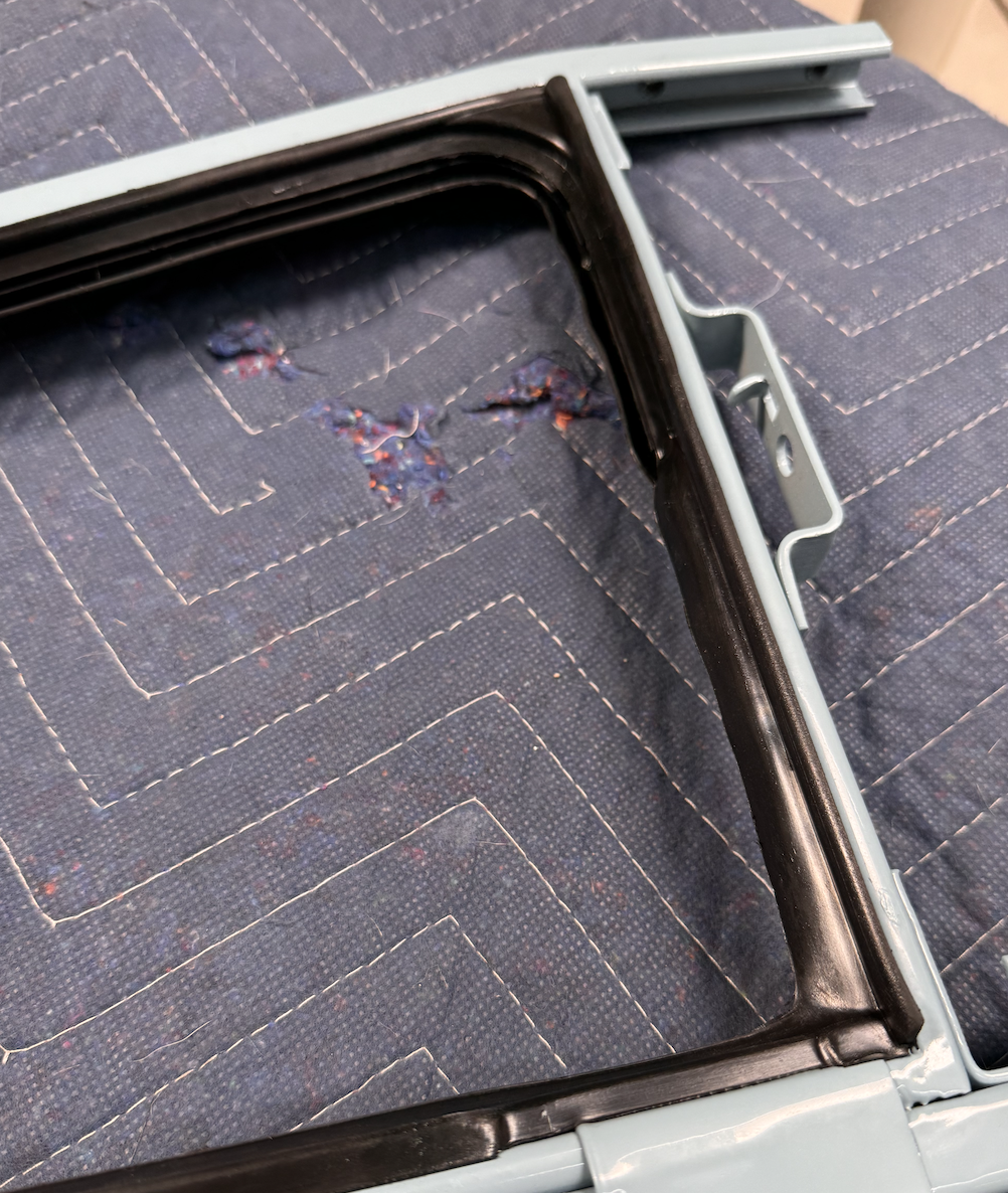

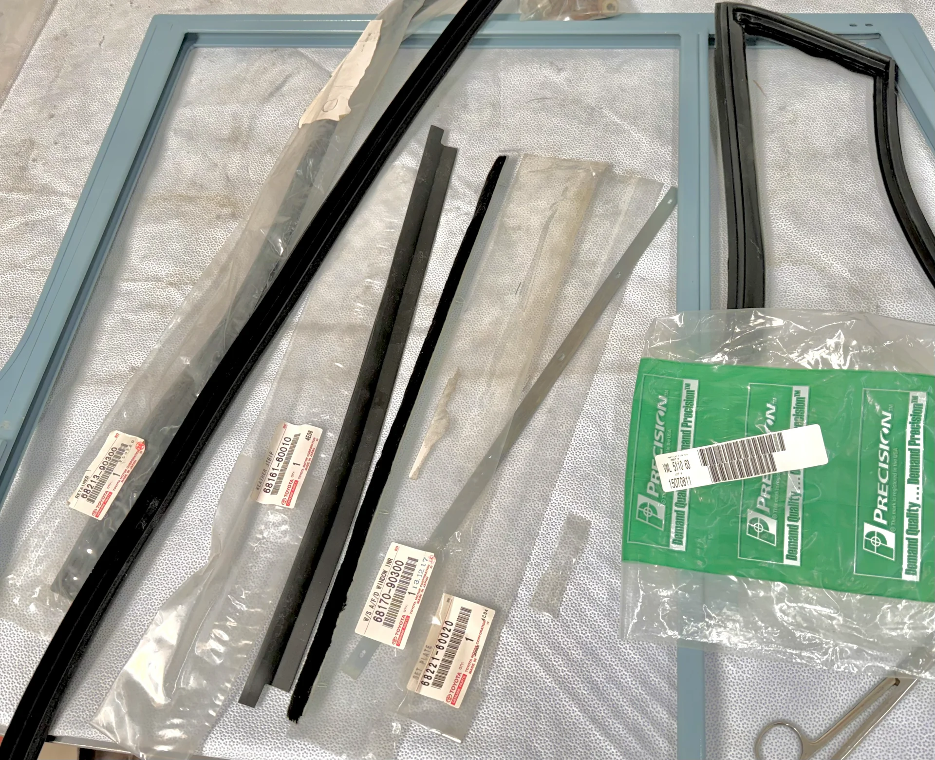

Starting to put my doors back together after painting etc. I couldn't find much on the 2 piece doors so I figured I'd share.

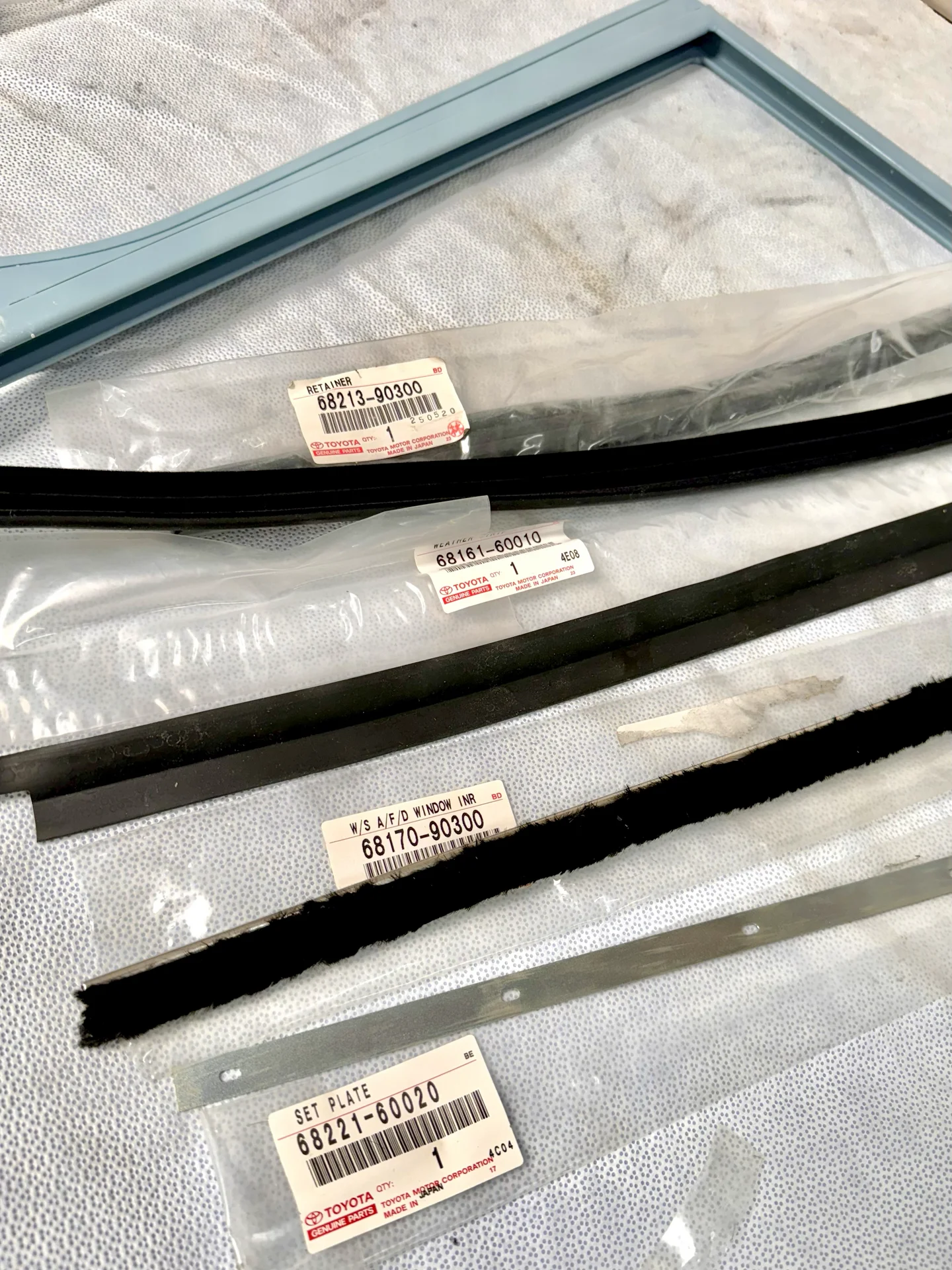

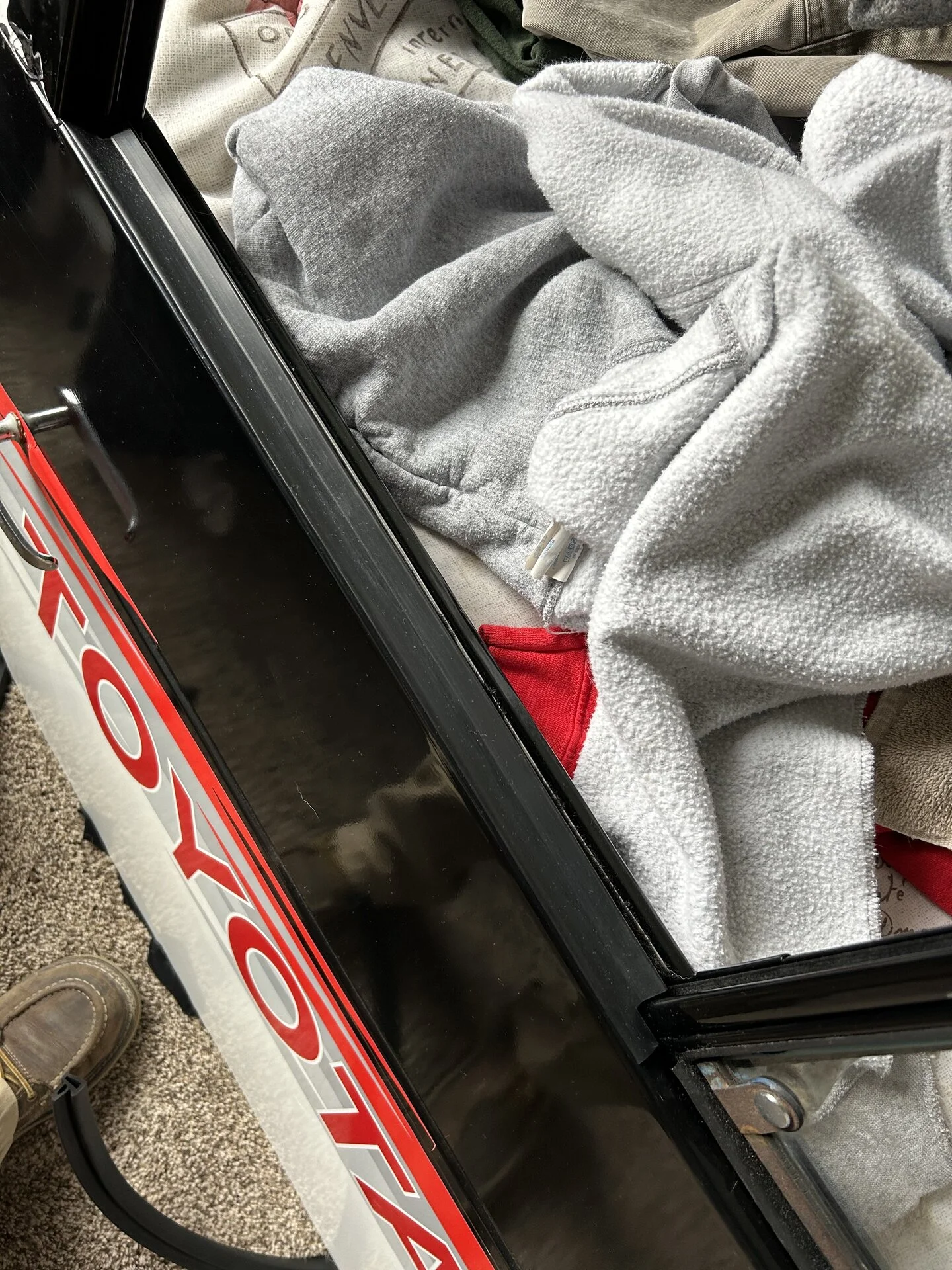

the felts etc. Everything still available from Toyota except the vent window (?) - not sure where I picked that up but it was very nice quality

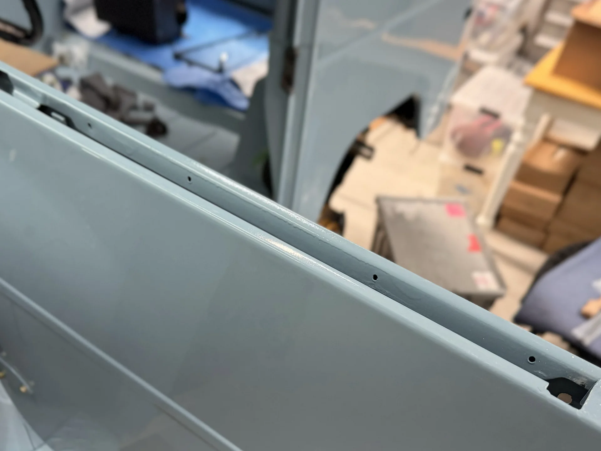

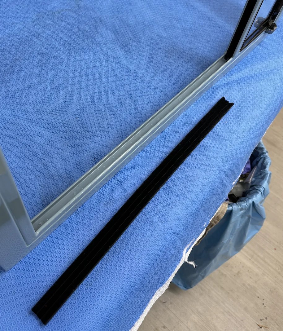

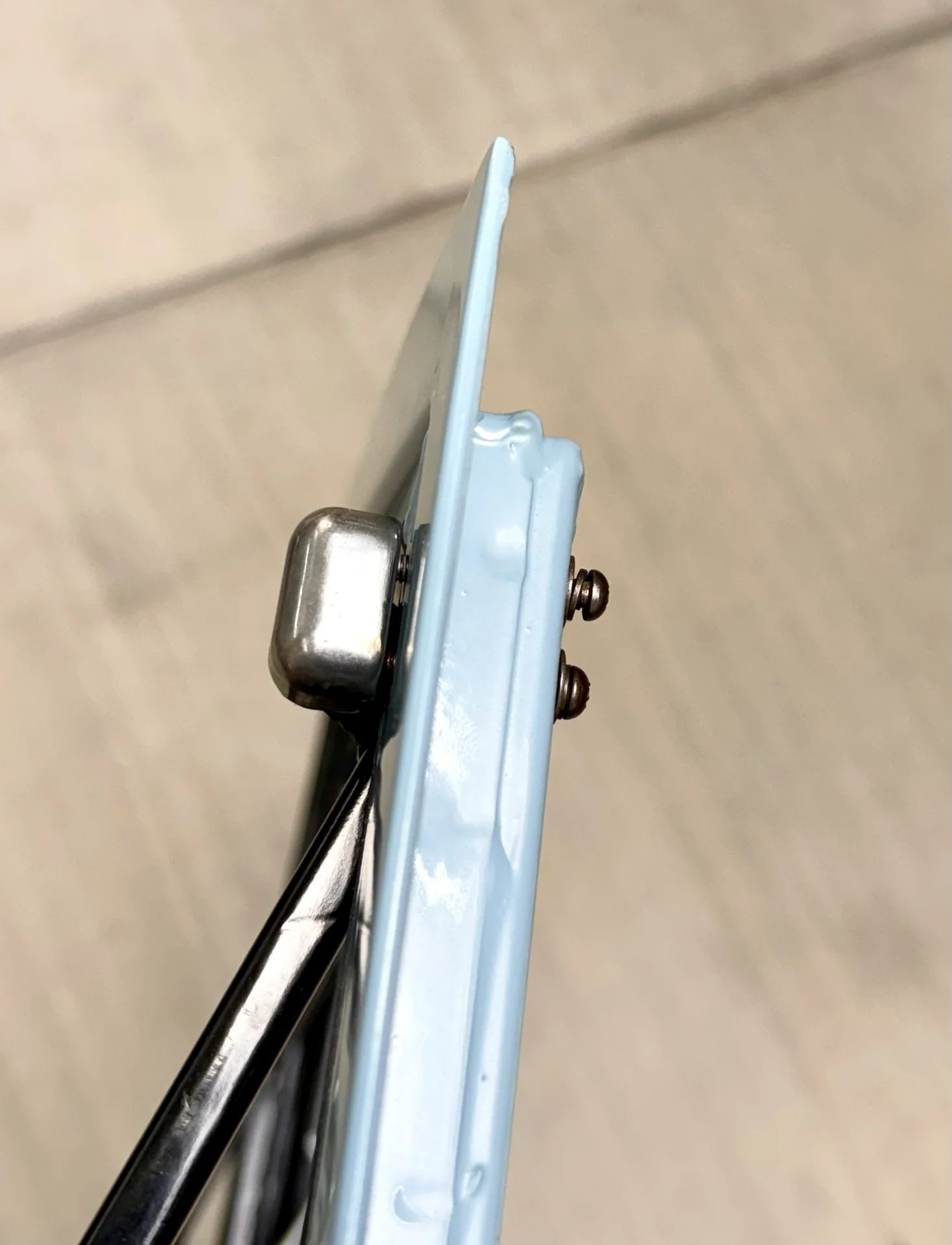

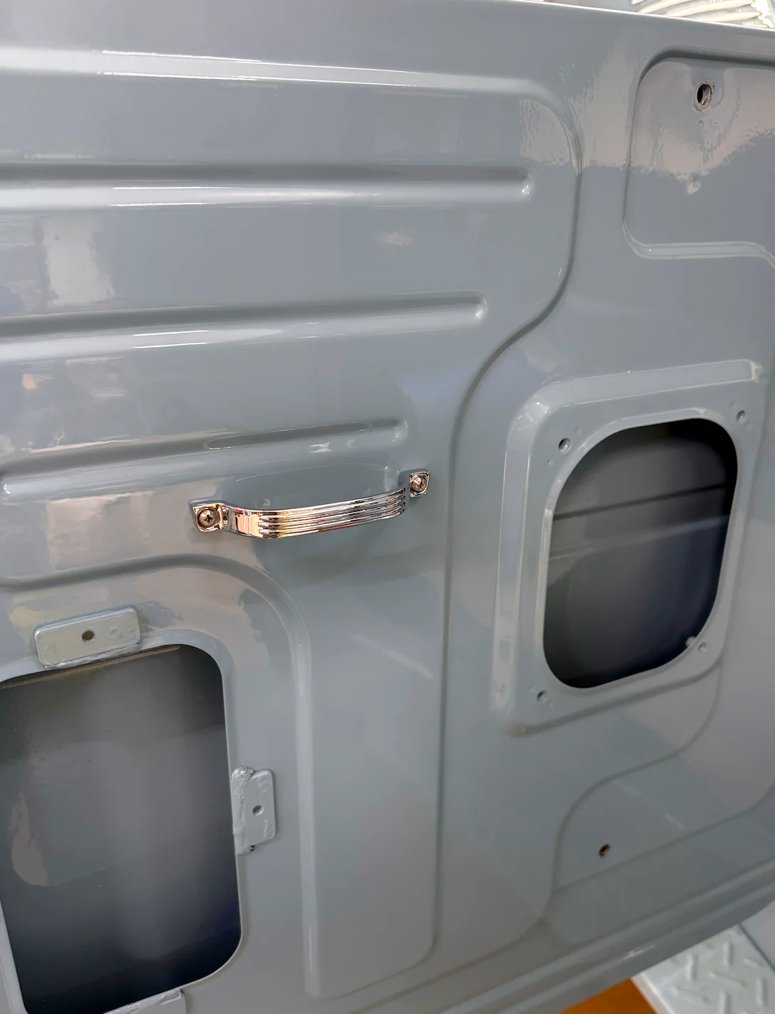

the mounting holes for the glass trim. the inner strip comes with the attachment clips attached, the outer wiper does not. I thought I had some of the clips but couldn't find them so I need to address that - 6 per door are needed. Apparently, they are still available from Toyota but crazy expensive.

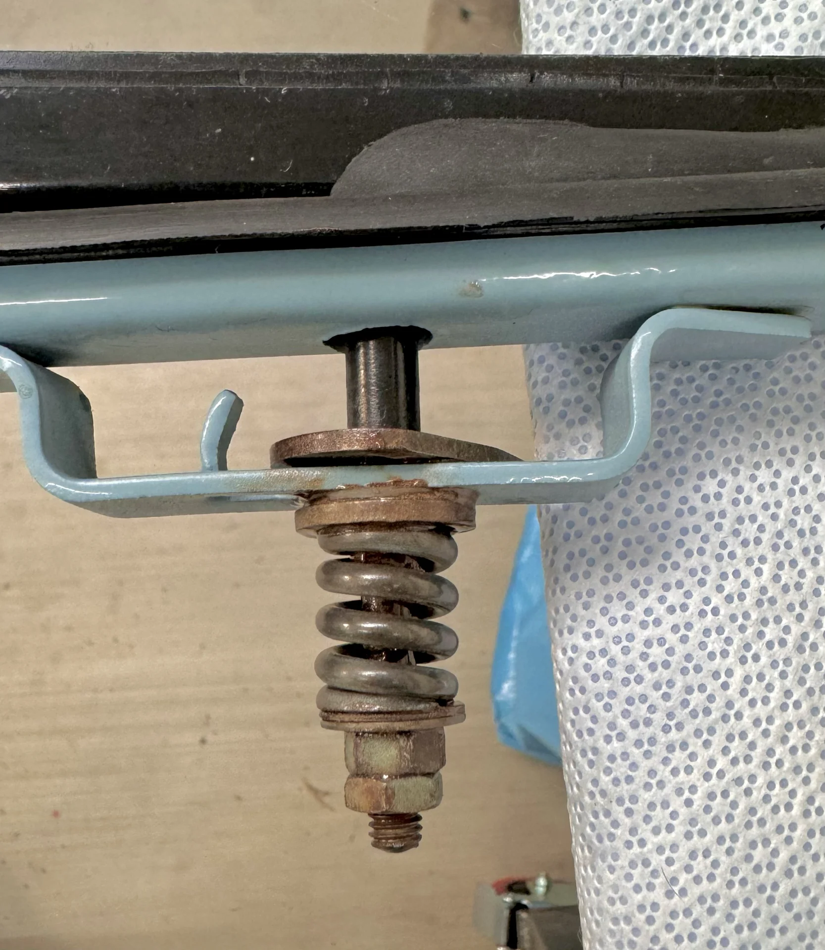

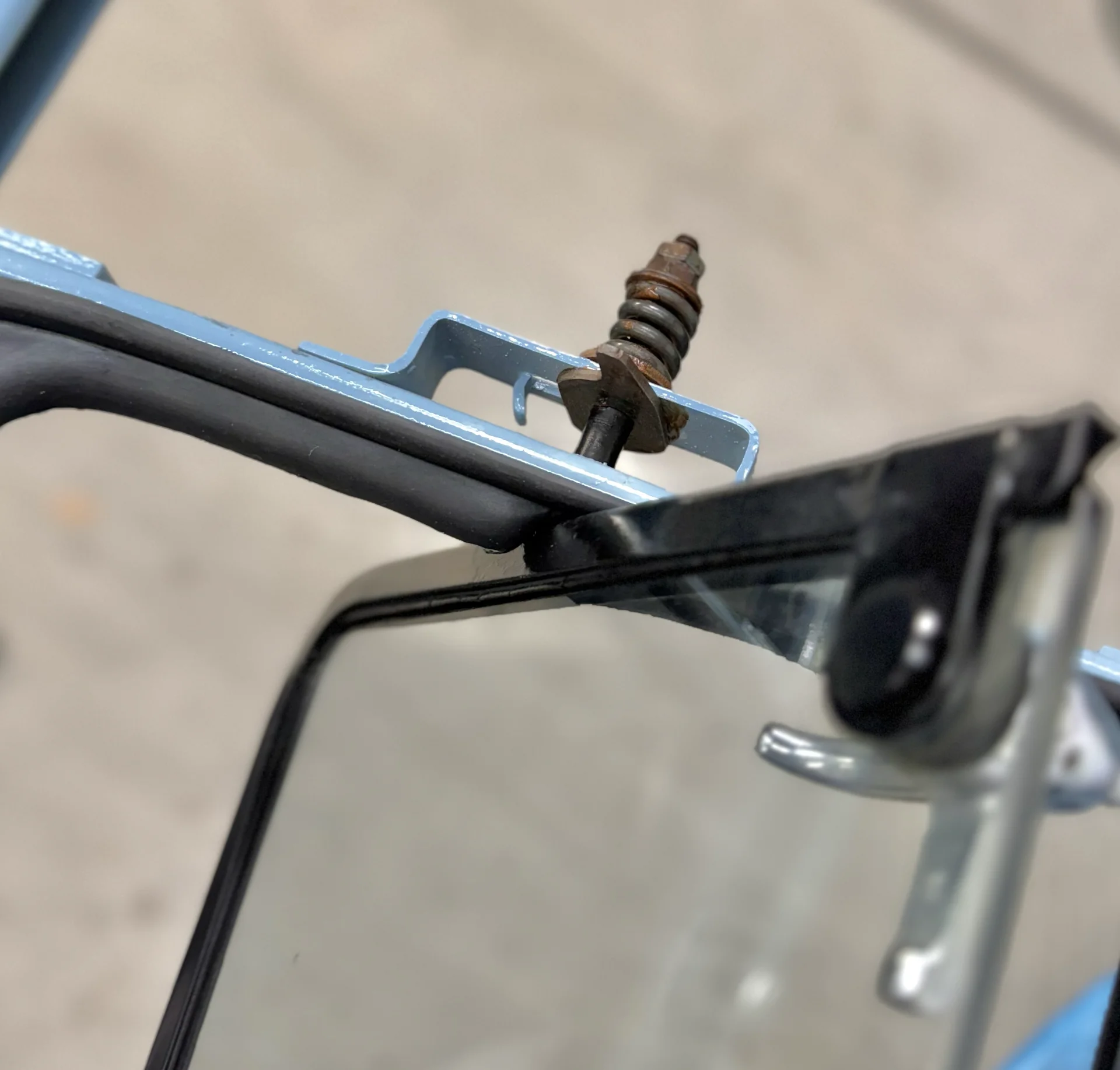

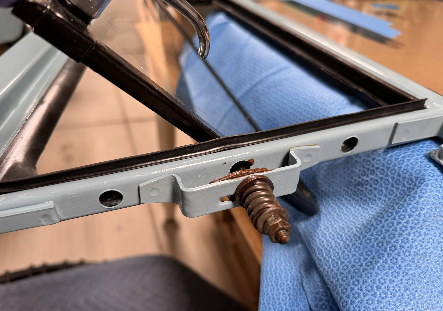

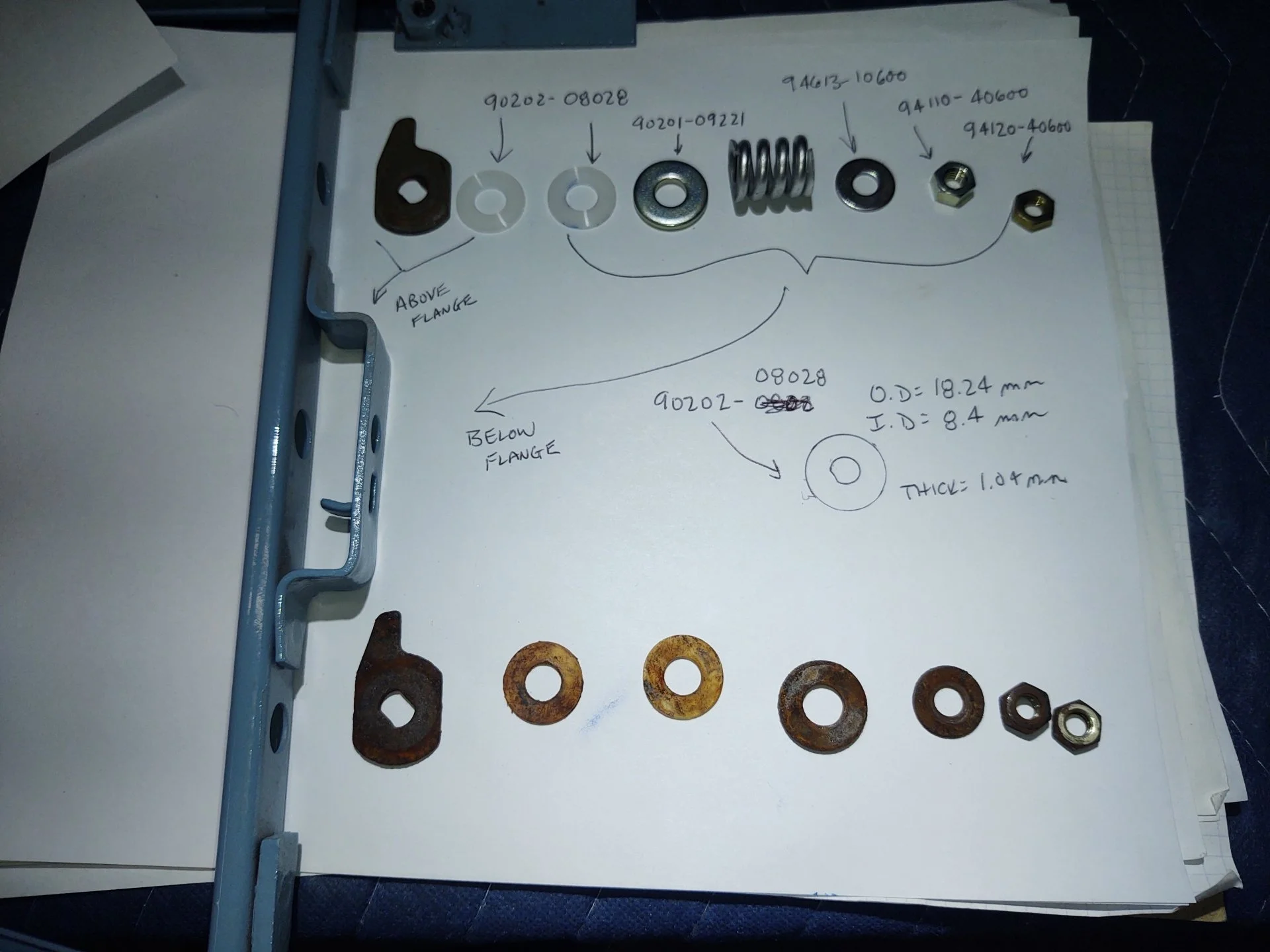

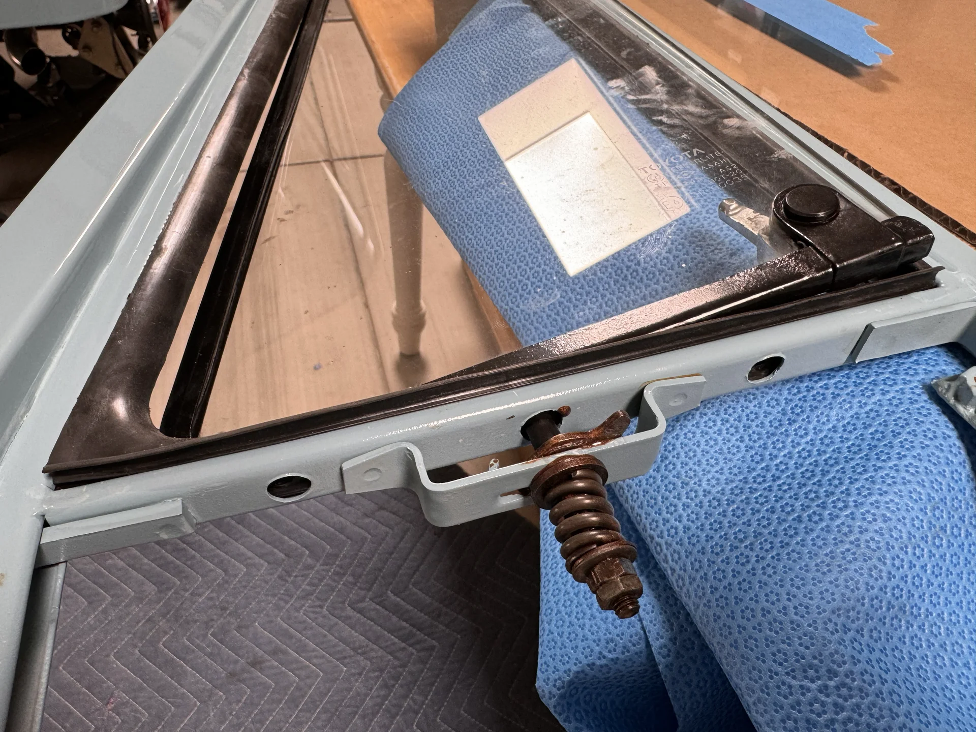

here is the vent window hardware as it was on mine - full disclosure, I'm not sure that this is factory correct but it seems to make sense. There is a nylon washer followed by a thick washer - both have a larger bore in order to go over the shaft. Then the spring followed by 2 smaller washers, with a smaller bore. Last a nut and jam nut. The important part is make sure the cam/ stopper is oriented correctly - keeps the vent window from opening too far
another thing to note - the way the vent window cam sits in the frame, the window has to be opened to slide into the door.

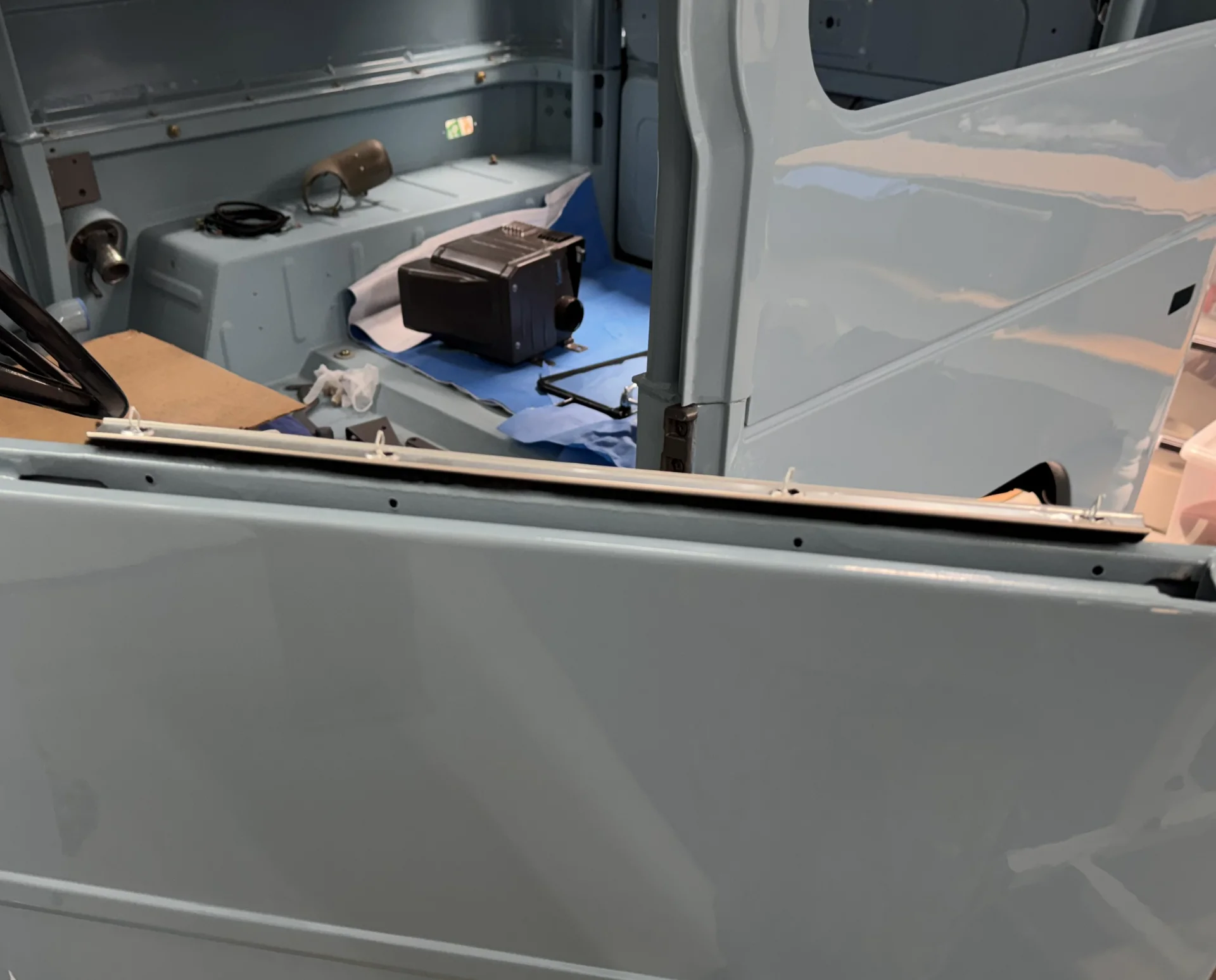

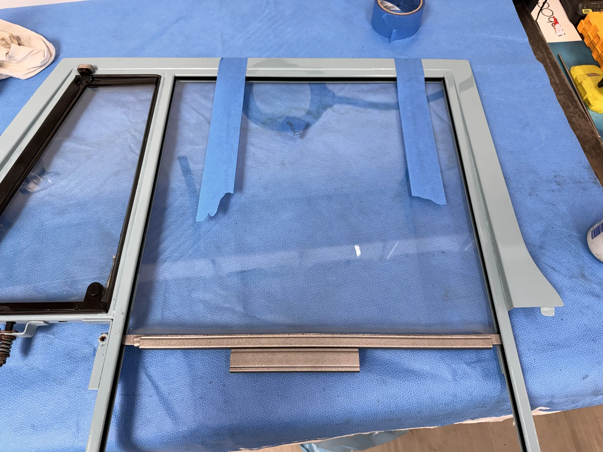

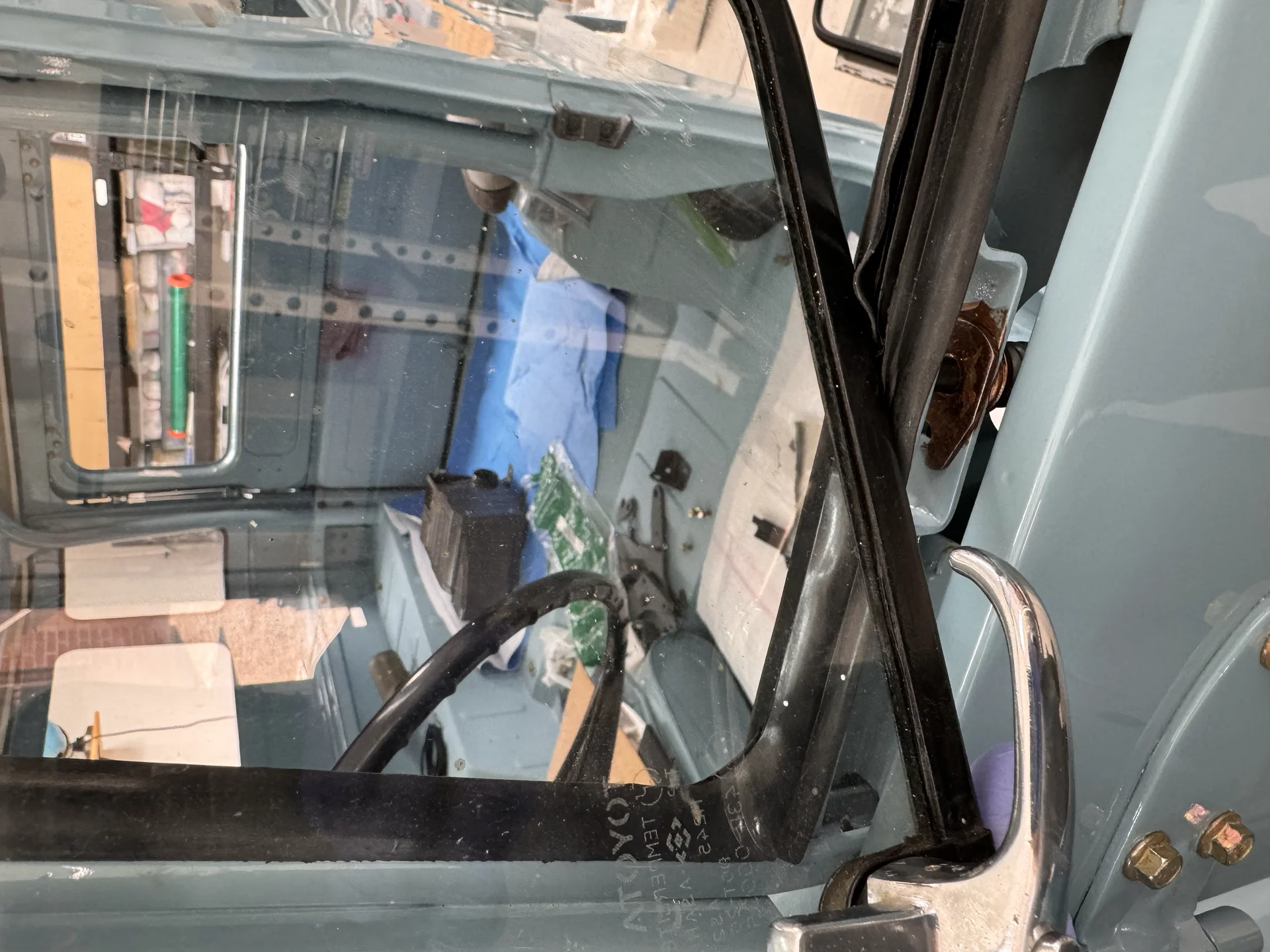

this was just a trial fit as the outside glass wiper needs to be installed before the glass etc

Outstanding - thanks for posting that! I like the nylon washer under the cam - need to go to the hardware store for some other things as well.
Do you have any guidance on how tight the spring tension should be? I just put enough in to seat the window.
Same question here. I have noticed that at highway speed the wind tends to push the vent window toward the closed position. Not sure if adjusting the tension on the spring will make a difference in this regard.
I just did all this stuff with my doors . I think you will find you will need to get the outer wipers on first . Also put the glass in the door take the 2 screws out that hold the stopper out so the glass can drop down lower . This will give you the room to get the inner felts on . .
The outers will make it difficult to impossible to get the glass in after
Yes, tighten the spring until the wind doesn't effect the wing window. Leave the whole plug out until they're both set.

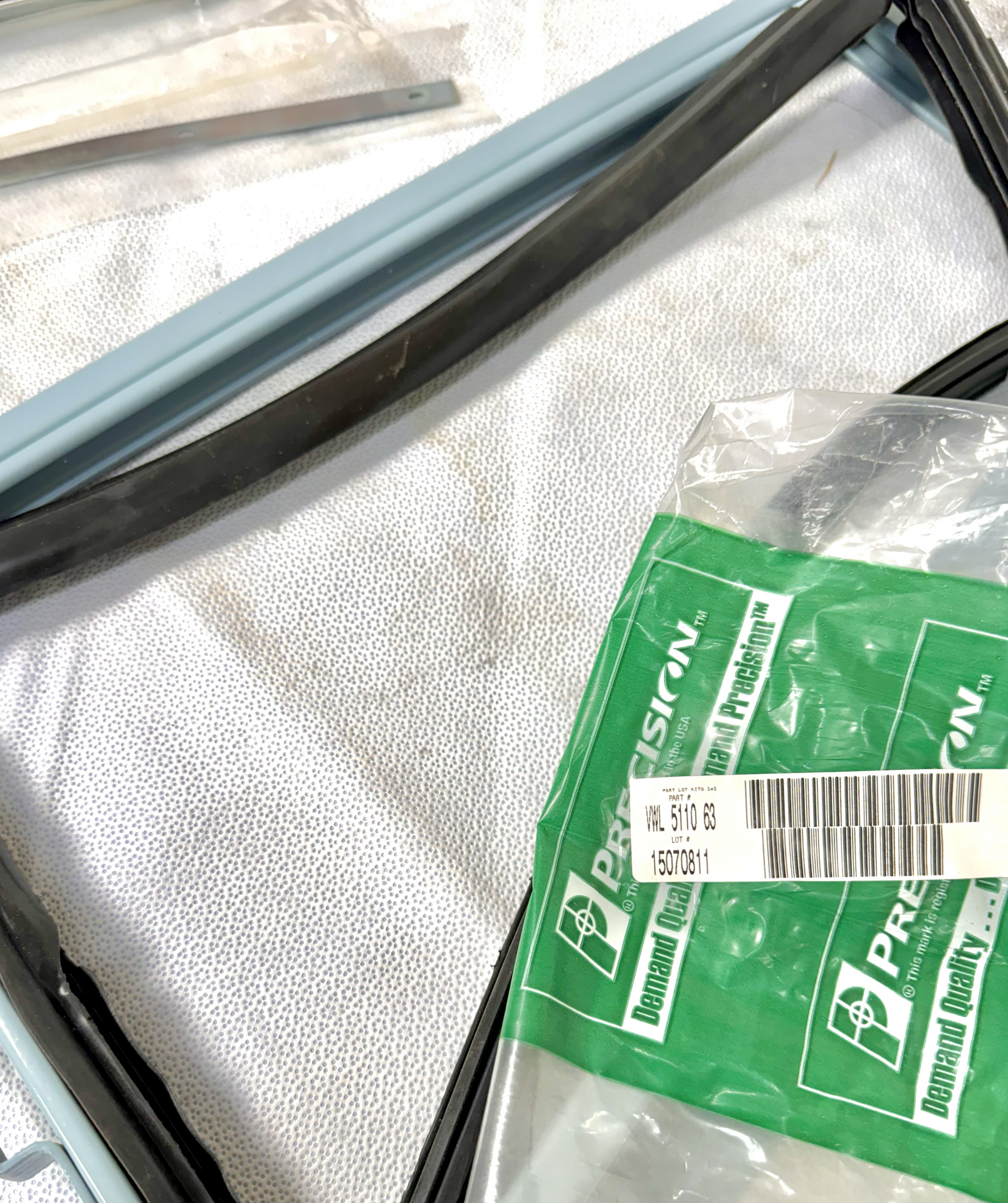

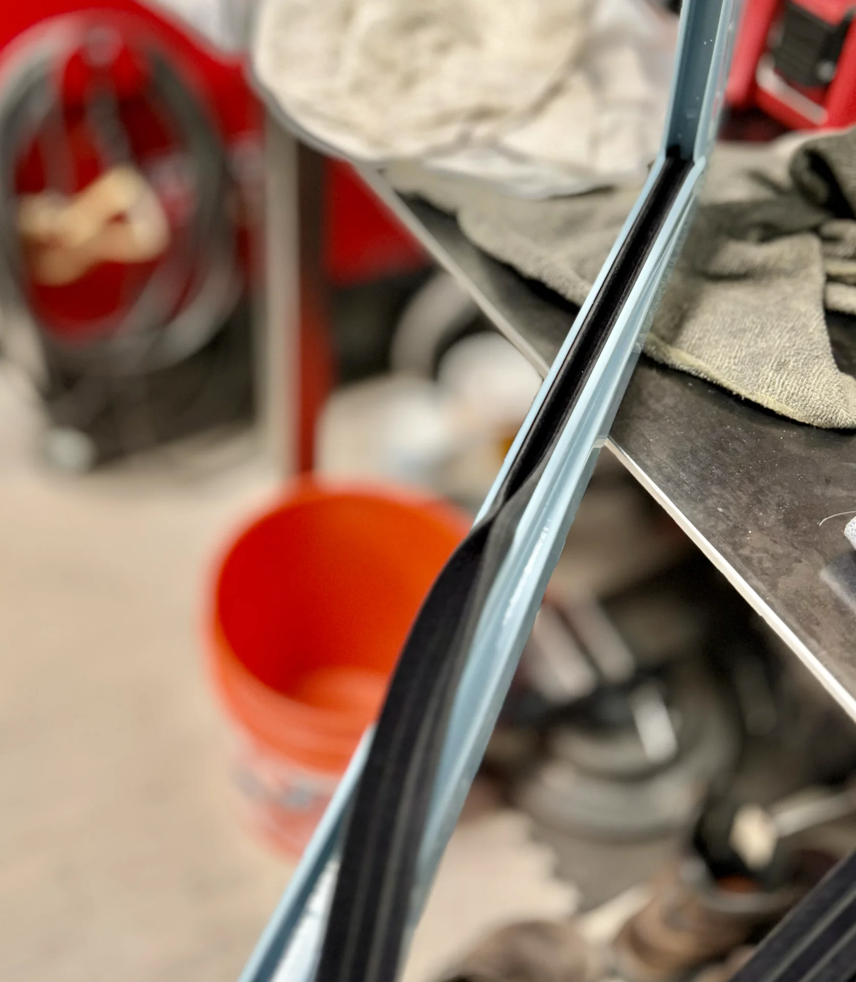

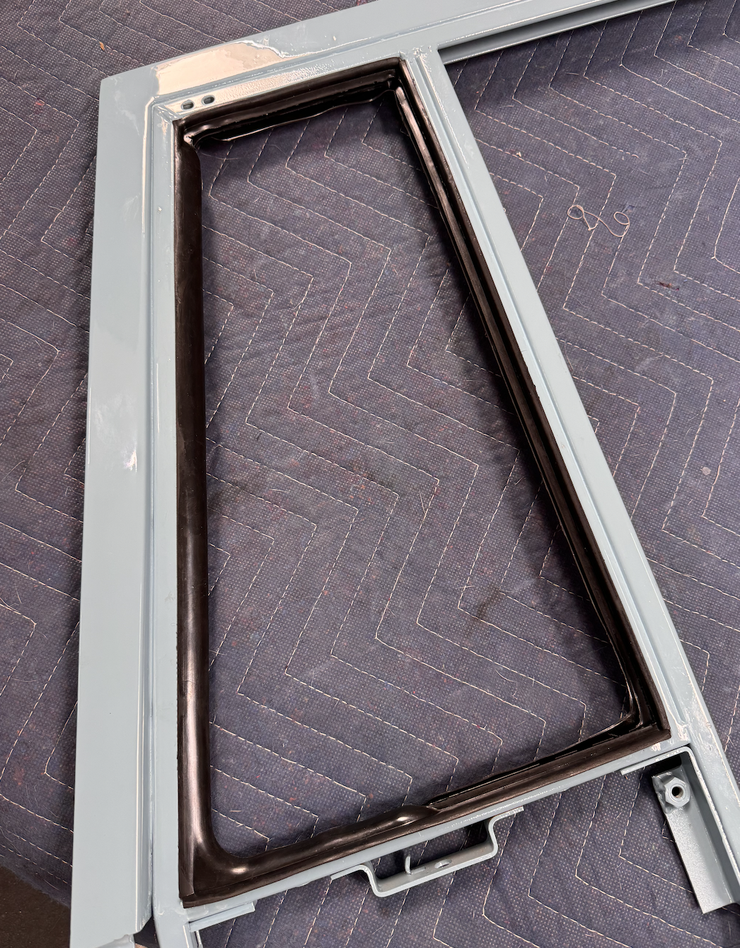

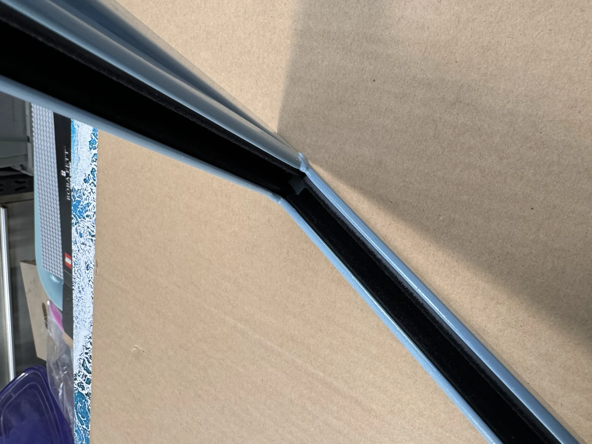

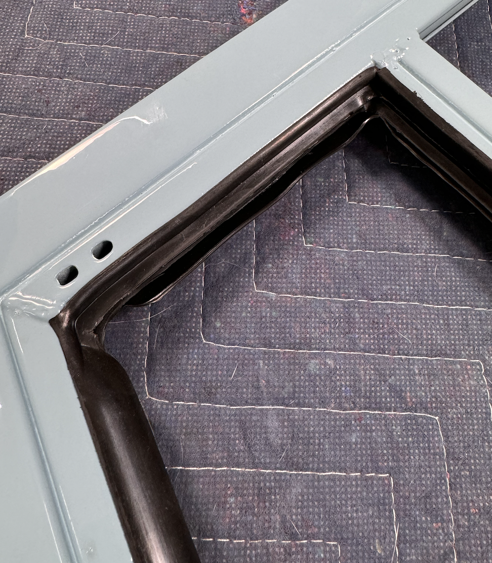

The vent window gasket was straighforward as well. There is a ribbed section that presses into the channel. A little soapy water to slide it in and it easily popped in and conformed to the frame
It all looks fantastic! Question- where did you get your vent window rubber seal? I got mine from Specter Off Road (aftermarket) and it fit perfectly. The problem is that the drivers side whistles badly unless I open it. The passenger side is stuck so tight if I open the glass I have to fiddle with it to close back up. Based on your response I might replace mine again.
