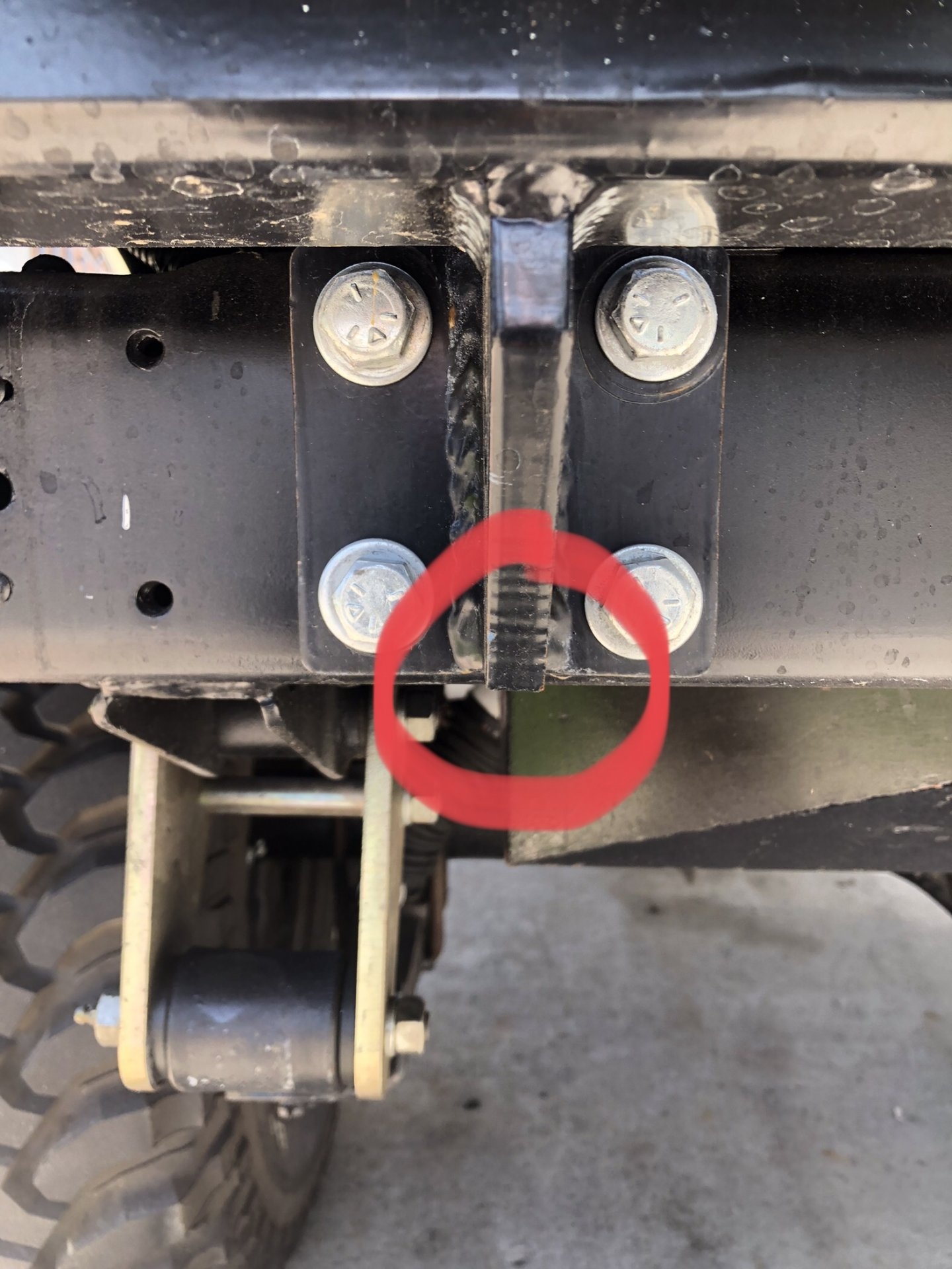

Welded flush at the bottom
Not flush...
The mounting holes had to be wallowed out to make it level. I did not catch this initially and laid/drilled the hole out evenly.

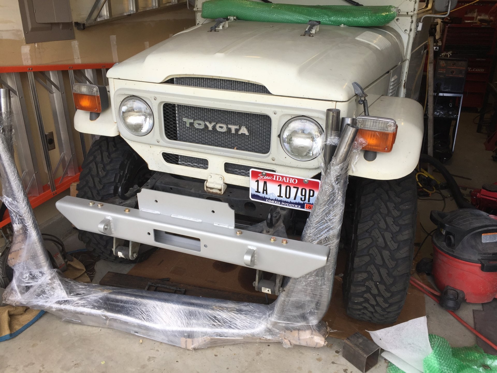

The front twist is very hard to capture on camera. If you look closely, you’ll notice the top is farther away than the bottom.

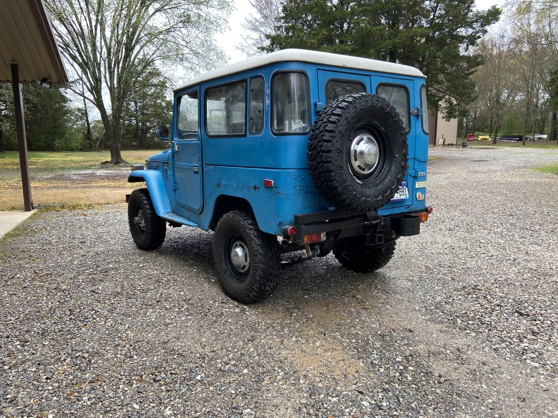

I have an old school front guard and the rear cooler/jerrycan/tire carrier. No real complaints from me.

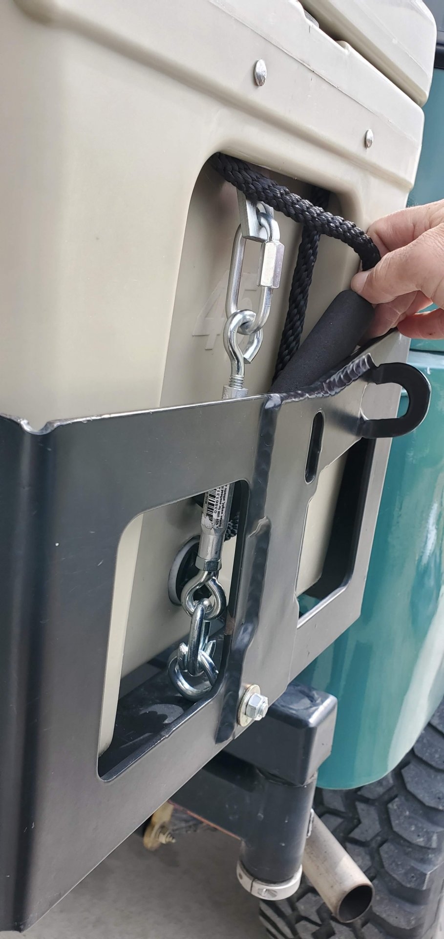

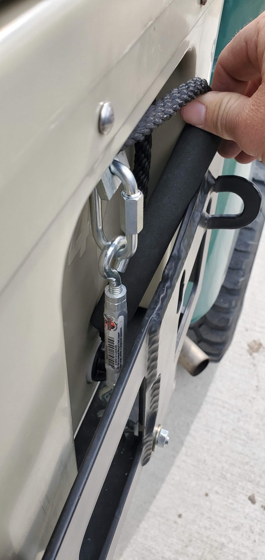

Also, there’s my method of securing my cooler, it could still be jacked but they’d have to earn it at least.

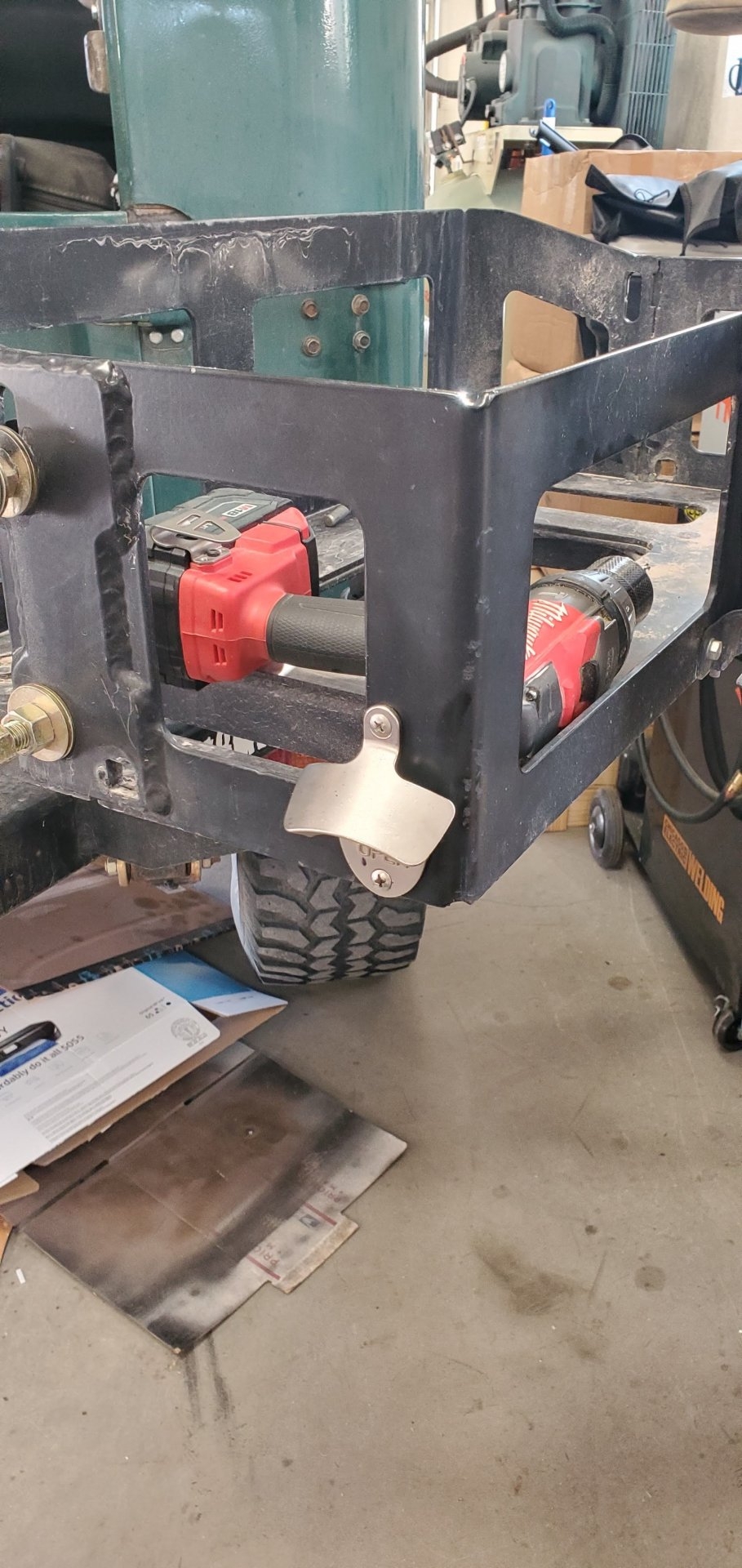

Can’t forget about the bottle opener mod.

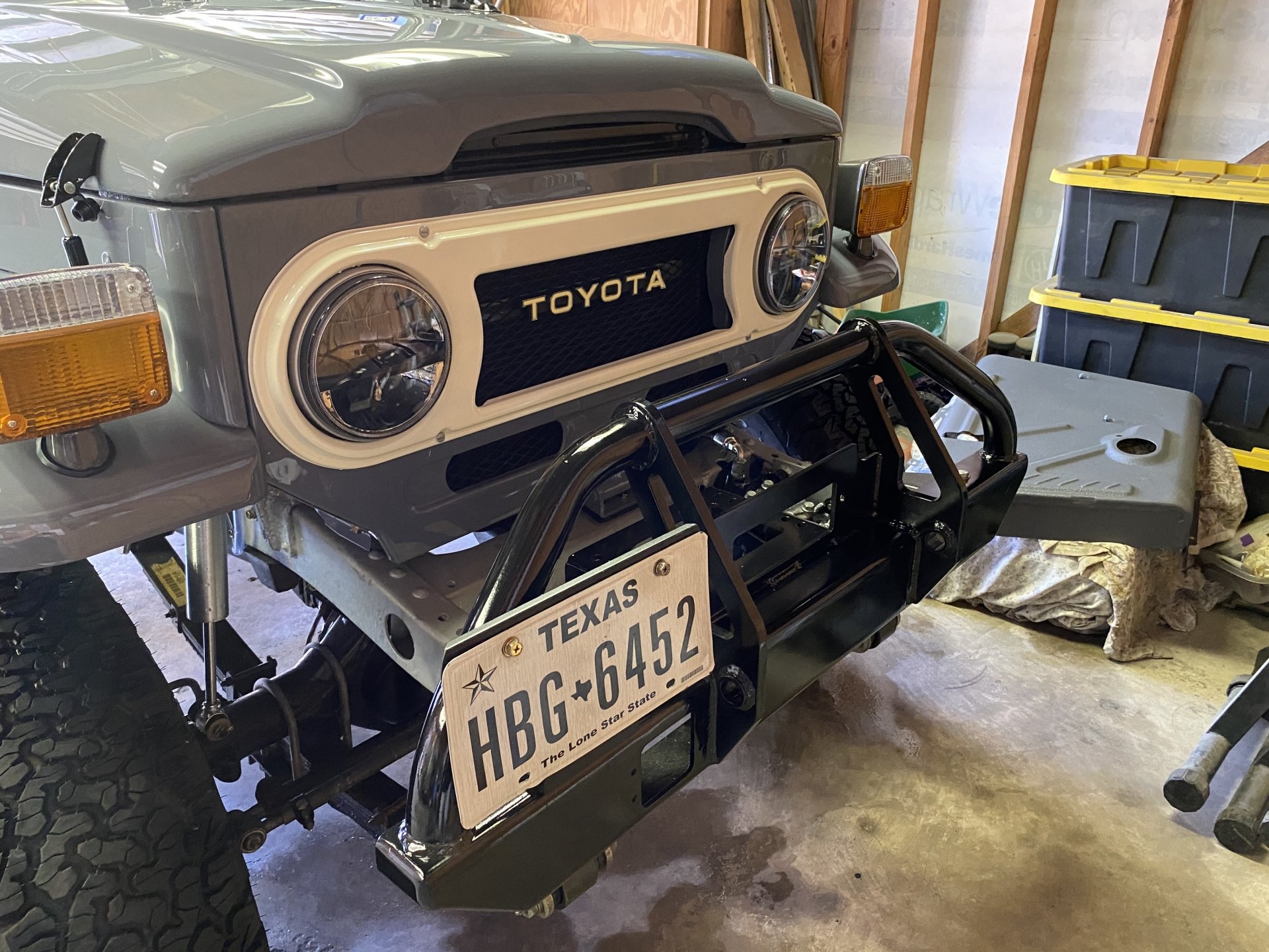

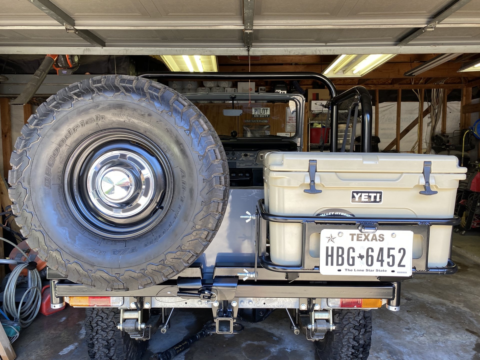

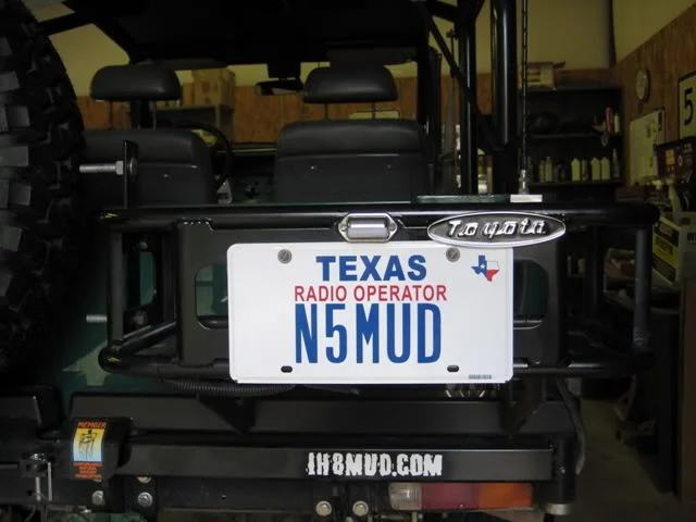

I've got 4+ bumpers front and rear on mine; love them and would buy them again for another truck.
Mods I made to mine:
1. Added grease zerks to the swing-out pivots on the rear.
2. Added a CB antenna mount to the rear basket.
3. Added a license plate light and mounted my rear plate on the rear basket.
4. Drilled holes and mounted my front license plate on the front bumper
As far as security for the rear basket, it hasn't been an issue for me. I don't carry anything in it unless I'm working or on a 4WD trip, and I've never had anything stolen out of it during those times. When I have jerry cans in the basket, I do run a ratchet strap over the top to secure them from bouncing out.

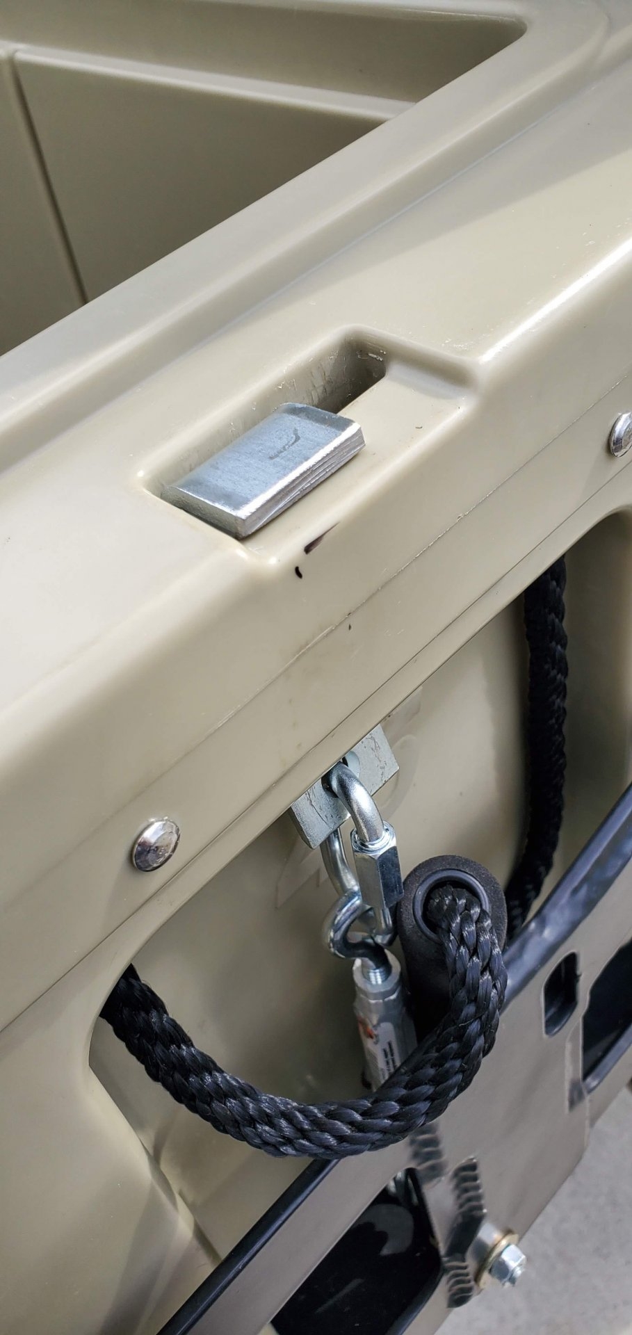

I added some tether straps made from crimped SS aircraft cable-this prevents the arms from crashing into the tub.
Also machined a new SS latch and replaced the original locking pin with a pushbutton pin.Both tethered to the bumper with the same SS cable-this prevents loss
Jerry cans are locked in the basket with SS chain inside nylon chafing sleeve-this prevents theft by honest people.

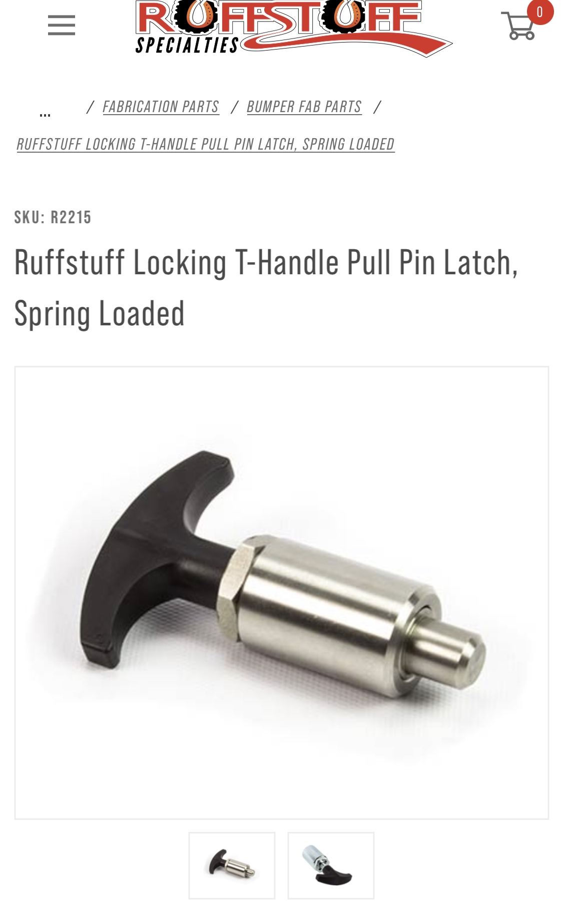

I sprayed Rustoleum on both of my 4+ for ease of touch ups. Did the same thing on my bumpers and sliders on my old Taco and it was a great decision. Good ideas on the tethers, but I’ve used these locking T-Handles on a bumper I previously made and they worked fantastic. Probably going to do the same.
