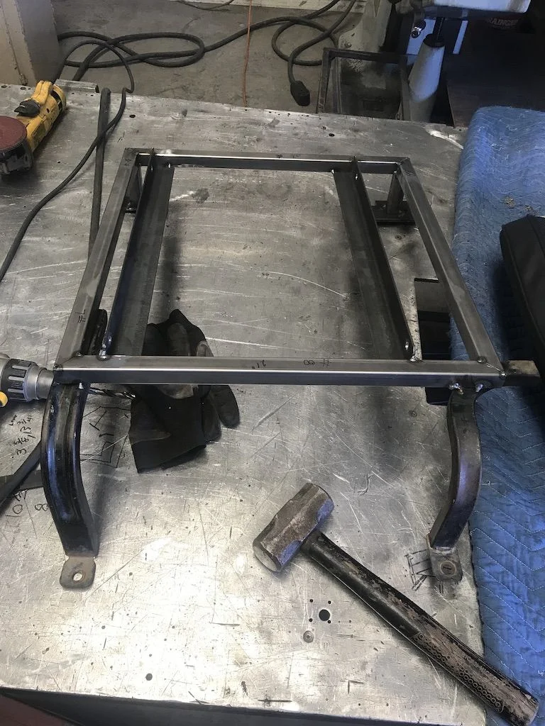

My driver side seat base for the prp seats. Took a few trys to get height right but the legs are lower than stock. Still uses the stock mounting locations in the floor.
Passenger side I could not drop any lower due to fuel tanks. Reused the factory legs to match the bend around the tank but still built a new frame for the seat. The angle Iron pieces are what the seat itself bolts to now. Allows them to drop a little lower.

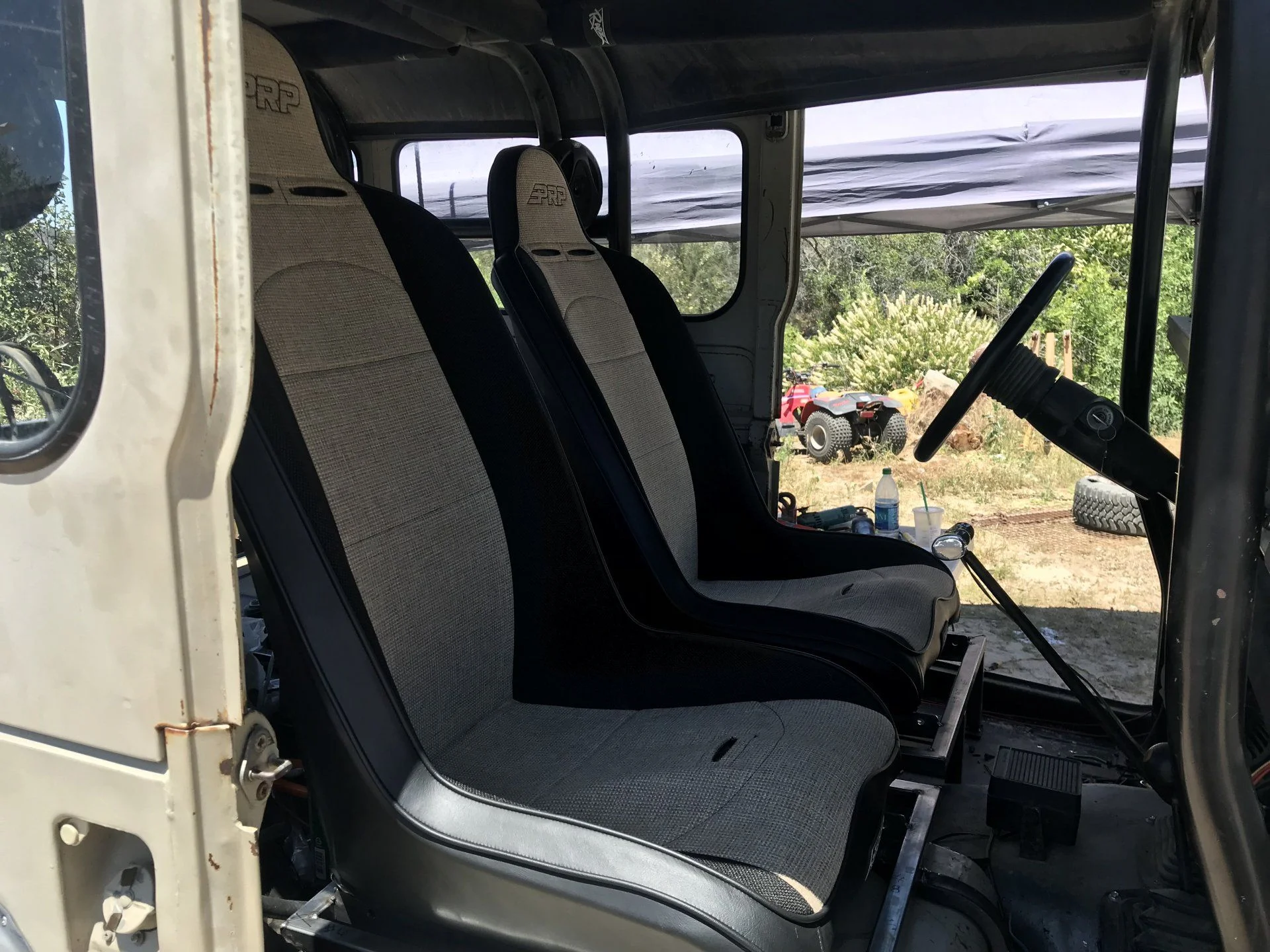

Seats installed showing clearance to the steering wheel
The installed pic is pretty old. Since then I have got the passenger seat angled back a bit more but this hopefully paints a better picture of what I was talking about in my first post.
