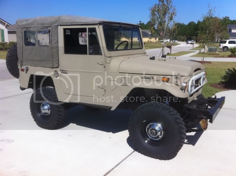

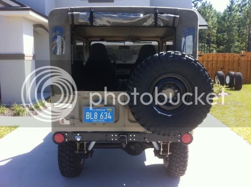

Front of the lift is done, took about 4 hours for the front and 5 for the back by my self. I doubt it would have gone much quicker with help, if anyone is thinking of doing it themselves.
Still a little tall at 5" up front and 6" in the back. I'm still about an inch too high to get it back in the garage.
I took it offroad for about an hour trying to get it to settle, but I think it will take a while.
I kinda like the look with no caps, kinda wish I held of on em.
Driveway is on a slope, 40 is actually pretty level.
PO included a full car cover with the sale, I'm going to try it out and see if it's water tight tonight. If it's dry tomorrow I'm going to keep trying to get it to settle. If it leaks the tops coming off until it drops an inch.

$OR stock length shackles are in and will go on Monday. I'll reinstall the top and see if she fits, but I doubt it. I'll measure it for you with the top on and you can measure your garage opening.
