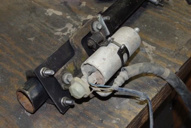

Just for a difference of opinion. I'm using the OEM fuel pressure regulator with an aftermarket pump. I believe it's an Aeromotive, but don't remember which flavor. You need 45psi out the pump. Mine is mounted on the rear crossmember using muffler clamps and rubber isolators.
attachment.php
I believe I opted for the exact same pump and factory FPR.
IIRC, the pump is from an late 80's F-250?
When my return line was plugged, this pump was building >70 PSI in the rail!!! :eek:
Once I fixed return line the FPR kept it right around 36 PSI in the rail. :cool:

I used this pump: Aeromotive 11109 - Aeromotive Inline EFI Fuel Pump. Note the 5/16" inlet and outlet. This doesn't work for some people, but worked for me.
Sorry, wasn't clear when I posted ... the Napa AFP E2000/Aeromotive 11109 are the branded Airtex E2000 fuel pump if you do a little searching ;) Thought PabloCruise was running that one as well, looks like he posted another Napa in-line part number (Napa brands multiple manufacturers as their own) -
