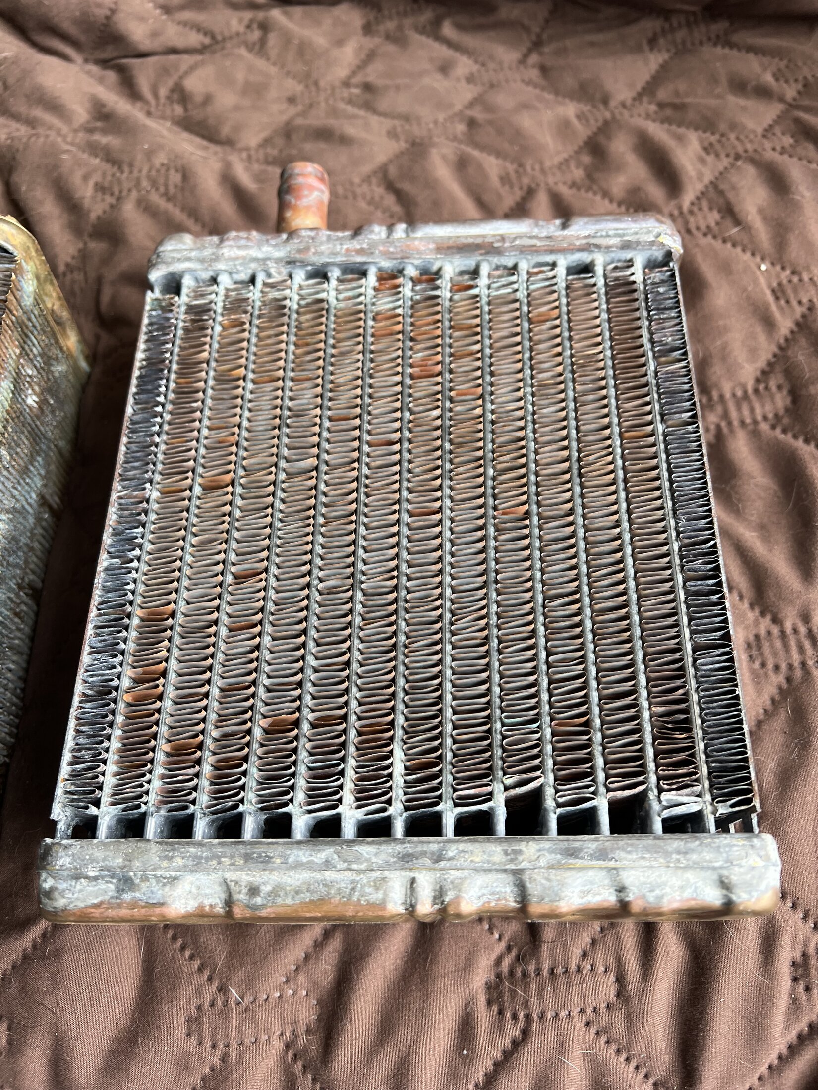

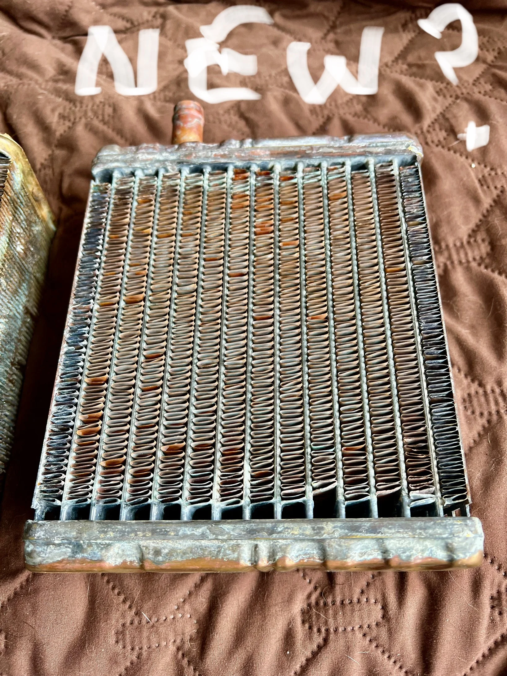

SOR advertised new FJ 40 heater core for $205 plus shipping, roughly $250 to my door. The unit came yesterday and I am disappointed. The supposedly new unit doesn’t look as good as the 57-year-old core that came out of the heater box.
The fins on the “new“ heat core don’t even extend all the way down to the bottom cap. The fins are rusty. The top and bottom caps, show, corrosion, scratches, and what looks like solder smears.
Worse, the inlet and outlet tubes on the top cap are not correctly positioned, they are out of square. This means that the new heater core does not fit square in the OEM heater box it is rotated and not flush at either end.
Did I even get a new unit?

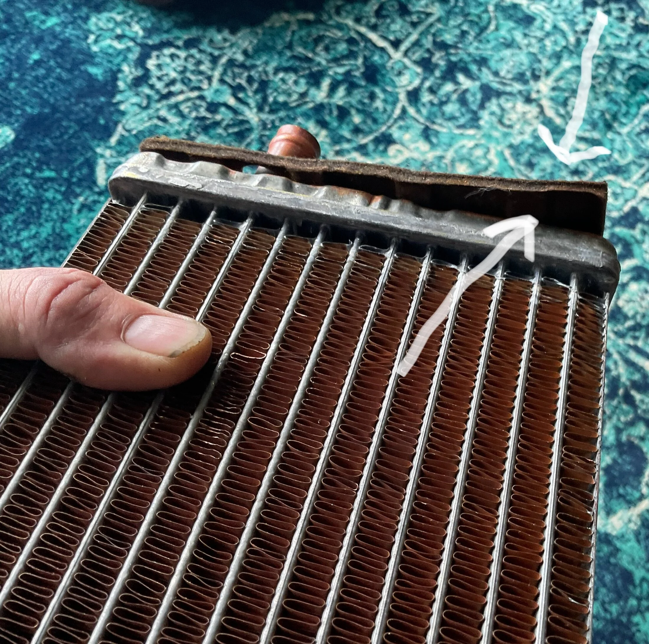

The OEM tube outlet gasket pad from the original heater core fits perfectly squared to the body.
The same OEM gasket pad put on the new heater core is very crooked because the inlet and outlet tubes are incorrectly positioned. Which also means the heater core is rotated from square when placed inside the OEM heater box.

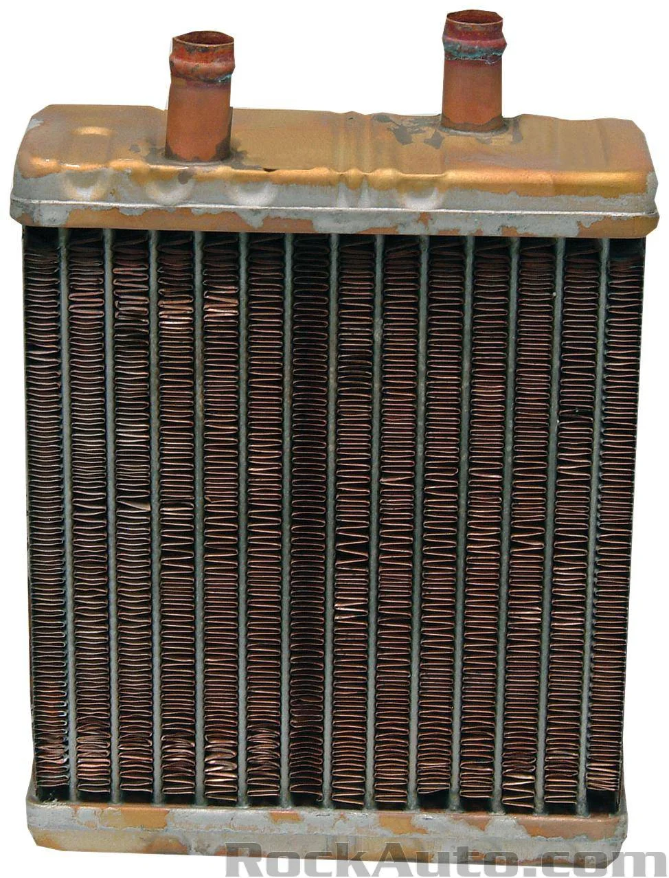

Rock Auto has heater cores listed for 1969 and newer. Specs below will let you know if it's interchangeable with your core.
$76.79 plus tax and shipping by fedex ground to 24171 is $18.99
Doesn't say refurbished, so an example of "new"?
Specs on this one from the rock auto website:
AGILITY 9010346 Specifications
ConstructionCrimp Tank
Core Depth (IN)2.000 in
Core Height (IN)6.250 in
Core MaterialCopper Brass
Core Width (IN)6.250 in
Inlet Pipe Diameter0.625 in
Outlet Pipe Diameter0.625 in
Tank MaterialBrass
OEM / Interchange Numbers: 87107-60091
I did not even think to try Rock Auto…

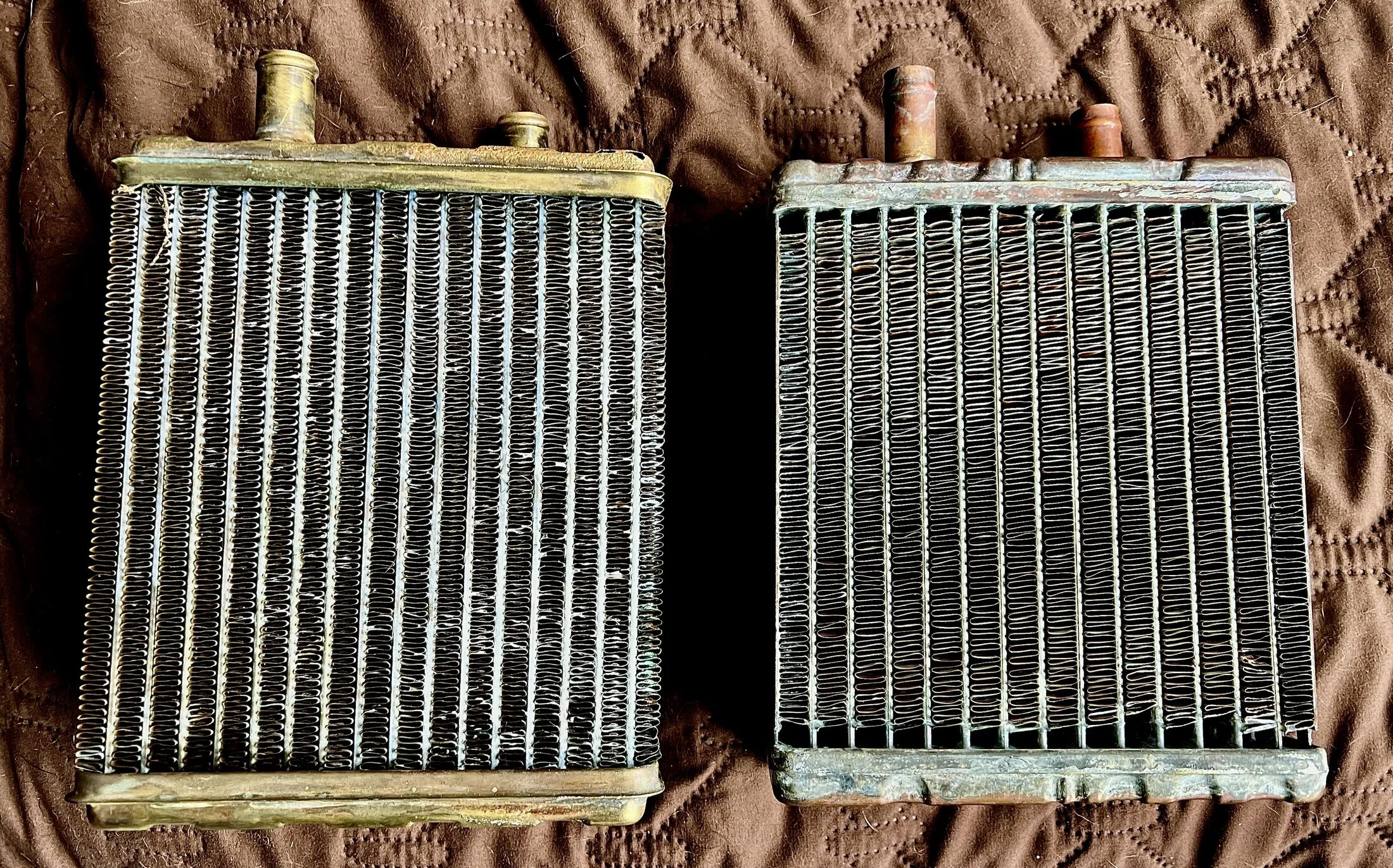

Dimensionally, the unit you listed is the same as the “new” unit I bought from SOR. The OEM heater core I removed is 1/2 inch thicker, but all of the replacement cores I have been able to find are the same dimensions as the rock Auto one.
A thinner heater core would work fine, as long as the inlet and outlet tubes are in the correct location, allowing the core to be installed square in the heater box.

First of all, SOR did send me exact part that I ordered, the correct FJ 40 part for the correct year FJ 40. The core that they sent me was indeed new, was functionally robust, and had no leaks.
So why did it not fit inside my FJ 40 heater box? Why was the core smaller than the one that came out of my heater box? I have the answer.
After several phone calls with the incredibly understanding SOR Customer Service, and the exchange of photos and measurements of in stock units, we determined that the heater box I removed from my 1968 FJ 40 is not original. My heater box and its heater core came from an FJ 55 (unknown year). One of the POs in the last 50 years did a swap out and I just found out today.
Wouldn’t you know it, an FJ 40 heater core doesn’t fit in an FJ 55 heater box. It isn’t supposed to.Not knowing this, I ordered the wrong part. None of this was the fault of SOR, but their customer service helped me discover the true history and origin and ID of my heater box. It’s an FJ 55 heater box that somebody previously put in my FJ 40, and it’s going to work just fine with a replacement FJ 55 heater core from SOR.
To recap:
SOR sent me the exact correct part that I ordered. I just unknowingly ordered the wrong part.
The part SOR sold me was new, it had not been returned, and it was not an incorrect part.
When I couldn’t figure out why it didn’t fit, the amazing customer support at SOR made the figuring out part happen. They figured out the heater box in my FJ 40 came from a FJ 55.
SOR Parts took measurements and pictures and verified that the FJ 55 core would fit my heater box now known to be an FJ 55 heater box.
SOR is shipping me a tested replacement core for my FJ 55 heater box and I am so grateful for their help.
