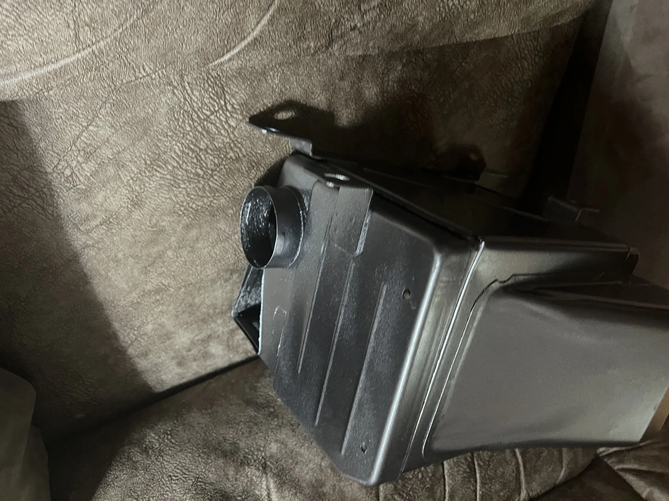

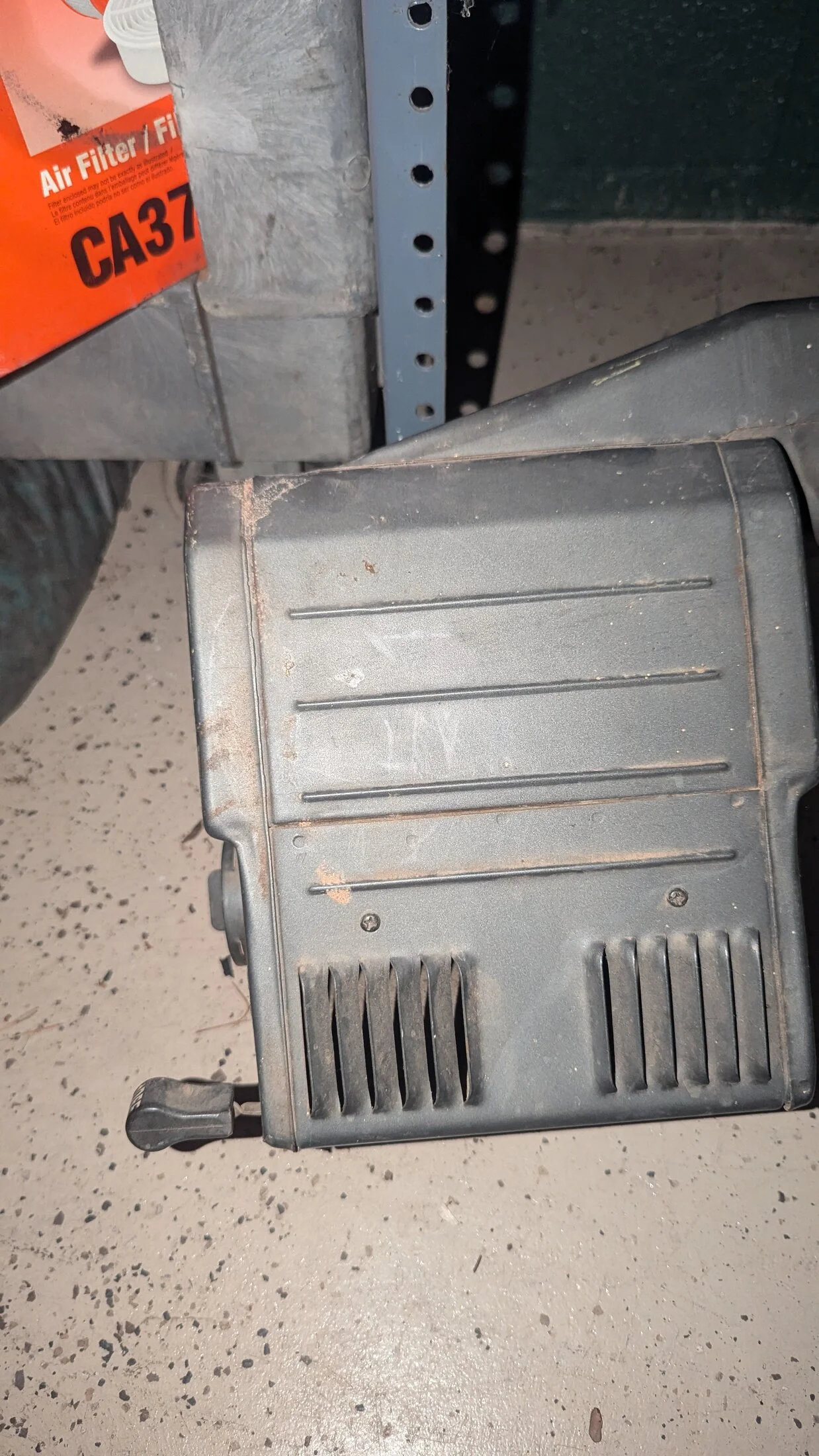

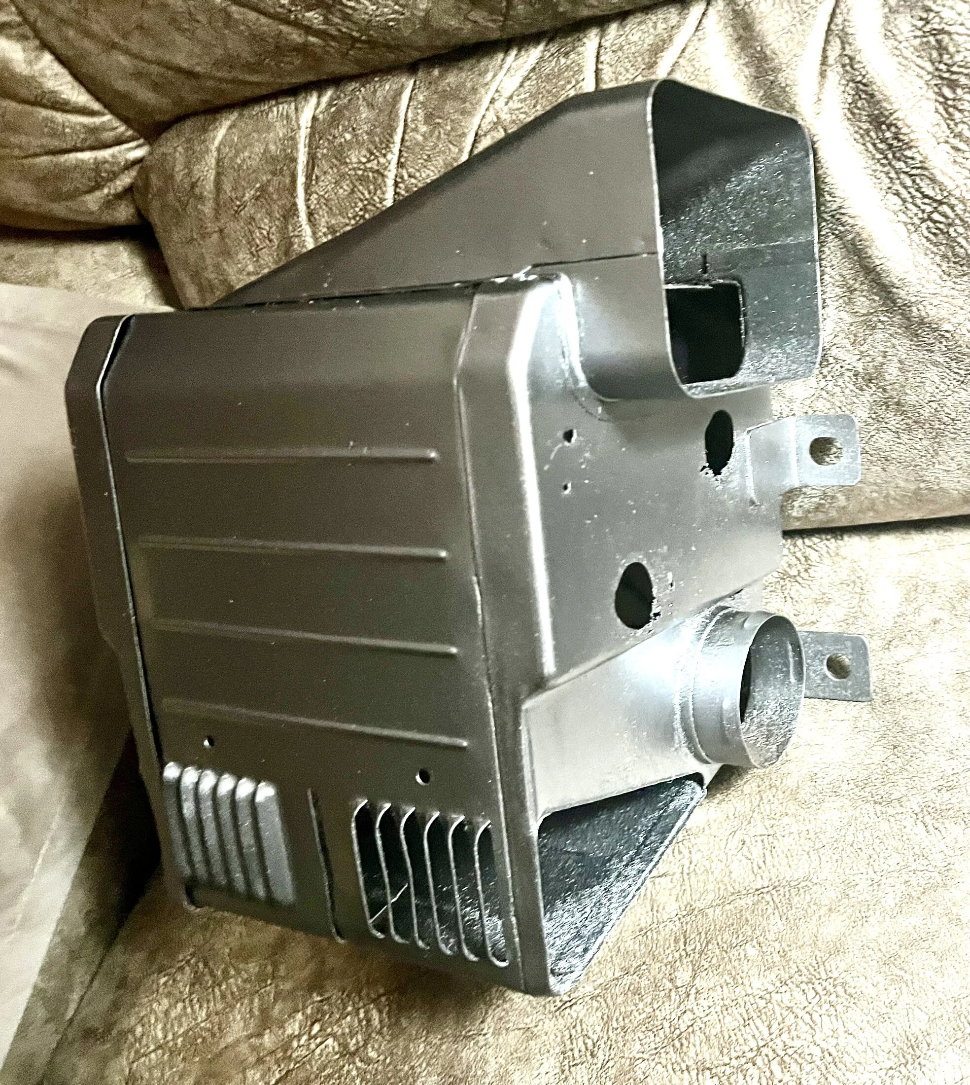

Here are some pics SOR sent me from the stock room while we were trying to sort things out. The black heater box at top is from an FJ 55, and the distance between the core inlet tube centers poking out of the box is the correct 3 1/4”. Correct, in that it matched the distances on the heater core and heater box I removed from the truck.

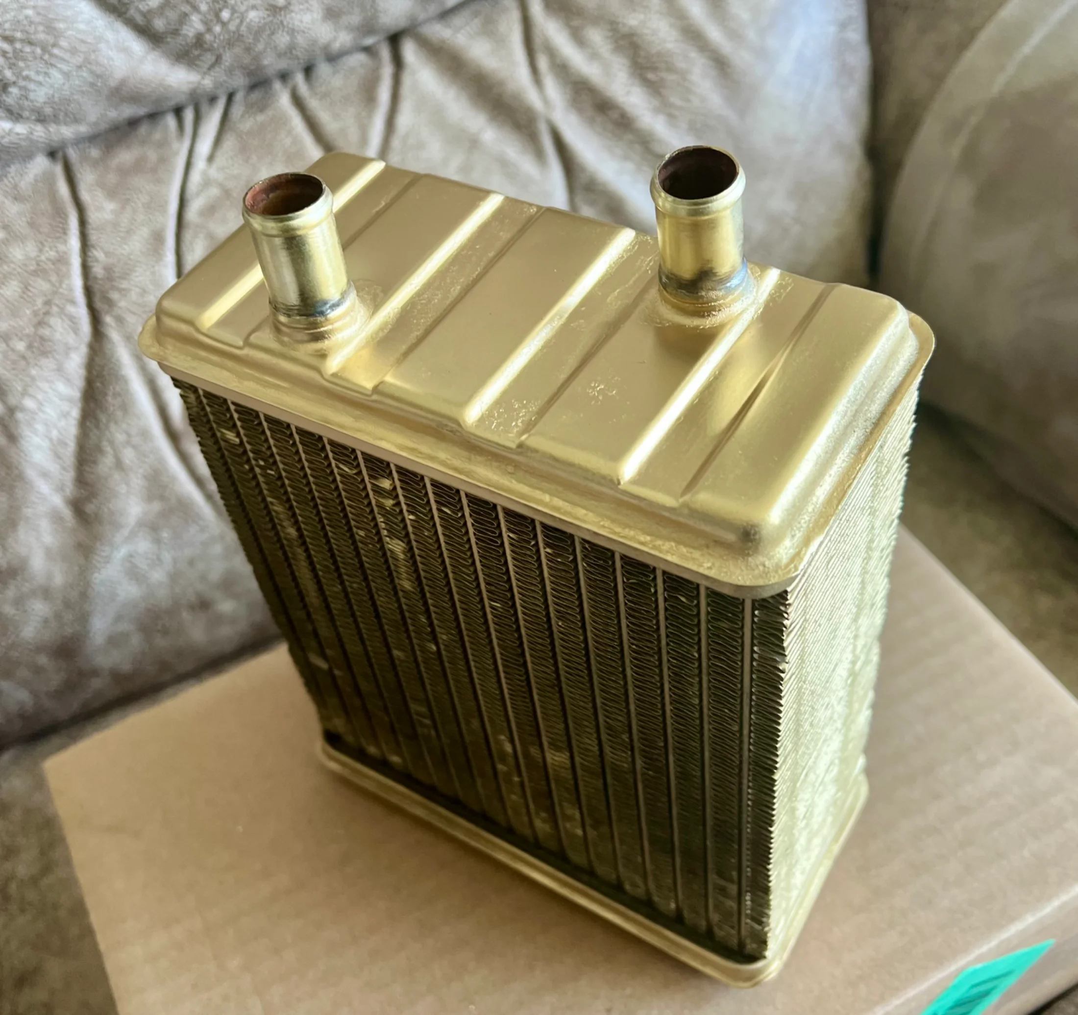

Beneath the black heater box for the FJ 55 in the stockroom picture is a new SOR replacement core for the FJ 40. The distance between the inlet tube centers on that heater core is right at 3 inches. That FJ 40 heater core will not fit in the FJ 55 heater box. Was never designed to do that.
When I saw those 3 1/4” heater core inlet measurements taken from the SOR stockroom on the heater box for an FJ 55, I knew that was what I had. The FJ 55 core was also 2 1/2” thick like the one I removed from my heater box. Even if they sent me another new FJ 40 heater core, it was never going to fit my heater box. I needed an FJ 55 heater core and hooray, they had one.

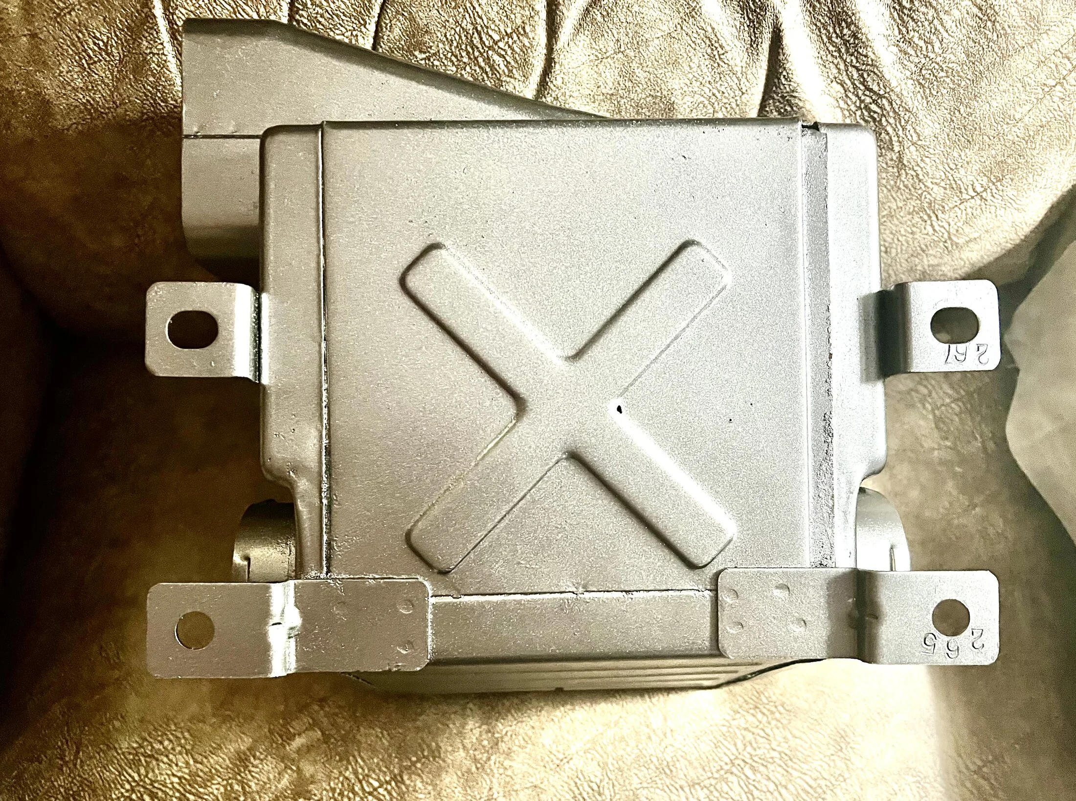

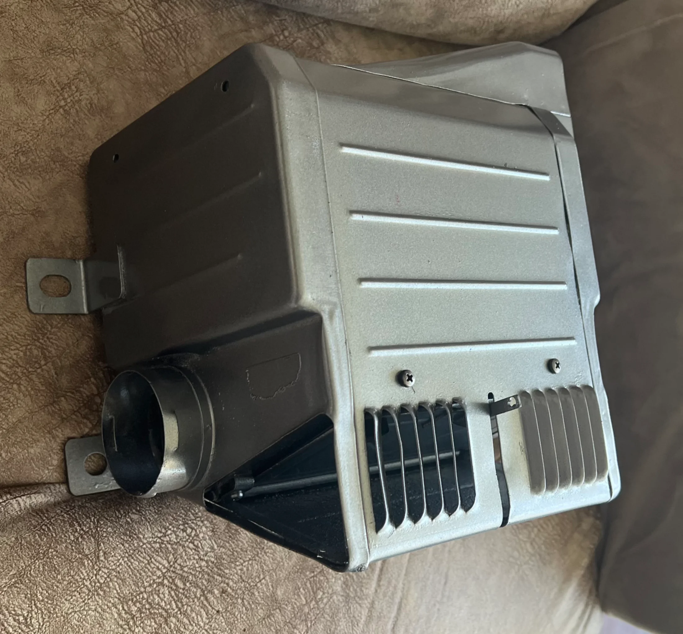

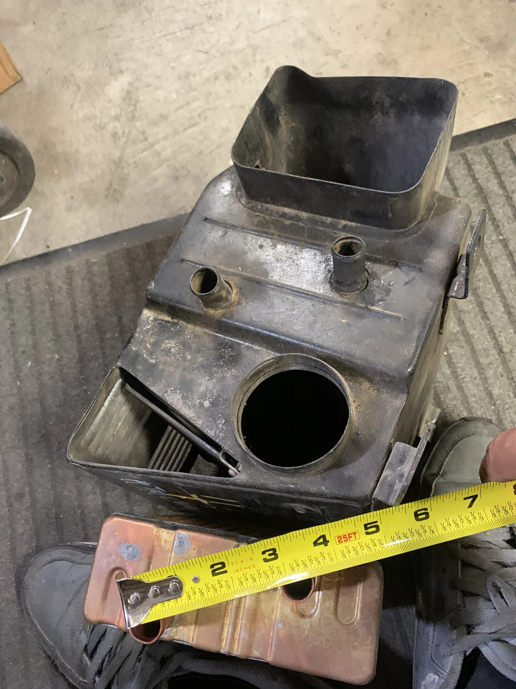

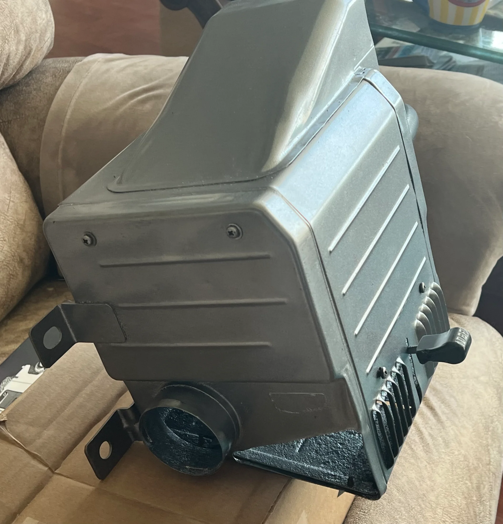

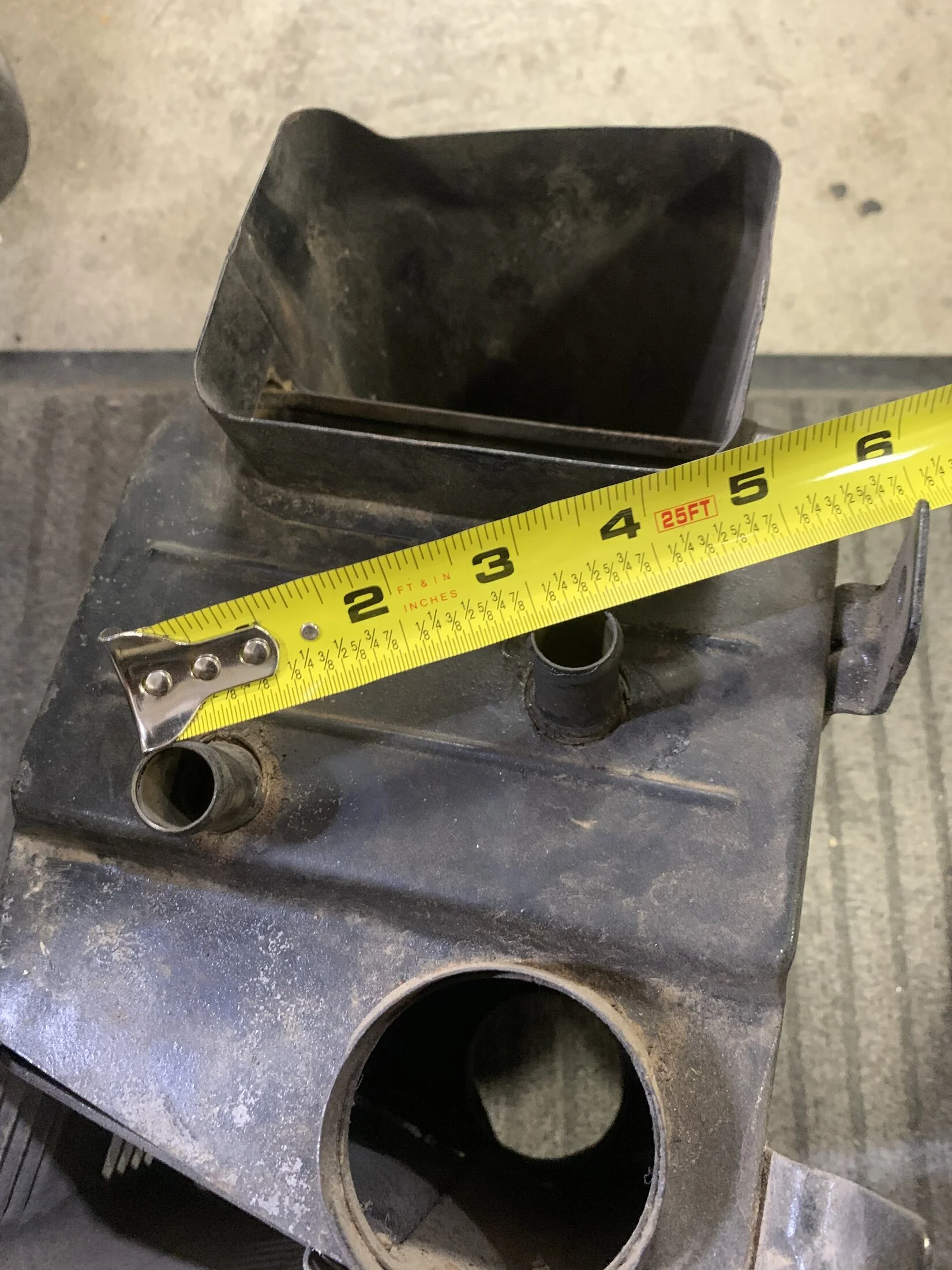

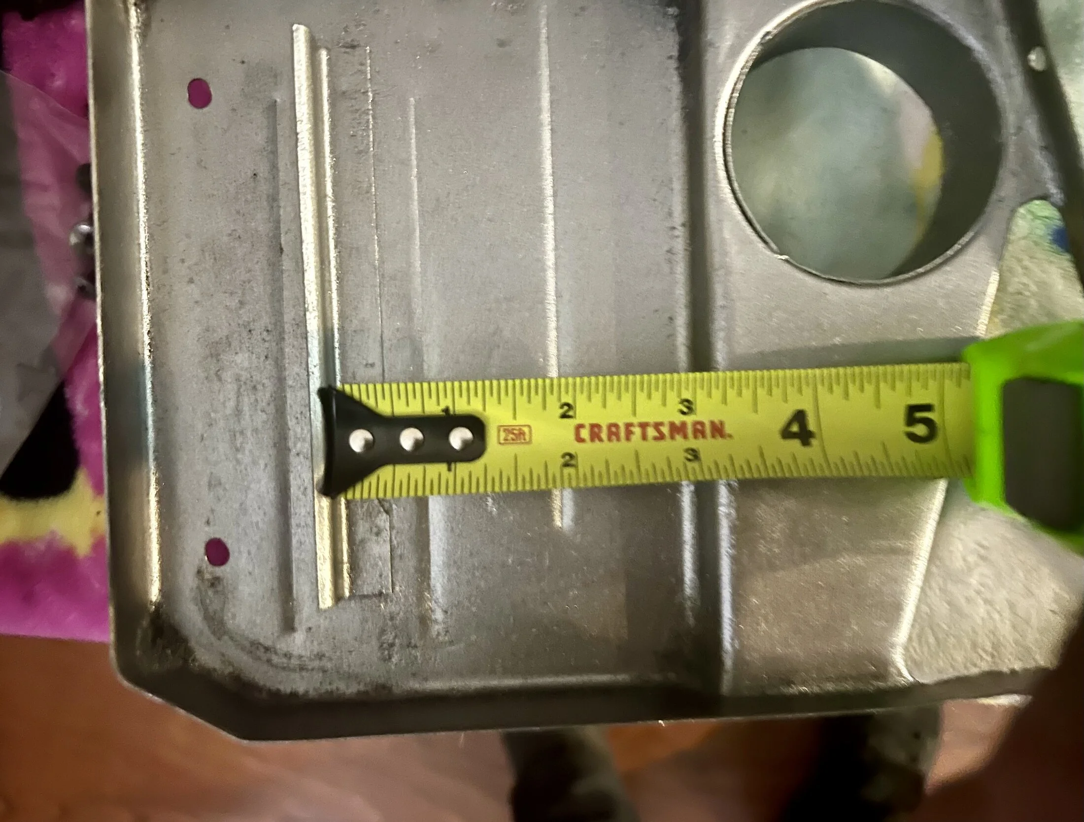

Below in metallic gray,is the heater box that I pulled out of my FJ 40, (not knowing it was an FJ 55 box). The measuring tape shows the inlet tube holes are also 3 1/4 inches apart.

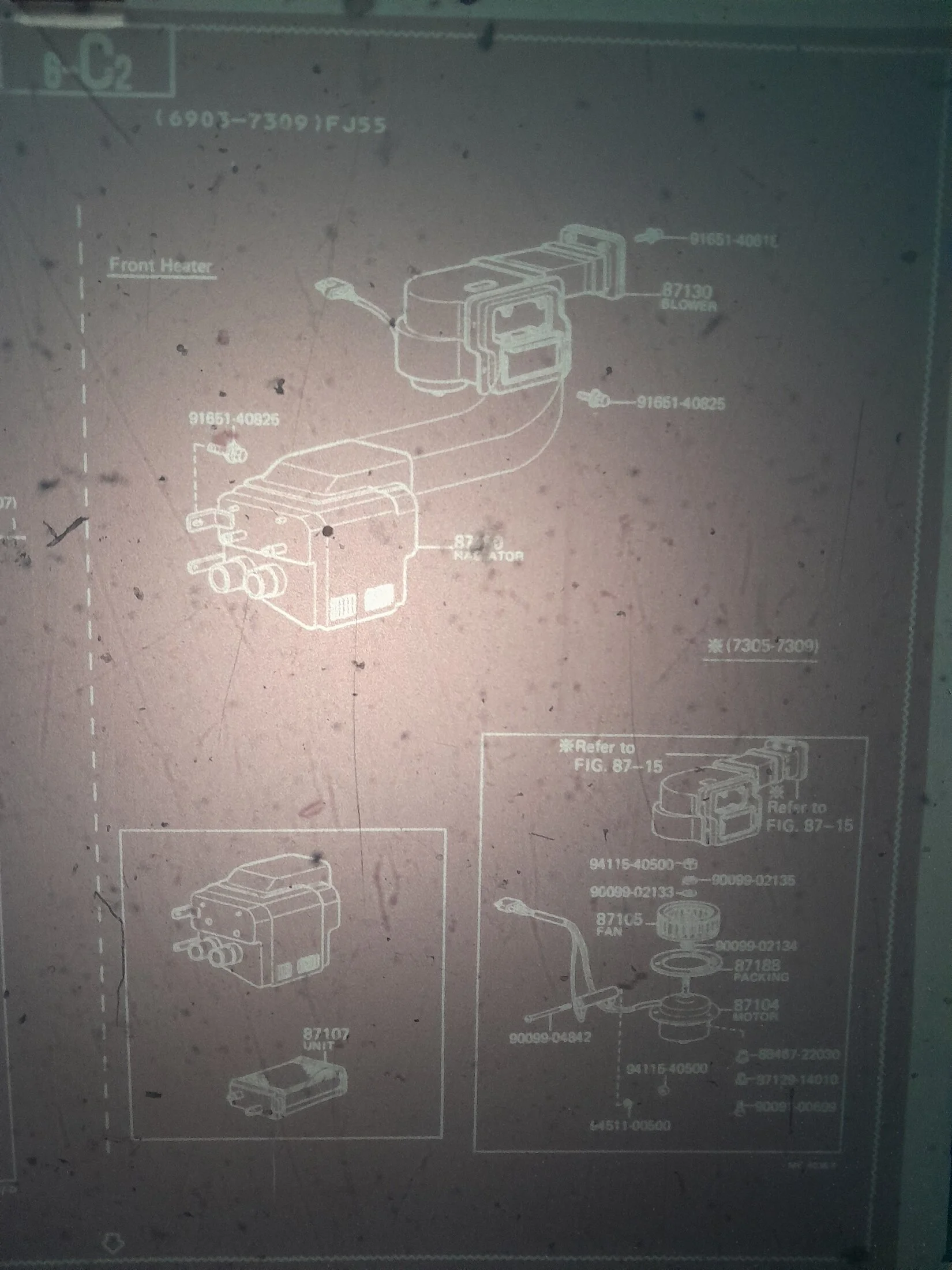

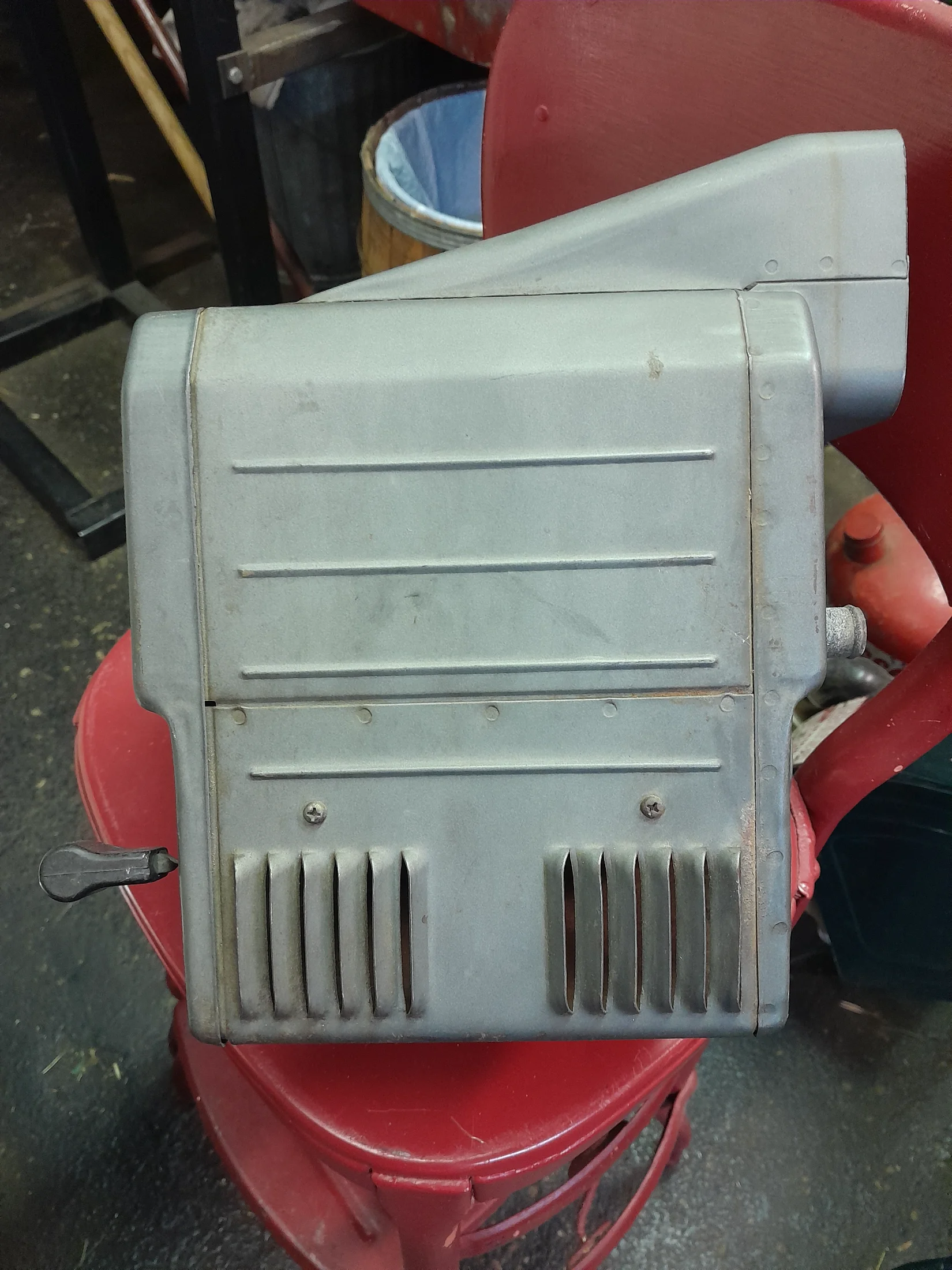

More to the story than different heater core in the FJ40 and FJ55. I show the heater cores for the 40 and 55 are the same with a 9/73 change along the whole heater design change. In my collection of heaters I have a pre 9/73 FJ55 front and rear heaters. The base on the rear heater is different. On the front heater the FJ55 two defrost hoses one one side instead of one like on the FJ40. 9/73+ heater has a vent on that by passed the heater core. Never compared the 65-68 40 series heater which is different than the 68-73 but believer they used the same heater core. The duct work between the blower and heater is the same.

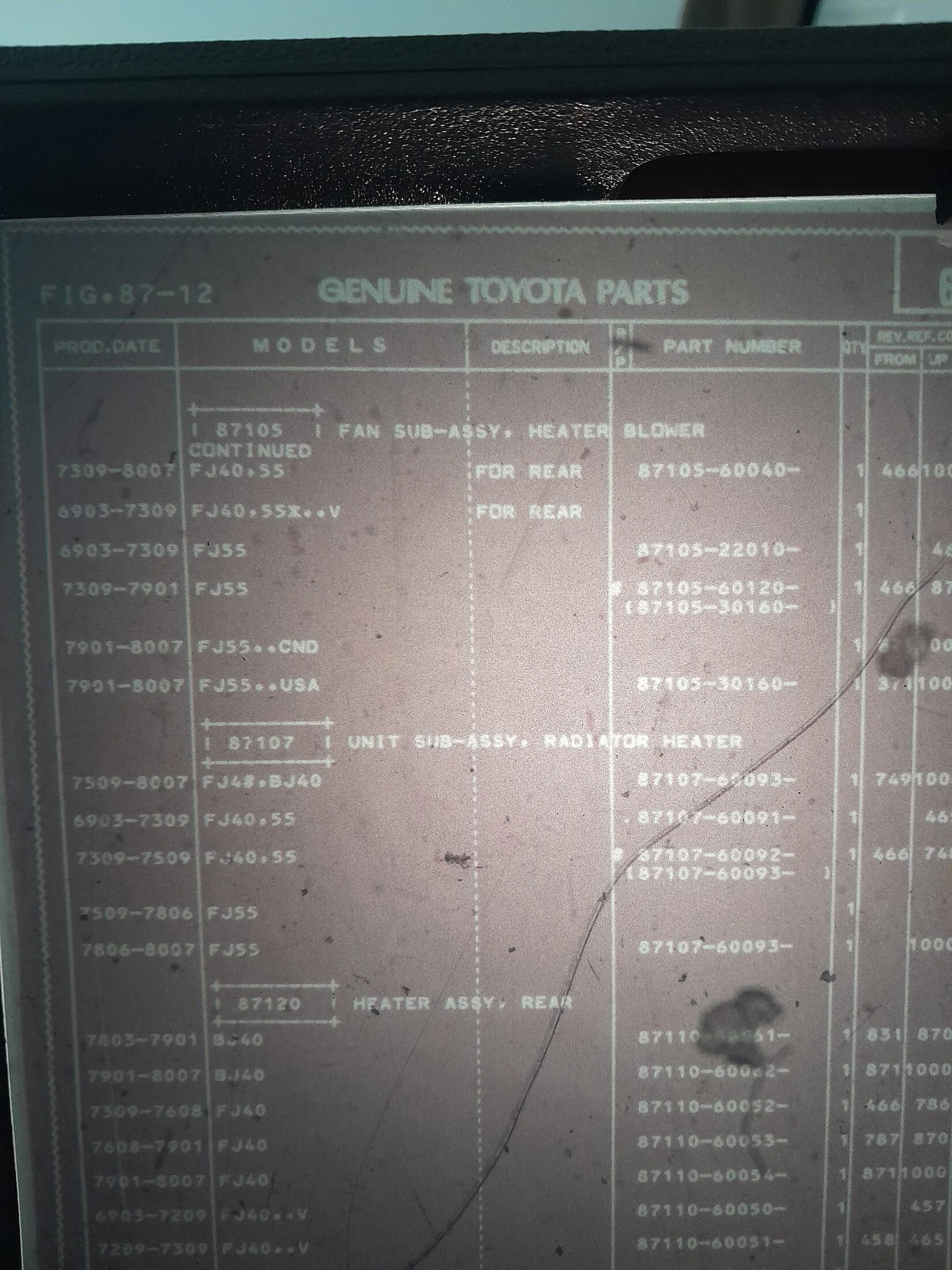

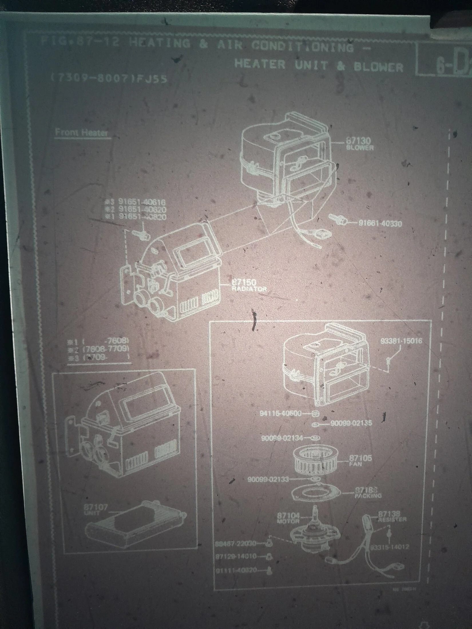

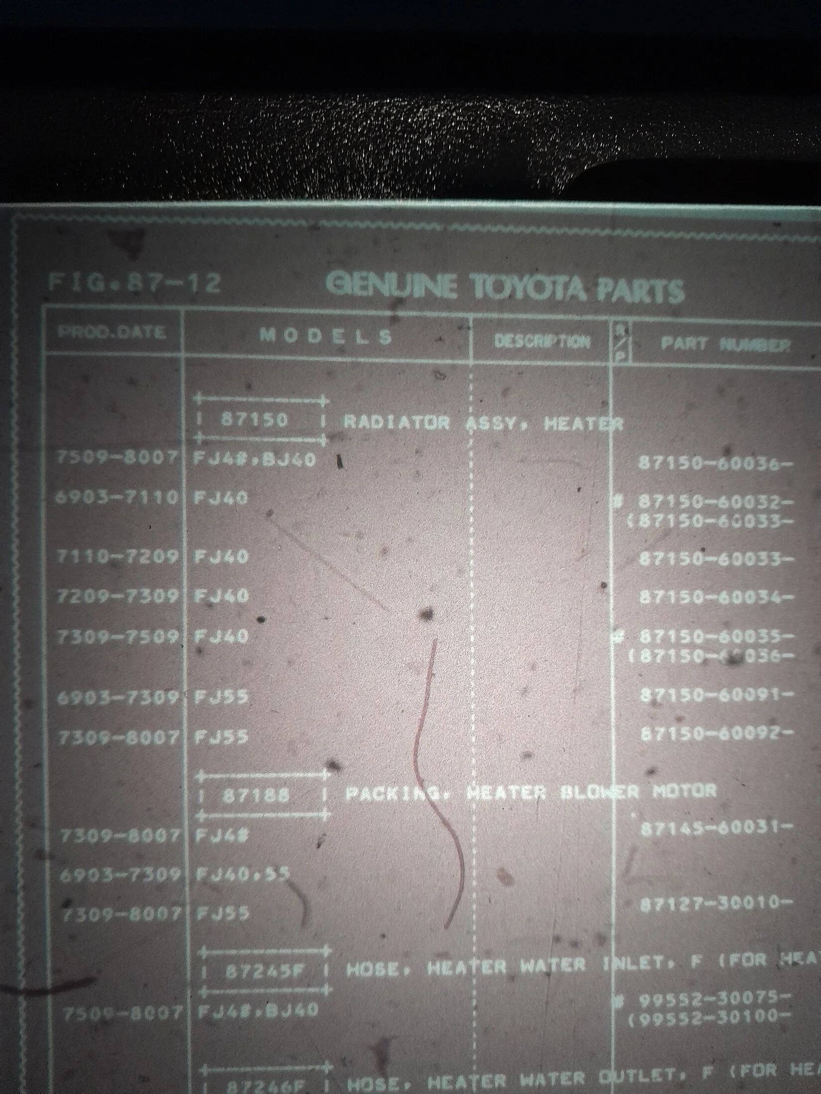

I'm no authority or parts counter guy, I'm only presenting what I see. It appears there were only three different p/n's for the front heater cores for the FJ40 series and FJ55's for the period from 03/69 to 07/80, with both vehicles using the same p/n, year dependent. These p/n's were good as of Jan. '81 as indicated on the microfiche panel.
Im looking at the fiche pictures and none of them look like my heater box. My truck is titled as a 1968, so pre-69.

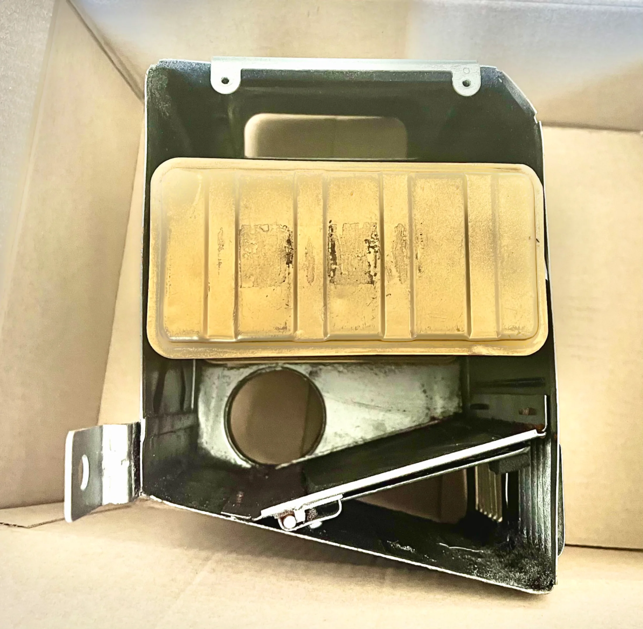

My heater box has a single air discharge outlet on each side. When opened, each of the heater box ends contains a well that brackets and holds in place a heater core that is 3 inches thick and sits square.

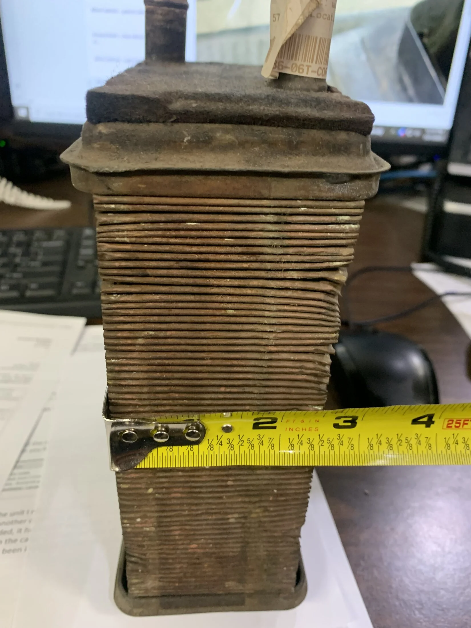

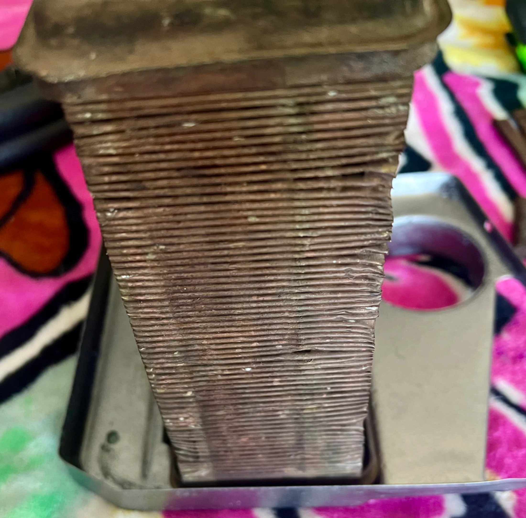

The heater core I removed from my heater box was 3 inches thick and sat squarely and securely in the recessed cap end wells of the heater box. Fits very well.
Below are the 3 inch wide recesses for the core in the end caps of the heater box

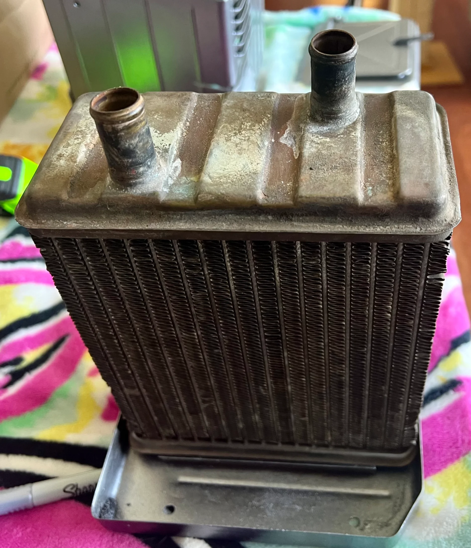

This is the 3 inch deep heater core itself
Note: the core is 3” across at the end caps. Smaller in the middle.
on the 3 inch thick core, the distance between the center of the inlet and outlet tubes is 3 1/4 inches.
Searching across multiple vendors, all of the replacement early FJ 40 heater cores offered are 2 1/2 inches thick, with a distance between the center of inlet and outlet tubes of 3 inches.
The 2 1/2 inch thick replacement heater core absolutely does not fit in the heater box that held a 3 inch thick OEM core. The heater box outlet holes on my heater box are 3 1/4 inches from center to center. The 2 1/2 inch thick replacement heater core outlet tubes are 3 inches from center to center.

I agree — only one part number appears in the >1969 fiche images you shared for the heater core.

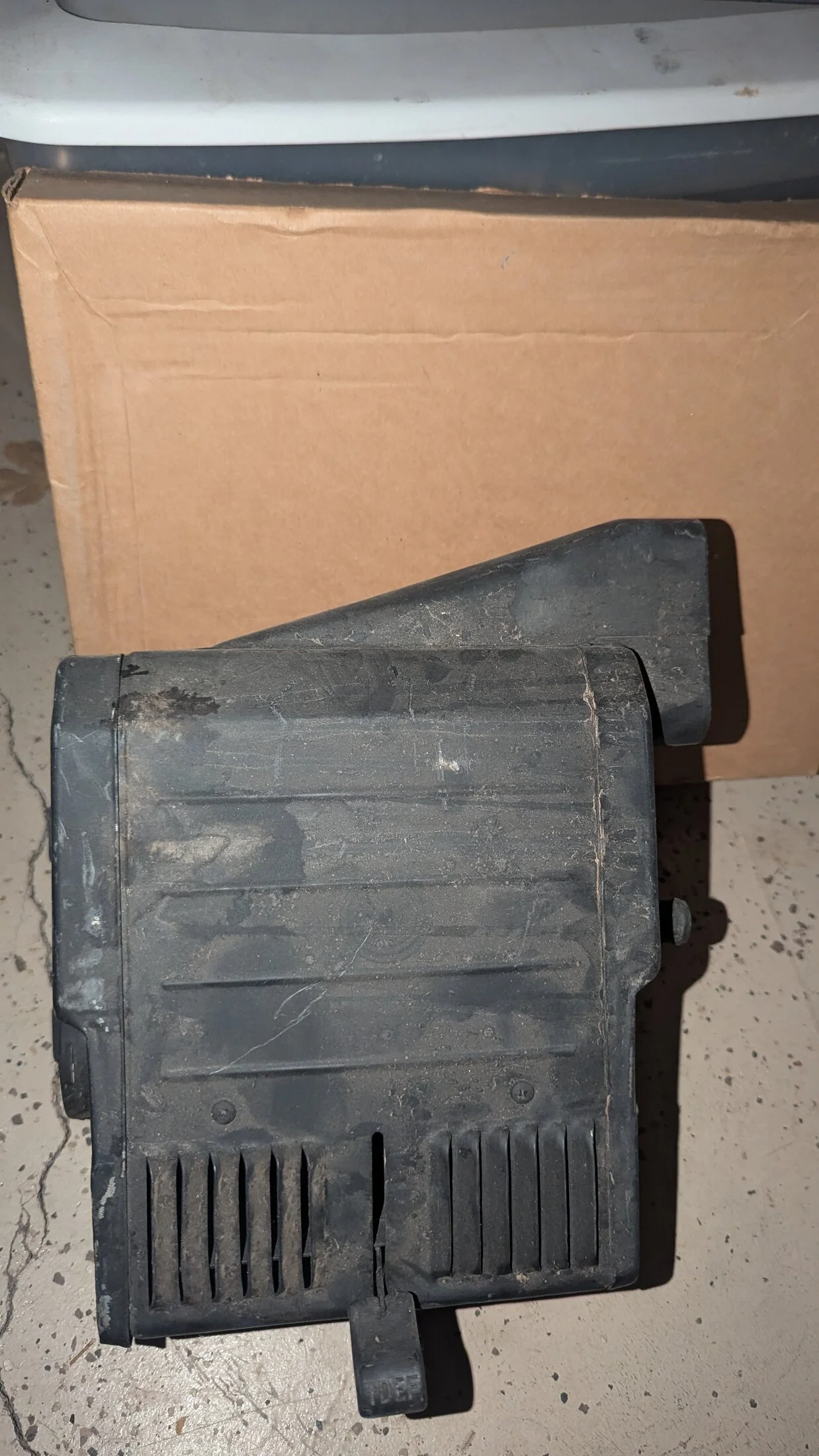

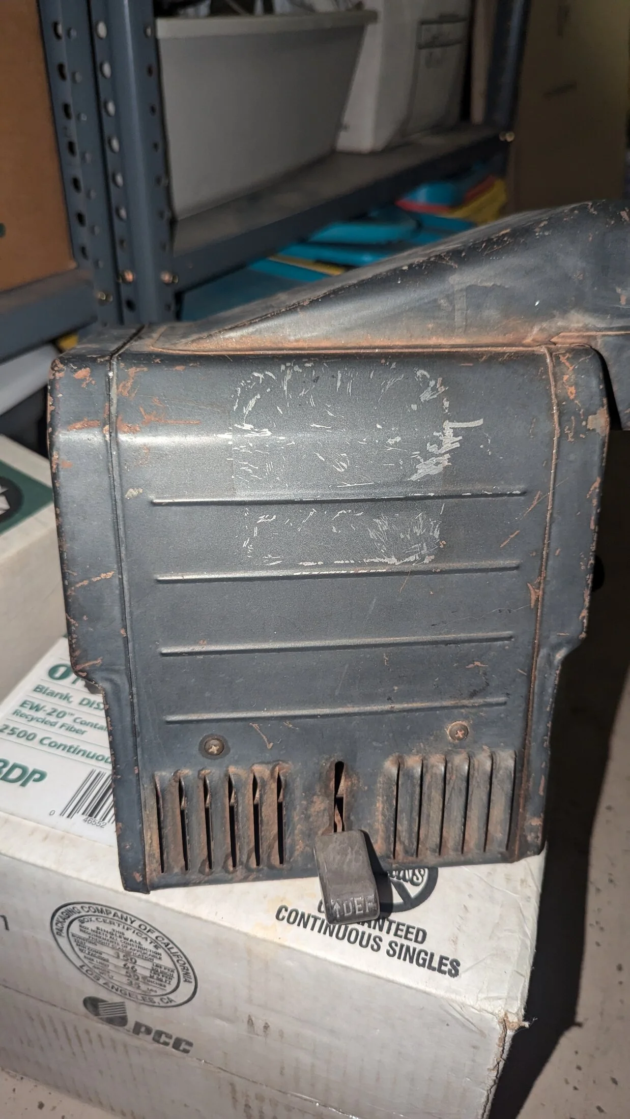

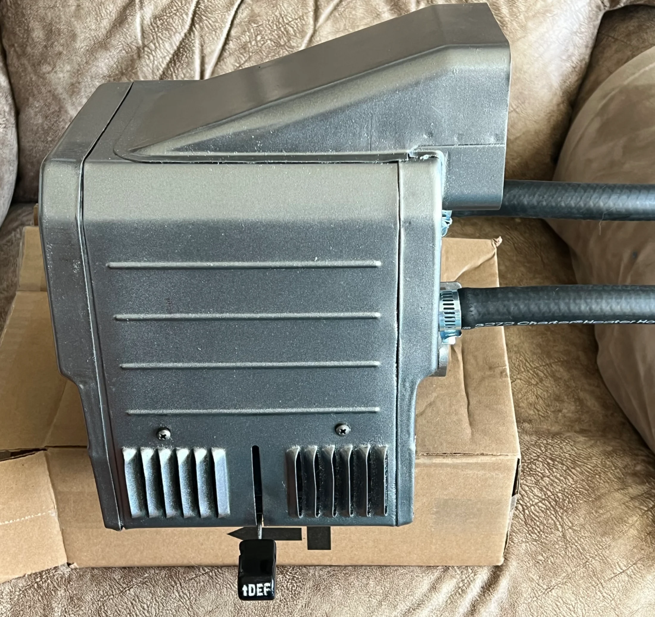

Unfortunately not around my 9/67 (which first month of the 68 model) or my collection of heaters. The heater installed in my is not the original heater. Friend painted my 68 for free over forty years ago. He didn't tape off the heater and painted it same color as the 40.
The knob to move the damper to defrost in the slot in the face. Not sure where the one with slot and knob is from. Possibly a 72. One withlut a slot is for a 73.
View attachment 3954446View attachment 3954447
The last two pictures look like the heater box in my truck… from a 72, you say?

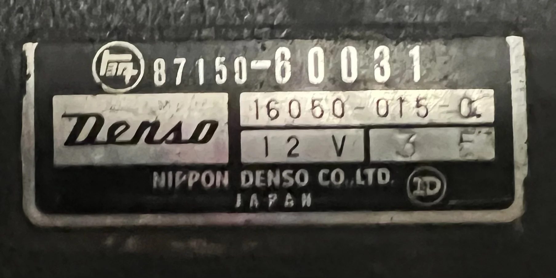

No, thought first picture which is what is in my 68 currently might be from a 72 because the slot in the front for the defrost and knob at the side. Part number is 71 or earlier. Interesting because the ones with the defrost in the front have that part number as well. My 72-9/73 heater ends in 34.

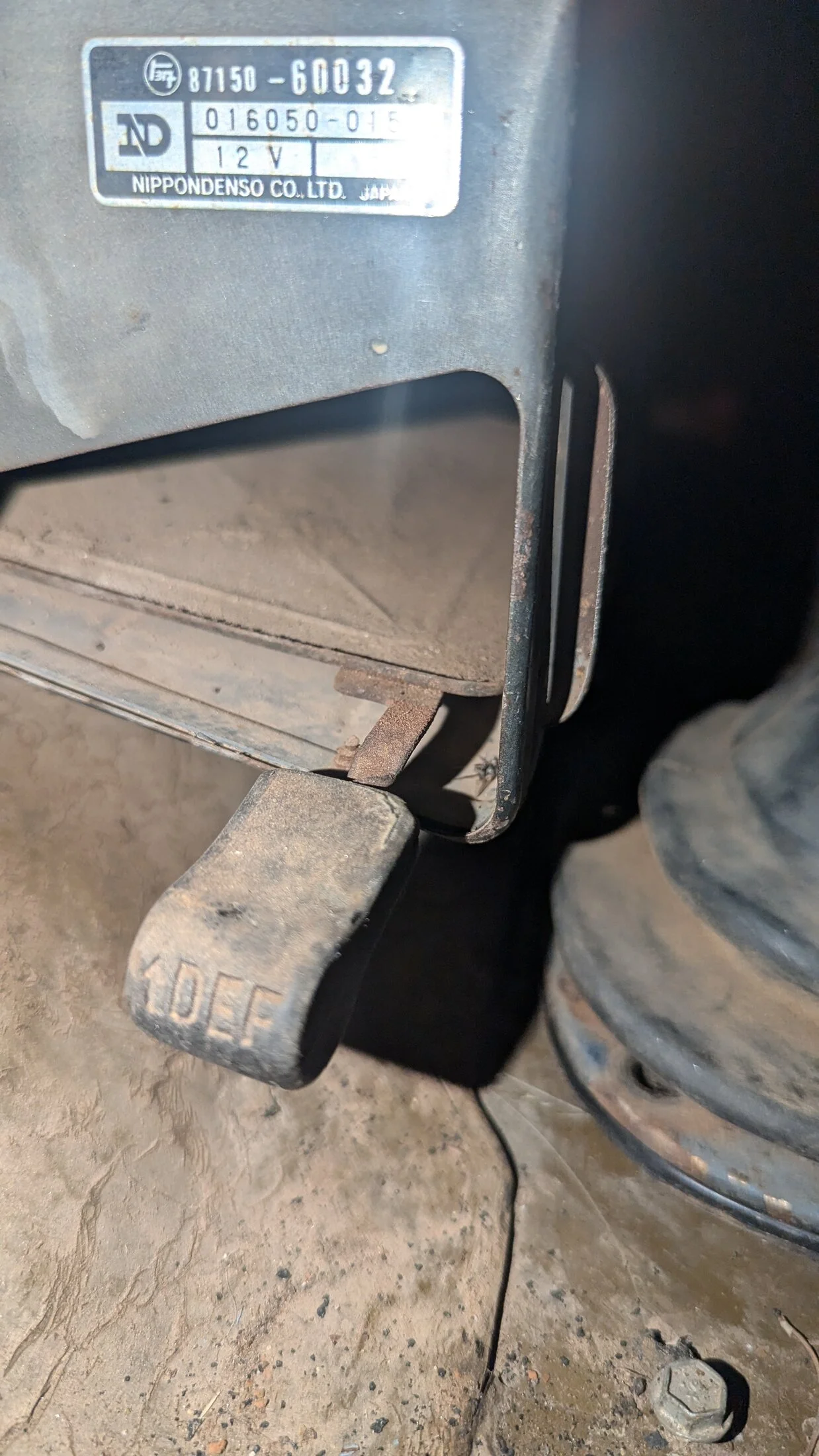

Pics from my 01/72 fj40 heater, owned since 10/78, and heater p/n tracks with parts numbering sequence.
Interesting the only difference between your 33 and my 34 is mine seems darker. The inlet duct and defrost hoses did not change between 3/69 and 9/73. When I get around my heaters again with check closely to see if possibly the defrost knob been moved. The 71 when the brake booster started the brace that ran between the brake and clutch master was crudely modified. Thought possibly the same had happened with the 72 model which was the final model year for the column shift. Defrost knob in the front harder to get to with a floor shift. 72 seems to be a mix of floor and column shift.
I definitely have the defrost knob and slot in front, but I know the truck was converted by one of the previous owners from column shift to floor shift.
Ergonomically, I don’t have interference issues between the defrost knob and the floor shifter in my set up. So I’ve got that going for me, which is nice.

This is the cleaned, flushed, correct size heater core. I even sat down for a while with a tiny screwdriver and straightened out a bunch of bent cooling fins.

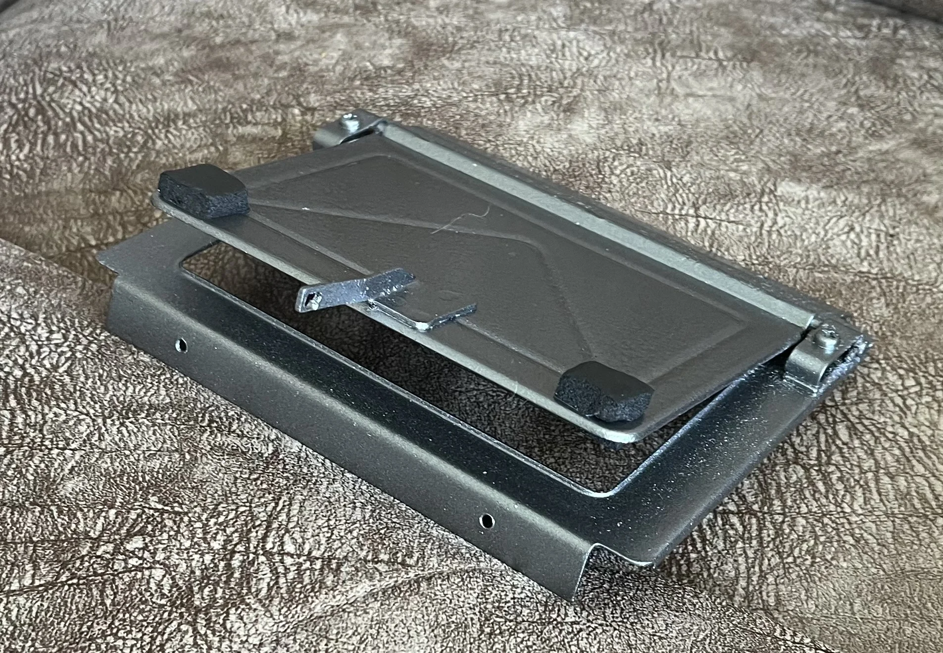

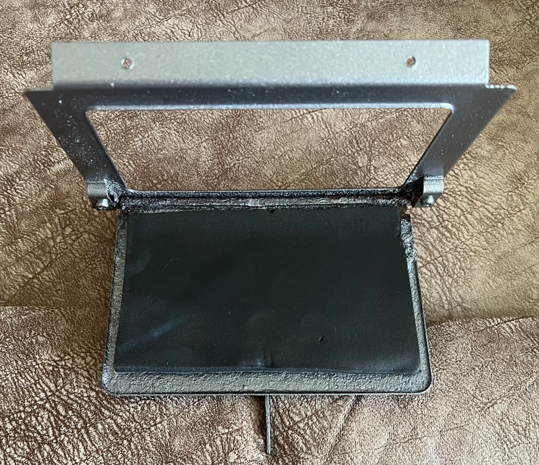

I also put fresh gaskets on the diverter door.
I added little pads on the bottom corners, so the diverter door wouldn’t rattle against the heater box when in the open position.
