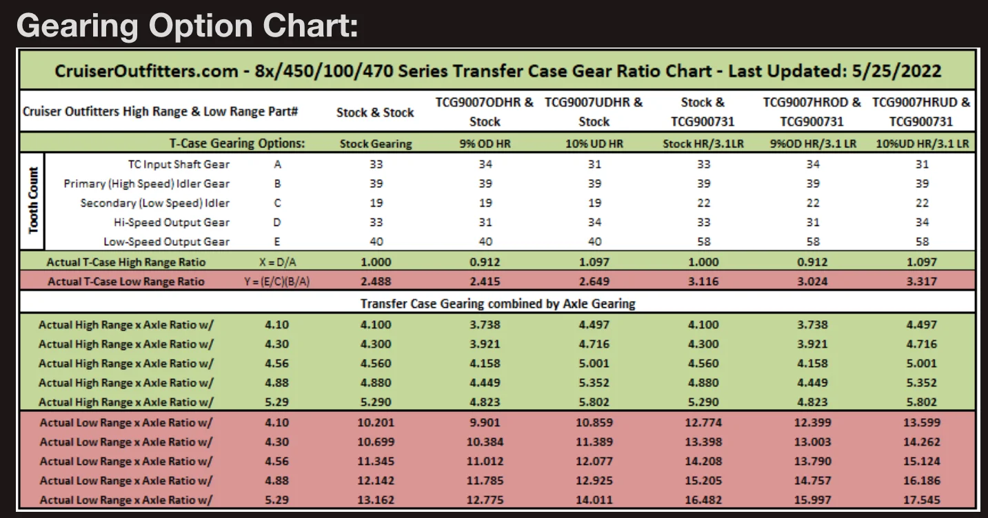

If you are in fact using 35 inch tires that is a 12% increase over stock. So with the 10% underdrive gears you should be back to the correct speed readings on your speedometer and a better place in the power band as well.
Changing out the t-case gears is less invasive than swapping axle gears, but axles usually need love (maintenance) where the t-case rarely does, so you can knock out two jobs at once if you go with axle gears. There are advantages and disadvantages to both, it usually comes down to your personal situation to determine the right path for you. There are a few threads that address the pros and cons to both.

I am going with 488s because it only made sense since the work had to be done anyways to install Eaton lockers. However, I did ask this question to the gear expert and this was the response. “Regearing the diffs is the best place to balance out the driveline torque throughout the whole drivetrain.....you have an auto so the 488 gear change is welcomed with larger tires. the highway is ok with 488s.....the 488s offroad will mean you have regained control and can go slower and less bumpiness. You might consider the transfercase regear if you go to 35" or larger.” So if I end up going larger than the 34” I am running today I would also do the TC. Hopes this helps.
I may go 37's at some point. I have a 4" Dobinsons lift. Would 37s fit?
The lift size doesn’t matter when it comes to fitting tires. But if you have the inkling that you may go to 37s, just do 5.29s. It’s not worth the money to do 4.88s in my opinion. They’re fine with 35s but supper annoying with 37.
I'm on 35's, planning to do the high range underdrive and low range crawl gears. If I go to 37's I will tackle the diffs at that time.

One of the first things I did on my 97 LX450 was 4.88 gears. I had already had 35s. Later on I had the 3.1 low range gears installed in my transfer case, and I just wish I had done that sooner. It's a joy to wheel the rocks now.
